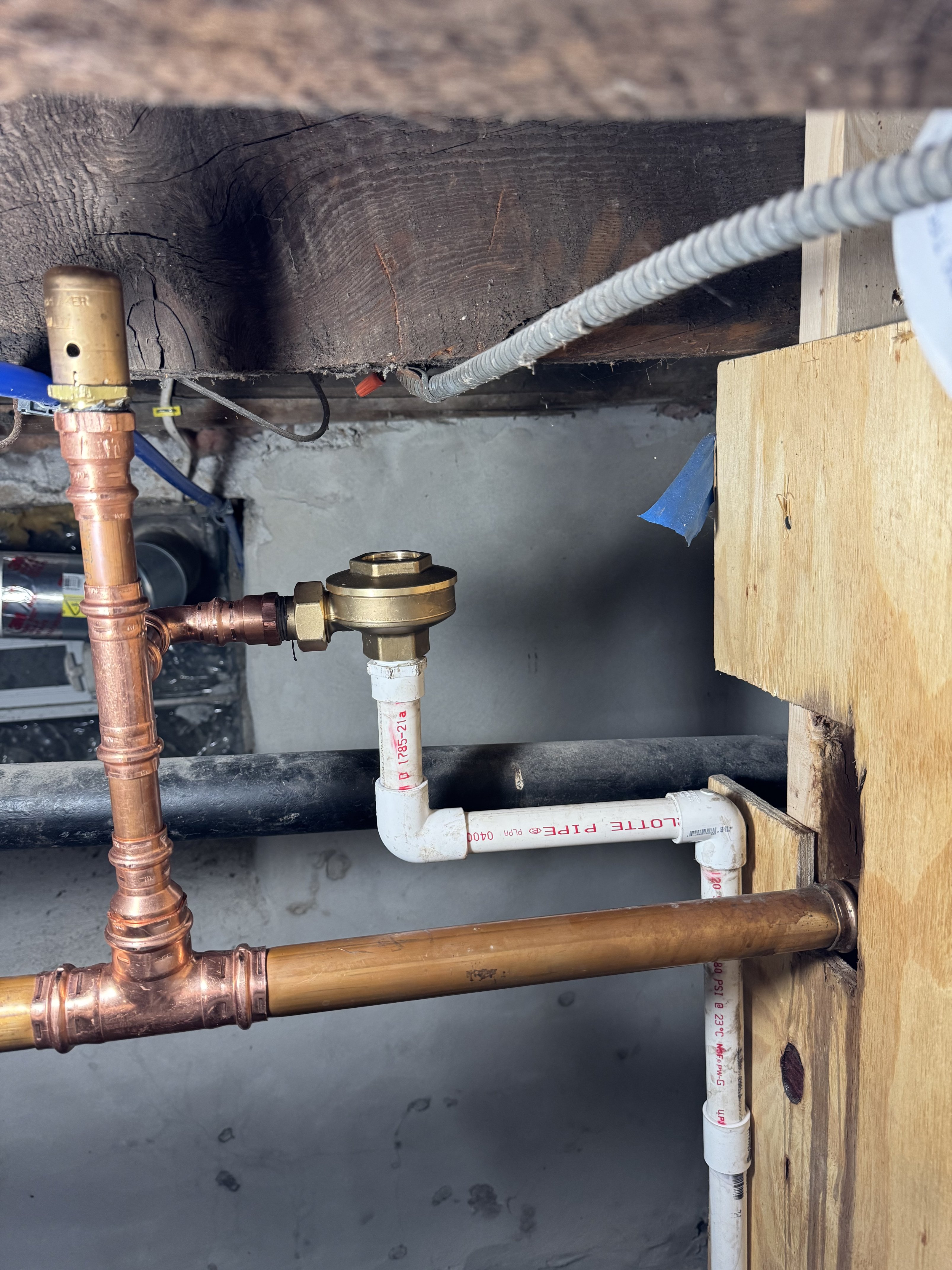

Hello all. I just had an old Hoffman vent replaced with a Barnes and Jones “big mouth” BJ-B3M. The plumber who installed it moved it about 12” from where the Hoffman was, and also put it on a T. The T comes up from the steam pipe about 8”, then the vent is pointing out horizontally from there. Looking at the spec sheet (https://s3.amazonaws.com/s3.supplyhouse.com/product_files/Barnes-&-Jones-BJ-3BM-Submittal-Sheet.pdf) it looks like only their crossover trap should be installed horizontally; main vents should be installed vertically. Will the horizontal position impact its function or performance? It’s on the dry return about 8” above the pipe. It’s the only vent in the system. 2 pipe steam.
Thanks.
Edit to add picture. The white PVC is open at the bottom leading to a bucket. The gizmo at the very top is a vacuum breaker.
    It's on a dry return? Then it shouldn't be a problem — since it should never close anyway.
    but any water that gets in to it may not find its way back in to the main but may drip out
    Quite true. A Big Mouth will not close against water…

    I have a big mouth, oriented correctly very near the end of the main on a 1 pipe system. So it sees steam every boiler cycle. The spec sheet orientation is so the condensation from the steam that closes the valve drains back into the system, minimizing system water loss.
    Your system being a 2 pipe system, if your big mouth never sees steam, probably not a big deal.

  • Yes, on a dry return, however, the old vent was spitting *a lot*, so either steam or water was getting to it somehow. Various problems in my system that might be causing that. I believe my radiators are letting steam into the returns because they have missing or faulty steam traps / orifices. Pressure may be getting too high also.

    the trap is also a vacuum breaker. be better if the trap were turned 180 degrees so the outlet was facing up so that any condensate in it would run back to the return.
  • Right, thanks. But would it be even better for the T to be reconfigured so that the vent is oriented vertically and the outlet is pointing out horizontally? That’s how it’s shown in the spec sheet.
    i don't think there's much difference between the 2

    For best performance regardless of the defects present in the system it should be installed as the spec sheet shows, that is 'Best Practice' in this case. Is there a clearance issue ? Why the plumber install it the wrong way ? Having the vent port pointed up invites debris contamination and I would not suggest that.

    Well just saw the picture. You should not need the PVC pipe leading to a bucket.
    I'd figure out why you are experiencing
    " the old vent was spitting *a lot*, so either steam or water was getting to it somehow. "
    You want to minimize system water consumption, if it is loosing water with every cycle, that is not good. Once that is corrected then correct the Big Mouth vent orientation.
    " But would it be even better for the T to be reconfigured "
    I would leave the T as is.
    I would do this; Disconnect the PVC pipe. Then unscrew the union to disconnect the Big Mouth, unscrew the Big Mouth's spud (requires a Hex tool 5/8" (I think) if it is a 3/4 pipe thread) add a threaded nipple and a 90 degree elbow (preferably brass) pointing up, reinstall the spud and reattach the Big Mouth.
    Personally I think the vacuum breaker is kind of useless.
    Actually I'd probably just remove the vacuum breaker and put the Big Mouth there if it will fit, then plug the other pipe where the Big Mouth is now.
