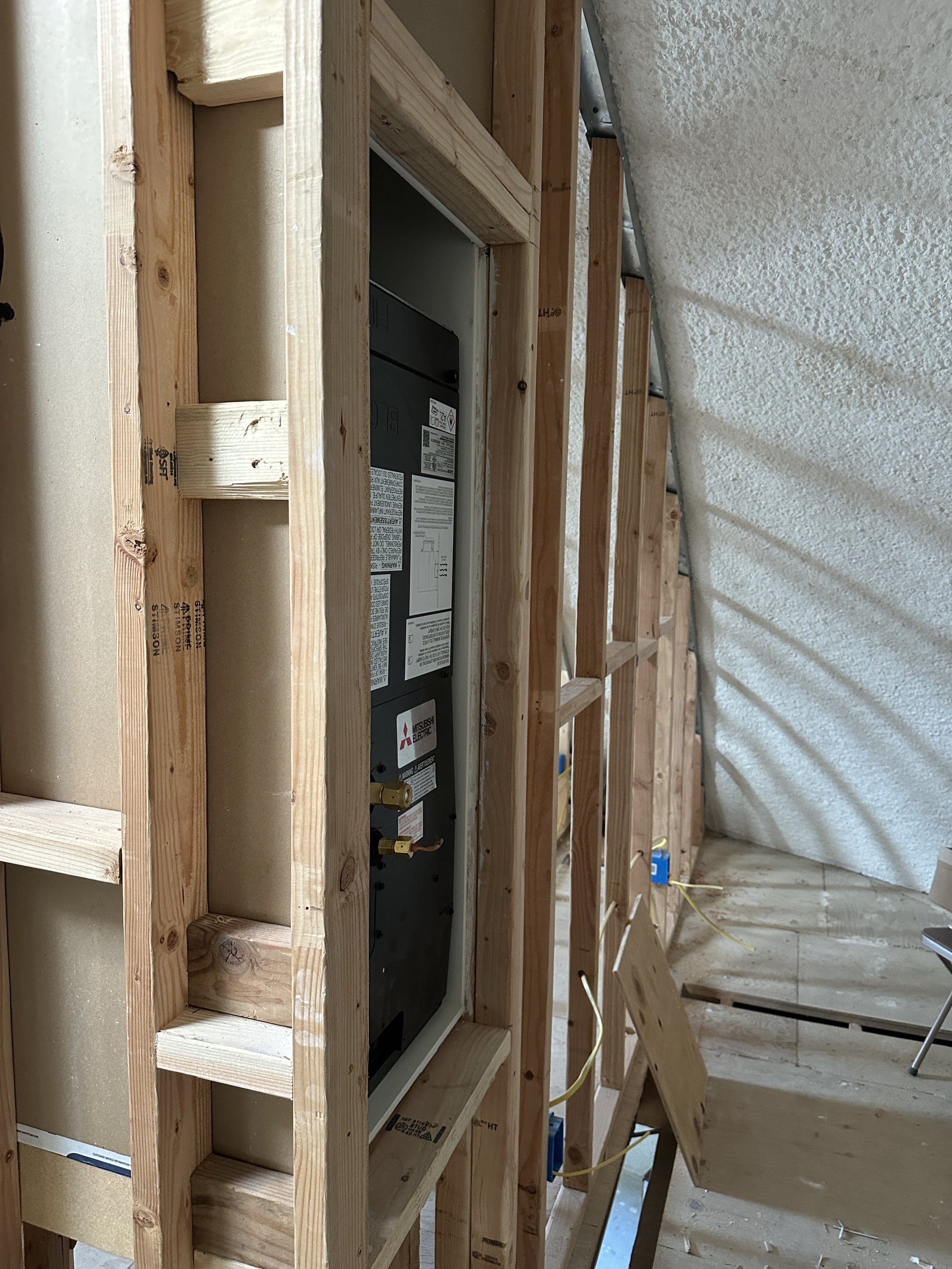

  • thanks again for the replies. I’ll talk to my hvac installer about all of this — he just moves very fast and isn’t always easy to get ahold of. I’m more detail oriented and trying to fill in the details and solve the hiccups to keep things on track.

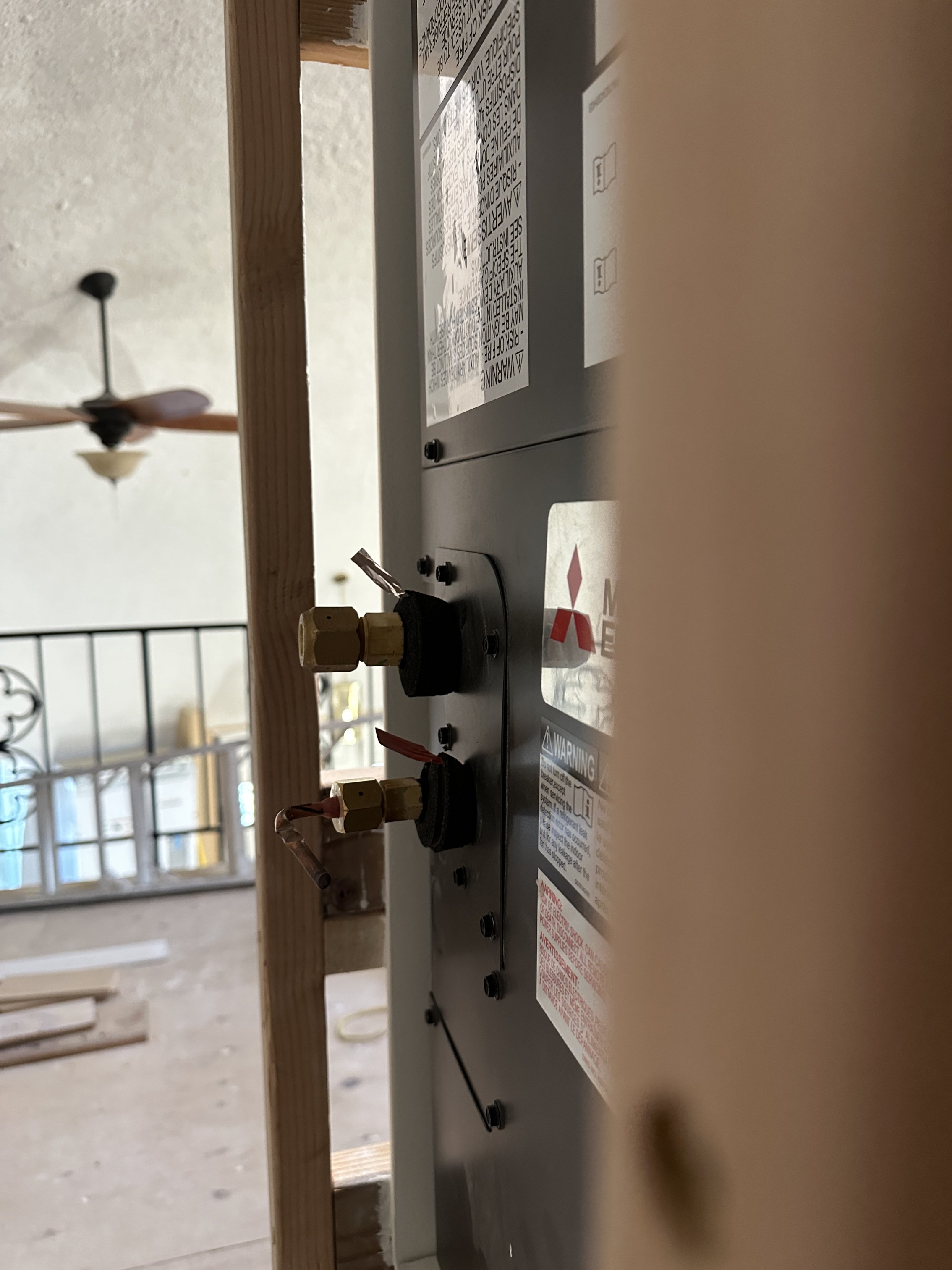

    Separate question: spec on bend radius for 5/8” looks to be about 4” — ouch. Should I religiously stick to that or can it be done a bit tighter? This wall needs to be furred out to fit the turn down of my line set. Trying to minimize lost space where I can. I’ve also seen 90 degree fittings discussed instead of bends, if that’s an option.
    Mitsu gave dimensions of the unit but didn’t factor in the additional line set clearance and I didn’t plan for it unfortunately. The flare nut fitting is currently 1/2” to 3/4” inside the framing and I will add what’s needed for it to fit.
    Check out that pretty (pretty tight) mechanical chase though. Phew.
    They make sweat and flare elbows if they are needed. 4" radius sounds about right but you can bend it as tight as you want as long as it does not kink the tubing. There are lots of benders available.
    Manufactured elbows don't have a 4" radius. Elbows and extra fittings should be avoided but if you need to use them use them its not a deal breaker.

    You're going to have a hard time getting that line turned into the unit in less than 4 inches or so. I think I'd flare a piece of copper, slip a nut on it, cut it off just past the nut, then braze it on to a 90, even a sweep 90 is tighter than a bend in the pipe. Might be able to get that down to 3" if you're careful to keep the solder away from the flare (both surfaces). You want to bring that wall out another 4" or so to give yourself more room. I would consider doing that.

    Also, I can fur out the wall to give 4" of space for the turn down bend — didn't want to but if I have to I will. Trying to set up a call with the HVAC installer to go over these details but no luck yet.

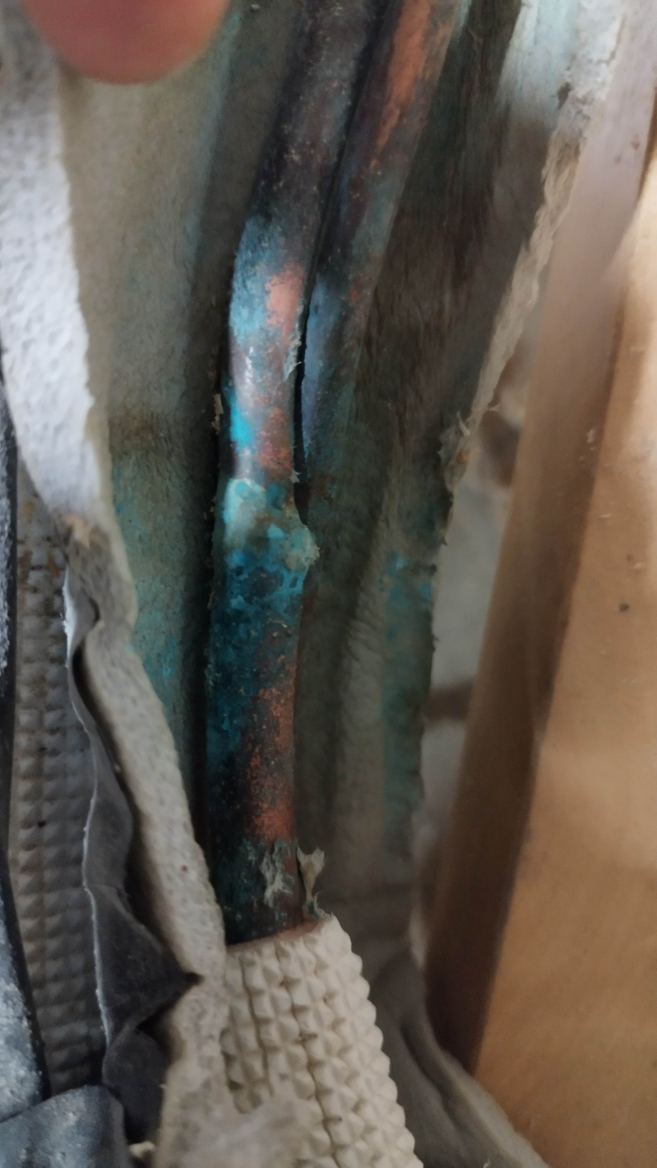

    Also make sure the installer cleans the flux off the outside of the brazed joint. I had one pinhole where this wasn't done. If you run the lineset running through a lot of studs, make sure to allow for thermal expansion otherwise it will make noise. Instead of a straight run through a bunch of studs, what I do is run it say 10' then jog a couple of inches over then another 10'. The jog now takes up the expansion. I'm pretty sure now it is common knowledge but with mini splits, but both lines needs to be insulated otherwise they will sweat.
    Instead of furring out the whole wall, if you can bring the line up from the bottom, you build a faux wood cover like this:
    https://ca.elitetrimworks.com/collections/ceiling-beams
    and make it look like a column in the corner to cover.

    Not the best picture, but that is where it leaked. Looks like the installer didn't have the right sized pipe and didn't use a flare connection.
    Looks like he shoved one smaller tube into a larger tube. This was commonly done. I have done it myself. We used line hide inside in a commercial building to cover some chilled water pipes down to some fan coil units as we couldn't get down inside the walls without tearing them apart
