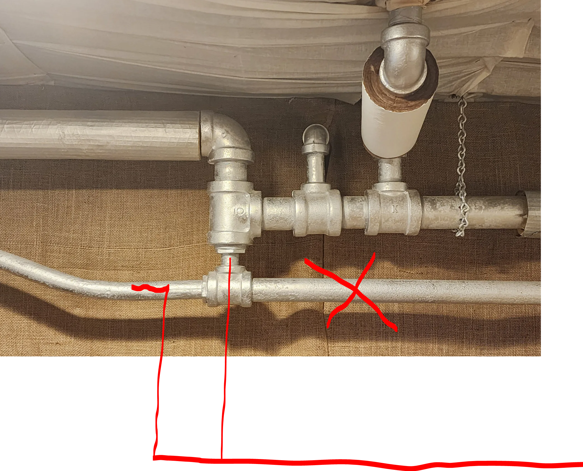

    Thank you! I will give you a call this coming week sometime! Attached are some pics. I've always thought the strangest part is that there are two pipes, one much larger than the other, that are connected at the end of the "unfavored" main (as if it's one long pipe folded in half). My guess is that the lower pipe is a dry return (???) The main itself has this odd section where it comes to a tee and takes a 90 degree turn upwards, then another 90 degree turn to continue out. The tee also connects into the dry return (???), so steam gets up into that pipe too. The two radiators whose risers branch up right before this odd configuration are two of the ones that have serious trouble getting steam. (one is on the 1st floor, the other on the 2nd). I know those main vents are undersized, but like I mentioned, I completely removed the one at the end of the longer "unfavored" main and air vented out of the stem, but it made no difference whatsoever. Still took an hour for true steam to get down there.

    Does 'A' and 'B' service more than one radiator, I suspect two ?
    I think the whole A, B, C, D pipe configuration thing was to either raise the height of the parallel flow main or provide more headroom to where pipe 'A' and 'B' are going or both. Since 'A' is higher than 'D' you don't want to trap condensate in 'D' so you need 'C' as a drip so condensate in 'D' can drain away. The problem is Steam can take both paths 'A' and 'C' to get to the Left main vent pushing out more air than is necessary to get steam to the radiators to the left slowing things down. Pipe 'C' should go from 'D' down significantly (maybe to the floor, pressure issue) and back up to 'B' to trap condensate to block the steam path but let condensate return to the boiler. Improving the venting a lot may be easy and all that is needed for that issue, changing 'C' is more work.
    The flexible gas line wrapped with black tape may be too restrictive. The burner may not be able to output its full BTU/Hr rating (as you suspect).
    Why did they install an oil boiler then modify for gas ? Was the gas conversion a later decision ?
    It looks like someone in the distant past replaced a wet return with a dry return and connected a drip that had to go to a wet return to the dry return.
    or a loop of pipe that made it a wet return was removed somewhere.

    All of the A, B, C, D stuff goes way over my head. Lol. To clarify, though, the boiler is to the right, abut 15' or so, of this weird configuration. I didn't post the photos in order following the pipes. The system is designed for two radiators off the end of the main, but I have one of them removed and capped off atm. It's been like that for over a year and the one removed is only a 3-section radiator.
    There was no natural gas line to my house yet when I had the boiler replaced. UGI came out and put the line from the street over the summer. Boiler was shot and needed to be replaced before they could get the gas line in. It was cracked, sending steam up the chimney, and I was constantly adding water. I used the new boiler with my old oil burner for the last month of the heating season. It worked better than the new gas burner.
    ETA: That lower pipe does drop way down once it's closer to the boiler.

    Would the fact that steam ends up traveling down both pipe "A" and pipe "B" once it hits this configuration, and needs to push out a larger volume of air in order to make it to its "radiator destinations" have anything to do with how slow that leg is? Like I mentioned too, the steam seems to almost just bypass the two radiators in line there, even if I completely remove the vents off of them. Eventually a couple of sections get hot, but only after an hour.

    the steam will follow both of these paths toward the vent. if the one without the radiators on it wins, the vent will close and keep those radiators from heating
    that may be part of something leftover from the original coal boiler.

    The two pipes (A & B) are connected at the end of the main on a single vent. So they can be added together volume-wise as if they were one big pipe. That's the way I think of it anyway. I'm not sure how it affects the physics of it all. How would increasing the diameter of a main towards the end of it's horizontal run affect the system, if at all? This is the end where they're connected:

    If steam travels through the lower smaller pipe and closes the Left hand main vent the only venting remaining to purge the Left main (larger pipe) is the one on the remaining radiator (the other is capped off), so everything on the Left side of the boiler is slow. Once the radiators on the faster side of the system start to condense steam causing a lower pressure inside the radiators on the Right hand side of the system, the steam movement favors the Right hand side which slows down the Left side more. If the burner is set up undersized for the boiler / system that just makes things worse.

    Ugh. Sounds like a vicious cycle. Would keeping a smaller vent on the right side main and radiators help? Does pipe "B" even really need to be there at all if the main were angled back towards the boiler? It does get hot before pipe "A"!

    Since it is a parallel flow system (the mains slope away from the boiler and a return at the end of the main brings condensate back to the boiler), if the main is raised as it moves away from the boiler, the lower section needs a drip to allow condensate to return. That drip should drop to the floor so the drip connects below the water line. There are also arrangements with u bends in the piping that could keep that elevated section full of water and stop steam from passing through it.
    I think that section may exist because the original coal boiler may have had 2 steam outlets, one of which was connected to the tee.

    It is a vicious cycle, every cycle of the boiler. It is all about balance. The mains want to be vented as fast as possible, but equally so the steam is available at the radiator runouts at about the same time. Then when the main vents close the steam can propagate evenly to the radiators at the rate the radiators are vented at.
    If you remove the 'B' pipe and raise the 'A' pipe the radiator and radiator runouts would have to be raised also so the condensate can drain.
    " It does get hot before pipe "A"! "
    The 'B' pipe has less air in it and less metal to warm up as the steam propagates.

    So, could it help if pipe "B" had some kind of P trap or a dip in it right after the tee to prevent steam from traveling up there?
    This house definitely had a coal boiler when it was built. The hole in the wall for the chute is there, but it's boarded up.
    109A_5 Posts: 4,761
    A condensate trap (deeper than pictured) placed anywhere along that pipe would stop the steam from moving through it.
