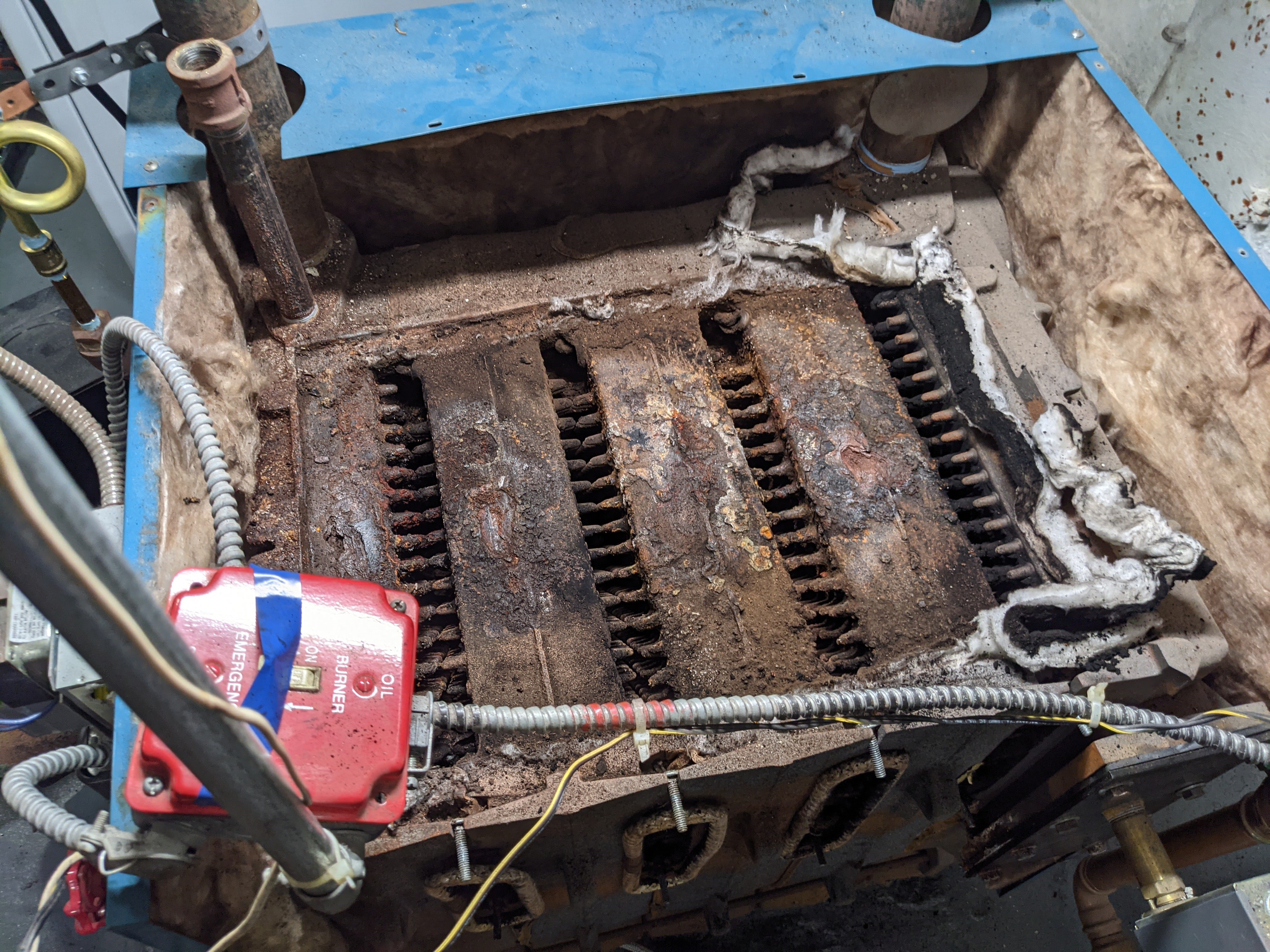

My SteamPunk boiler

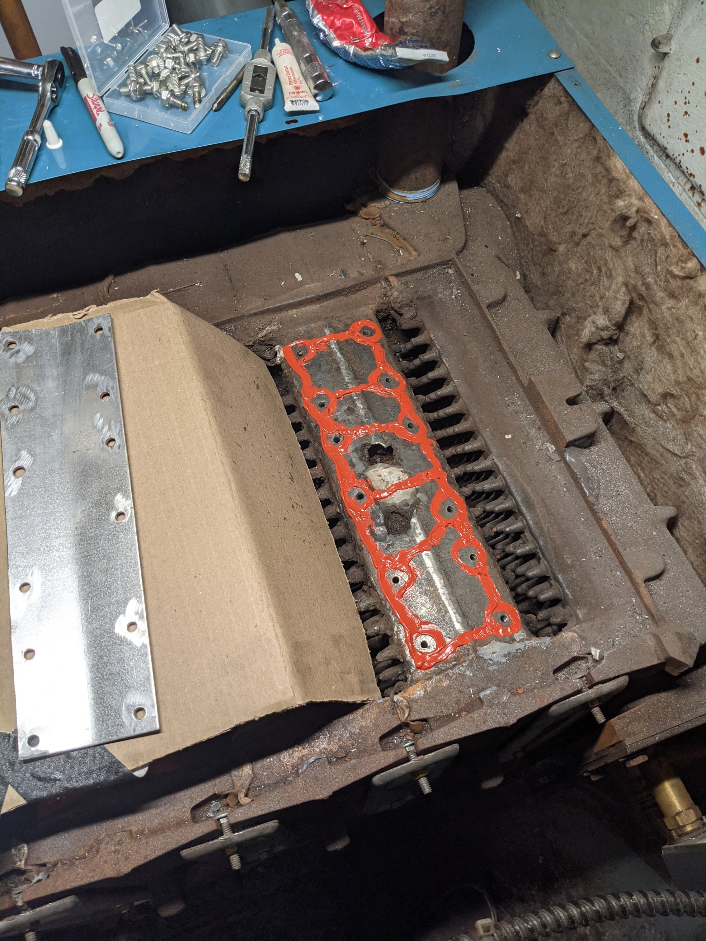

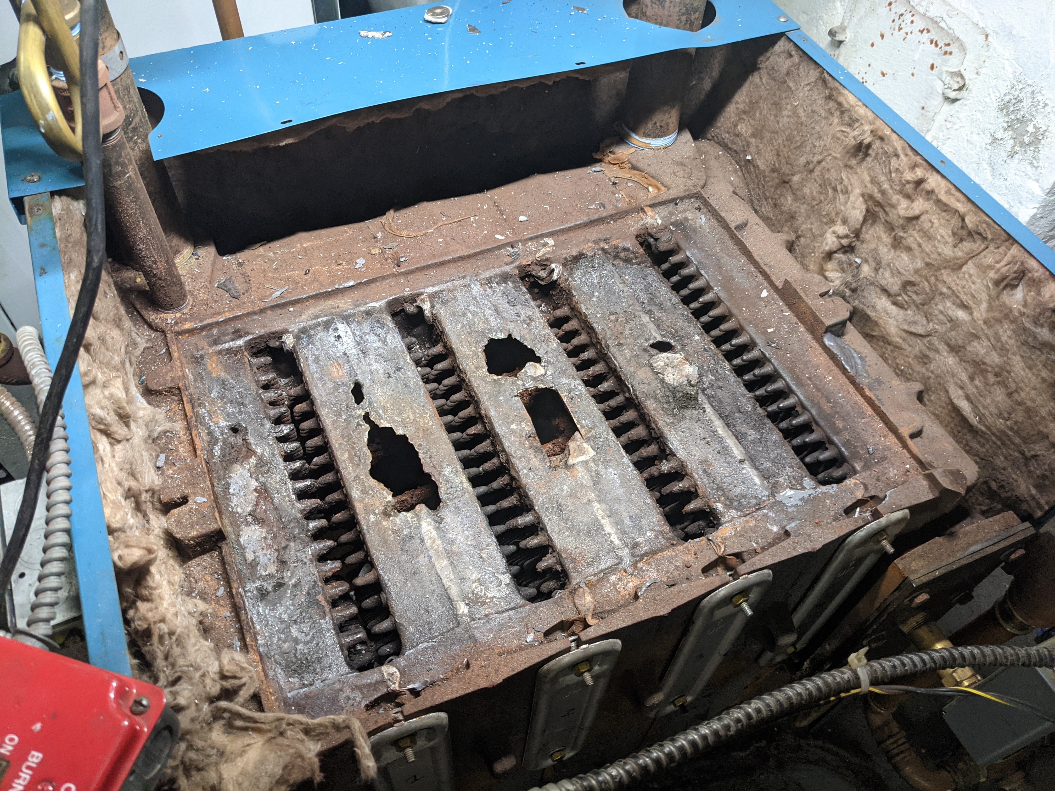

At the beginning of last winter i've zeroed out my automatics water feeder. At the end of the season it read 247… Not good!
Opening the boiler covers i saw a sorry state of the boiler's top - with huge rust holes.
I though i could seal it with some kind of steam-resistant high-temp epoxy.
I've searched long and identified some pro epoxies uses used in the oil industry. Sales rep has confirmed that it could work (key word: "sales rep"...)

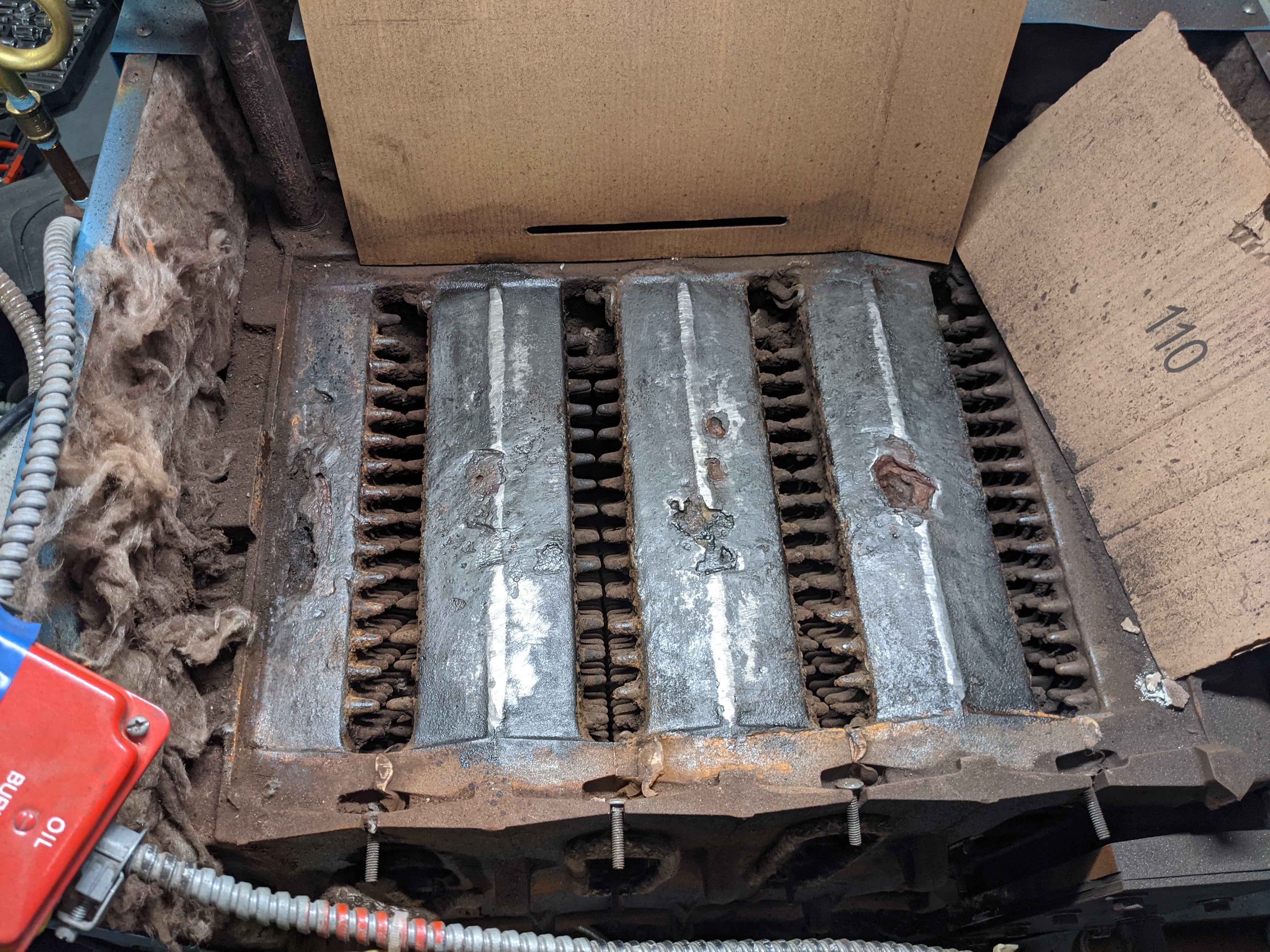

I cleaned up the surface prepping it for the epoxy. I filled the holes with the marine version of JB Weld (btw, very good epoxy!)

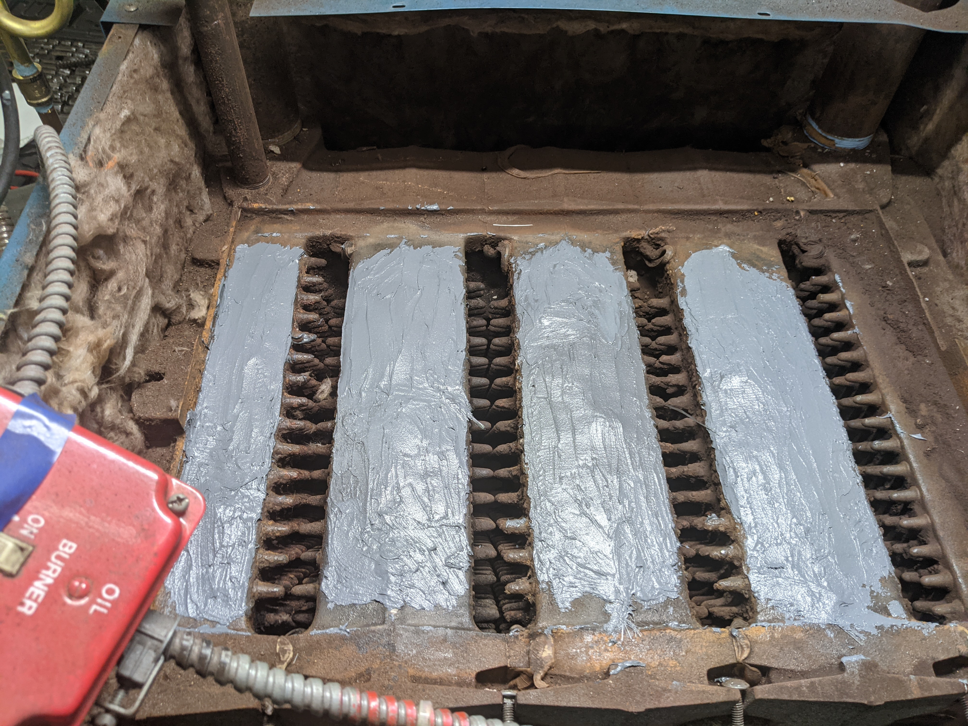

Then covered the top with the "pro" grade reinforced with some carbon mesh.
Soon i started having doubts.
In my research i didn't consider high temperature of the flue gases. Though metal jacket heats up only to around 250F, the surrounding flue gases can get to 600F (the verge of the epoxy stability).
Even before fire test, i started thinking about plan B.

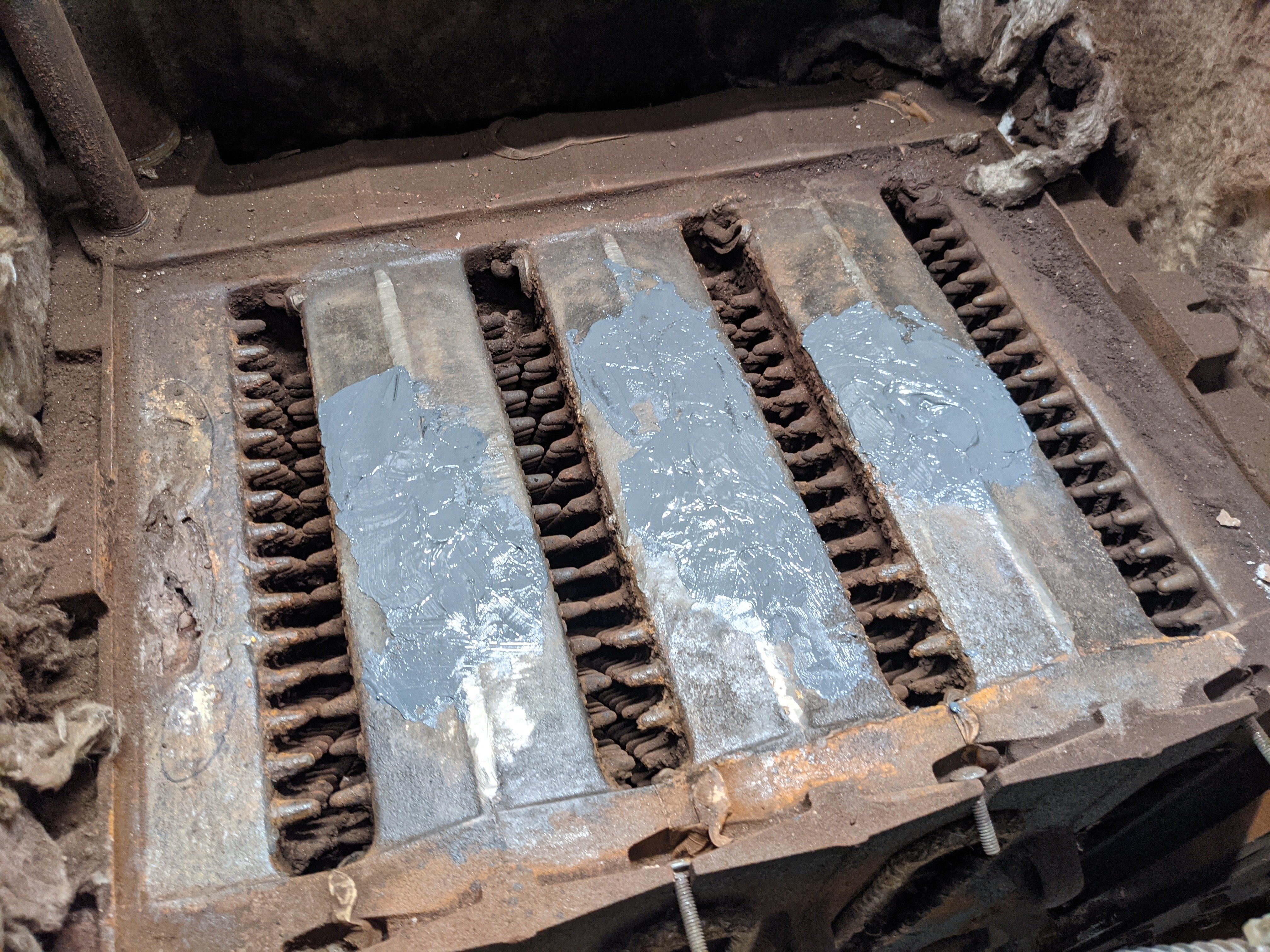

Test fire has confirmed my doubts.
The surface, despite the prep, showed epoxy delamination due to rust developing between epoxy and the cast iron. Surprisingly, the water resistant JB Weld held quite well.

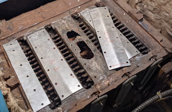

The boiler was "dead" again so i removed the epoxy and this time chose not to stop until i found some solid metal. The holes kept on growing...

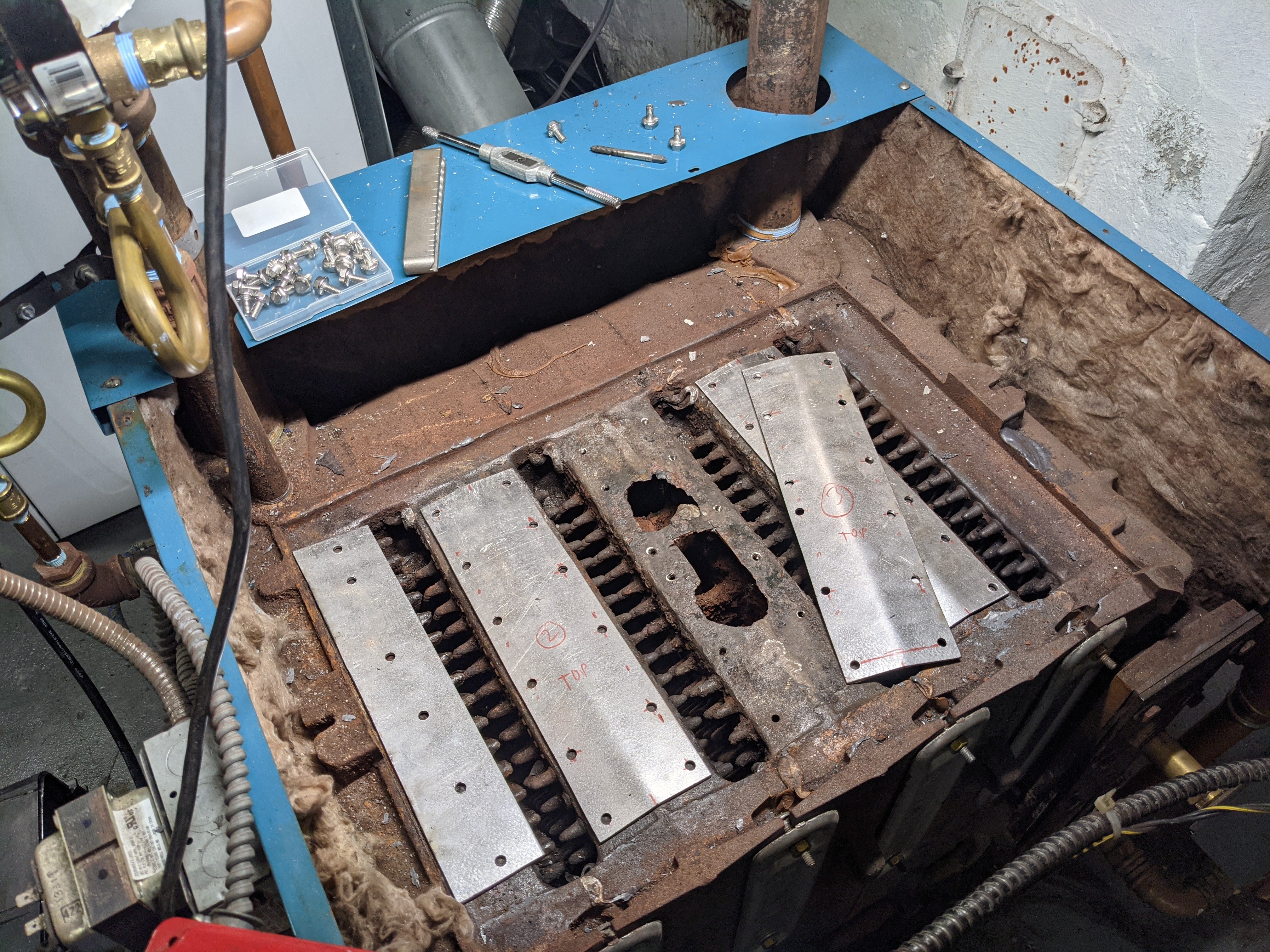

I started to think the whole cast iron section turned into a clump of rust held only by wishful thinking. That said, i started to see some hope. Some chunks were still quite thick. If i could manufacture metal plates, drill then tap some holes to hold those plates then maybe - just maybe - i could get another heating season out of this boiler.

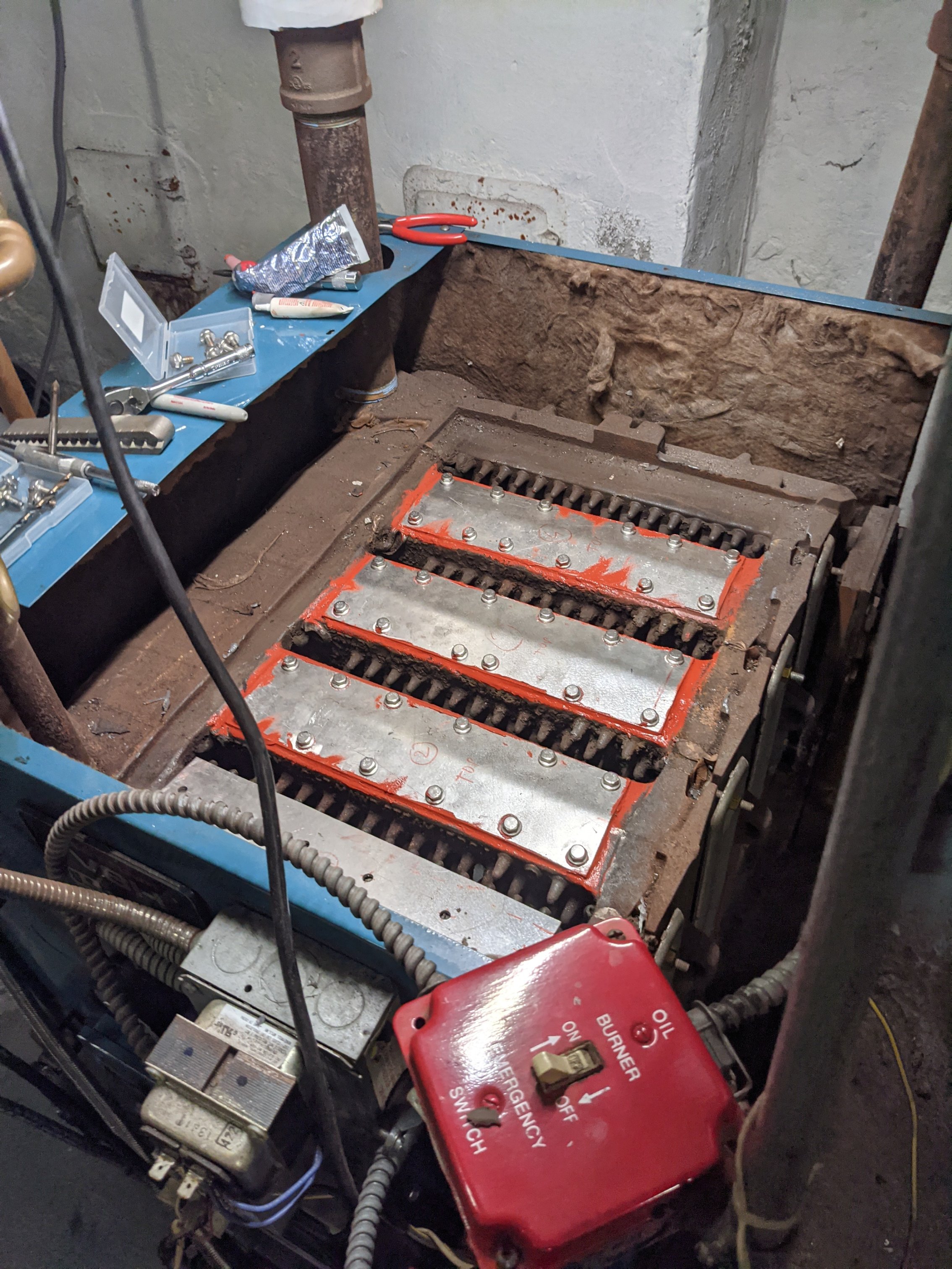

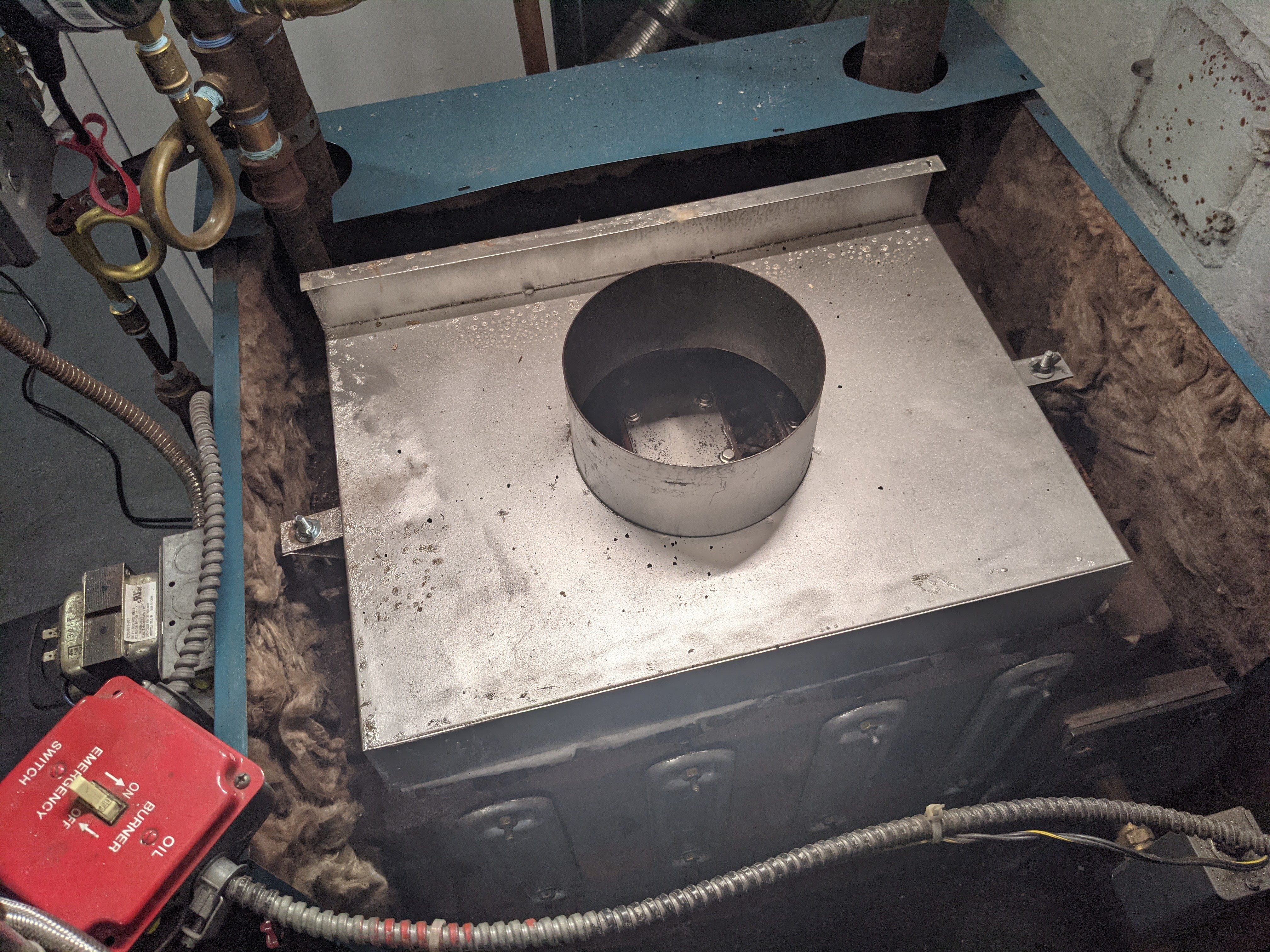

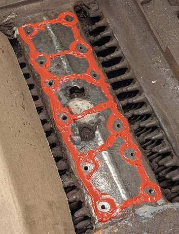

I drilled some holes in strategically located places. Surprisingly all had enough metal to tap those with at least a few threads.
Some extreme heat silicon (rated at 750F) was applied to create gasket between cast iron and metal plates.
The plates were bolted onto the boiler with stainless screws (ah, why not at this stage?).
After a few days of firing, so far so good.
Wish me luck this heating season!
(i'll update you as the months go on)

    necessity is the mother of invention. That actually looks pretty good.
    The temperature changes and different expansion rates of the two steels may cause looseness in the bolts, so maybe check their torques until you are comfortable they wont loosen.

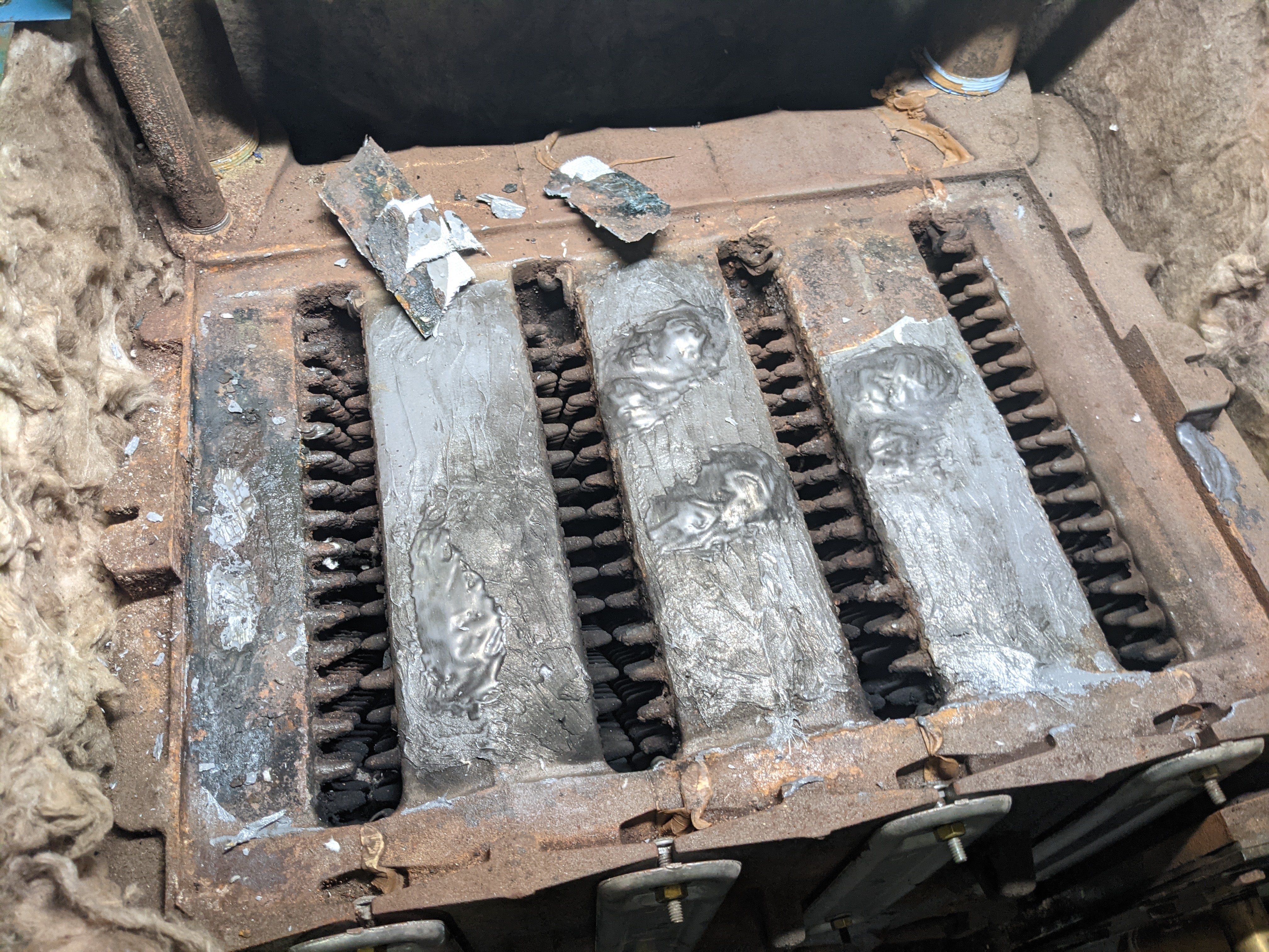

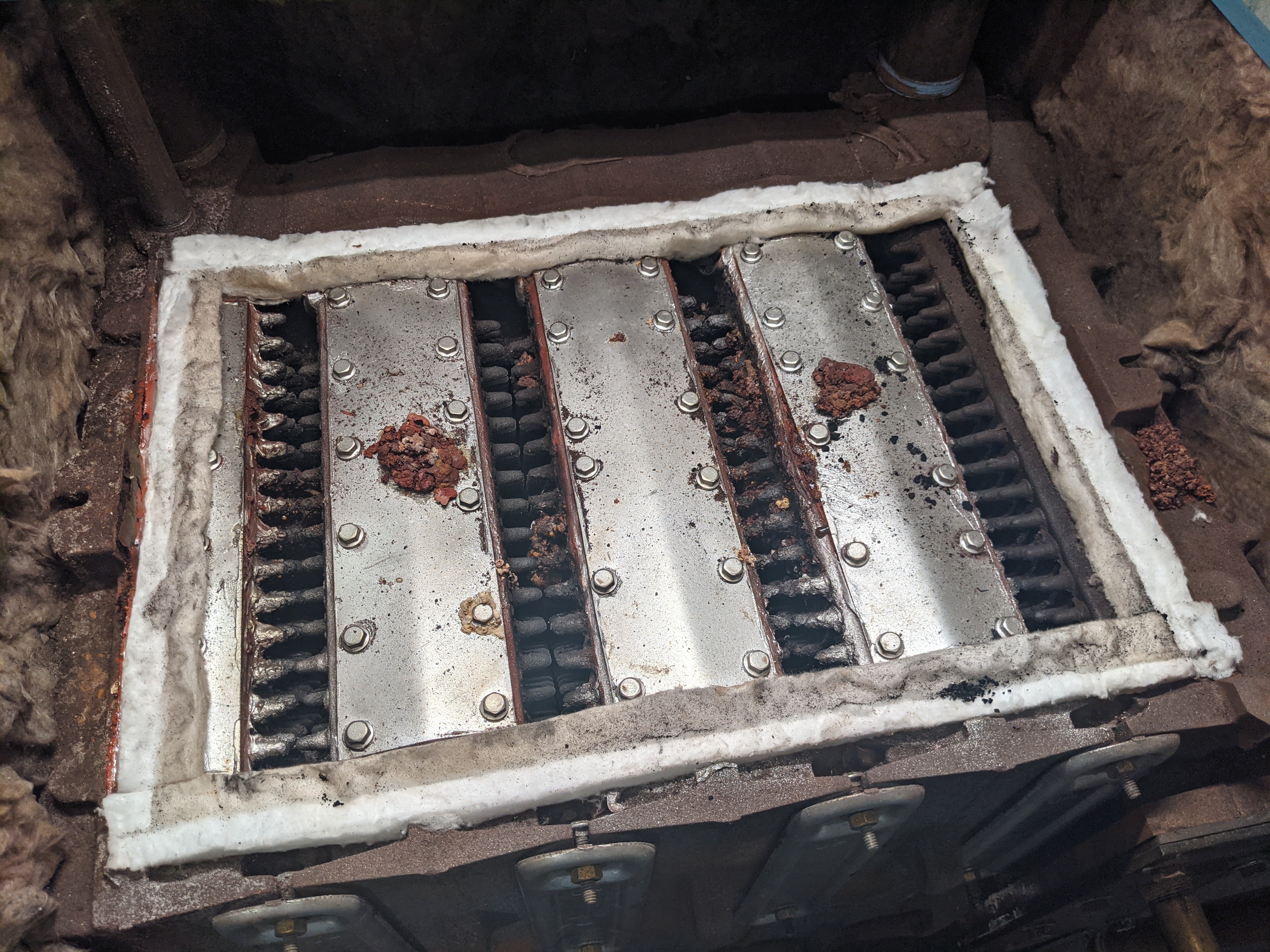

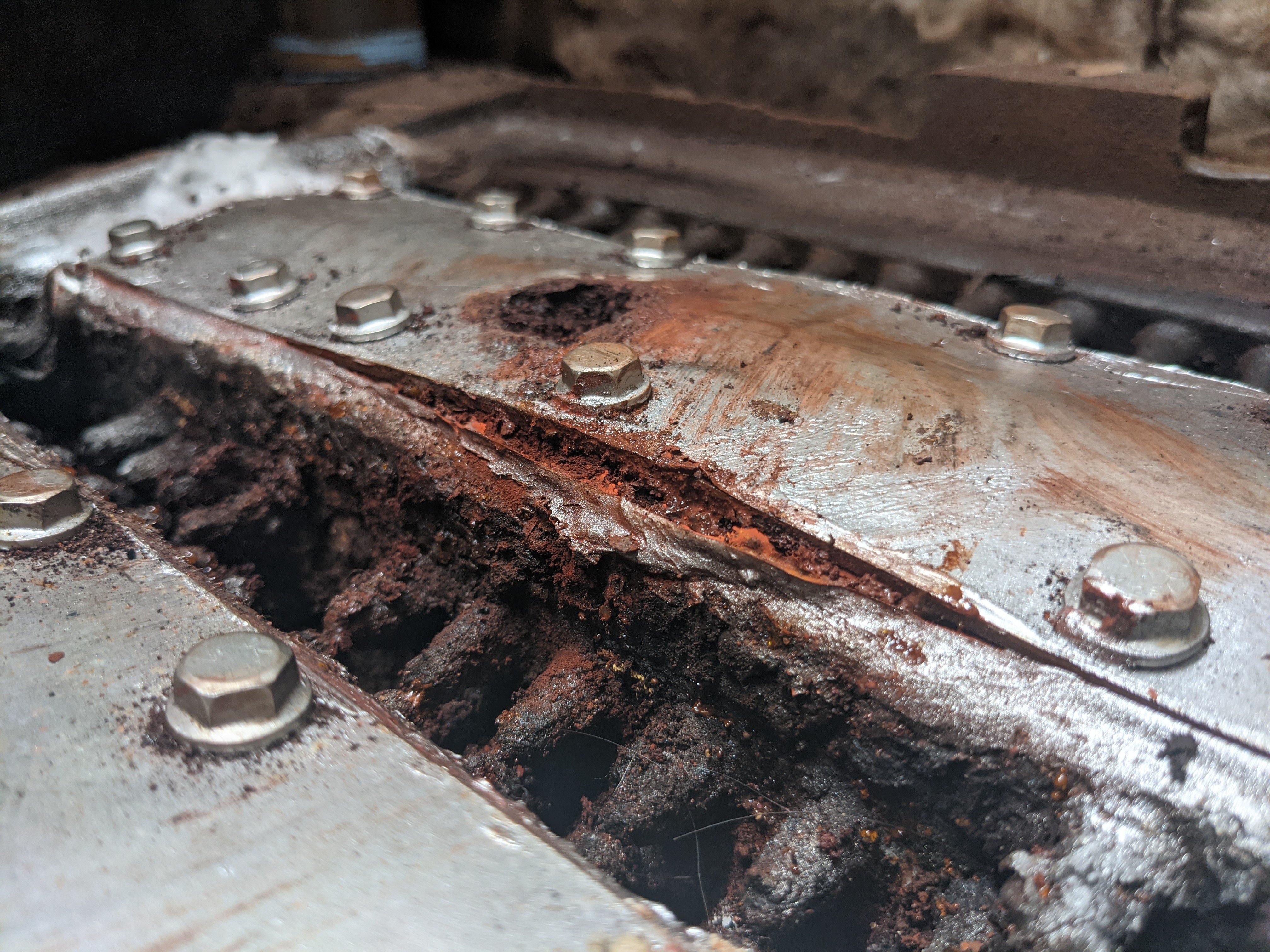

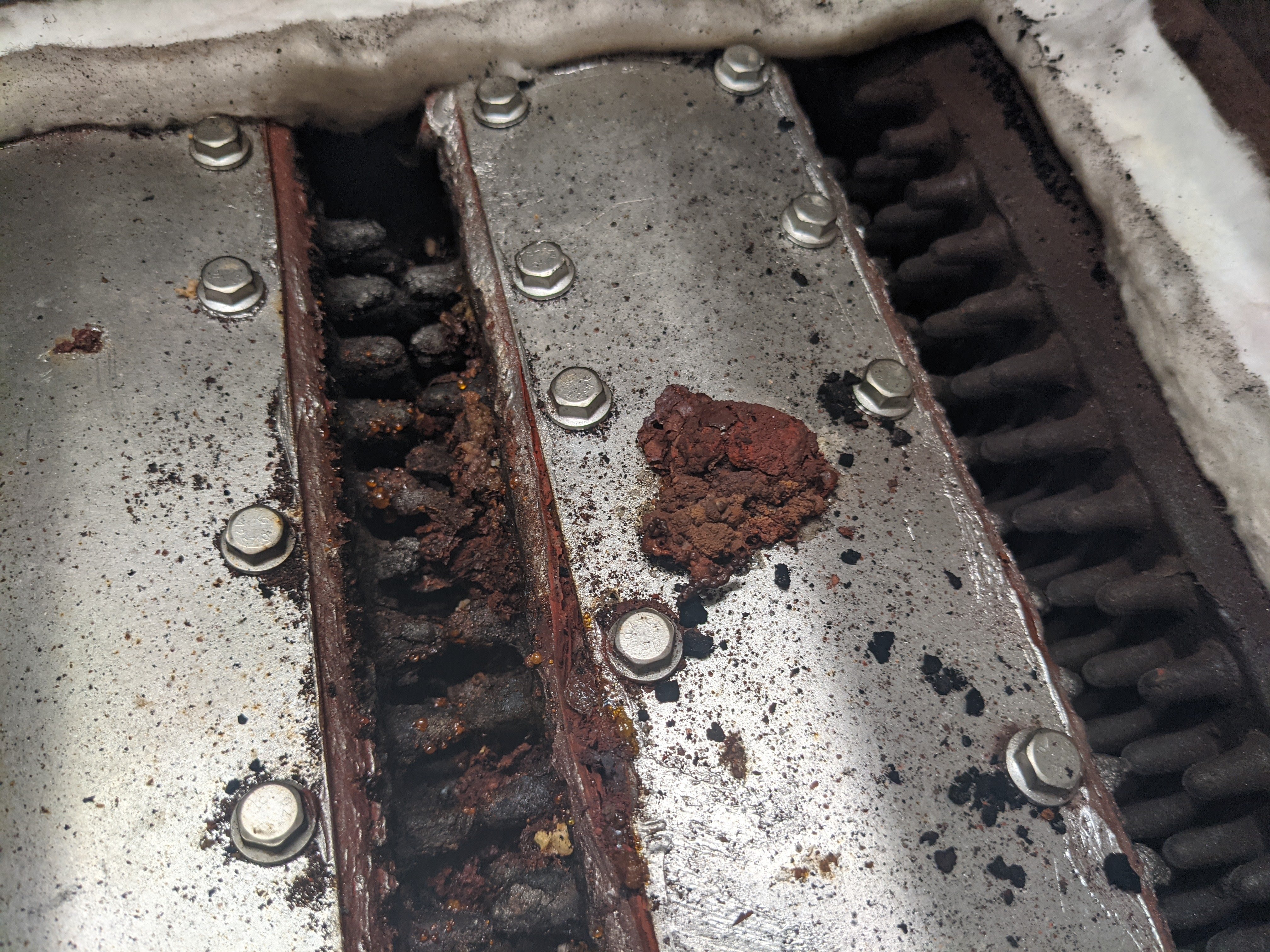

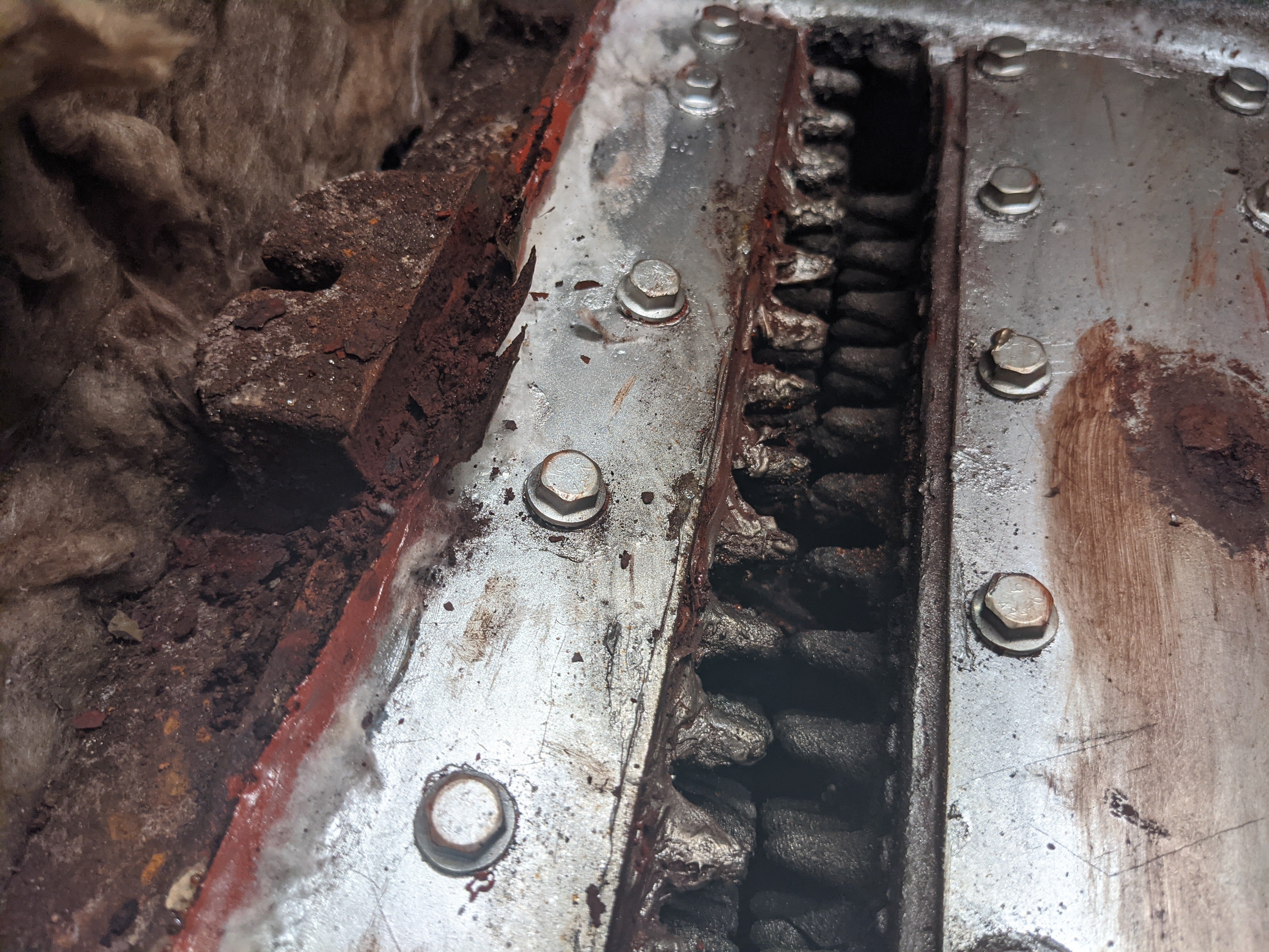

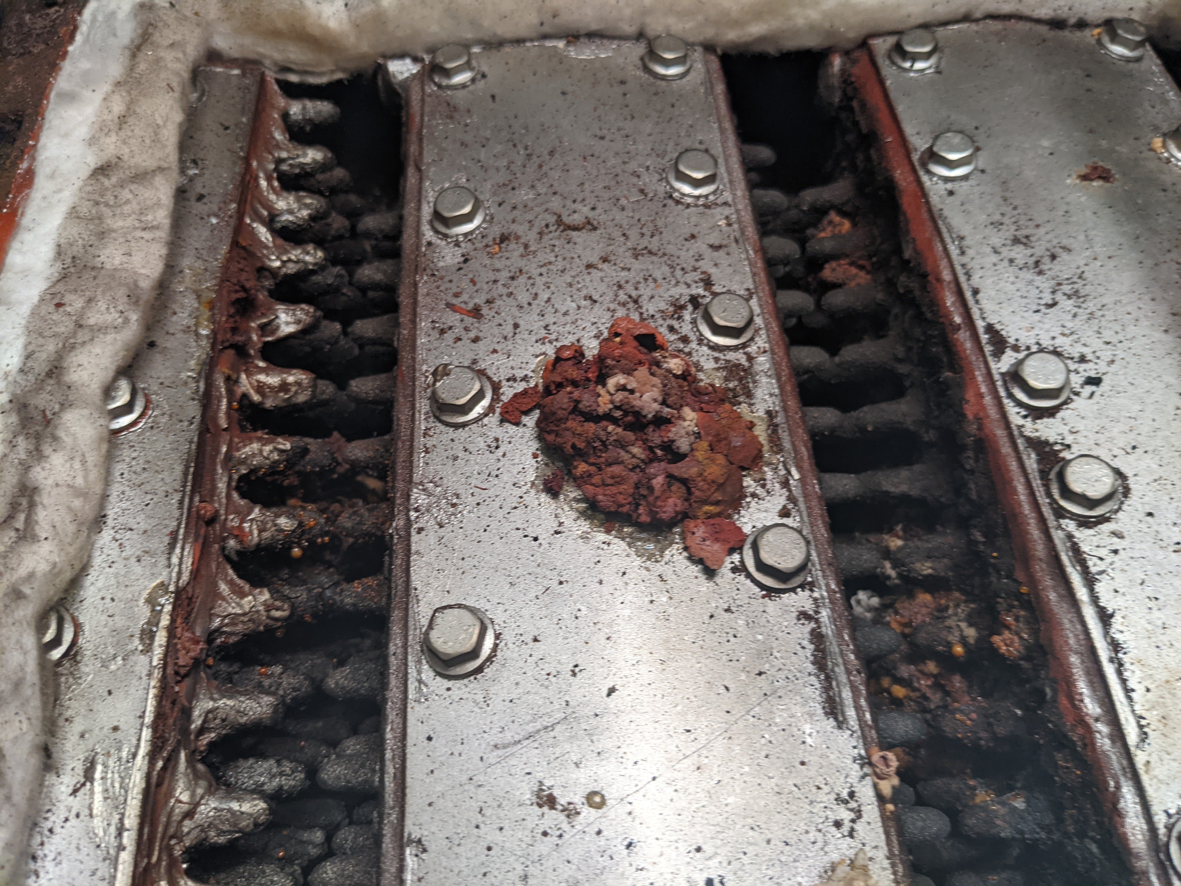

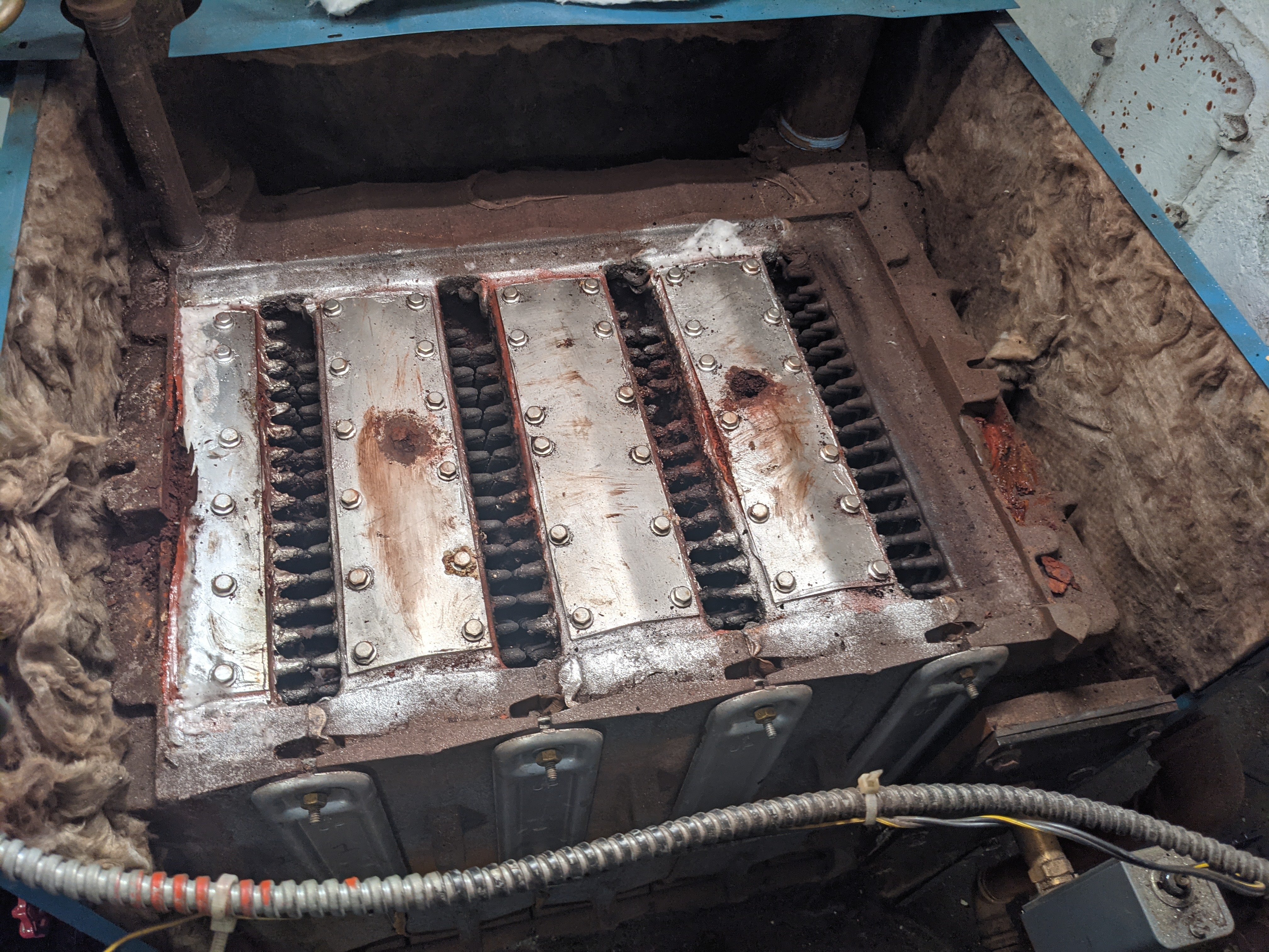

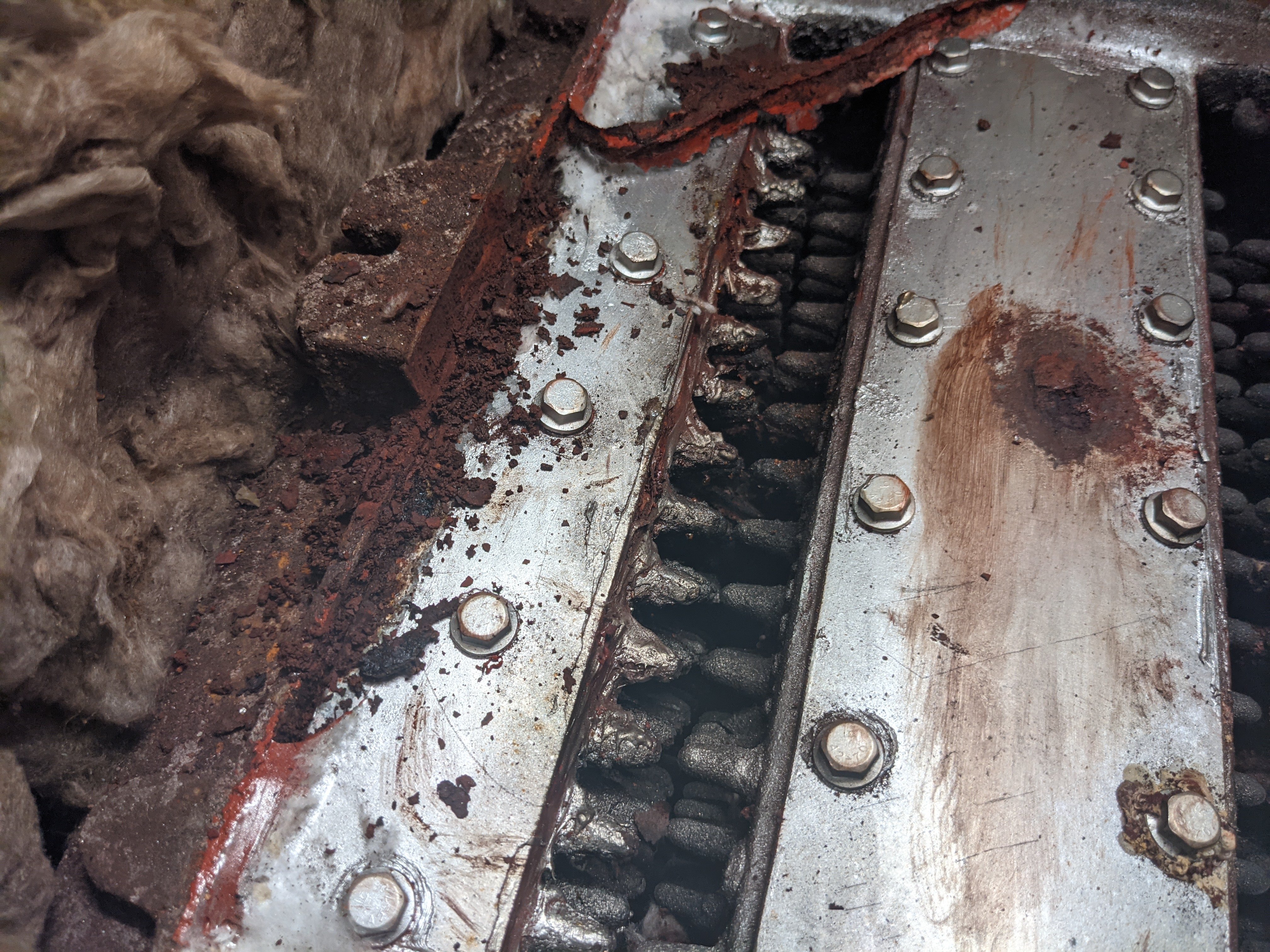

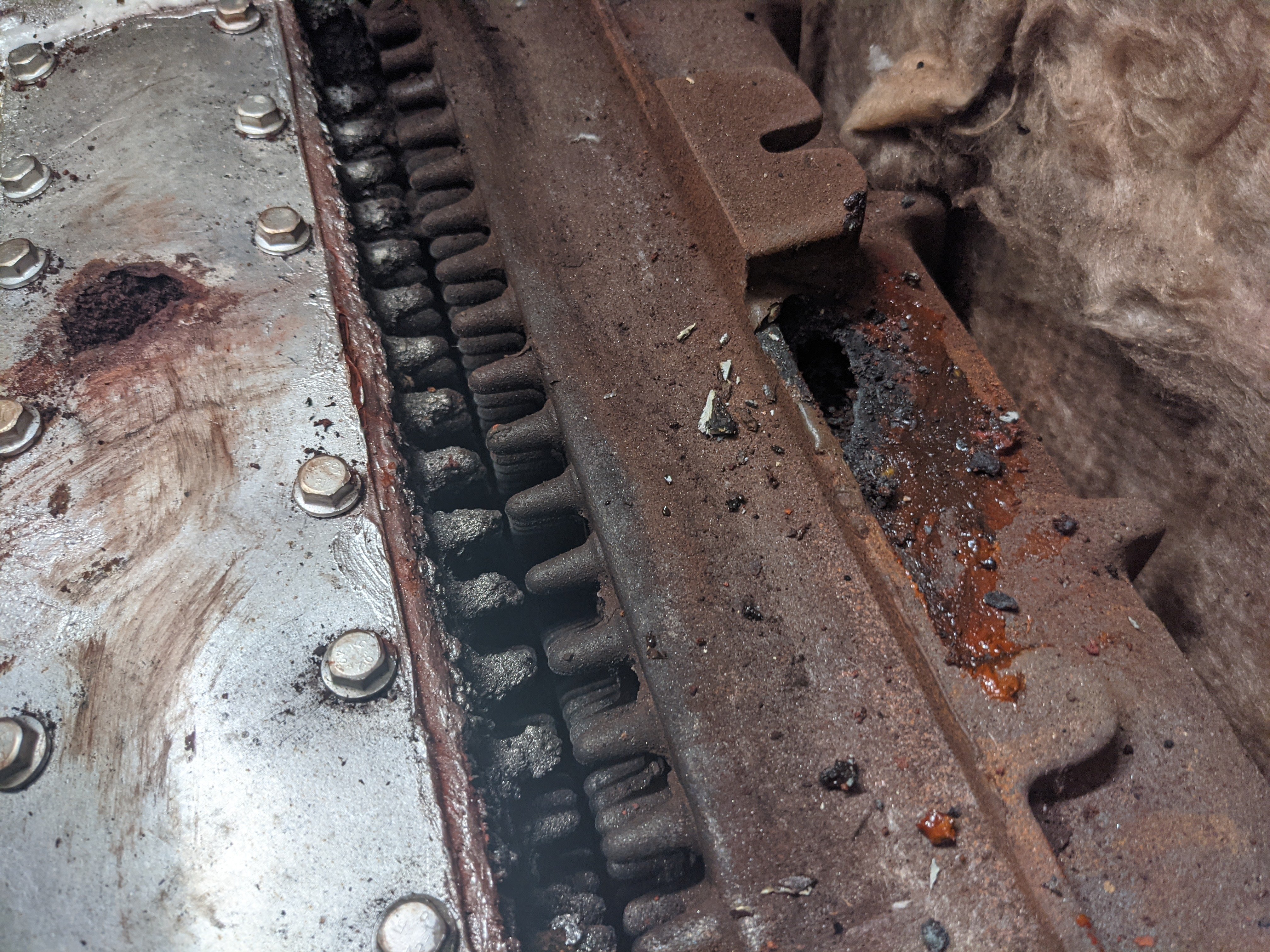

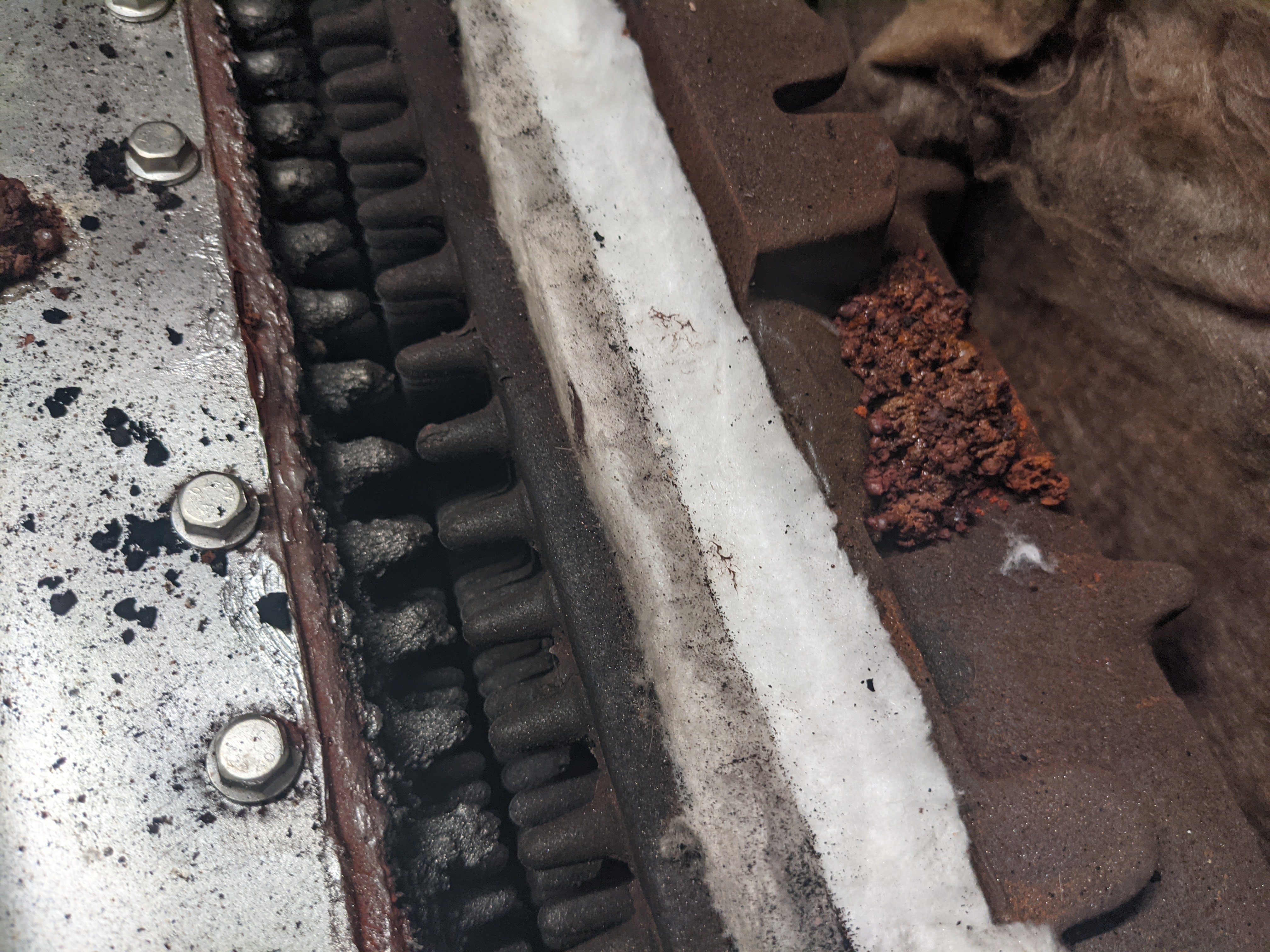

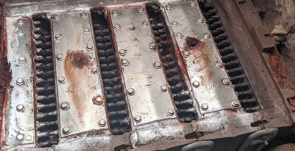

    UPDATE:
    Yesterday, since the heating season is over, I opened up my boiler to see how it held up (it has been in service the past 8 months). I knew the fix wasn't permanent because i still had significant water intake - 110 gallons during that time: some due to the boiler leaks, some to a failed vent, some due to a tiny steam leak one on of the pipes.
    A few notes:
    > The boiler rusts from the inside out, so if you see holes, there may be much more rust inside. This also means that other parts of the boiler can rust through, exposing new holes.
    > It's shocking how untreated metal plates (painted on the top but not on the bottom), about 4 mm thick, can rust through completely.
    > Rust is a powerful force—it can deform thick metal plates (see photo 7). This also means that non-mechanical repairs can fail miserably. That said, the epoxy on the right side (near the hinge) did hold up, even though the metal underneath rusted through.
    Here are the results:
    PXL_20260612_020841428.jpg PXL_20260612_020949863.jpg PXL_20260612_020952473.jpg PXL_20260612_020955506.jpg PXL_20260612_020958300.jpg PXL_20260612_021518019.jpg PXL_20260612_021522844.jpg PXL_20260612_021526138.jpg PXL_20260612_021648526.jpg PXL_20260612_021651419.jpg

    the plate rusting through probably in part is because of the huge amount of fresh water it is still taking on. that will happen to the piping too so you probably want to replace the boiler and fix the other leaks asap.

    I take it the sheet metal was not stainless ? I would have used stainless steel sheet metal. It would not stop the CI from rusting but it may have stopped (or slowed down) the holes through the sheet metal.
  • patrykrebisz
    patrykrebisz Posts: 168
    edited June 13
    If i had to do it again:
    1. Skip epoxy
    2. Drill and tap + high temp silicon (as i did)
    3. Paint the metal plates both on top and bottom.
    4. Understand that you will get 1 season out of this repair, but that's about it. (notice the red bubbling on the sides, indicating that even if the plates didn't rust through, other parts would open up.
    you can pack lead wool in the hole too instead of putting a plate over it.
    109A_5 Posts: 4,759
    What paint did you use ? It seems to hold up well to the combustion gasses. I wonder how well it would hold up inside the boiler.
    I'd maybe skip the paint on the sheet metal and use stainless steel sheet metal. Then the issues is minimizing the CI rusting where the corrosion was cleaned off for the sealing of the heat exchanger. I'd probably coat all shiny CI with the high temp silicon, not just make beads to seal the heat exchanger. Help mininize the rust jacking.
    the top of the casing probably doesn't really get all that hot, probably not a whole lot above 212 f because the mass of the casting takes the heat away so high temp paint would do great there, even ordinary paint would probably be ok.
    109A_5 Posts: 4,759
    Hmmm… Why did the center section patch hold up better than others ???
