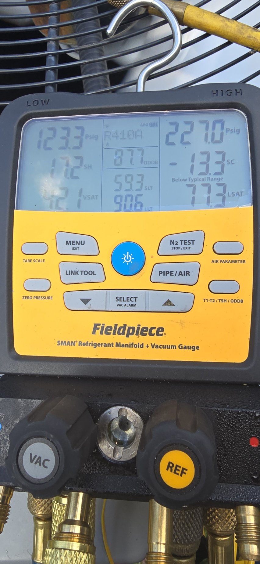

I was doing a p.m. on my year and a half old unit. it's a Grand Air 3 and 1/2 ton. I have a normal suction pressure slightly high superheat and a negative subcooling. Head pressure is also low.
The system is cooling perfectly.
123.3 psig
17.2 SH
42.1 VSAT
59.3 SLT
74 ambient inside
227.0 PSIG
-13.3 SC
77.3 LSAT
90.6 LLT
87.7 Ambient outdoor
I did a pump down on the compressor. it would only go to 4 PSI. At 40 psi the compressor started to become noisy and rattled.
I am leaning towards a week compressor or a bad TXV. Your thoughts would be appreciated

    The bulb for the TXV is in the correct position and insulated? Any static pressure readings? Fan on low speed, or a high MERV filter?
  • The bulb is insulated and in the right position. I haven't taken a static reading at this point. The fan is on high speed. I opened all returns and removed filters.
    I am running a 18.5 degree split

    Did your gauge kick the bucket? Is this AC or HP?

    Where are you taking the measurements? Pictures

    Somehow the gauge has to be wrong. How can the evap side be good when the condensing side is so low?

    The gauge is saying the saturation temperature is 10* below ambient, then it warms up to a few degrees above the ambient as it goes thru coil! ? ! ? Guess I am missing something…
  • JMWHVAC
    JMWHVAC Posts: 134
    Is that condensation on the high side of gauge set or just the way the surface looks on pic?

  • It's straight cool. Guages are a month old.
    Never pumped the compressor into vacuum.
    It's not condensation just a glare from the picture.
    I just hooked up my old sman 380 to verify that there's not an issue with the new guages. I'll let you know.
    At this point I'm leaning towards an internal issue with the compressor or a restriction at the txv. Checked the drier is not restricted
  • Okay update. hooked up my old s-man 380s got normal subcooling 9. Which told me my new 482s had a problem. So so I did a factory reset on my new gauges and got correct readings.
    I would not haveI would not have guessed that a brand new set of gauges would be doing that. That explains why I never seen settings like that before.
    My thanks to everyone that contributed.

    the first red flag was - sub cooling

  • I totally agree. I have been doing this for a while and have never seen it. I wouldn't think that a set of gauges out of the box would do that. My old s-man 380s were completely reliable never failed me. Only replaced them because the display is wonky. Thank you for your help
    Glad you found the issues.
    Sometimes old tools are better than new shiny tools. It like having a multimeter that doesn't work. If you can't trust it it leads you down the wrong path
    Not even looking at the sub cooling if the OA is 87 your liquid saturation can't be below that temp but its 10 degrees less. LL temp of 90 seems low with an 87 OA so the whole high side seems wrong. But you already found the issue
