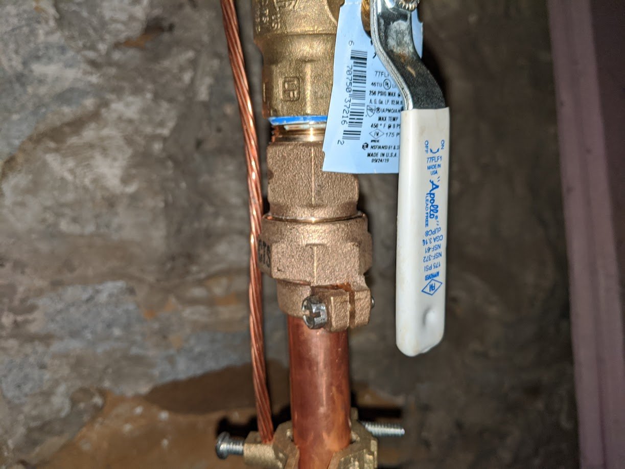

    Code does not allow you to bury a soldered line regardless, so it would need to be brazed.
    That said, I'd use either hammer flares or pack joints or similar. That's what's typically done on water service lines.
    https://www.supplyhouse.com/Legend-Valve-313-204NL-3-4-Pack-Joint-CTS-x-MNPT-Coupling-T-4300NL-No-Lead-Bronze
    https://www.supplyhouse.com/Legend-Valve-313-214NL-3-4-Pack-Joint-CTS-Union-T-4301NL-No-Lead-Bronze
    I even used one in my basement rather than soldering it because it seemed like a really good connection and could easily be worked on. It's a compression joint with a very thick heavy rubber gasket and a metal clamp that secures the pipe. I believe they're called pack joints because they used to use lead packing.
    These aren't cheap cheesy compression fittings, they're literally what water companies use for this work.

    How much copper -K- type tubing will you need for your hose? If you need to make a joint, consider using a compression joint suited for a buried water supply, or better yet, a full length of tubing with no joint at all.

    You want type K soft.
    It comes in a roll. Make sure you use a PVC sleeve anywhere it goes through concrete etc.
