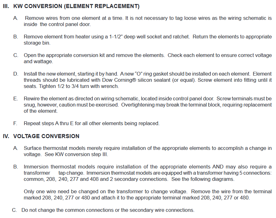

    all you need to do is move a wire
    kcopp
  • mikedo
    mikedo Posts: 302
    and it changes it from 277 to 240
  • Mikedo is correct. Government regulations don't want you to have a 66, 80, or 120 gallon electric water heater in your house, so the mfg's consider these "Light Service" commercial heaters. They ship as 277 volt single phase, 12.2kW wired simultaneously. Moving around a couple of wires gets it back to 240v 4.5kW. The stickers are for the next guy to work on it.

    thanks karl you can download the insrtuctions online for free and use a sharpie to write on it that it has been converted . just another example of how manufactors dont care about trades people just how much money they can make off are hard work

    Good morning, folks. I work for Laars. We are asked frequently for conversion instructions and stickers. Either the contractor wants an "official" one from us, or an inspector does. When someone needs an instruction sheet, we offer to email a pdf, but still some people want a "real" one shipped. I know it seems like a very small thing, but there are real costs associated with selling these. Just like contractors have costs that people may not think about like insurance, training, employee benefits, stock, vehicle registration/maintenance, etc. We pay a vendor for these items, and pay people to order them, receive them, store them, pick them, pack them, ship them, etc.. No different than the process to get controls, gas valves and blowers, etc., in house and out to a job.
