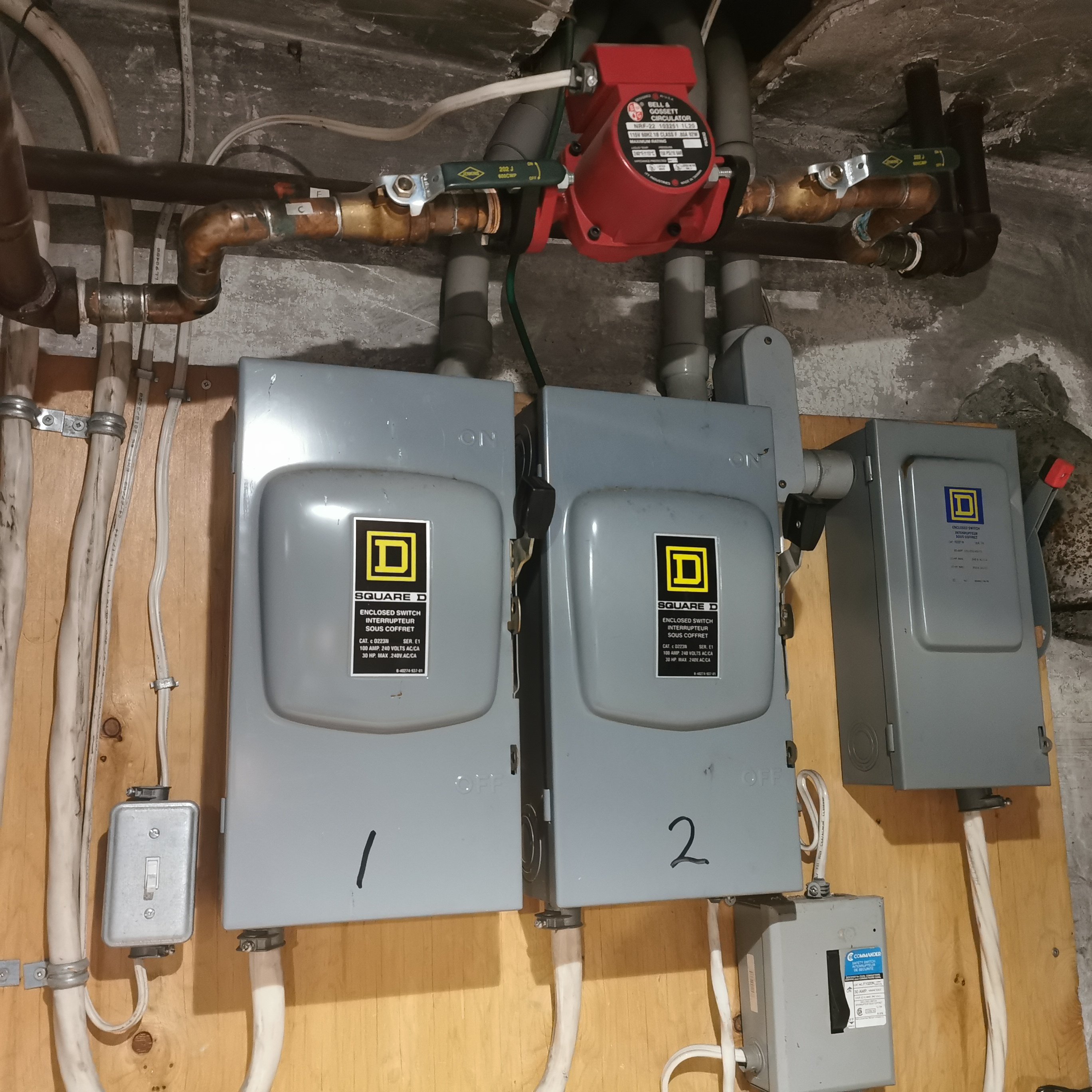

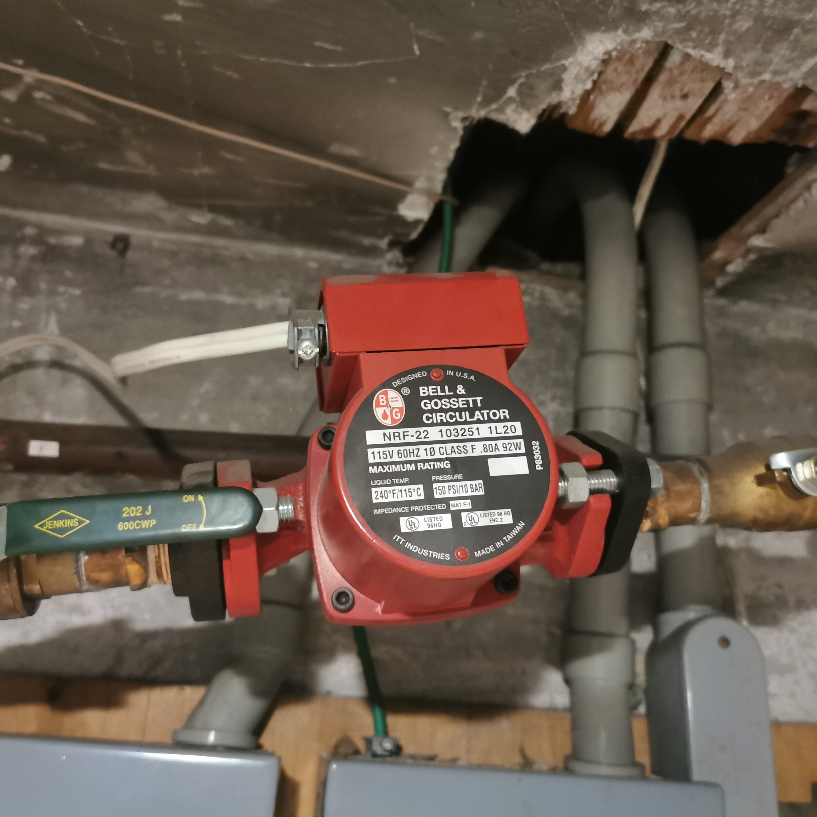

I turned off the power to a unit for a few days so I could do some wiring. Then I turned it back on. To turn on/off the power to a unit, you pull the switch for the corresponding unit as shown in the first photo.
A day after turning it back on, I heard a whirring noise while I was on the main floor, which is directly above the basement panel room. It was loud enough that I thought the noise was coming from the street. But eventually I traced the source of the noise back to a Bell & Gossett circulator situated in the panel room. This circulator is controlled by the same panel 2 that I have been turning on and off as I run wiring in that apartment. Not only was it making noise, even though the furnace is shut down and awaiting removal, so it shouldn't be running at all, it was very hot to the touch. I was able to turn it off with the switch situated to the lower left of panel 1 while restoring power to apt 2.
I don't know why this is occurring. I don't think it's anything benign or that can be ignored. I don't believe I did anything to cause it - I never touched that wiring or the circulator during the work I was doing. Does this mean the circulator is bad and needs to be replaced? Or is there something else that could be causing this issue?
Close-up of circulator:

    " the furnace is shut down and awaiting removal" (if the heating system uses a circulator, its a boiler) if the "boiler" is being removed it's possible that supply and return valves are shut and the circulator is being dead headed. I would follow the pipes on each side of the circulator and look for shut valves for starters.
    But seriously if the system is being removed/replaced that circulator should not have power to it.

    hot_rod Member Posts: 27,904
    Sounds like it could be low on water? What is the boiler pressure? 10- 12 psi is common.
    That is a water lubricated circulator, so it needs to be filled and air free.
    You can dead-head those circs for a short period, eventually they can boil the water out of the volute then you are running dry.
    A leaking relief valve is often traced to a failed or water logged expansion tank, or a fill valve that is leaking past.

    Just shut the circulator off using the white toggle switch (lower left of panel 1) when servicing the boiler. It is being controlled by a thermostat or an aquastat. It NEEDS to have WATER in it and NO AIR and most preferably water moving THROUGH it while running. It is lubricated with water. It looks to be "brand, spanking, new".
  • sjh
    sjh Member Posts: 70
    I'll do that from now on. This time, to deal with the leaking relief valve, should I drain the expansion tanks and then replace the relief valve?

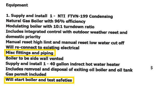

    There are 6 zone thermostats for the hydronic system. The boiler itself has a gauge or maybe that's also called a thermostat. I'm pretty sure the new boiler will come with a new gauge or thermostat.
    The contract doesn't say anything specifically about any expansion tanks. There's a line about 'Misc fittings and piping' which I could bring up, but they might say that's not what it's referring to.

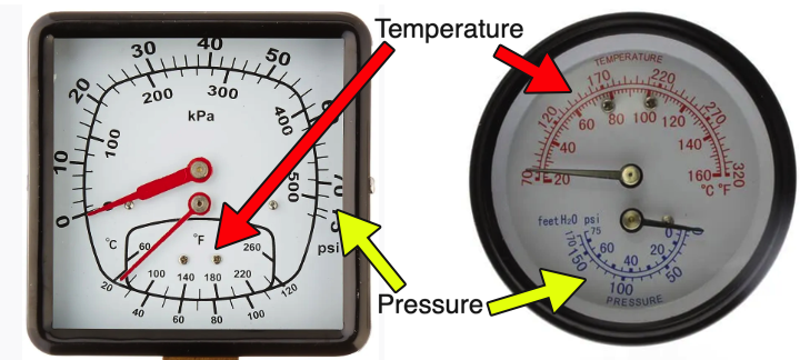

    @sjh said: "The boiler itself has a gauge or maybe that's also called a thermostat."
    This is a gauge with a thermometer to tell you the temperature of the boiler water.

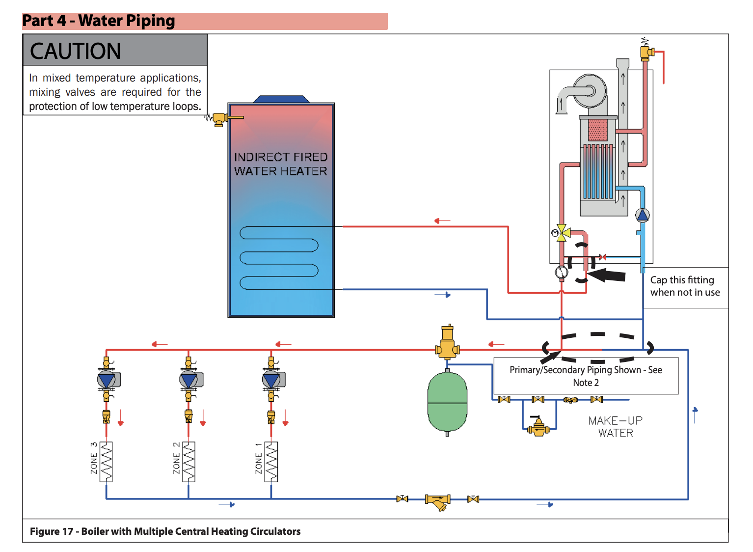

    Looking at the NTI boiler you selected to purchase, there is a relief valve included and there is a circulator pump included within the boiler.
    Now if you could look at the Installation manual, and the fact that you indicated that you have more than one circulator pump (6 pumps for 6 zones) and perhaps a water heater that is another zone that is heated by the new NTI boiler this is the piping arrangement that you would want the installer to follow.

    Since you have an indirect water heater (indicated by the DHW priority in the contract specifications) I am guessing that since the oil tank is empty, you have no hot water in the building. If you still have hot water, then there are some contrary information herein.

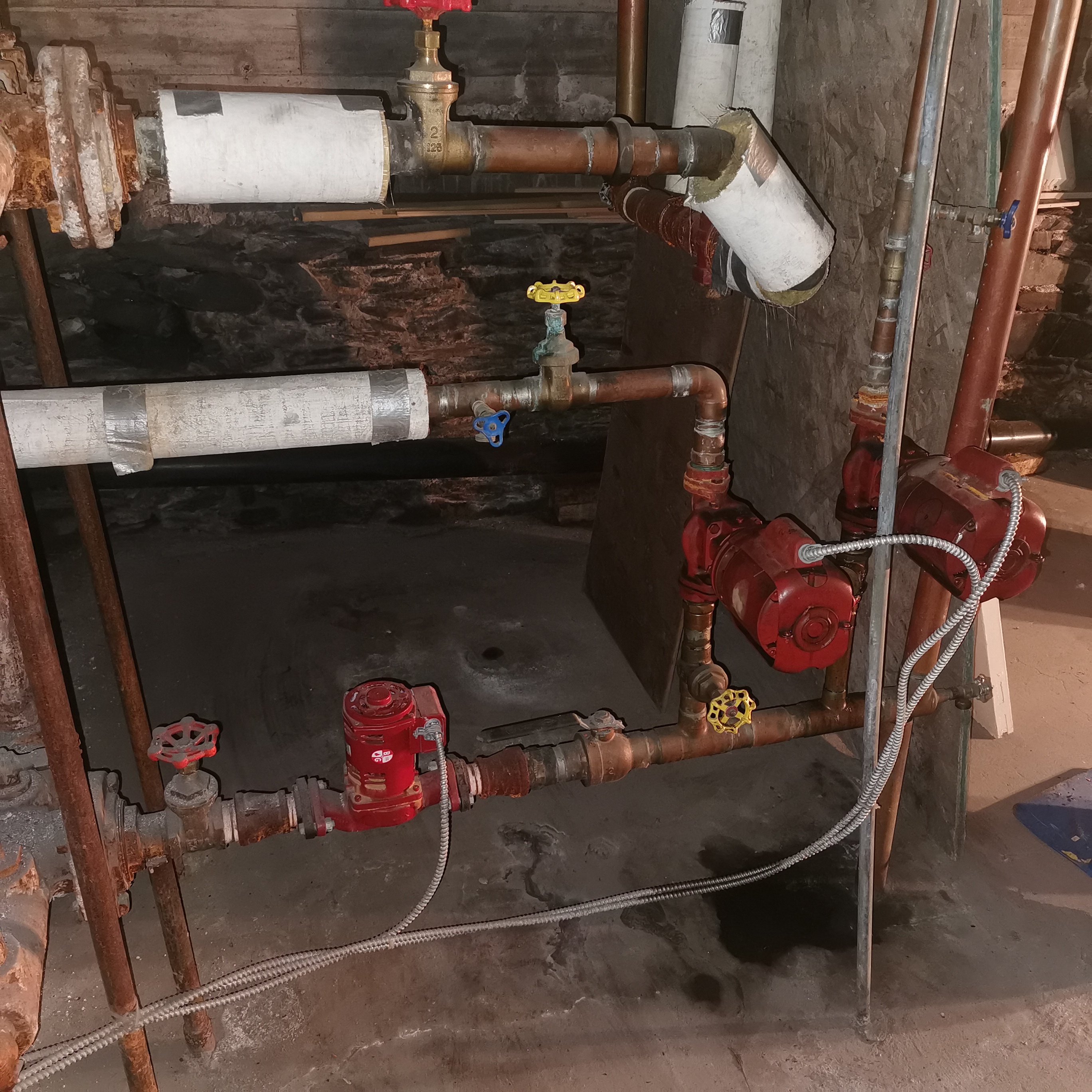

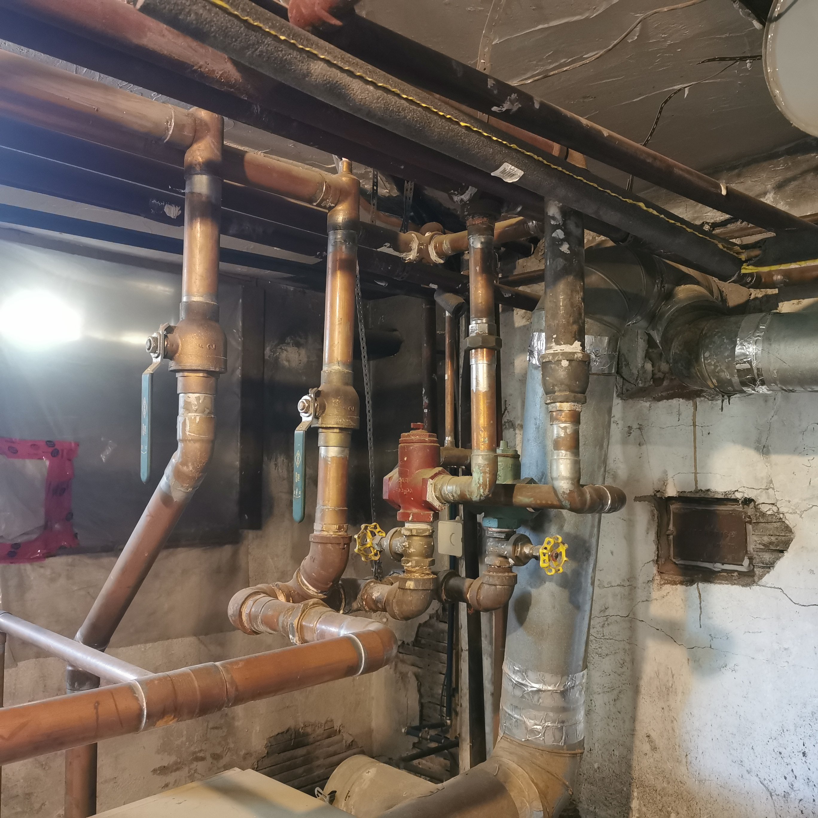

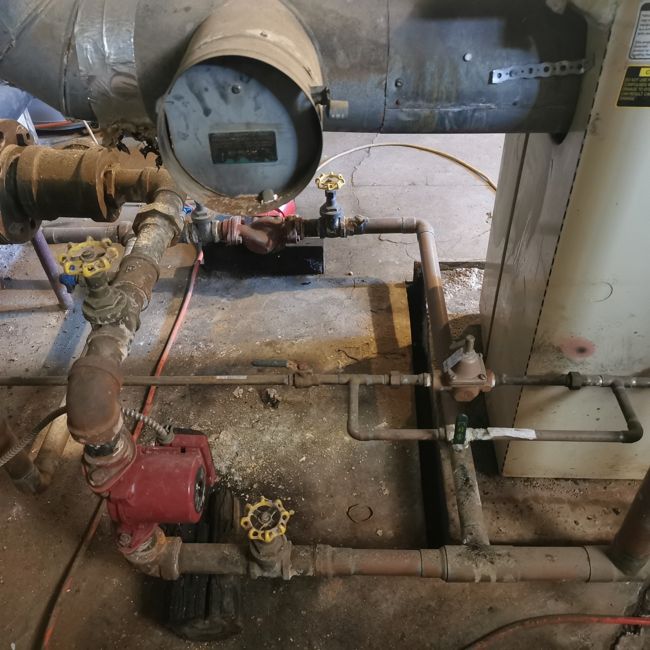

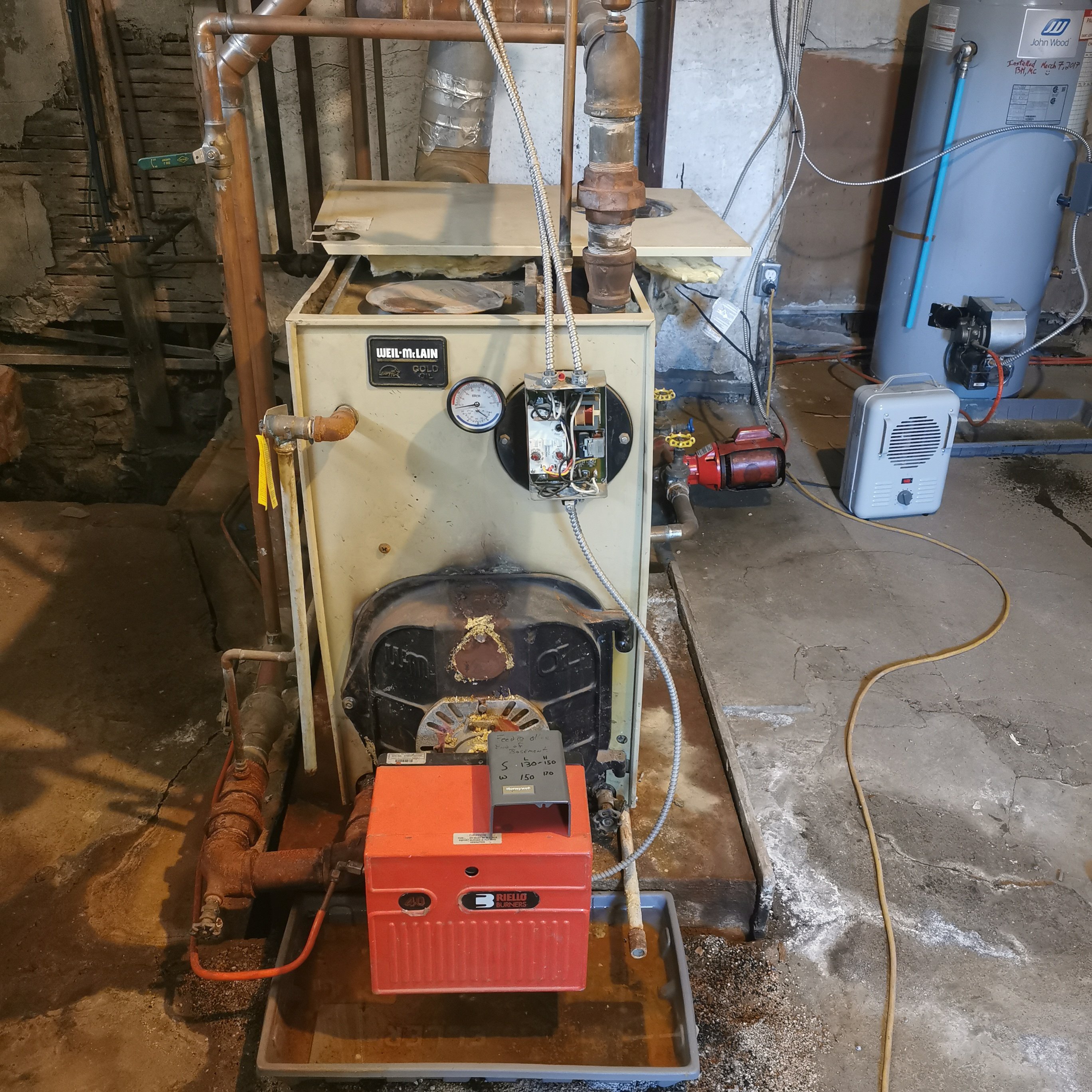

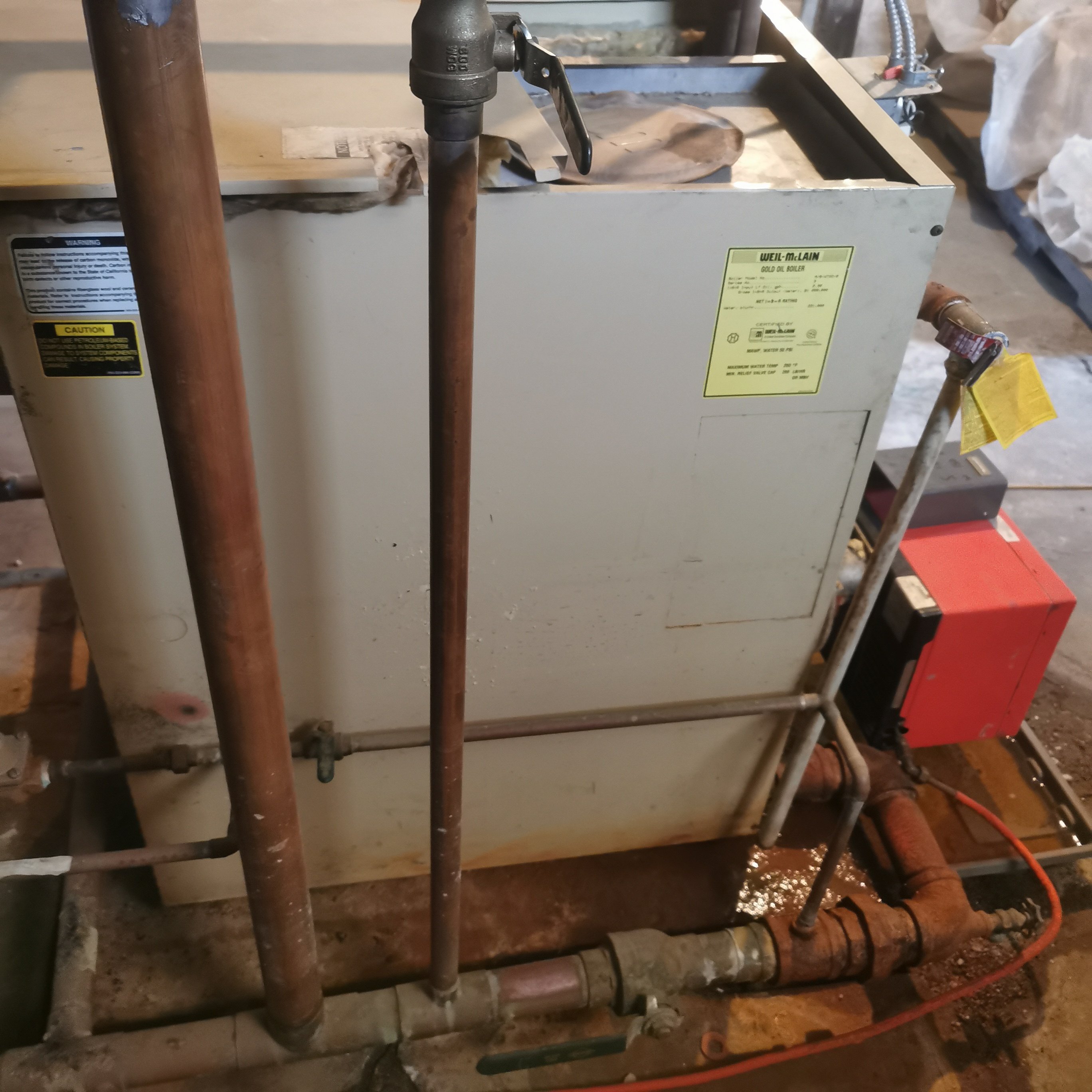

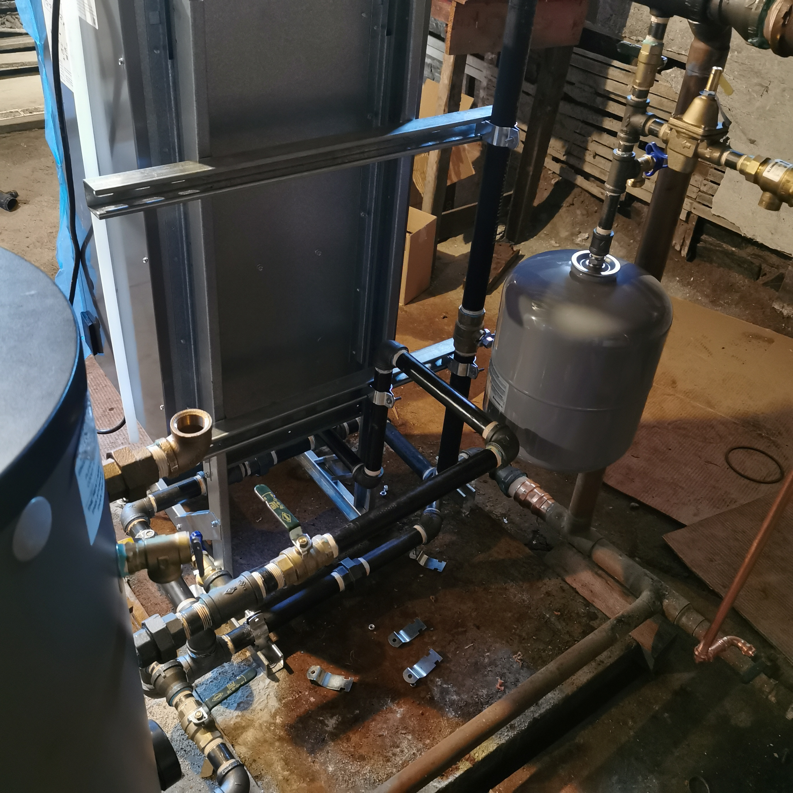

    Here's some photos, if you need more photos, just let me know.
    Front view of boiler. You can see a circulator behind it on the right side, near the floor. That one is Armstrong and it didn't seem to be working when I ran the system a few months ago to check if everything was working. You can see there's an older part connected to the newer Armstrong part - that circulator died a few years ago, and I had to pay hundreds of dollars to get it replaced. They replaced that part and left the rest of it. Now it might have to be replaced again, if it's not something that can be fixed.
    The boiler was leaking constantly, and I don't think it was just from the relief valve, because the relief valve points straight down, not towards the tray under the controller. But that tray was overflowing, even though I had cut power to to the boiler, until I also shut off the water to it a few weeks ago. The tray is still full of water. If I were to restore water to that line, it would just overflow the tray again and there'd be water all over the floor again.
    Rental oil water heater in back right of shot.
    Plumbing on left side of boiler. Relief valve and ingoing & outgoing pipes
    Plumbing on left side and back of boiler. The Armstrong circulator is near the top of this photo now, partially obscured. The other circulator seen is a Grundfos.
    Plumbing on the right side and back of boiler, with the Armstrong circulator in lower front of photo and the Grundfos circulator in the upper centre, blending in with the background
    Plumbing above boiler
    Three more circulators are located in the middle of the basement (the boiler is in the front of the basement). These are all B&G, as is the one shown in the first photo I posted at the beginning of this thread. At least one of these is not working. May be the coupling has broken off the one furthest to the right and I'll have to replace it again. That's already happened 3 times since I've lived here. Or maybe it's something else. When I have time I'll open it up and look.

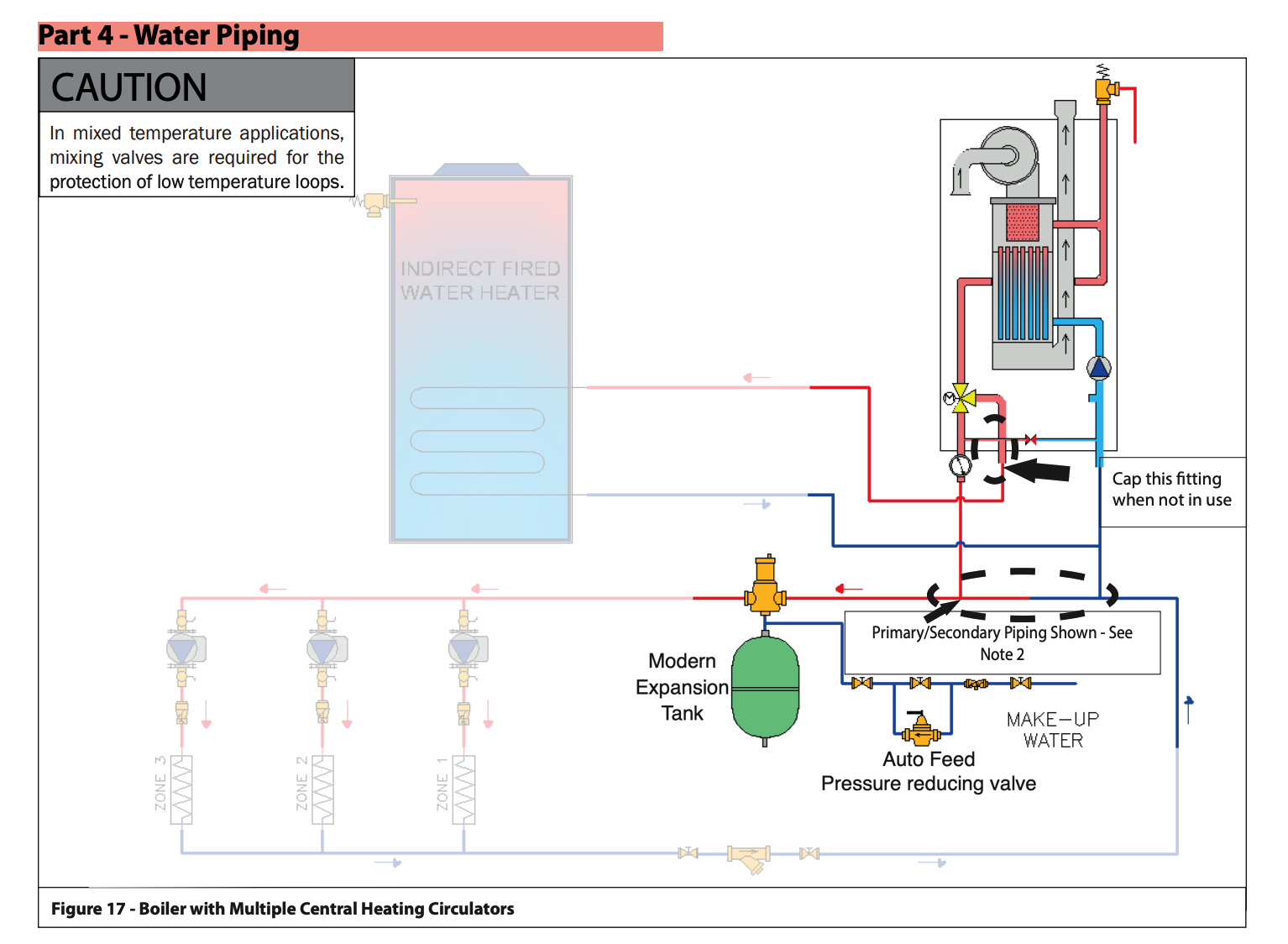

    Question: What's 'Make-Up Water'? I see Figure 17 in the NTI manual shows an expansion tank after the Make-Up Water, while Figure 16 has the expansion tank before the Make-Up Water.

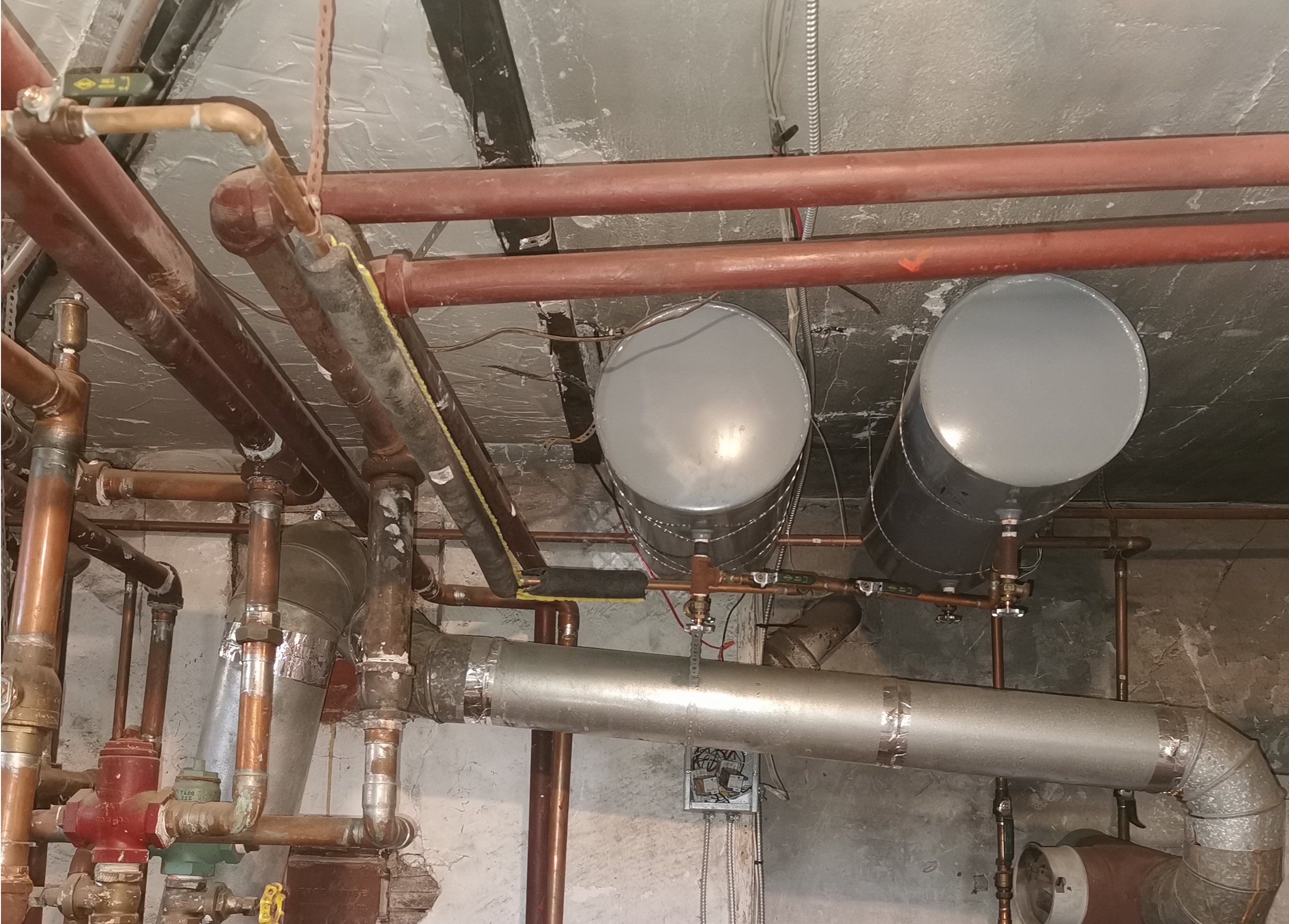

  • sjh
    edited September 2025

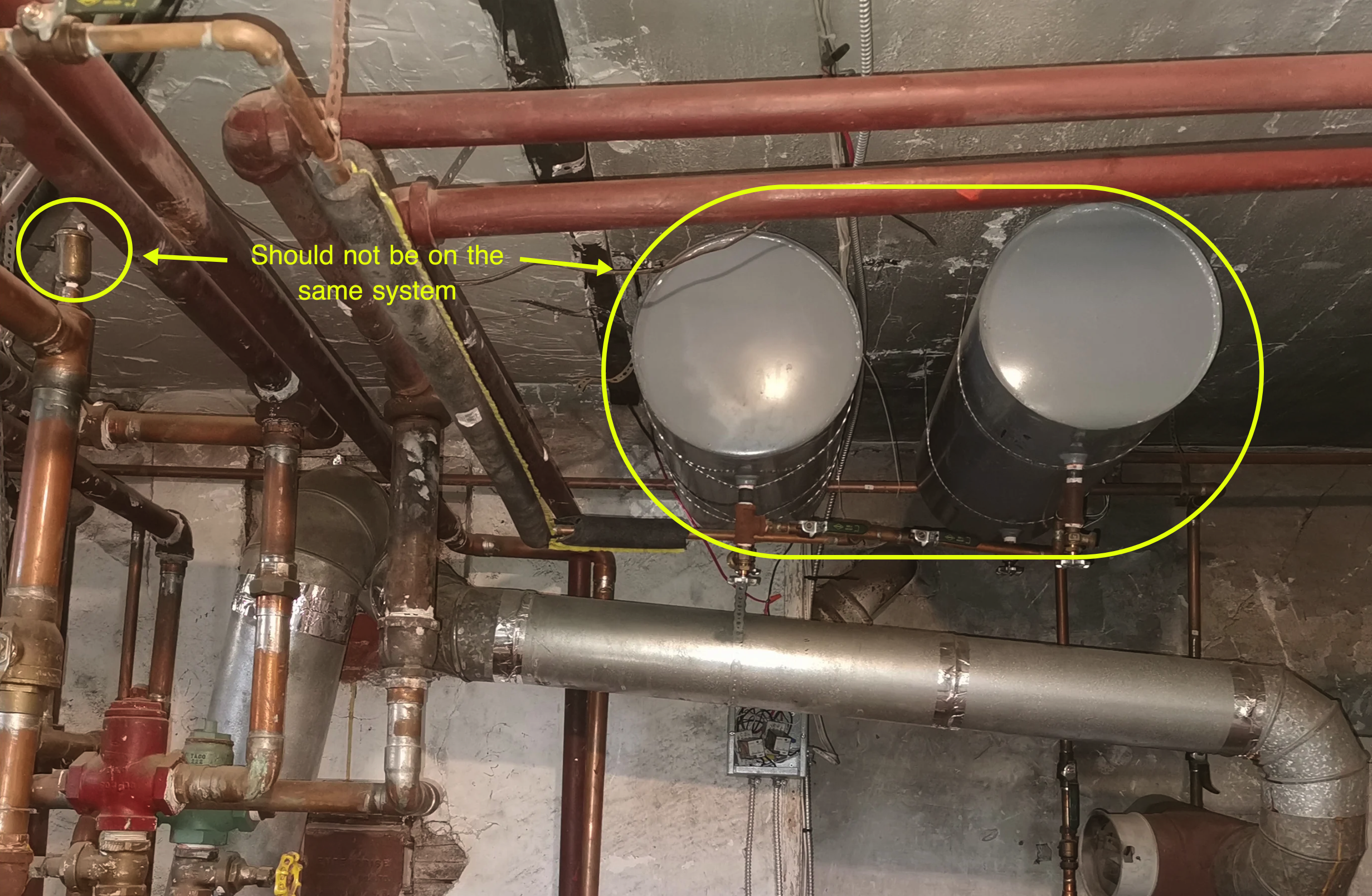

    Whoops, I forgot to include a photo of the expansion tanks. They're about 1:00 from the boiler, a bit to the left of the water heater. Here:
    EdTheHeaterMan Member Posts: 12,543

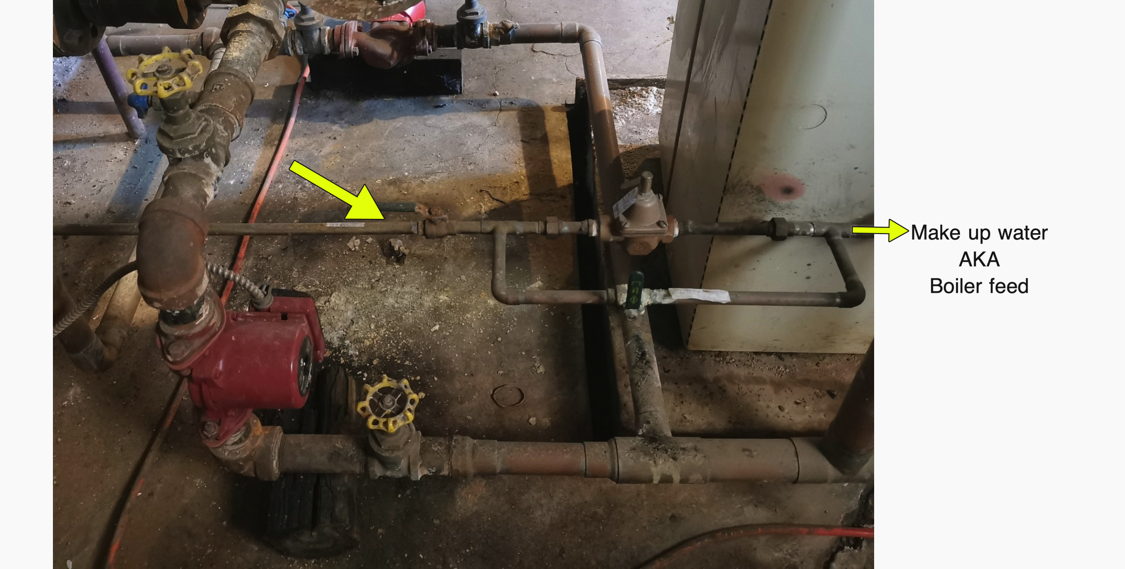

    WOW! I can see that the zones were added over time and were not built into the system at one time. Perhaps as different sections were added to the home, or as different sections were changed form unheated spaces to heated spaces.

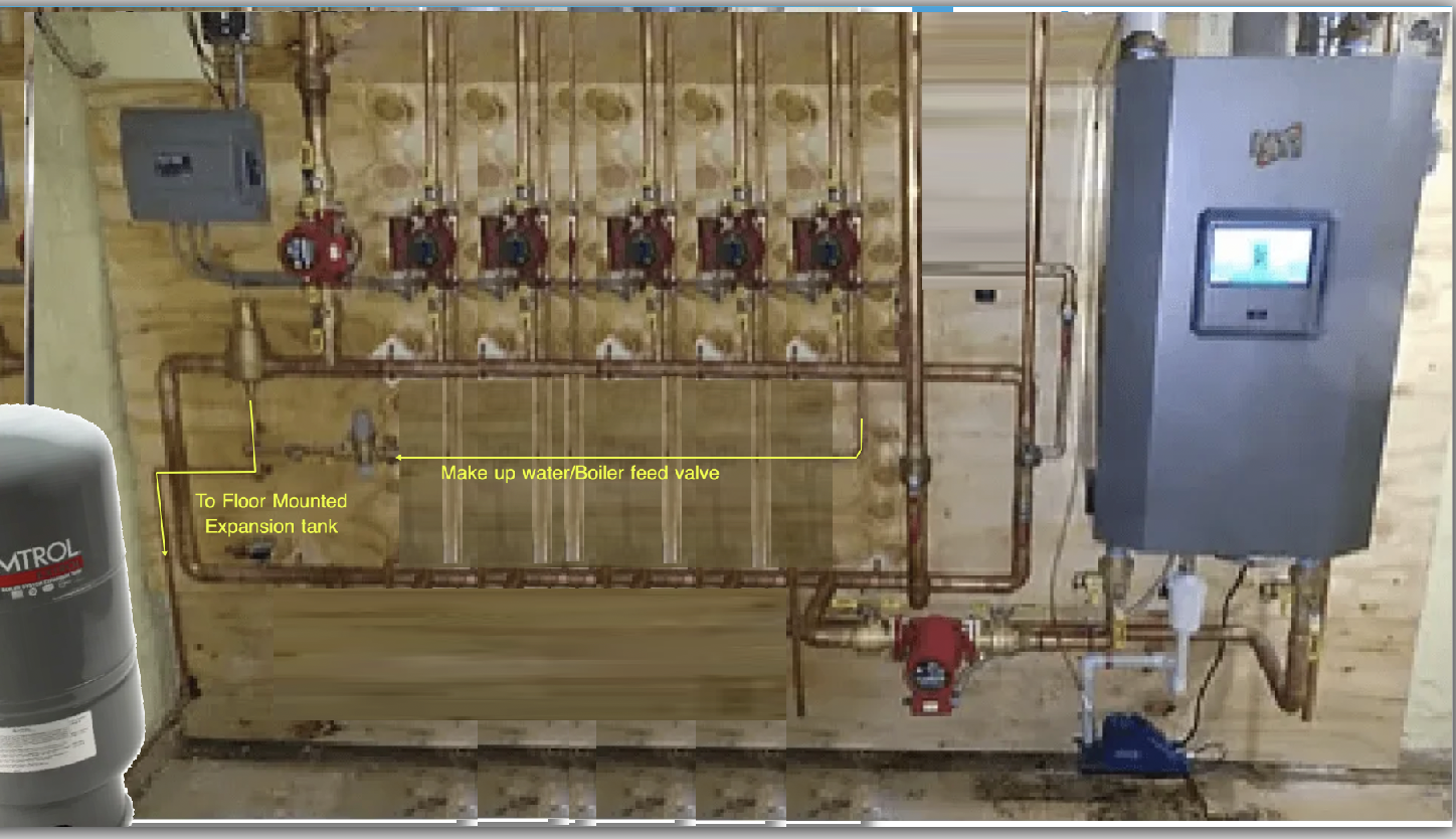

    Make up water is how you add water to the boiler. it is the pipe that connects the house's water you use at the kitchen sink and shower and all the other places there is a water connection to the boiler so it can be filled without using buckets and a funnel in the attic.
    This is your make up water line

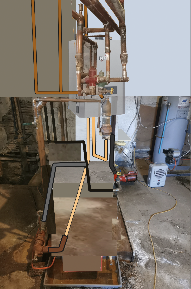

    Here is the reason why I do not like to do only. part of the job. The oil boiler appears to be about 2 feet from the wall. the new boiler will hang on the wall. so the new boiler will be 2 feet away from the pipes that it needs to connect to. A hack will just remove the old boiler and leave all the pipes that are hanging in mid air and run the supply and the return from the boiler to the pipes that are way out 2 feet away from the boiler and that will look like CRAP.
    This is what you do not want the installing contractor to do, (See the old pipes in front of the boiler and the new pipes in light copper color) however you end up getting what you pay for.  This will be difficult to work on in the future, and may have operational problems also because all your circulators are in the incorrect position for eliminating air problems.  If they decide to use the existing expansion tanks in lieu of a new modern expansion tank, then there will be air problems similar to the ones you are experiencing with your old system design. Also, when you use the type of expansion tanks you currently have, you should not have any automatic air vents which you also have at least one.  This is how waterlogged expansion tanks happen.
    I might suggest that you talk to the contractor and ask about making the system conform to the manufacturer's recommended diagram. You may as well get it all done right at the start of the job, in stead of having them cvome back trying to fix stuff because of a poor initial design.

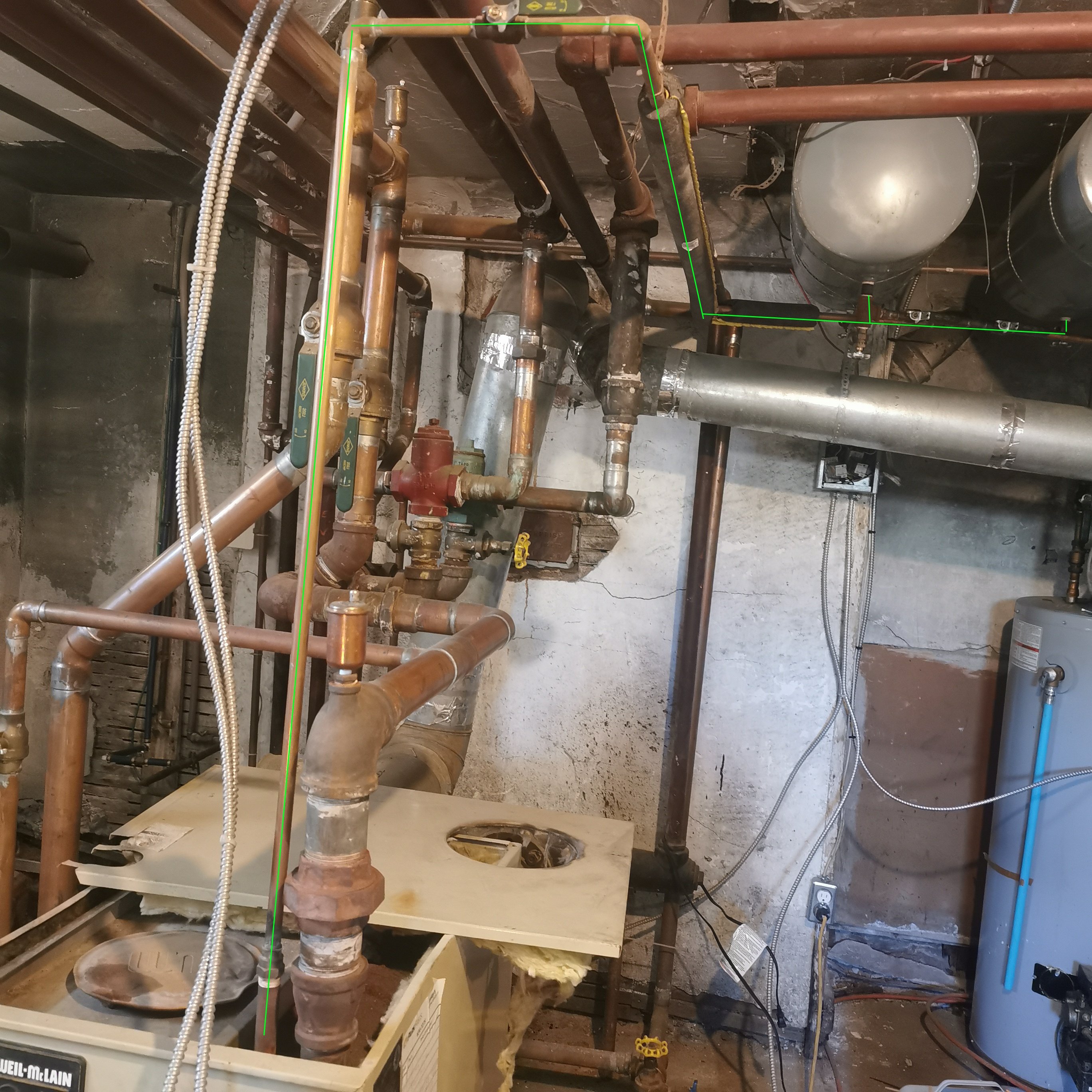

  • sjh
    So that means my expansion tanks are after the Make-Up Water, or in other words, on the system side.
    Below, I've drawn a green line on the pipe coming out of the boiler, feeding the expansion tanks. At least I think that's the directional flow. That's what it looks like to me.
    So they're installed in the right place, at least.
    Where's the automatic air vent for the expansion tanks? What are you looking at?
    You're right, I don't want pipes doing a 180 back to the wall from where they are now, and taking up that floor space and creating air problems. There's a lot of that in this house, and it makes it very difficult to sort out which pipe is going where and doing what. I will definitely bring these issues up with the contractor.

    You might want to pay extra for doing this.
    You could let them use the existing pumps because they are working just fine. You just want something easy to work on where you wont bang your head on pipes that are way out in front of the new boiler.

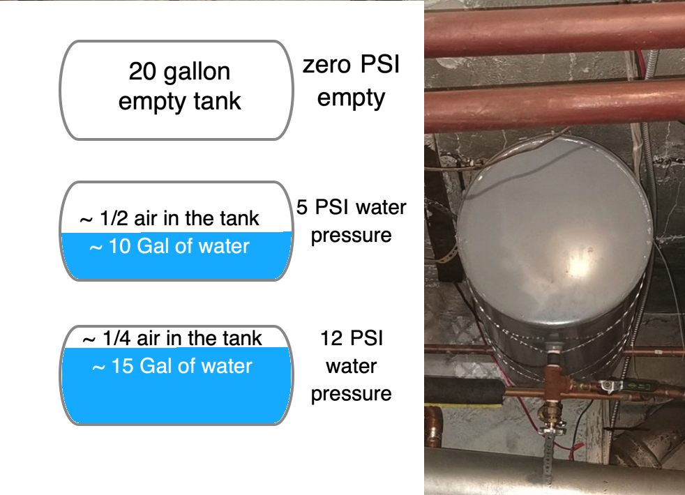

    One more comment about the system: The service personnel that have been maintaining your boiler are in need of some training.  (or they have offered you the necessary upgrades and you have decided not to pay for them). You are having air problems and water logged expansion tank problems as a result of two items that are not compatible are included in the same system.
    The air vent on the left side of the photo is letting out all the air that is supposed to be inside the tanks on the right side of the photo. The process in which this happens is called gas dissolution. There is a long and interesting explanation of this process as related to a boiler in a heating system like yours, but it is safe to say that if the expansion tanks are not replaced with the modern style expansion tank you will continue to have the same problem
    The other way to fix the waterlogged expansion tank problem is to add two AirTrol® ATF -12 Tank Fittings to the existing tanks and connect them to an air separator located in the system at a strategic location on the hottest portion of the system piping and where the lowest pressure is in the system. In order to make the lowest pressure and the highest temperature happen in the same location you will need the circulator pumps moved.
    HVACNUT Member Posts: 7,539
    @sjh, The plastic flue access cap on the jacket looks like it saw some pretty high temperatures. Even if the insulation is gone, it shouldn't warp. There's also scorch marks around the burner door. What's the stuff around the inspection window and the air tube?
    You mentioned a gas fired boiler is replacing the oil fired. But all the zones need to work first? So they're sliding out the old boiler, and sliding the new in, only to reconnect to that existing mess of piping? Please tell me I'm crazy.
    Actually your expansion tanks are connected to the built in air scoop on your Weil McLain boiler. The 3/4" pipe tappint is actually a built in air scoop at the top of the boiler.
    Your new boiler does not have a built in air scoop so you need to provide one as shown in the piping illustration.
    Untitled Image
    The air separator is the yellow part just abpve the light green expansion tank. Since the contractor is removing the built in air scoop that Weil McLain has provided, the contractor will need to provide one to comply with NTI's instruction manual.

    I actually installed that vent myself, when the previous one stopped working. I had no idea I was replacing something that shouldn't even be there. I just told myself "this thing was here when I got here, then it died, so I'll find out what it is and replace it with a new one."
  • sjh
    I don't know why those things happened. I assumed it was normal. I haven't seen a lot of oil boilers and don't know enough about them. I've been trying to figure the system out for years, but where do you start? It's a mess and I have no training in this area and never had an opportunity to get training in this area. The boiler was cleaned annually by the oil company, and they never said anything like "this is dangerous" or "****, what are those scorch marks from?" I would usually ask them questions whenever they came here to clean it or do a service call, and they answered me, and sometimes I learned something. But that hasn't been enough for me to be able to say "oh, this was installed wrong, and here's what I have to do to fix it." or even "here's why this radiator isn't working." Sometimes I know why, sometimes I don't. Sometimes they don't know why either. I have 2 rads that never work, and they can't tell me why - I've asked them.
    The corrosion looks to me like sulfur. It's quite rusted inside. The unit is being taken away soon, it's no longer in use.

    I'm getting the impression that this system in this house is poorly designed and installed haphazardly, which I didn't know before. If you can tell me what else should be done, I'll see if I can convince them to do it. I've had nothing to compare it to and haven't really had the time to figure this system out, and usually I could just call in and have somebody come out and fix whatever was not working. But improving the design of the system never came up. It was always 'this is an emergency, there's no heat because this object is not functioning, replace it with the same thing or the modern version of the same thing.' or call in, they show up and drain the tanks and maybe they replace a part. I should have discovered this forum sooner.
    @sjh asked: "What are the modern expansion tanks? How are they better?"
    Let's first understand why you need an expansion tank.  When water is heated it expands, 100 gallons of 60° water will become 103 gallons of 190° water.  Now when you fill the boiler and all the pipes and all the radiators with water and there is no air left in the system, you need a place for that extra 3 gallons of water to go.  If the system is completely closed and there is no air in the system at all, then that expanding water can become explosive.  See this video about an overheating water in a closed tank with no relief valve:
    So HOW you do you make room for this extra 3 gallons per 100 gallons of water in a heating system? The expansion tank has an air cushion that can compress as the water temperature increases Tha compressed air will make way for the extra water.
    In the tanks that you have, you start out with an empty tank of air with the only opening at the bottom. then as you fill the system with cold water until you have enough pressure in it to fill all the radiators on the top floor. That might be about 15 Pounds per Square Inch (PSI). it would look something like this inside your expansion tank. (Note: the following pressures and gallons are not exact measurements and are provided for illustration only)

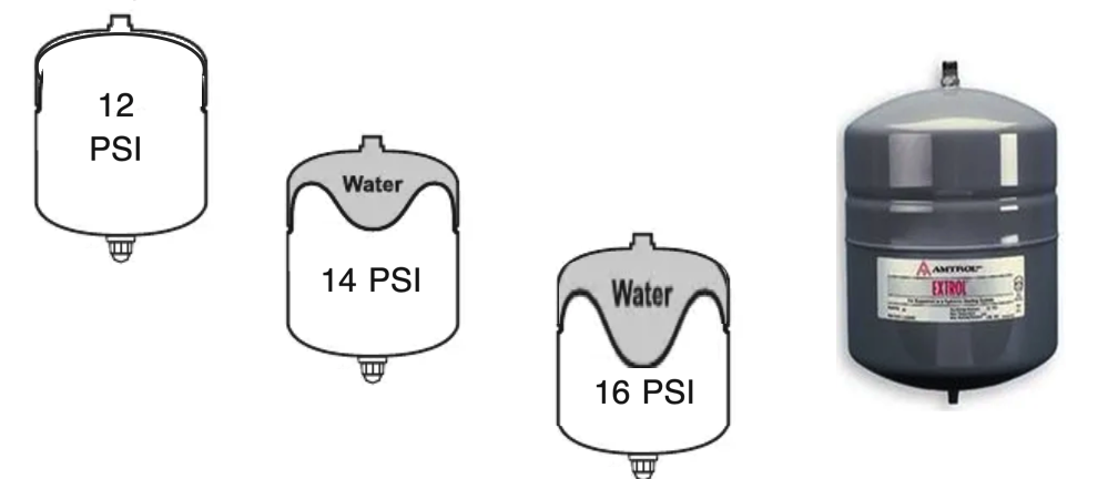

    in the late 1950s a company called Amtrol invented a smaller tank that came with 12 PSI air pressure already installed inside it and placed a flexible membrane between the air side of the tank and the water side of the tank. This was the first Modern Precharged expansion tank. Since the 12 PSI was already in there, you only needed a 5 gallon tank to do the same job as a 20 gallon tank old style tank.
    As the water temperature in the heating system increases the additional water volume moves into the tank and compresses the air in the tank the same way it does in a old style tank. more water expanding the pressure increases a little. as long as there is enough air in the expansion tank, the system water and air pressure will stay at a reasonable level well below 30 PSI of the safety pressure relief valve
