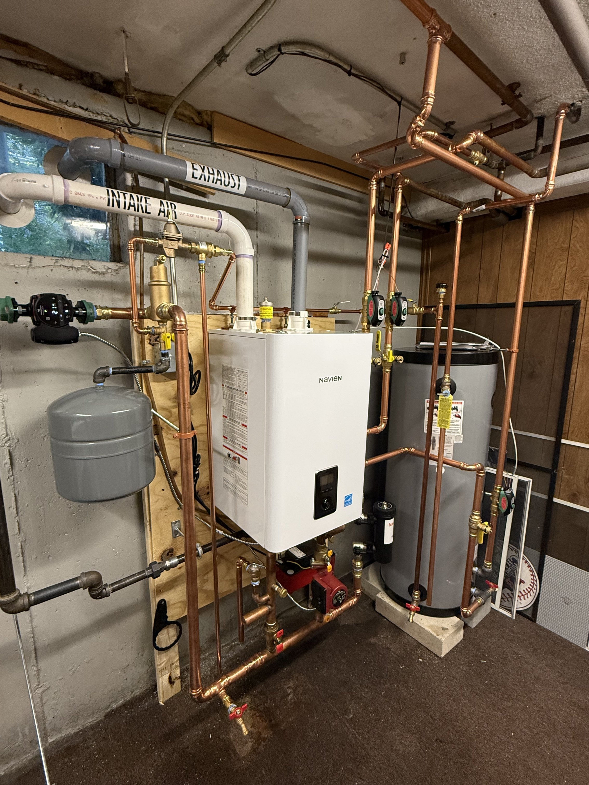

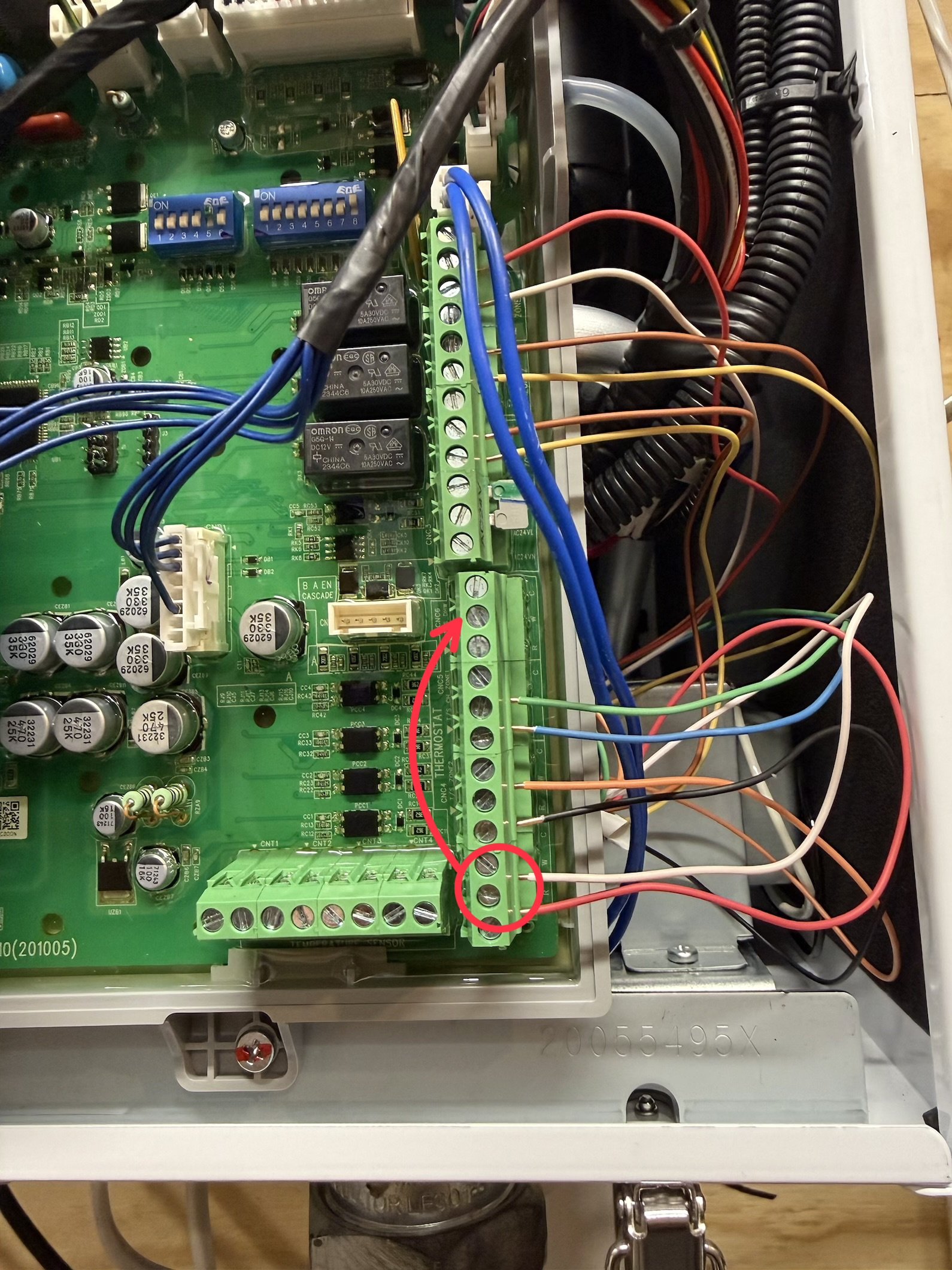

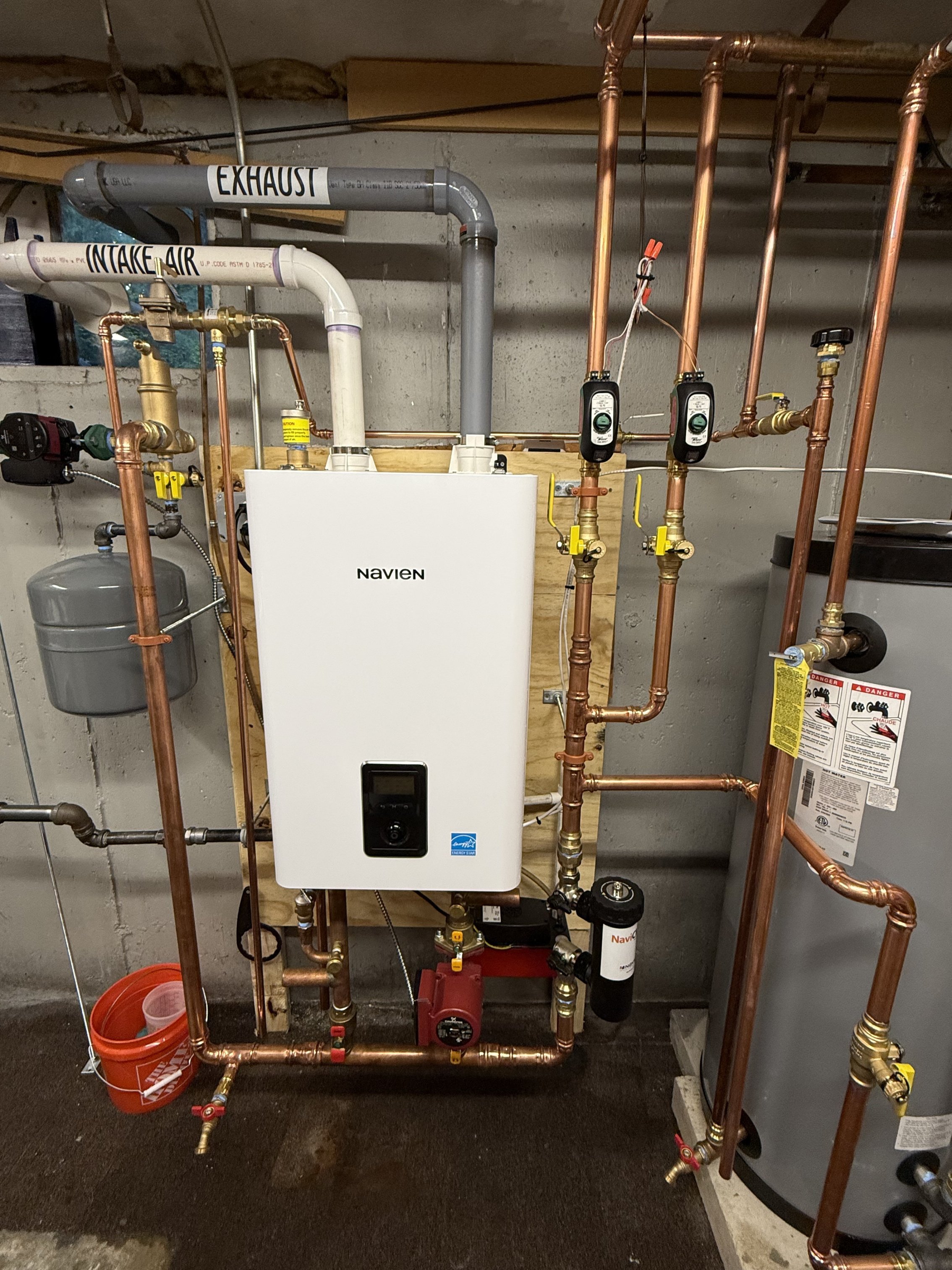

I recently had an NFB 175H boiler installed along with an indirect water heater. My question is about the installation: the installer connected the indirect water heater thermostat to zone three instead of using the dedicated DHW block. Zones one and two are used for my baseboard radiant heat. When I asked why it was done this way, the installer responded, “We prefer to pipe it as a heating zone because it simplifies troubleshooting in the future. We could have piped it directly off the manifold, but that can make it harder to diagnose a failure of the primary pump. That’s why we did it this way.” Does this make sense?

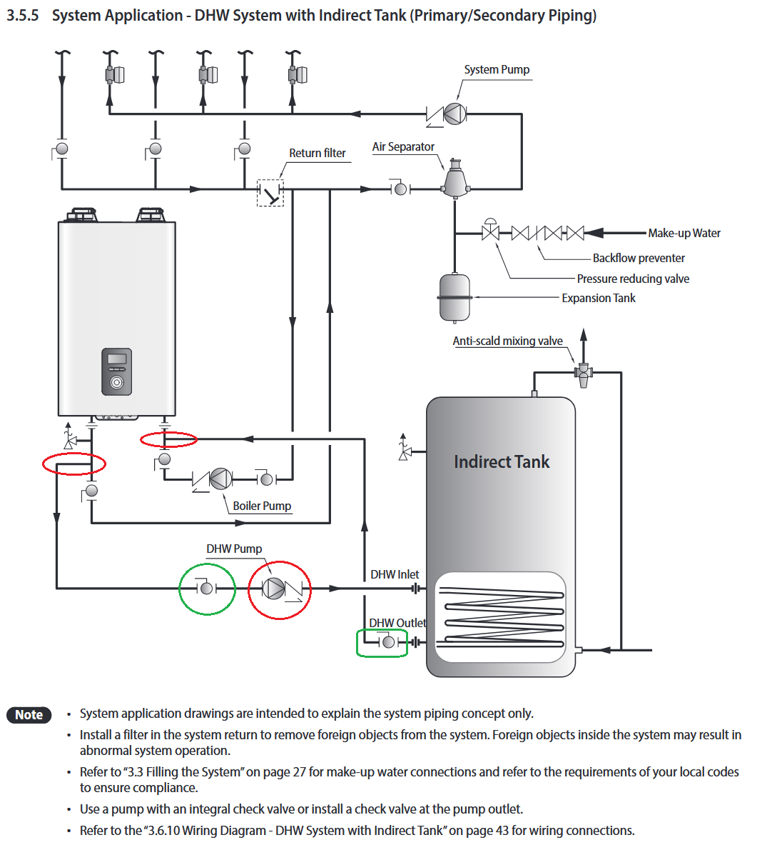

    Well, is seems it is more than just moving the two wires in your annotation, but not enough to avoid it. How does the boiler (or the system) control the water flow through the indirect water heater ?
    IMO doing it the way they seemed to have installed it (can't see the whole DHW loop in your pictures) you are loosing out of features the boiler has built in like DHW priority and maybe DHW temperature control by the boiler's user interface.
    I'm not sure I buy their explanation. So for ease of their (maybe future) troubleshooting you loose features and functionality, seems lame to me. They could close the isolation valves to the indirect water heater if that is messing up their troubleshooting strategy.
    Kind of seems like it is not piped per the instruction manual either (however I did not read the whole manual).

    Sorry, I did not see you added a picture, it seems Edits don't push the thread to the top of the queue or trigger notifications.

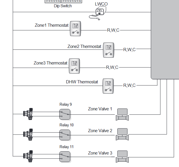

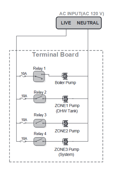

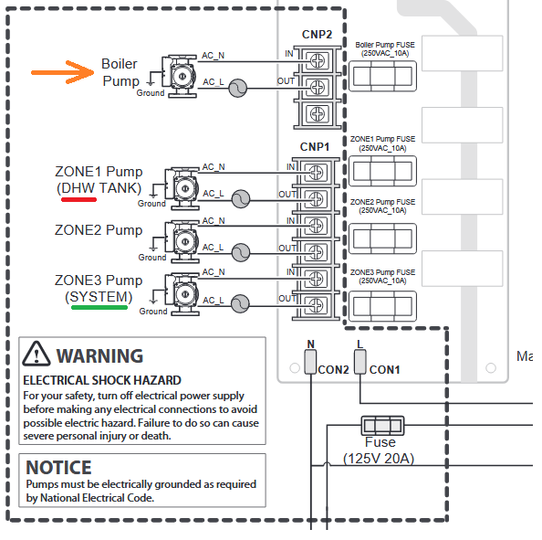

    It looks like they used a Zone Valve instead of a circulator for the DHW zone. Maybe a cost savings strategy on their part. If I understood the manual correctly. The way I believe the boiler is set up electrically (and logically) if you use the DHW thermostat input you need a DHW circulator. Since I suspect the boiler will not turn on the "Boiler Pump" or the "System Pump" circulators, it wants to turn on the "DHW Pump" circulator. (there are ways around that, but that just complicates things)
    It looks like the way they piped and configured the system, for you to have DHW the Boiler Pump AND the Zone 3 Pump (System) both have to be running and the DHW zone valve needs to be open. It may work but you probably loose the DHW priority and maybe other features and you are powering an extra circulator and a zone valve for your DHW.
    I would venture to say that is not what Navien intended.
    It seems when the DHW thermostat input is used it is the same as Zone 1 but with different features / functionality for DHW service.
    As far as troubleshooting (at least from a newcomers point of view) If you build the system different from what the manual shows that may add confusion, not making troubleshooting easier. Like a "not enough DHW" complaint in the middle of the Winter.

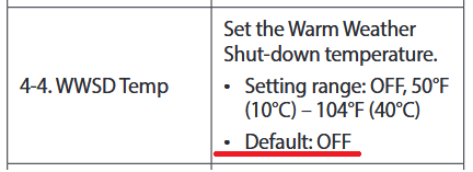

    Made me think of something else, WWSD (Warm Weather Shut Down) Probably disabled. Another lost feature.
    No DHW above a WWSD set temp. Sadly too funny. Probably still disabled.

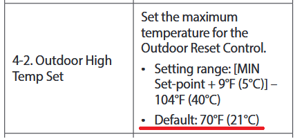

    If the Outdoor reset was enabled it may provide poor DHW temperature or extended boiler run time since the indirect's thermostat may never be satisfied. Since the boiler thinks it is a normal heating zone.
    In this case, many pitfalls when you don't follow the manual. If you follow the manual and then if it does not work correctly it is not on you.

    If the features like Outdoor Reset and WWSD (Warm Weather Shut Down) sound like features you would enjoy using and you enable them, monitor the performance, if it fall short complain.
    Maybe a bit late in this season for WWSD (Warm Weather Shut Down) activity but I bet if it was enabled, and is set for 70 degrees and it goes above 70 degrees outside you would loose the DHW heating. Maybe they never bothered to install the outdoor temperature sensor.

    The outdoor reset feature of your boiler must be disabled in order for zone 3 to make enough temperature to heat the tank for DHW. If that was piped and wired in accordance with the manufacturers specifications, the lower temperature operation would save you on fuel usage for the life of the appliance, while the DHW zone would override the lower temperature for the DHW priority, and then the lower temperature would be restored to make space heating zones operate at a loser cost.

  • The install was done about a week ago…The installer was very defensive about the DHW question. Says this is the best set up and easiest to service. There is not a separate circulator pump for the indirect hot water tank..they use a valve instead. Not sure if you can use the DHW features without the dedicated DHW pump? I’ll also be asking about the outdoor sensor.

    @Kaos if you look a some of the diagrams (above) from the manual it appears Navien wants (or recomends) a circulator for the DHW loop.
