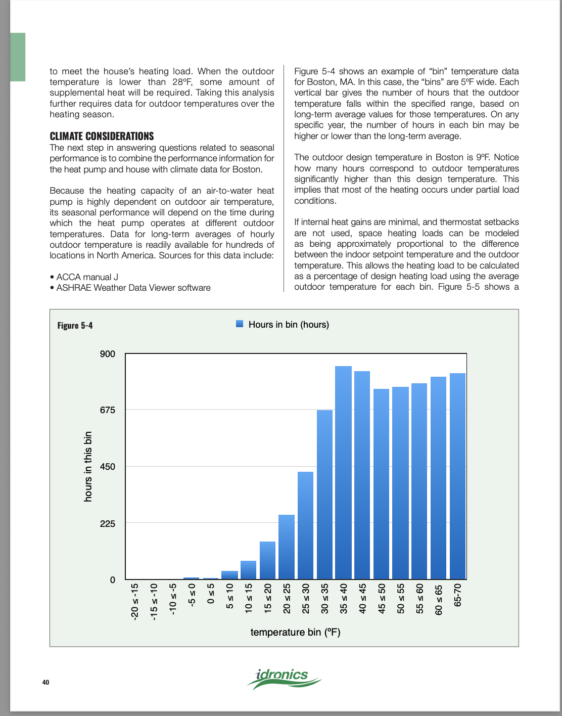

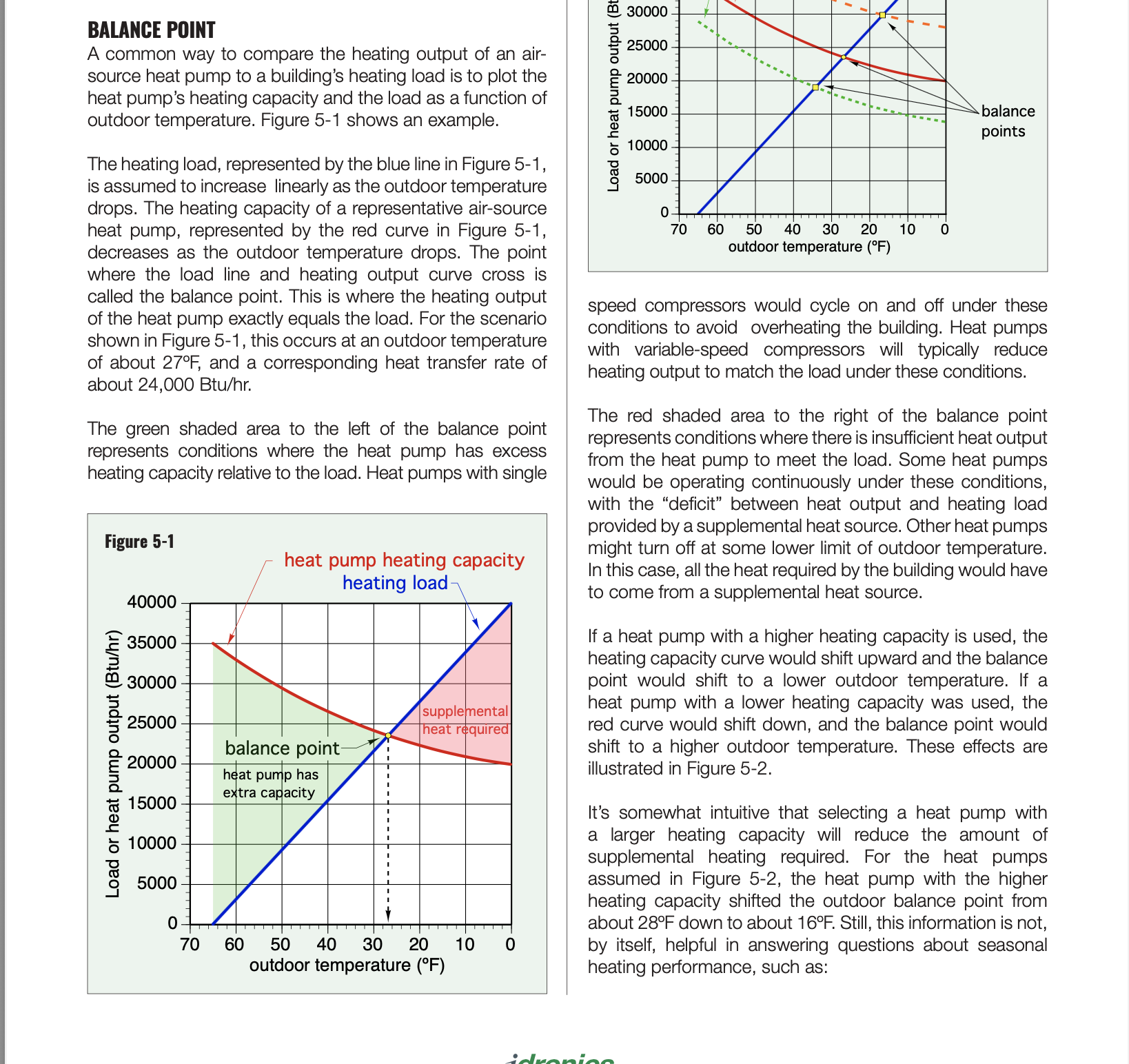

    Are you talking about and air to water heat pump connected to the hydronics? Or some sort of air to air.
    Here is some data that relates to both as far as Boston design temperature and BIN data.
    This issue of Idronics uses Boston as one of the design examples, for an air to water HP option.
    https://www.caleffi.com/sites/default/files/media/external-file/Idronics_27_NA_Air-to-water%20heat%20pump%20systems.pdf\
    You really want to use data specific to your area and application
