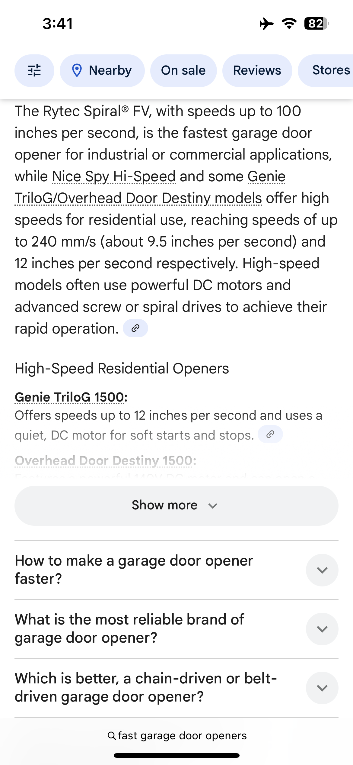

    my Local Toyota dealer has those large super fast overhead door openers
    It seems a months worth of fuel cost would pay for that setup
    I’ll bet the company that manufacturers those has some fuel saving data
