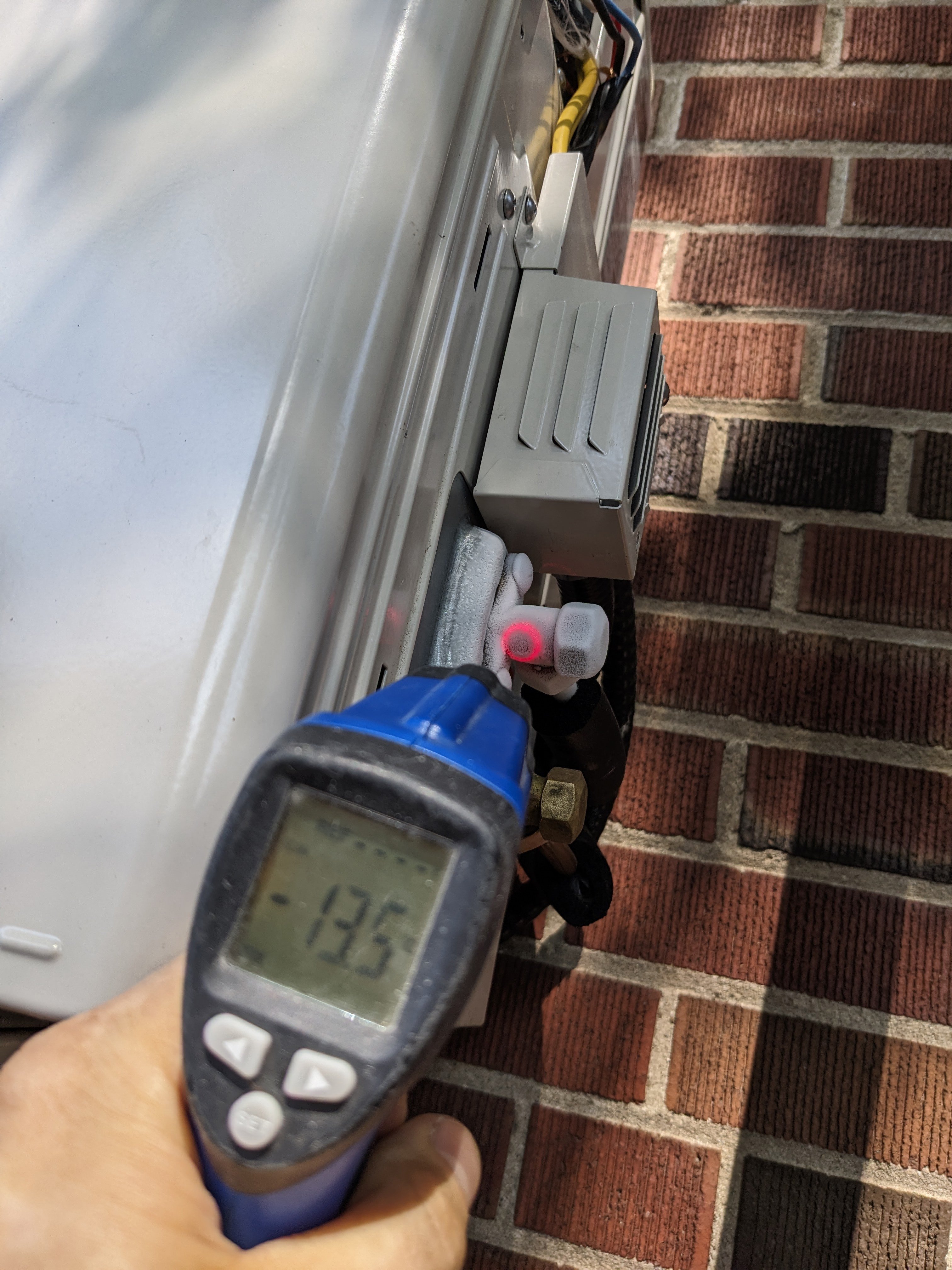

The liquid line gets frosty (charge is 100% correct, 2.5lbs) , the evaporator doesn't get cold.

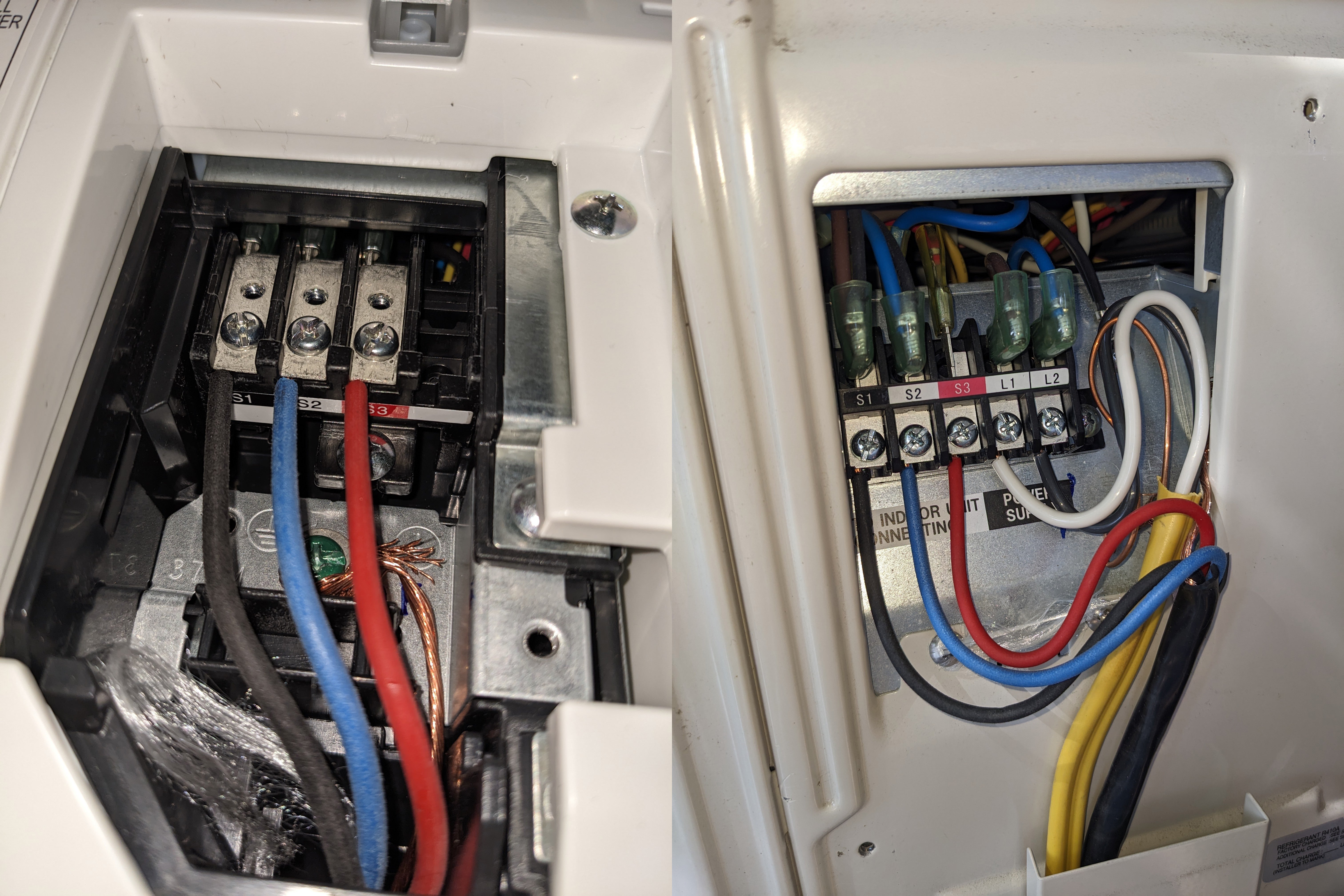

    how long is your lineset and have you triple checked your wiring is accurate?

    Check the valve on the mixed-phase ("liquid") line. It shouldn't be frosty, just wet with condensation when it's working. Something's restricted, the valve is the simplest answer.

    The liquid (thinner) valve is definitely fully open, counterclockwise to the left until it stopped. That line is frosty all the way to the evaporator.

    That mixed phase line is definitely waaaay too cold. The LEV stuck closed is the next simplest answer along with the LEV not opening due to mechanical or electrical issues.

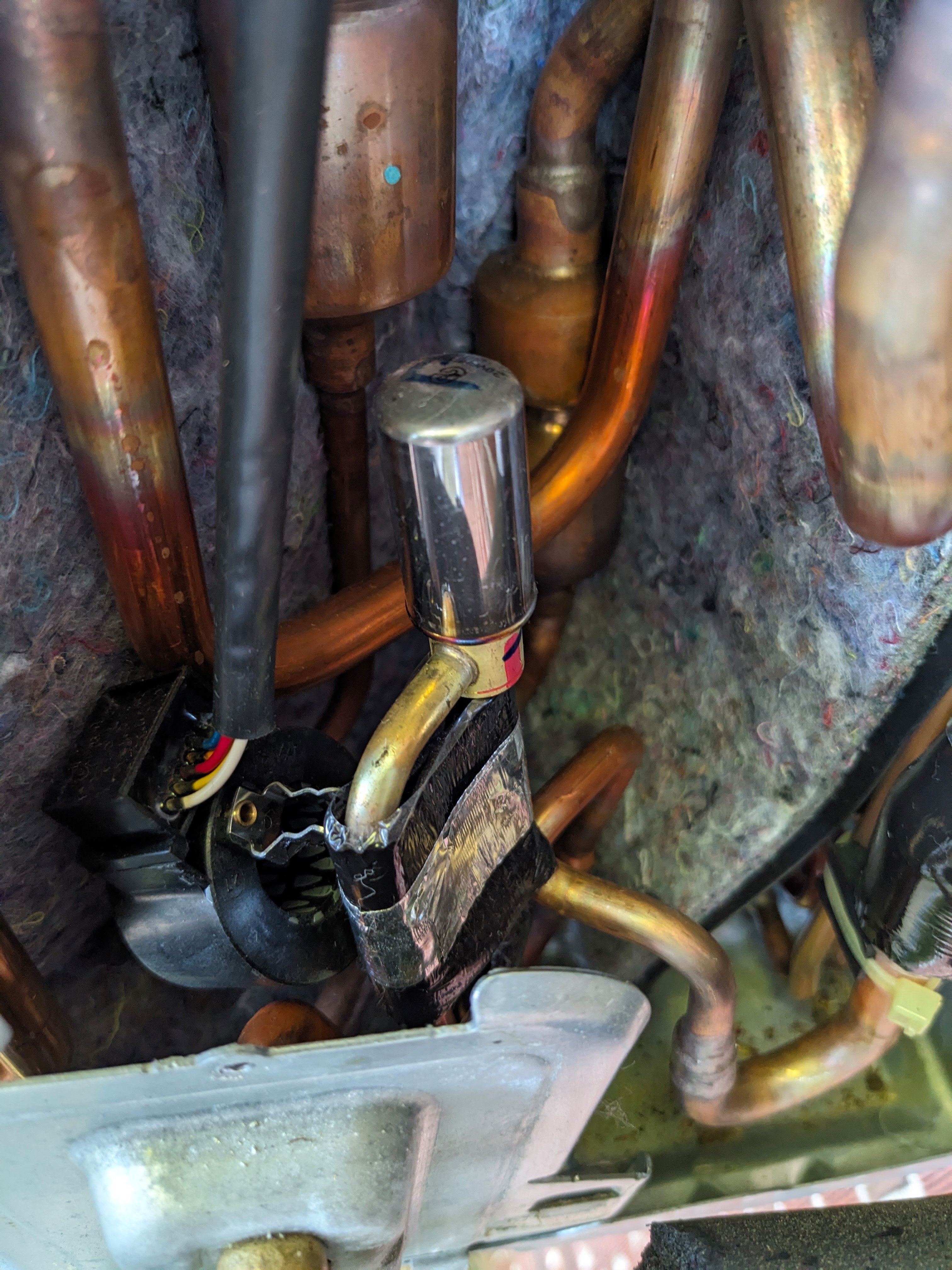

    I'm reading the actual magnetic coil on the LEV sometimes gets unsnapped, i drove this this for 2 hours without the original box. A long shot but worth checking.

    The AC works now!
    The black part hanging is the coil, it's supposed to sit on the shiny cylinder with the metal clip snapped into the copper pipe. It got bumped off during transport i imagine. As soon as i snapped it back in place the AC began working as it should.

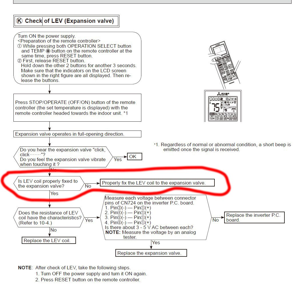

    For anyone who might be having a similar issue here is an excerpt from the service manual, indicating they know the EEV can come off. It happened to me because I transported the condenser without the original box which i guess dampens vibrations when you're going over bumpy roads with the condenser in the back of the vehicle.
    Symptoms are very similar to low refrigerant. Inexperienced techs might add refrigerant overcharging the system which isn't cheap to fix if you're going to do it properly by recovering the entire charge and weighing in the right amount.
