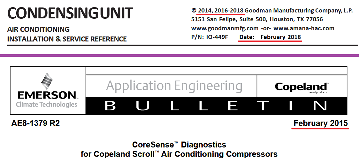

3 years ago my son installed a new Goodman GSXC16024 that has been working fine for the first two summers, and the beginning of this summer. About 3 weeks ago there was no AC and he found error code 04 on the condensing unit PCB display. I wanted to look up the technical documents for this unit and I am unable to find the IO manual or Trouble shooting info online. Does anyone here (other than @pecmsg) have info that might help? Is there a technical bulletin on this particular issue?
Cycling the 220 vac off to the outdoor unit and the indoor unit will bring the system back to operation. It will operate for several days and the stop. Now it is becoming more frequent.
There was a discussion on this same issue in 2021 on HVACTechTalk, but I did not see any resolution on that thread.
I think that he may need to call goodman tech support when he is at the equipment in order to get the answers, but I seem to be his GoTo tech support person on all things automotive, Oil Heat and HVAC, so that is why I'm asking

    https://hvacdirect.com/media/hvac/pdf/GSXC16-Install.pdf
    EdTheHeaterManPC7060
    HVACNUT Posts: 7,784

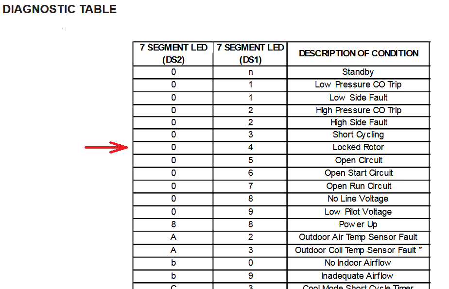

    Goodman uses the CoreSense module.
    109A_5 Posts: 4,759
    The dates are interesting and this unit may be much newer so it may be different than either of these documents posted.

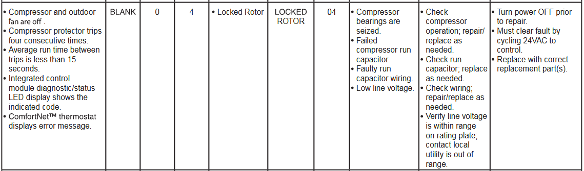

    Check easy things first. Electrical connections, capacitors, start components.
    If those are all good, let the system cool off completely. Reset by cycling power. Measure the suction temp and discharge temp at the compressor, as well as the amp draw/voltage.
    If the superheat across the compressor is high and amp draw low, you aren't moving enough refrigerant to cool the compressor and it will trip the common internal overload after a longer run time. That can come from low refrigerant, high head pressure ( dirty condenser, blockage or malfunctioning fan).
    If the compressor superheat is low and the amp draw is high, that would mean it's pumping to much gas and overloading the motor to the point of tripping the internal overload. This scenario would be most common in a horizontal right airhandler application where the txv bulb is in the return Airstream and not properly insulated or loose from the pipe.
    And lastly, it could be a bad compressor.

    Or the voltage may be marginal and it needs a hard Start Kit
    SuperTech
    Sounds like time to measure the voltage and current at the capacitors an calculate the capacitance to see if it is even close. 3 years seems about right for lowest bidder caps.
    EdTheHeaterMan Posts: 12,940
    Capacitance measured is 34.4 uf, capacitance rated is 35.0 uf. is that within 6% plus or minus.
    Testing that possibility. first step is to re do all the wiring connections. Seems that all the failures happen around 3 PM when the setback ends and the system starts to recover. If redressing the wiring does not fix the problem, then removing the setback to see if that is the cause of the problem. I don't want to change too many things all at once. Then we won't know what one of the many fixes worked.

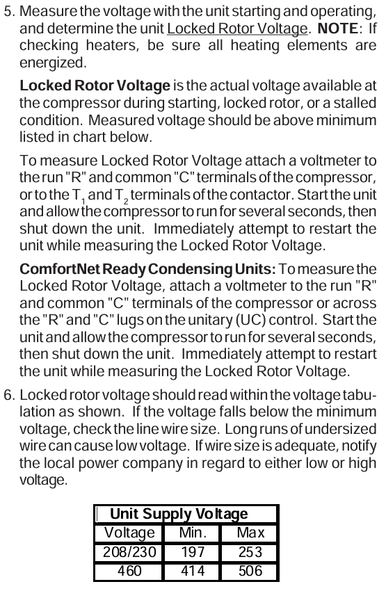

  • Update.  My son is working full time as a welder, so he does the family trade as a side gig.  Since everyone is asking for the fall tune up of their oil burners and other service calls as needed, he has been busy after work and on weekends. He has just finished looking at just about every possibility all of you have been so helpful contributing, but it has taken some time to get there.
    Finally contacted Goodman Tech support on Tuesday, and they asked him to get a megger and test the compressor windings. (locked rotor and stuff like that may have caused winding insulation deterioration).  Since I sold the business and no longer have a megger, he needed to borrow one from the guy I sold mine to.  That test indicated that the compressor is just fine with over 1000 megs.  (anything less than 700, Goodman would have condemned the compressor).  So, Goodman told him to get a new circuit board under warranty.  And just so happens that the counterman from the supply house where he purchased the equipment stopped by for a beer and to see how Ed Jr. was making out, and he heard the Goodman tech support guy tell him that. Case number and all!
    So on Monday, there will be an order for a replacement board placed if they don't have any in stock.
    Future updates to follow.  Thanks for all the help everyone.  Since this is newer technology on this compressor, I will keep you all updated on the progress.  As of now the 04 code is a daily occurrence.

  • Does that AC have a hard start kit currently installed?? Or, if there is one, is the potential relay working? Sorry if I missed that info.
    Just an FYI, that unit has to have a hard start kit or you will get that exact error code. At the time that unit was manufactured I don't believe they came with a hard start, they had to be field installed. We learned this lesson the hard way. I can't remember the exact date, but Goodman did start sending them out with "factory installed" hard start kits. I believe there was a bulletin issued from the factory about this.
    If I were you I'd skip the board for now and get a hard start kit like the 5-2-1 on it.
