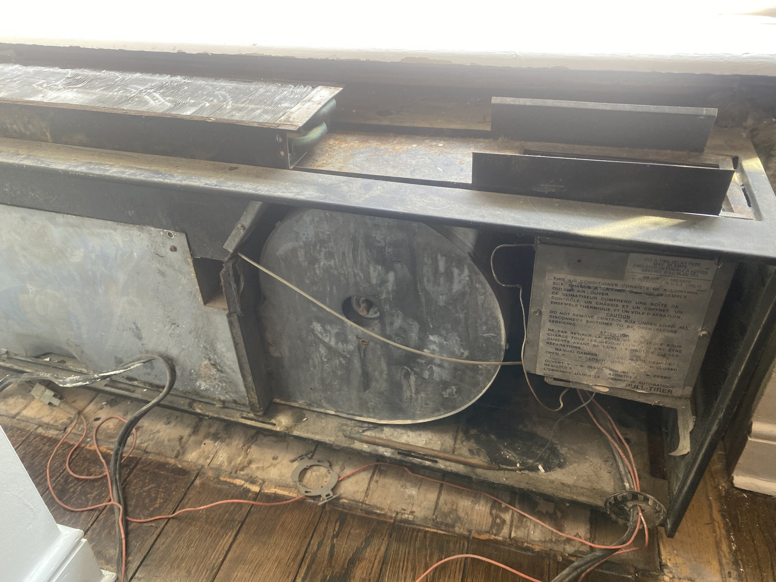

The blower fan is hitting the cover making a loud noise. If I pull the cover away from the fan, the noise stops. (I'm pulling using a screw on the cover).
To stop the noise I'm thinking I could rig up a 1/4" aluminum flat bar with some washers to effectively pull the cover away from the fan blades. The flat bar would be anchored on either side of the blower fan with sheet metal screws.
This was the HVAC techs idea. I think it could work. It's a temporary fix until we can get a replacement unit (4-6 weeks). These are 40 years old.
Here's what the unit looks like. (This is not the actual unit with the problem - but they are all the same).
Any ideas or suggestions?
I don't see any fan blades for the cover to hit. The PTAC is in a wall sleeve isn't it? Is it pushed in all the way?
Not a bad temporary fix — also known as a kludge — but it would be wise to find out what has failed or bent or rusted away or otherwise changed from the original intention — since it didn't do that when it was new — and fix that correctly. Might also be a worn or broken mount for the fan or the motor — or both — or less likely sufficiently worn bearings to allow the fan to move…

The fan blades are behind the metal circle in the pic.
Pardon my ignorance, but would a replacement motor for this unit (McQuay maybe) still be available?
How would I get to the fan & motor? How to I get that round circular cover off?

Yes they were. I had 4 units removed and washed offsite by the HVAC Tech. This particular unit had some debris in the blower motor so it was making noise. The pressure washer got it out, but may have dented the fan cover. Thats a guess - I couldn't visually see a dent. And the HVAC tech did a great job and was super careful.
great idea. I feel like 1/8" might do the trick.
not from whoever the manufacturer is but there is likely a replacement motor that will fit. A motor shop could change the bearings too but that would probably cost what the motor cost.
Look for up down play, my bet is that the shaft is tilted either down or up (depending on if the condenser fan is on the same motor or if it has a separate motor).

I assume I'd have to have the PTAC unit out of the sleeve to do that.
I think this is going to work (provided that is the problem). I tried this out on a scrap metal shelf that was concave in the center. It basically works like an automotive dent puller.
You shouldn't have to, but who knows? What's holding it in place? It looks like the air discharge slips inside. Are there L brackets or screws there? If you remove the flat metal cover to the left of the blower, maybe there's a braket in there holding the assembly. Is it accessible from outside?
