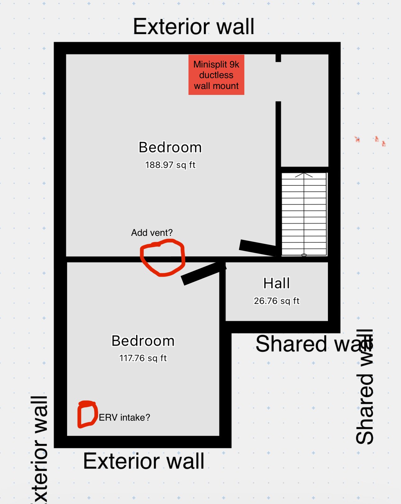

Adjacent bedrooms. ERV / Mini split setup
Currently have a 9k ductless wall mounted mini split in the master bedroom. Trying to get the hot/cool air into the other bedroom when doors are closed. Do you guys think this setup would work with a vent in between the 2 rooms & set up some sort of ERV where it would pull the hot/cold air towards the farthest corner of the room? My goal is to not have to use the electric baseboard in the smaller bedroom during the winter
    You going to need two vents in the wall between the two rooms 1 high and 1 low. As far as the ERV or some type of fan or duct fan to move some air is this second floor or first floor. If SF is the attic accesable to run a duct and is the basement acesable for the first floor?

    ok that’s a good idea doing on a vent high & low. this is on the 2nd floor, there is an attic above it with easy access.
    My other thought after doing some research was to put a Panasonic bath fan in the wall and have it exhaust into the other bedroom. Thoughts?

    The ERV will not help; it brings in as much air as it takes out so it will not move air through the vent between the two rooms.
    I don't think high and low vents will do much either, there simply won't be enough air movement to keep that smaller room warm.

    I don’t see how that will work at all.
    they make ducted minis for that application.
    QuintonSGGross
    I have no idea what the ERV is for. It won't accomplish anything. However, you can get some air movement with two vents, as noted above — and with a fairly powerful fan in one of them. A bathroom fan is nowhere near big enough. I'd try it without any ducting first.

    An exhaust fan (not an ERV) would take air out of the room, which would need to be replaced with air from somewhere else, like the room next door—but eventually it'll need to come from outside. You probably don't want that in the volume it'll take to keep the room comfortable.
    There are through-the-wall fans which will do what to want I think, a fan up high & an opening down low.
    Ducted heads are nice, but I don't think you want to replace the head. Also, it would need to go in the attic, which is outside the conditioned envelope, that brings in difficulties of it's own.

    In the attic run a duct from 1 room to another and use an inline duct fan. Insulate the duct. The suction from the duct fan should be over the minisplit. The discharge from the duct should be as far away from the mini as possible. Add the two wall openings as well.
    Will it be perfect? No will it help, yes
    QuintonS
  • Tjernlund offers AireShare transfer fans for that purpose. Models AS1, AS1P, or AS2 depending on your application.
