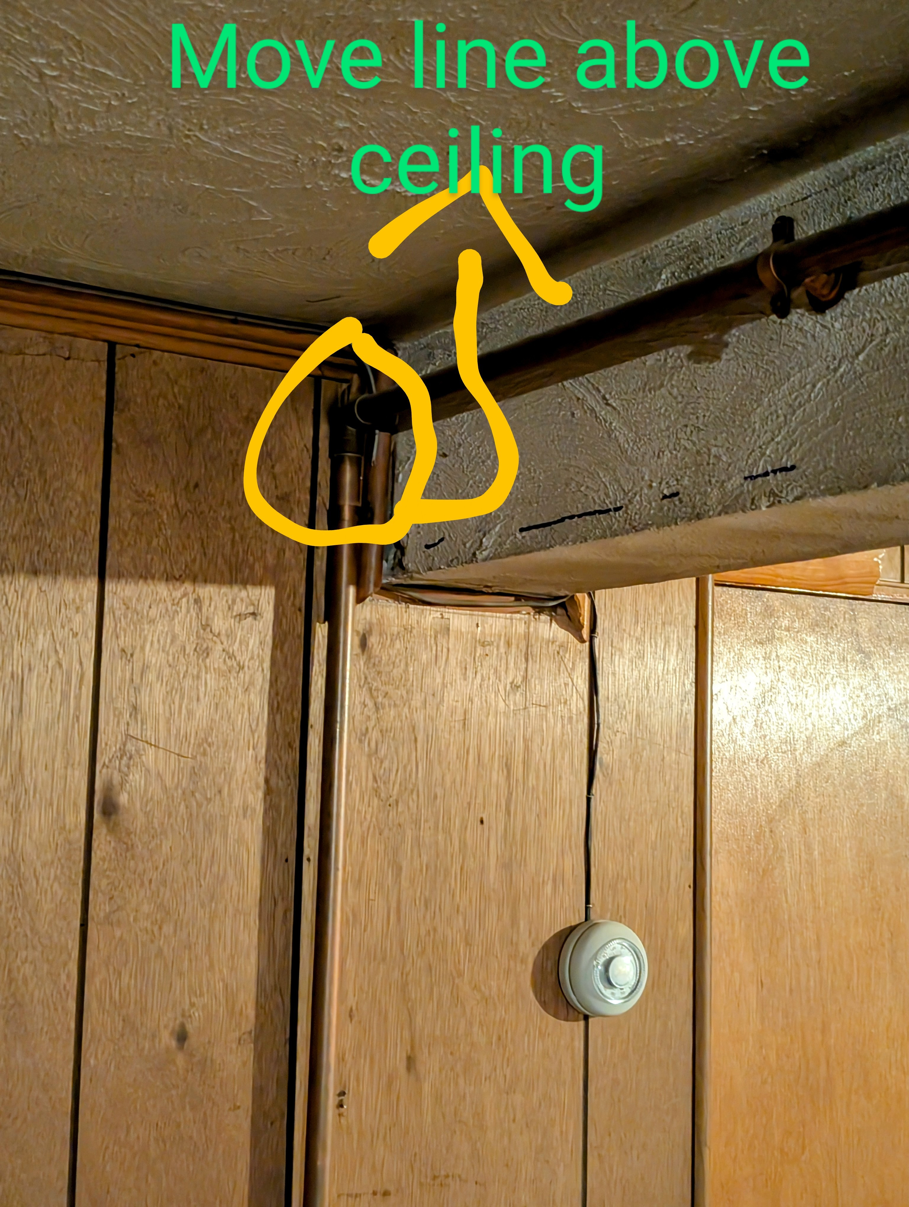

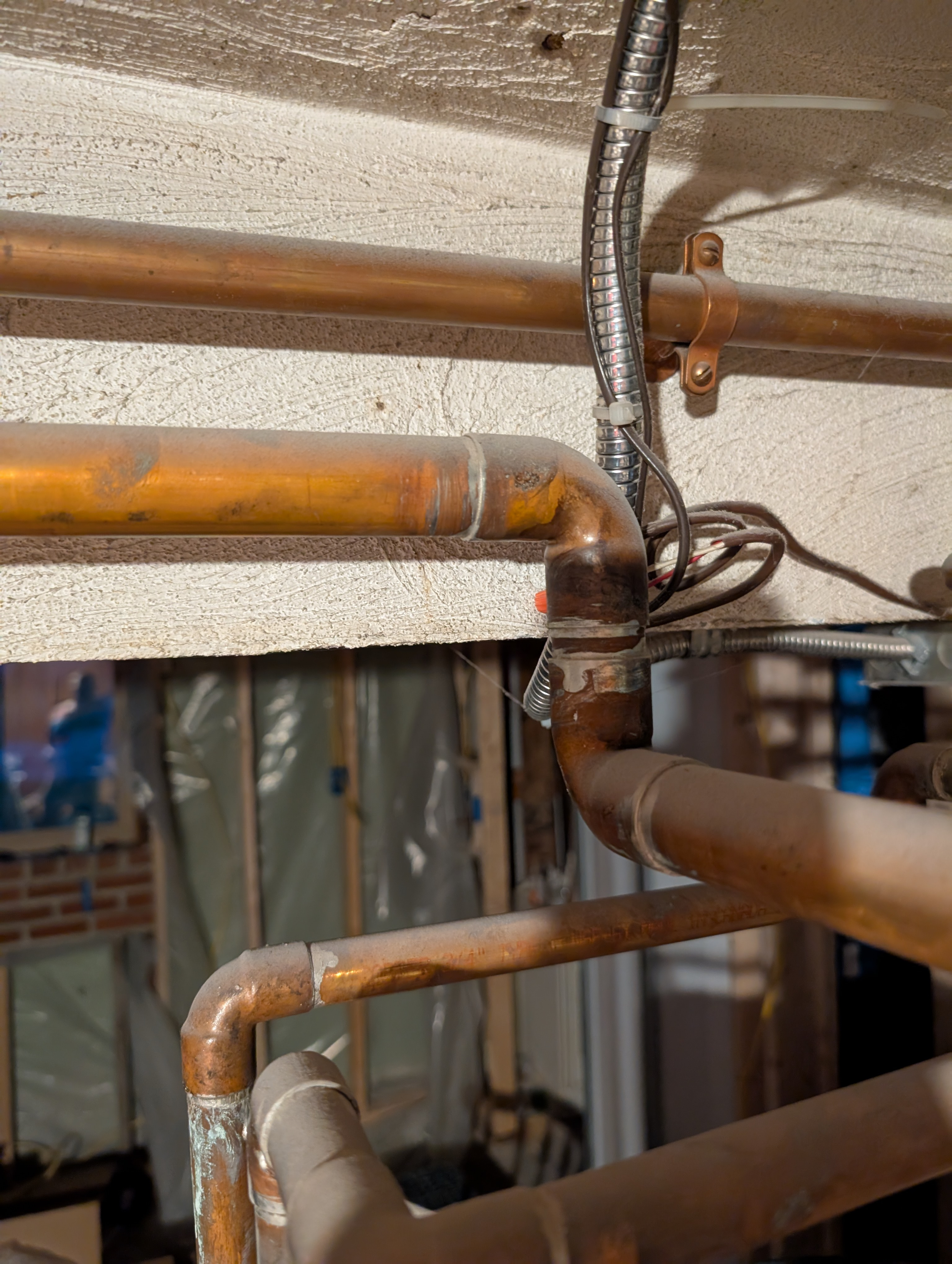

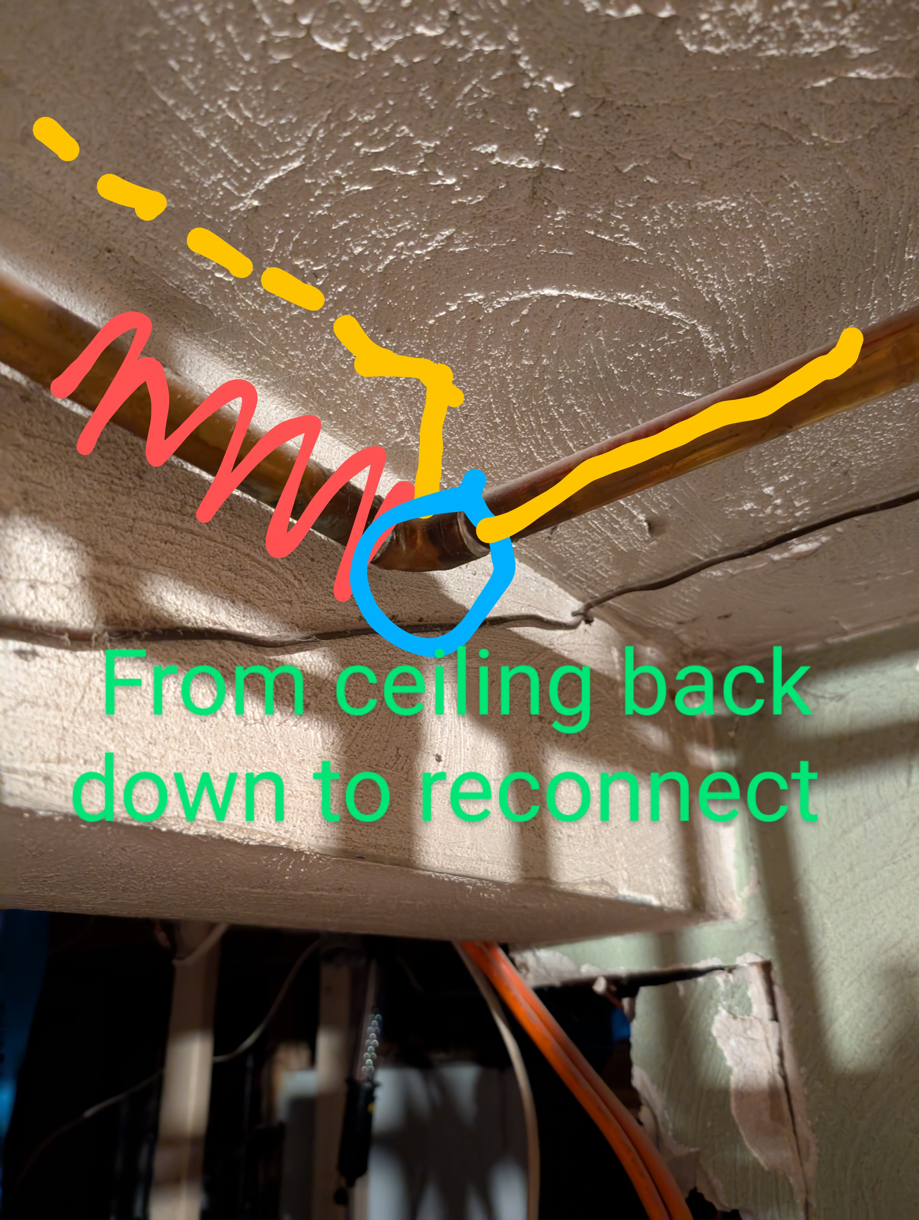

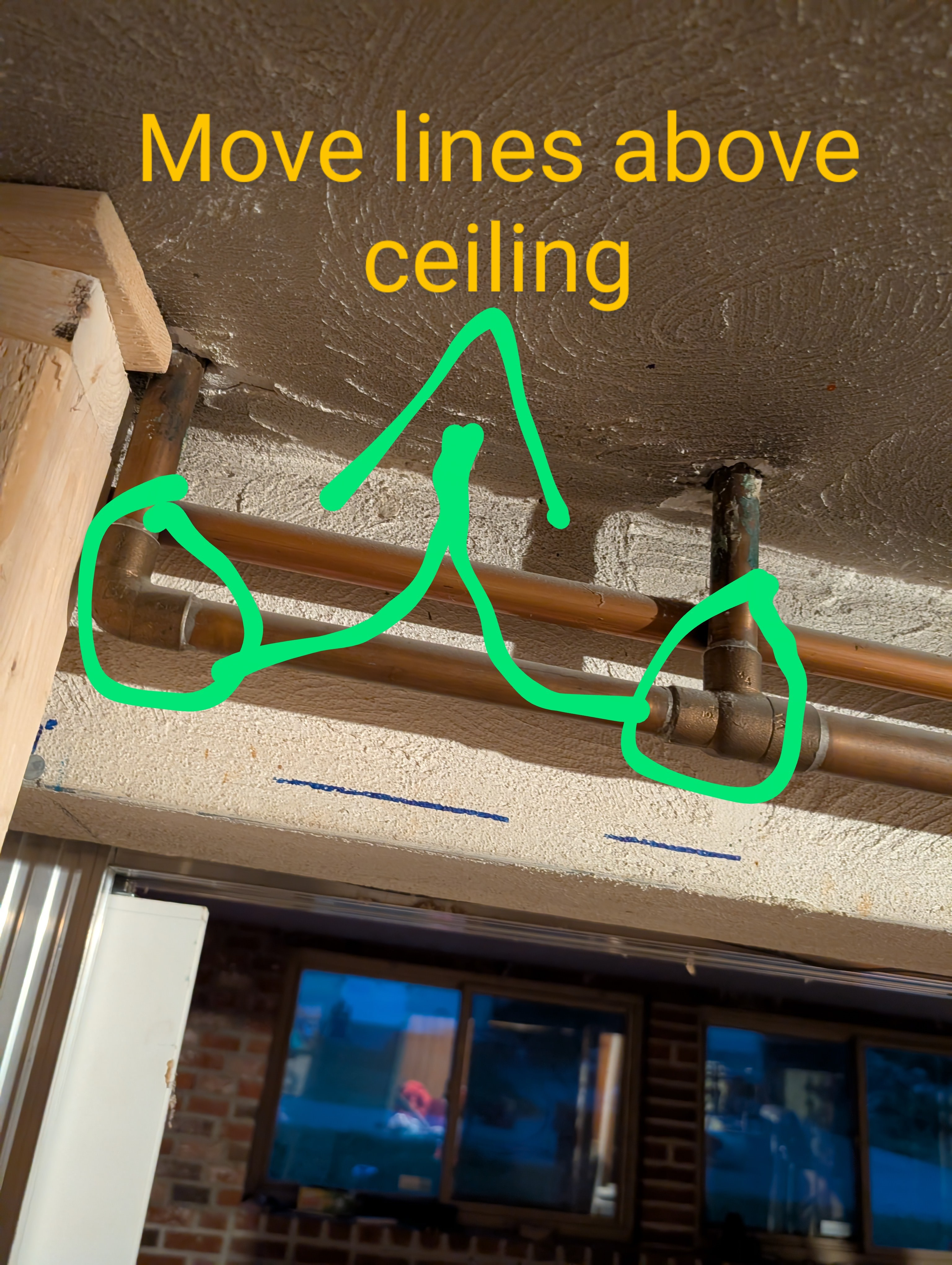

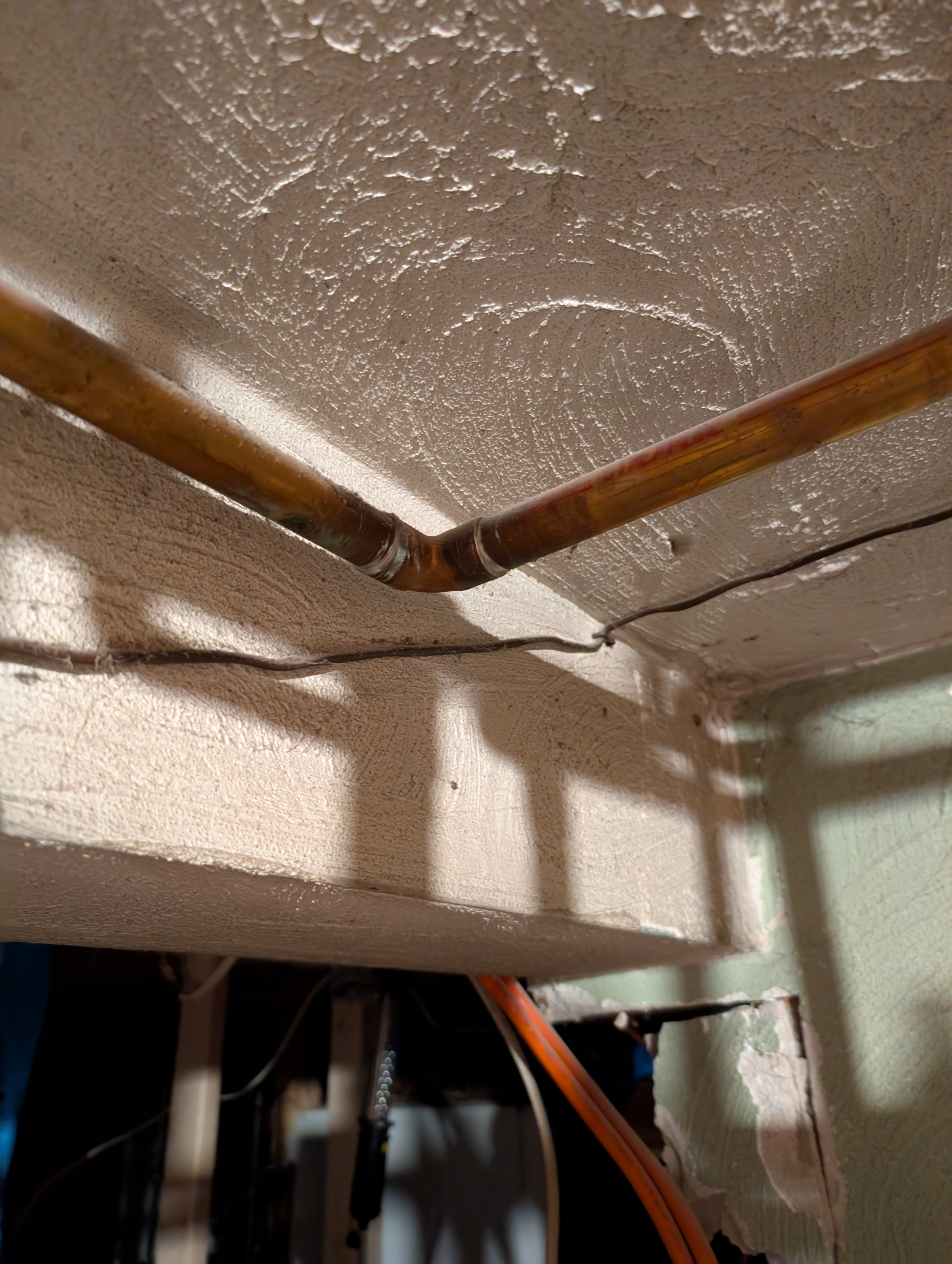

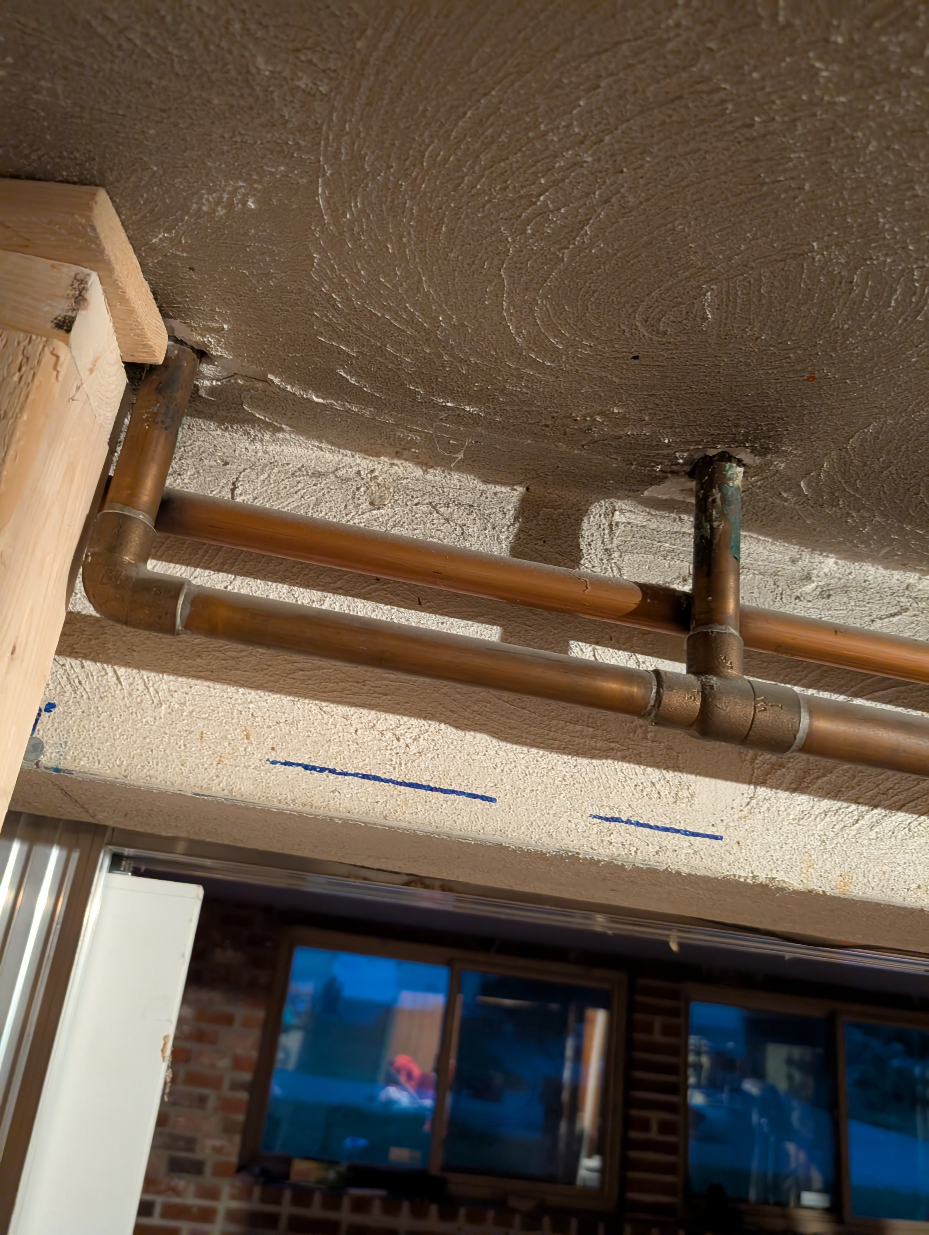

Hi, I'm doing a remodel and need to move a couple of pipes connecting my baseboard heating to the boiler.
It's copper. I don't know how to sweat copper so I was thinking of using PEX and shark bite connections.
So for those of you who know; is this a bad plan?
I need to do this as inexpensively as possible but also, and just as importantly, safely.
Does anyone have a different suggestion? Know of a plumber who could do the job on the cheap? (Woburn, MA 01801 area)
I NEED to move one line (3/4” copper), which means 2 new connections. But I'd LIKE to move a total of 2 lines (the 2nd being 1" copper) which would be a total of 5 new connections.
1000007414.jpg 1000007413.jpg 1000007407.jpg 1000007406.jpg 1000007412.jpg 1000007405.jpg
Thanks for the input!

    Moving heating pipes, without knowing what you're doing, can make your life miserable
    Sharkbites are OK — for a temporary or intermittent use (and yes, I have used them!). They really shouldn't be used for a permanent installation… and I think you have more than two connections there…
    PEX is OK. But use proper crimp type fittings everywhere you can.
    Nothing will be cheap in Woburn.
    hot_rod Member Posts: 28,078
    SharkBite is listed for that use, temperature and pressure. Large size reducing fittings are not always available.
    Copper press to pex would be another good option. You can rent or borrow the press and crimp tool.
    Compression fittings are also available. Use a pex fitting adapter to fit inside a coupling.Compression fittings are common in Euro hydronic systems.
    Screenshot 2025-06-29 at 11.08.47 AM.png Screenshot 2025-06-29 at 11.12.49 AM.png

    Hi, I'll just throw out there that learning to "sweat" copper really is not that difficult. Here's a video from the CDA showing how: https://copper.org/applications/doityourself/#podcast68854 I'll add that much of what they give applies more to bigger pipe and fittings. Smaller sizes are quicker and easier. Every plumber has their preferences, but I like C flux as it turns dark when it's time to apply the solder. I only use mapp gas also. You can back the torch away from the pipe to quickly control the amount of heating. It's important to thoroughly clean flux off the joint when finished. I keep a spray bottle with water in it to both wet nearby surfaces and to help with rinsing off the flux. Practice on a few joints first, and you might be surprised by how easy the process is.
    Yours, Larry

    Thank you everyone, I appreciate all the input! I'm leaning towards giving a go at sweating the fittings myself.

    My first concern is if you have the room above the pipes to move them there. I wonder why if there are two pipes going up into the ceiling that are close together, why they didn't run both of them up together and then split off. You might want to cut open the ceiling first and make sure there is not any structural issues in the way, and the pipes can go up in that space.
    Also, if you do decide to move them yourself, keep a spray bottle of water and a fire extinguisher handy. You will probably be soldering next to some very dry wood, and you don't want to start a fire.
    Rick

    Thank you everyone, you've been great. To answer the question of ceiling space, there is plenty. You can't see it in these photos but most of the ceiling is actually already down. I left the parts that have the pipes sunk through for the time being. The ceiling was basically the only part of our basement that wasn't destroyed by the flood but it was a poorly done job in the first place so replacing it all is a bit of a relief anyway.

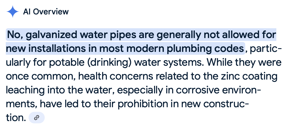

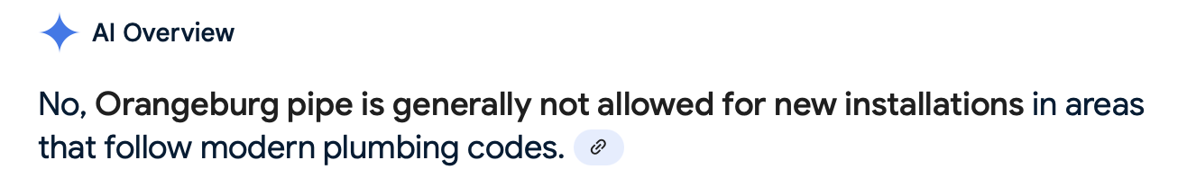

    so is orangeburg and galvanized potable water piping…
    mattmia2 Member Posts: 17,905
    that is ai. it is allowed in the code.

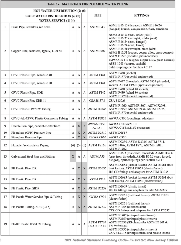

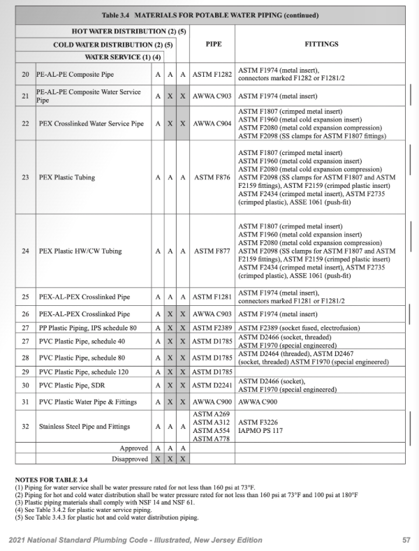

    I didn't check other areas, but in New Jersey galvanized pipe is allowed within the home, but not for a water service. I'm not sure why anyone would use it, but, you can. Even in a brand new house. At least in NJ.
    I tried to look for Orangeburg for soil pipe, but I don't know it's real name. Best I can tell, there's absolutely no mention of Orangeburg, fiber tube, or anything remotely similar in NJ's code. Probably because the stuff disappeared 50 years ago because of how wonderful it was.

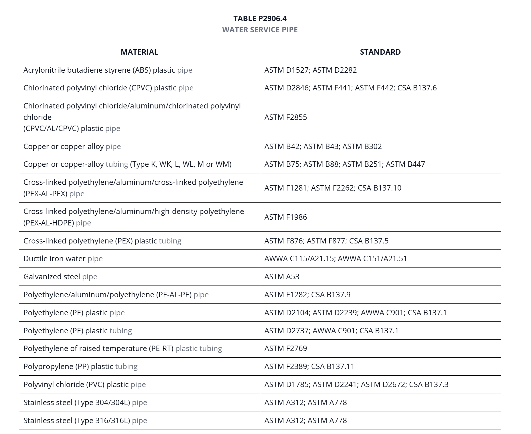

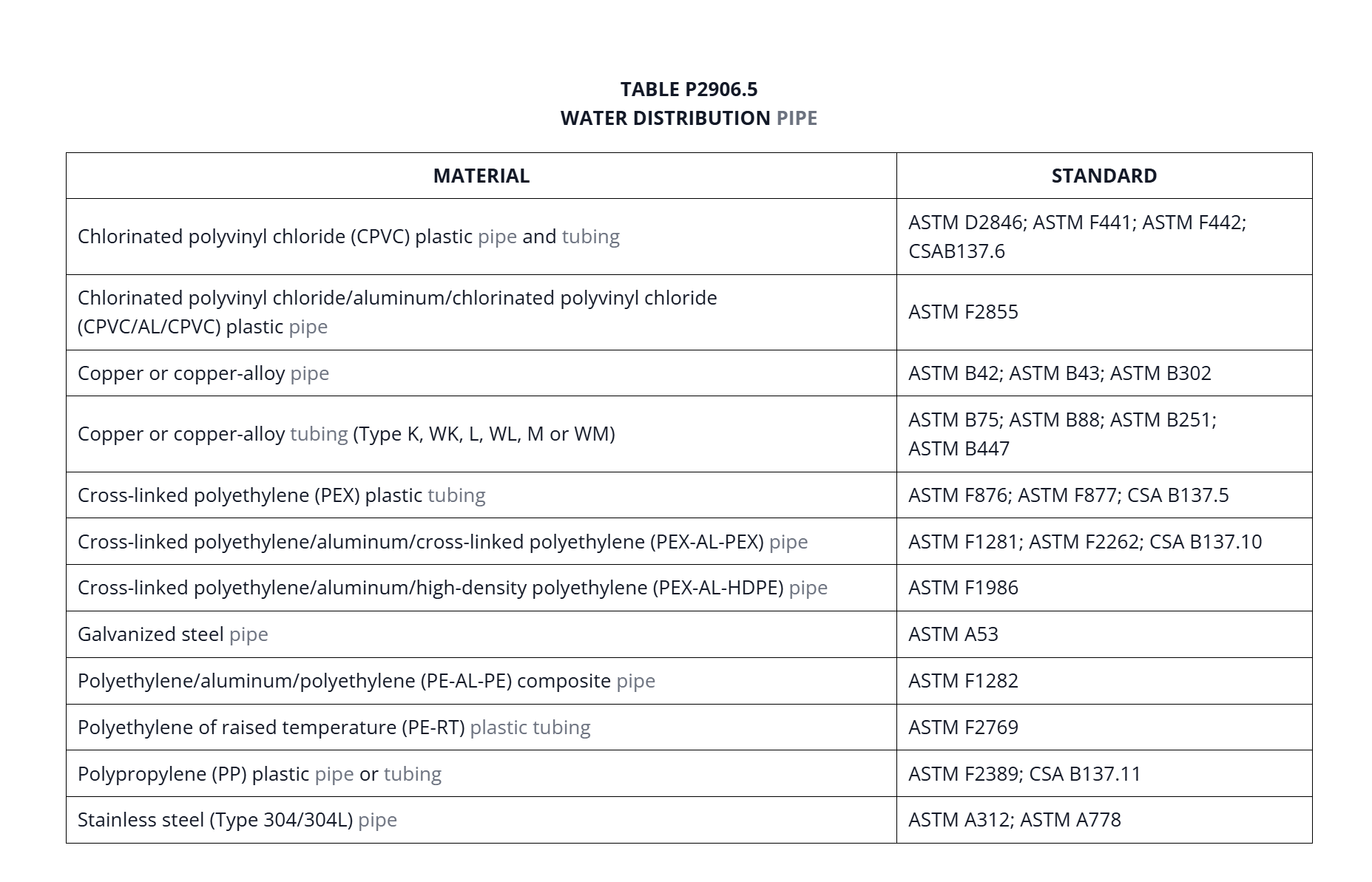

    From the 2015 michigan residential code
    It looks like they removed orangeburg. it was in the 2002 code.

    You posted charts for water distribution and water service, not waste.
    Or, did you check the waste / soil pipe section for that and just not share it because it wasn't there anyway?
    only posted the part for galvanized in supply piping. the orangeburg looks like it isn't in the current version but I'm pretty sure it was there 20 years ago. still never really got a clear answer about if the galvanizing sometimes had some lead in it. it would need to be lead free for potable water.

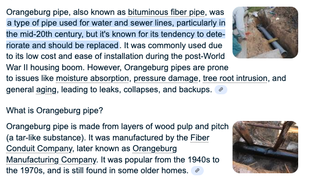

    I worked with Orangeburg pipe when I was young, cut it with a hatchet! Basically cardboard and tar.
    Started in Orangeburg, NY!
    I don't recall it being used form potable water use? Or any pressure? It didn't have much of a coupling feature.

    And if so, how many years does it last? I imagine quite a few. Just like sharkbite. Even Orangeburg reportedly lasted 50 years. Anyway all this is distraction. Sharkbite is accepted by the standards bodies for permanent installations, today.
