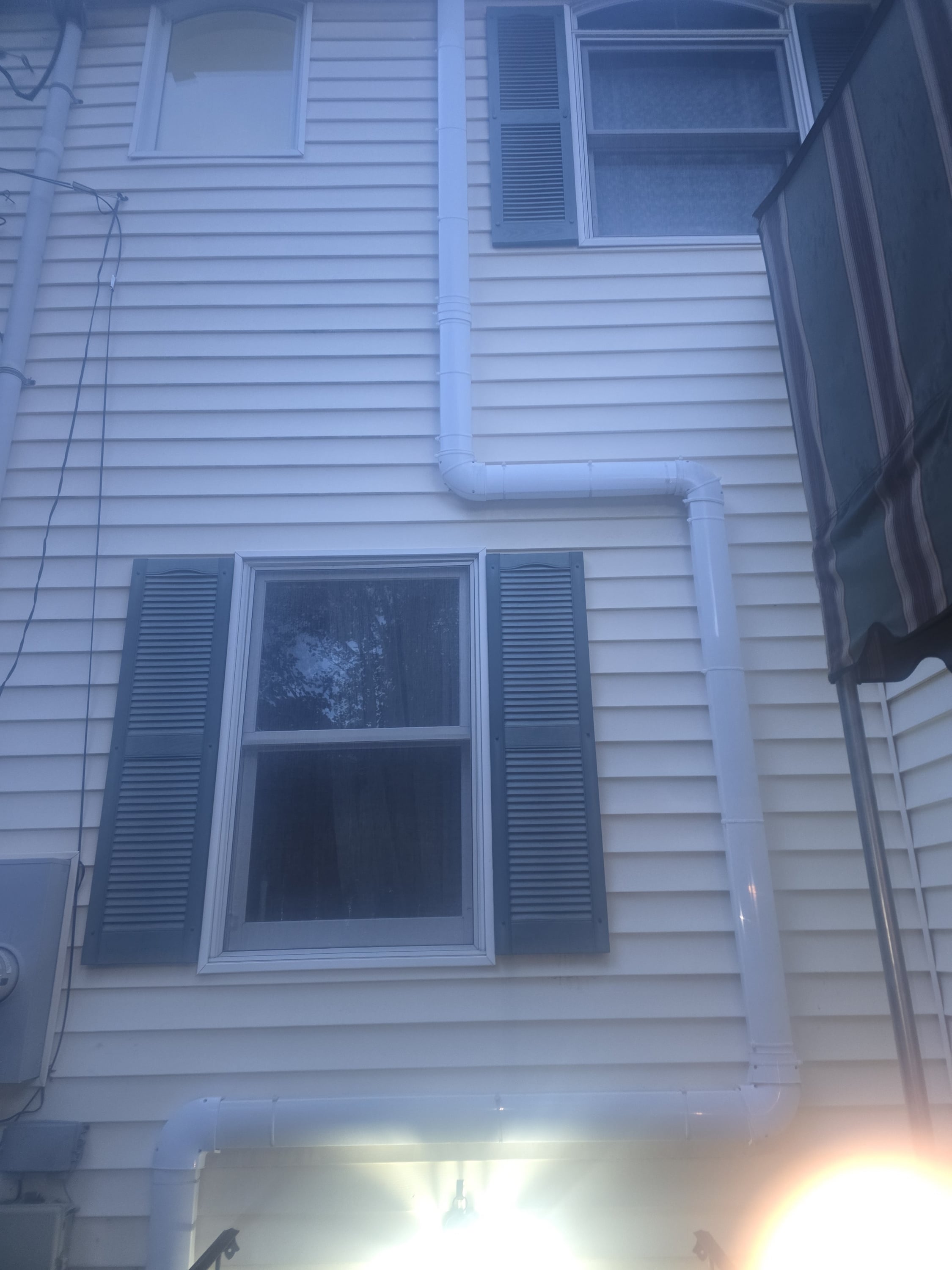

I come looking for your thoughts regarding heat-pump installation at an 1897 Victorian that we are rehabilitating in upstate NY. The home is three stories of which only the first and second floors will be conditioned. The ceiling of the second floor is being vapor sealed and insulated above the barrier.
It is my intention to install heat pumps designed for low temperature operation. At present the plan is to use ceiling cassettes in 8 locations. Taking note of several incidents of line leaks reported here on the forum I’m getting nervous about interior line set runs. I’ve been planning to run all of the line sets up interior walls. To address possible future line set leaks I’ve been eye-balling the structure to see whether I might be able to run 3” PVC or flex duct as chases for the line sets, but it appears I could only do this for part of most runs, not the whole way to the cassette in most instances.
Alternately I can take the line sets outside and up the siding, but I really, really don’t want to do that for aesthetic reasons.
The third alternative is to switch to small diameter air ducting with it’s attendant noise and loss of efficiency. Right now I have top to bottom access with sheet rock on only one side of the interior walls, ceilings open.
Your thoughts and opinions will be much appreciated. How afraid of line set leaks should I be?
Jim

    I was told at a class for the new A2L refrigerants that running linesets up interior walls should be avoided at all costs, if you do it you should run it through a PVC conduit. I wouldn't want a hidden flare connection no matter what refrigerant is being used.
    Ceiling cassette units in a residential building with Sheetrock ceilings sounds like a recipe for a service nightmare in my opinion. My brother wanted to do this in the house he's building, I'm glad I was able to talk him out of it. I'd rather go with a Unico/Space Pack high velocity system if you can't install a proper ducted system.

    That said, It is rare to not be able to run the pipes and control wiring and drainage tubing up the outside of the building in inexpensive, but not ugly, well designed chases, and then use through the wall or wall mount cassettes inside, and this is what I would recommend.

    8 ceiling cassettes is a bad idea for many many reasons. It will never run well, be noisy and a maintaince nightmare. Your line set worry will be the least of your problems. You want to find a different HVAC person.
    If you want proper operation, a fully ducted setup is the only way to go. This is harder in old houses but not impossible.
    Sometimes you can compromise a bit say a wall mount or two in larger spaces but small rooms like bedrooms need to be ducted.
    The budget solution is a wall mount on every level with resistance baseboard in rooms to even out the temperature.
