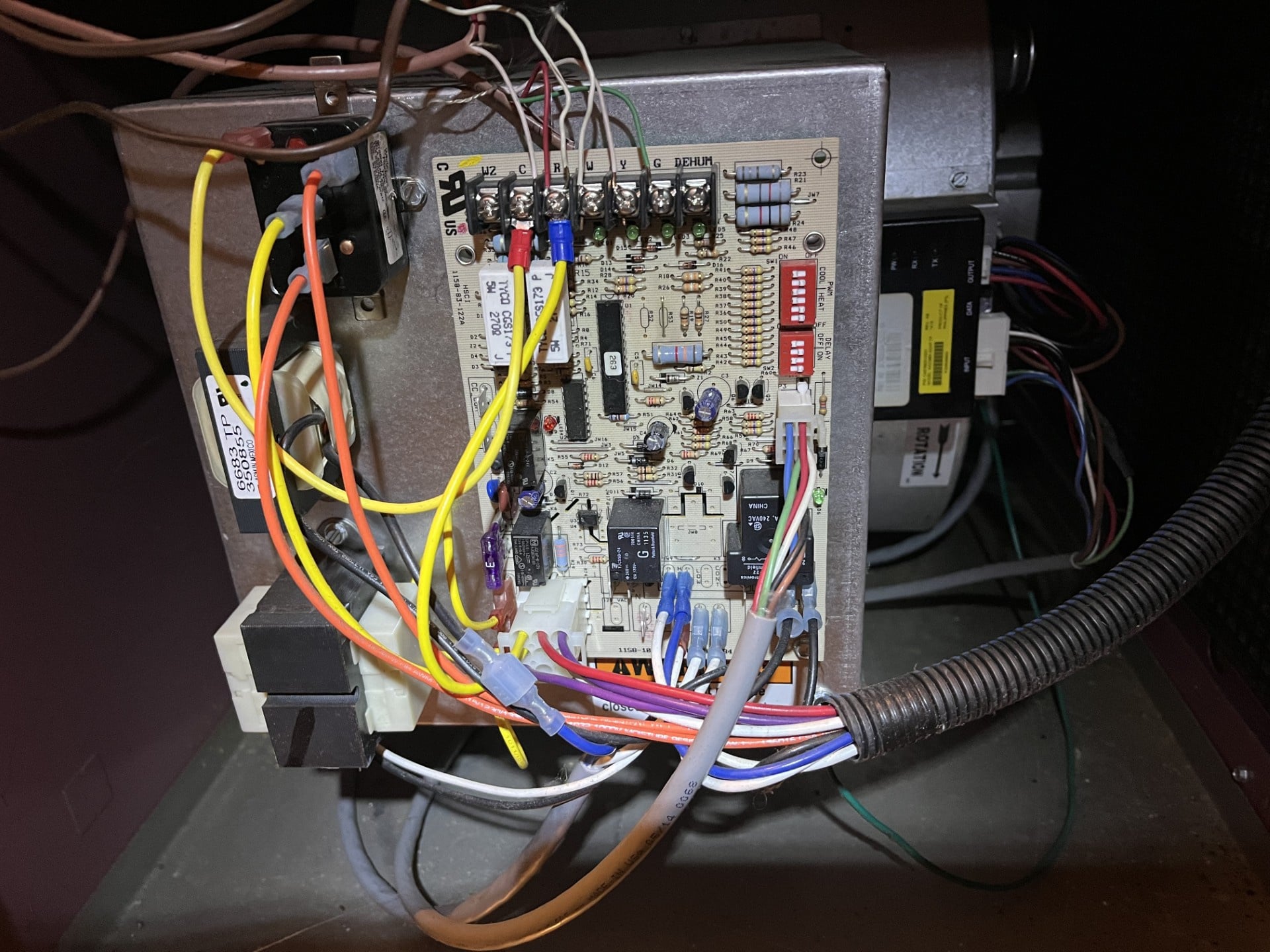

    Next step for @Mac18 is to take a picture of the circuit board inside the Thermopride and post it here for us to see what is going on in there. Can you do that Mac the Knife?
  • Mac18
    Mac18 Member Posts: 16
    Here is an image - please let me know if you need it zoomed more or anything else.
    Thanks
    I may see a problem. need to do more research.
    Can you verify the yellow wire with the blue connector on the R terminal is going to 9 pin plug? And if so which number on the 9 pin plug, 3 or 6?
    Do you have the Riello Oil Burner?
    edited May 2025
    I think you have the Riello Oil Burner and this is your diagram
    Remove the Yellow wire yellow wire with the red connector on the C terminal of the Thermopride control. That should stop the oil burner.
    If that stops the oil burner, then the Thermopride control board is bas and needs to be replaced.
    If the burner continues to run then the small black relay is bad and needs to be replaced.
    (unless the wires connected to the Riello burner are not connected properly. That would be another picture needed with the burner cover removed.

    This morning I started by tapping the relay a couple of times before turning on the power.
    Turn the power on and everything appears to be working normal.
    Only thing is, the blower appears to be running longer after heat goes off, beyond the purge cycle.
    I could be wrong but I thought before, the blower went off as soon as the HZ311 relay clicked and purge light went out.
  • Mac18
    I did another heat run - heat comes on with thermostat call, and shuts off when temp is reached. Heat LED goes goes off for the zone on the HZ311 and purge LED comes, and stays on for 2 minutes, until relay clicks, LED goes off. Blower stays running for 4 additional minutes then goes off. I think this is normal.
    Tapping of that black relay tells you that the relay got stuck. That may happen again. I would order a replacement relay and have it on hand for the future.
