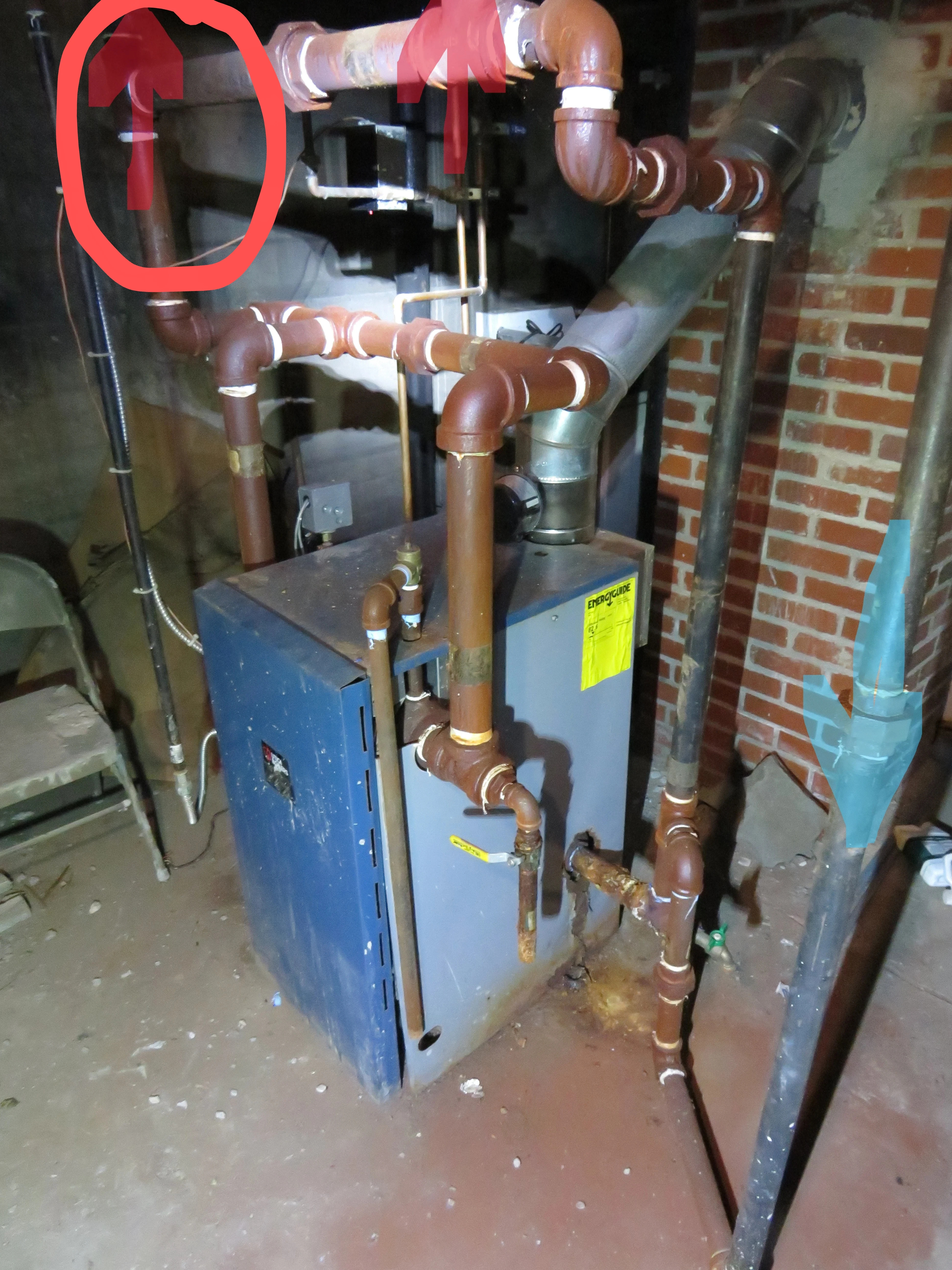

I am a home inspector and just inspected an apartment house with steam heat. The system is reported by tenants to heat well, but every diagram i have seen for a two-pipe system shows the supply mains pitched down as they go away from the boiler. These pitch up. Any idea what gives here? Is this piped incorrectly? If so, what would be expected fallout?

    I was not able to get a picture that clearly shows the supply mains running up hill from the boiler. But they surely do. I am providing a pic of the boiler piping arrangement. I do not see the end of main "drip" that you refer to. I would not fire this boiler for inspection because the sight glass was occluded and i could not confirm by it that it had adequate water. I did not want to damage the boiler.
    The tenants say that getting heat is no problem and none of them complained about noises.
    Thanks for your feedback!!
    The red arrows (PIC 2) are two main supply runs that continue to run uphill. The blue is the combined condensate return pipe to the Hartford Loop. Each of the two condensate returns had an air vent (PIC 1) installed just above the common return shown.
    I did not find an F&T Trap on this system (???)

    It's got two "headers", the taller one is probably from a previous boiler installation.
    There is no "header drip" or "equalizer" on the lower one and that makes a place where the condensate has to run back down against the steam.
    But it may be fine. If condensate does get trapped there and pushed up to the higher "header" (imagine a percolator situation), that higher "header" has a drain to let the condensate return down to meet up with the wet return. I don't foresee any problem with steam quality from this technically incorrect installation. The boiler looks very small and the steam velocity isn't going to be very high so the condensate might flow back to the boiler without issue at all. We've all seen way worse.
    If these pipes were insulated there would be less condensate to worry about also, at least when the pipes are still warm.

    Those main vents look way too small but i'm not an expert on identifying vents by sight.
    As @ethicalpaul said, the header is wrong, it has no equalizer connection so there is no way for any water that gets in the header to exit, it will get carried in to the system by the steam.
    From the steam trap that is either a crossover trap from the mains or a remoted emitter trap, I assume this is 2 pipe. If it is the returns need a way to vent.
    ethicalpaul Posts: 9,076
    Well that second "header" has a drain so I don't think water will go up into the main(s).
    Someone was having fun…. actually you sort of have two headers there, and the upper one has the equalizer connection. Any condensate coming back through the mains — and, as has been said, there won't be much — will get over to that equalizer end and get back to the boiler.
    A little unusual — but steam is sometimes oddly forgiving, and that arrangement should be fine.

    I would think that the main on the left side would be problematic. I would think that they would both be problematic, but the left side should be worse. Does that have any benefits from the secondary header and header drain / equalizer. And never trust tenants. I find there are two types of tenants. One type will complain about anything and everything. The other type, more common amongst immigrant community, will never ever complain about anything, because they don't want to ruffle feathers and get people upset.

    No, crossover trap and drip into wet return covers it.
    looks like just a radiator trap.
    is it one pipe or 2 pipe? it would be normal if it is where it belongs on 2 pipe.
    that pipe above the header looks like part of the header from the previous boiler that wasn't removed.
    note that the insulation that is there is very likely an acm
    Steamhead Posts: 19,007
    Those dry return vents are Hoffman #4A. Way too small.

    Funny with that small boiler the installer used both tappings we usually don't see that. not sure if the lower header is 2" or 2 1/2".
    if they had done the equalizer right it would be ok. Any condensate coming back to the upper header will be pushed toward the incorrect equalizer.
    We have all seen much worse that worked.

    I agree Ed, they almost got it right. Look, they even did the skim tapping correctly!
