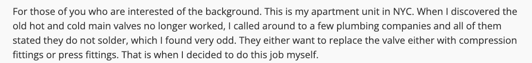

    For those of you who are interested of the background. This is my apartment unit in NYC. When I discovered the old hot and cold main valves no longer worked, I called around to a few plumbing companies and all of them stated they do not solder, which I found very odd. They either want to replace the valve either with compression fittings or press fittings. That is when I decided to do this job myself.

    This could have to do with the Hot Work Permit being required to work in that building?
    Copper press connections are a safe, reliable method for that type of work.
    The only way to know the quality of a soldered joint is to cut it open. That is what is required when you take a plumbing license test in some jurisdictions. Same for a poured lead joint test.
