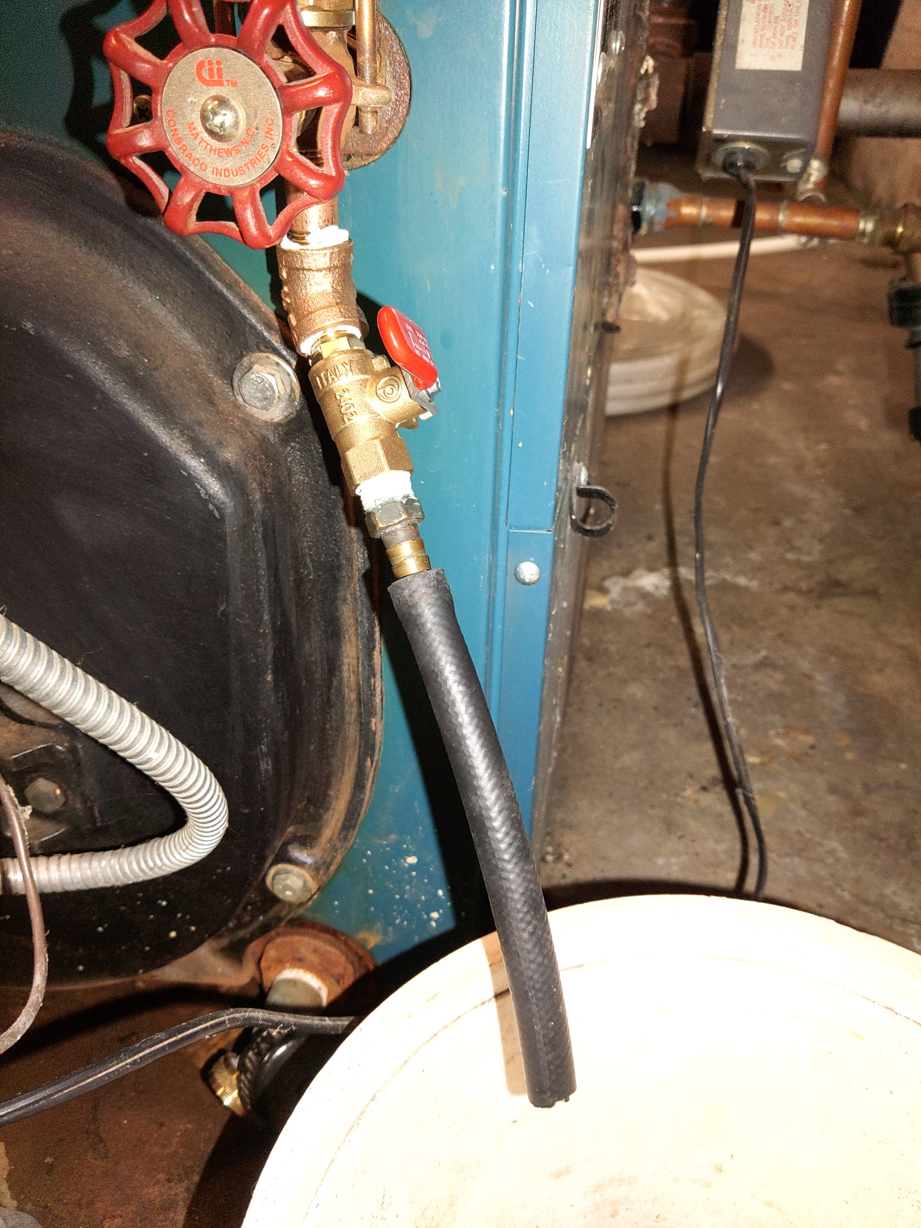

gauge glass blowdown valve
I have been watching several videos from @Gordo and I'd like to add a blowdown valve to the gauge glass on my V7. What parts do I need? Looks like I do have enough clearance to do so fairly easily.
1/8 m-f ball valve and a 1/8 brass plug.

You could use the fitting on the bottom of the gauge glass assembly. To use, close the upper valve and use a box wrench to open that bottom fitting; ccw to open and cw to close. Open it when the boiler has some pressure to force the junk out. I believe it takes a 7/16" wrench. Doing what @delcrossv makes a better looking job my way is cheaper and can be done now if you want.
That looks great @delcrossv ! Definitely going to be doing that here soon. My gauge glass appears to have some schmutz at the bottom of it. @retiredguy I can simply just blow it down when the boiler is steaming
1 -
but don’t use 1/8”, use 1/4” by removing the whole existing valve. It will provide a better flush
If you watch the correct @Gordo video (probably an older one) he explains it well and I think gives the valve's manufacture and part number. I think it is a RED-WHITE VALVE CORP. valve he uses.

Back in my steam boiler days the below video was my guide, thanks to Gordo. Used a bar stock brass street 45 1/4" NPT male thread, and the elusive all metal Dahl 521-61-04 valve. Finished it with 1/2 of an old washing machine hose.

I stopped at FW Webb on the way home from work and picked up a 1-1/2" long 1/4 npt nipple, brass 45, and a full port ball valve, I also got from the fittings bin at work in the shop a 1/4 NPT 3/8" barb and a short piece of 5/16 fuel hose. Quick easy installation.
Thanks for the idea @Gordo through your videos!
Works great.
