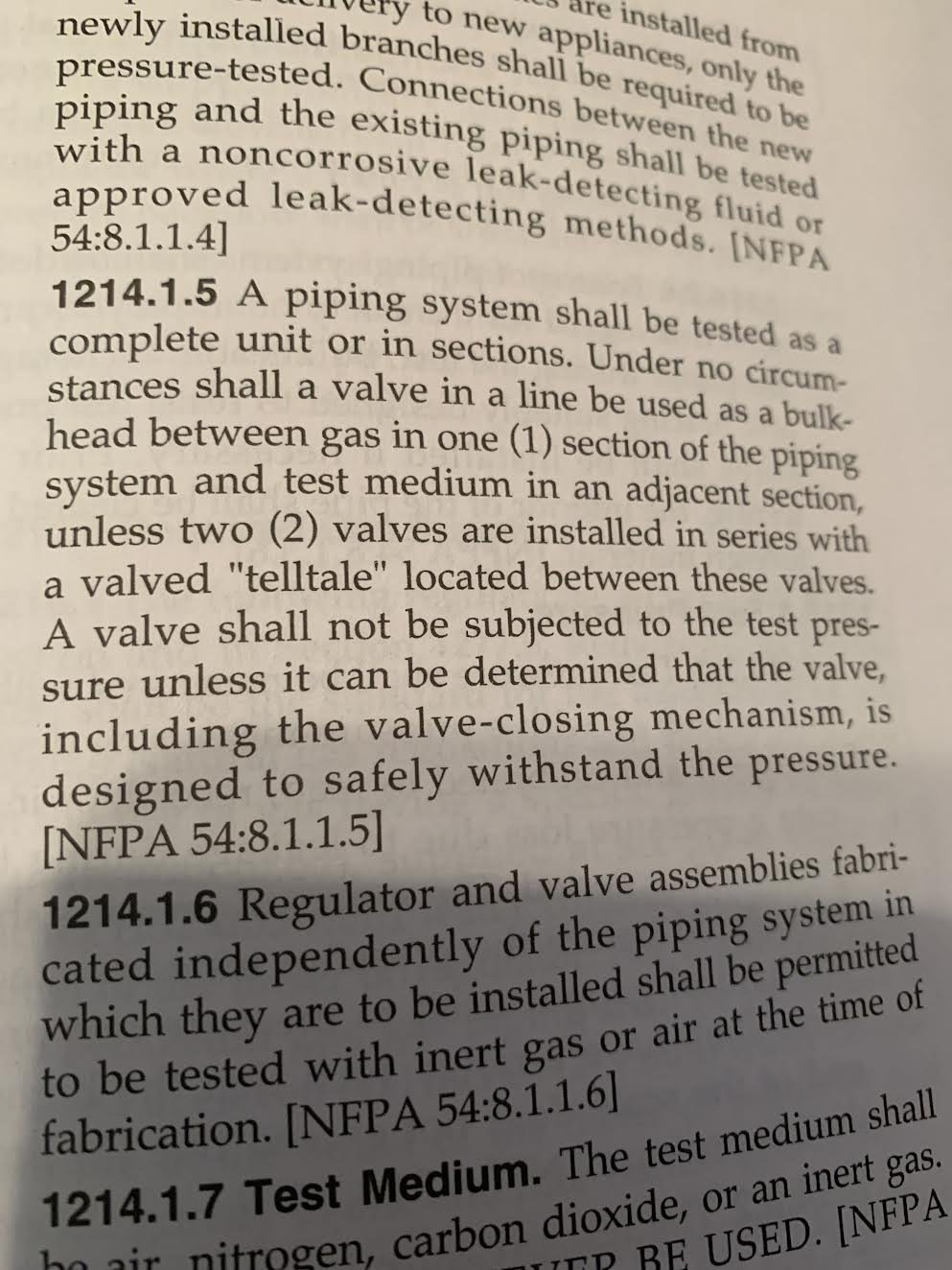

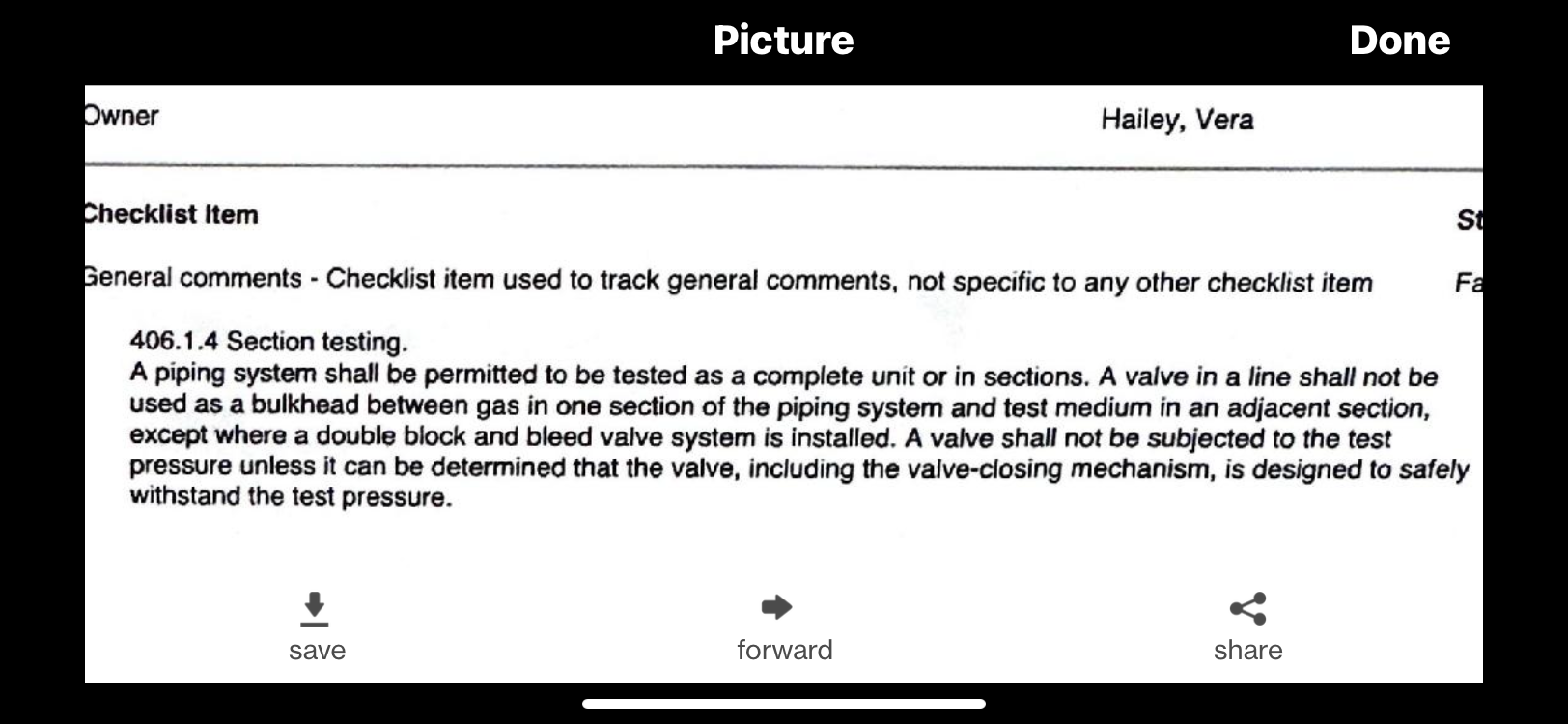

We installed a new run of 1-1/2” black gas line to supply a generator on a house. We connected it to the existing gas line where it enters the house and put a shut off valve there.
We put a pressure test on it (which held) and called for an inspection. The inspector failed it and cited this as the reason:
Has anyone here ever heard of this being applied to a gas line before? We do generators all around our area in several different jurisdictions and have never come across this before.

    Yes...It's part of the ICC Fuel Gas Codes. Painting is ONLY after the pressure test. If you Paint in before, you'll have to pressure test it at much higher level. 90 P.S.I. minimize (without looking it up). I'd like to see some pictures of what you did and all the tie is before, I give you a 100% answer that you can hang your hat on. Mad Dog

    Is that code trying to prevent someone from opening that valve before bleading the pressure off. Then having the gas side having the 15 psi go into the existing side of things and cause all sorts of problems?
    Mad Dog_2
    Yes.
    Technically the gas pipe is supposed to be isolated from everything for the test and a gas valve is not supposed to be a bulkhead.
    This is a holdover from the old "gas cock" days when the plug cocks could leak air test pressure into the live gas line.
    Common sense is that ball type valves don't leak and most inspectors in my area allow it or look the other way.
    I guess some inspectors don't care that this causes you to add another union that is a leak possibility

    It's included in our UPC and it looks as though they get it from the NFPA; they are the biggies.
    We've done it like you for years - as left and right couplings and nipples are a PITA - an have never been called on it. It's probably a remnant from when wedge-style valves leaked.
    Regarding the last sentence of the code: Find out the working pressure spec.'s of the valve. If it's like 100 psi and you're only testing at 15, maybe you could convince the inspector that it's OK.

    @Ironman, I believe if you had a valve behind your valve, and a tee with a gauge in between, that will meet the requirements.

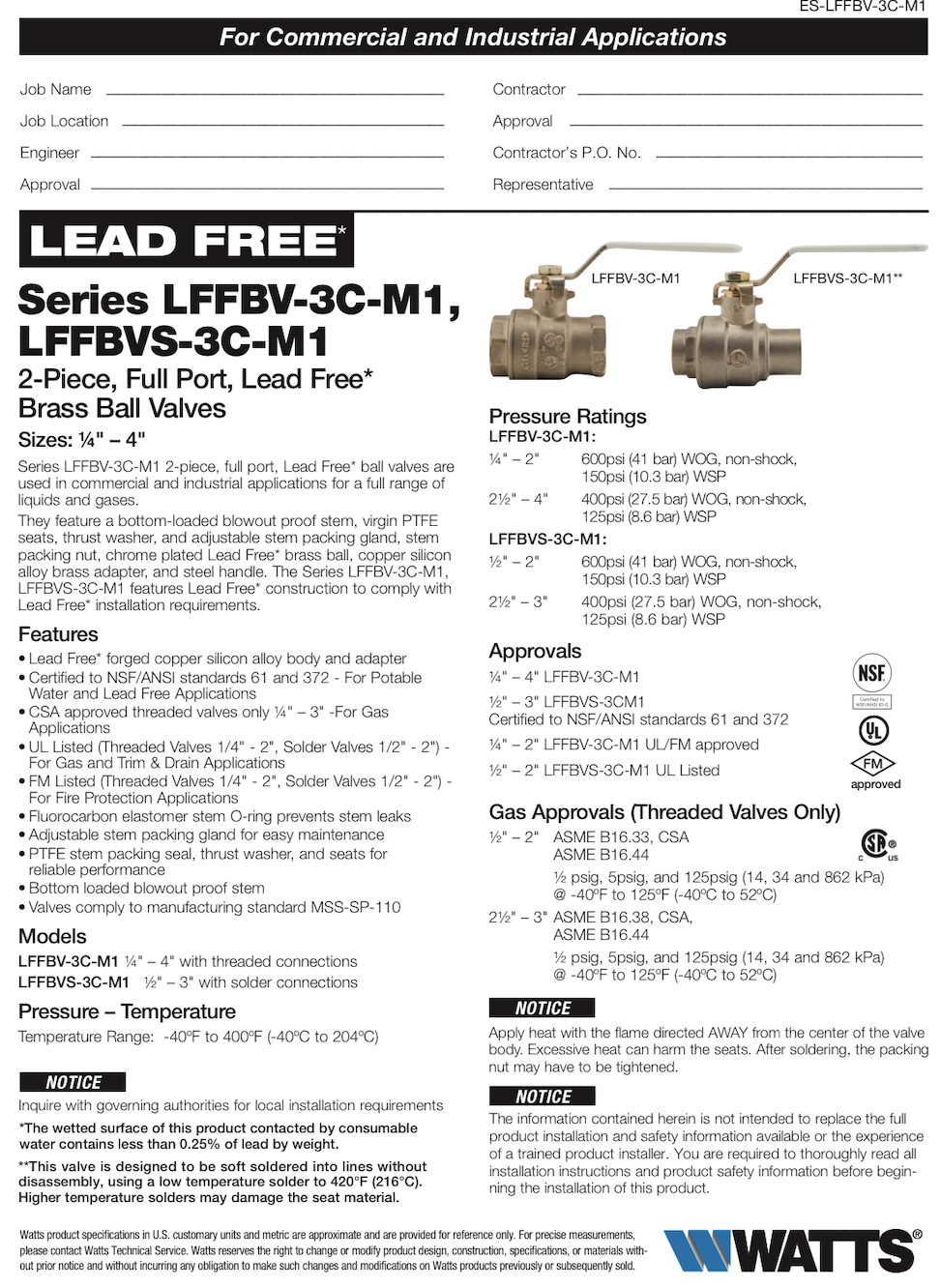

    @Ironman Does the valve have the "WOG" letters on the side? If it does, and I bet it does, you can point it out to the inspector so that they can put a pass sticker on the job. The valve with "WOG" on it stands for water, oil, and gas. It's rated for the purpose of gas. I had an inspector question this once, then pass the job after some hemming and hawing and head scratching. I asked, Why wouldn't you want the valve tested? That's why it's there.😉 As long as the test is isolated from any other connections, it shouldn't be an issue.
    As to the painting of the gas pipe. I've had some battle ship gray on the truck for after the inspection. I guess paint can hide a leak??

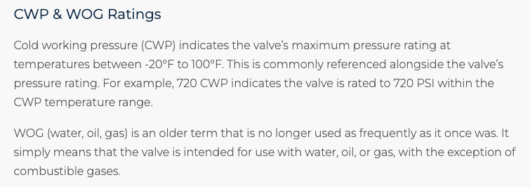

    hot_rod Posts: 28,705
    the "G" in WOG is for non combustable gas. Although I doubt many inspectors check valves for the actual NG listings.

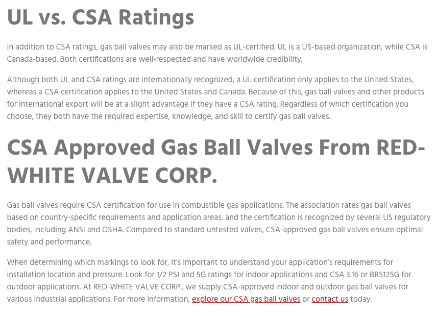

    Intplm. Posts: 3,162
    edited April 2025
    Ut oh ! That means that all of those ball valves used on gas lines "NG" are not allowed. My building inspectors are going to scratch their heads more now. Surely there are ball valves with WOG used and approved for Natural gas? Apollo brand comes to mind.
    Canucker
    if i remember right the natural gas rating is part of an ansi or astm standard and there are 2 depending on pressure.

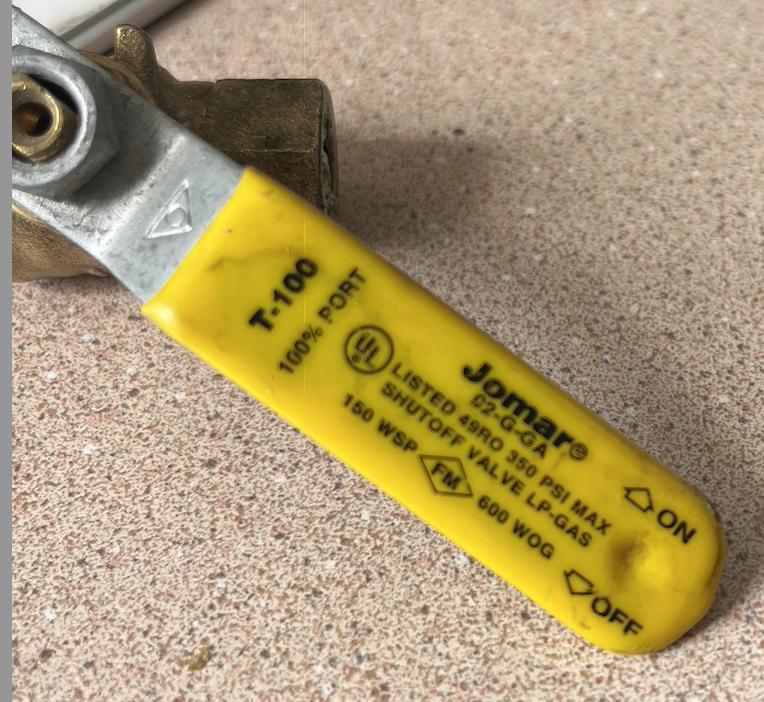

    Most quality ball valves will have the listings needed to be used for NG or LP. Regardless of the WOG label.
    Jomar has been my go to valve for years when I bought valves by the case. They have ASME, C SA, UL and FM.
    When I did fire protection work the specs always called for FM listing, inspectors looked for that.
    So buying valves with the multiple listings covers all the hydronic and fire protection.
    Here is an older basic Jomar, pre lead free days, and Watts, for example

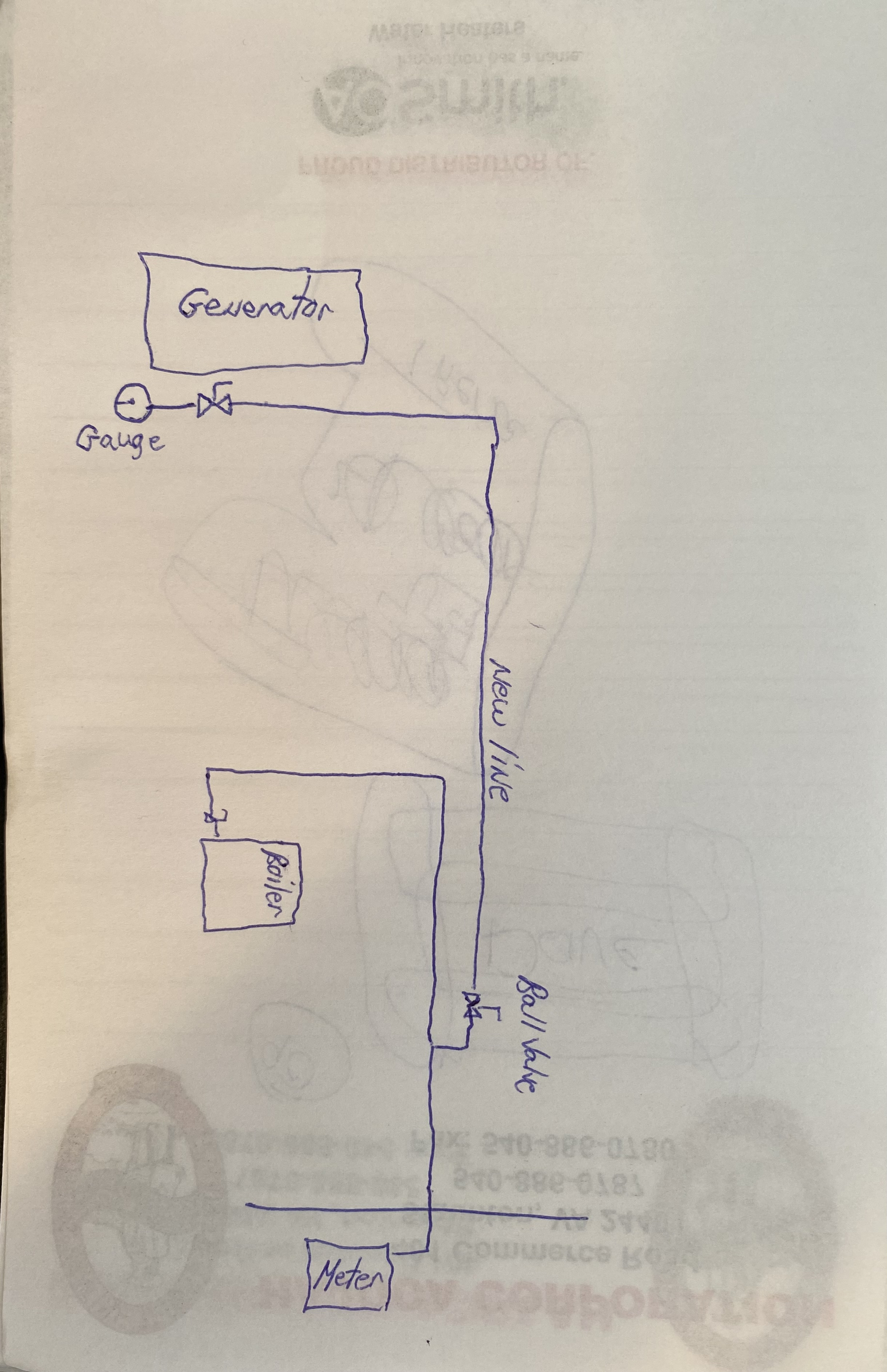

    Here’s a diagram of the piping:
    Thanks for all the input.
    I think that I’m just gonna disconnect the new section until it’s pressure tested and approved. That’s simpler than adding more valves and with the current warm weather here, the boiler won’t be needed now.
