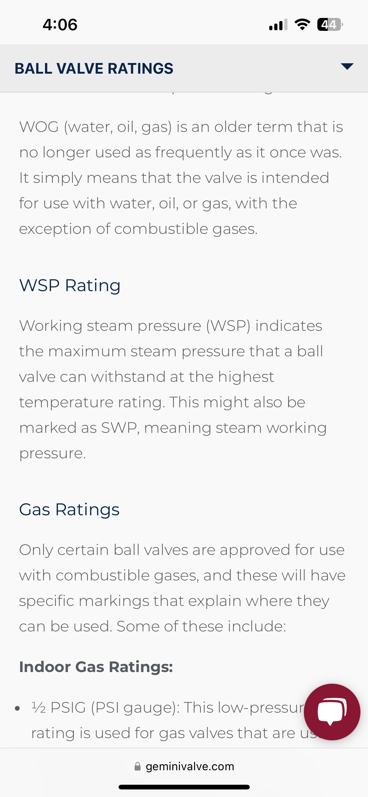

  • Hi, I'd feel better putting a full port ball valve rated WOG downstream of the meter, if simply as a safety measure.
    Yours, Larry

    Oddly enough the G in WOG was non flammable gas
