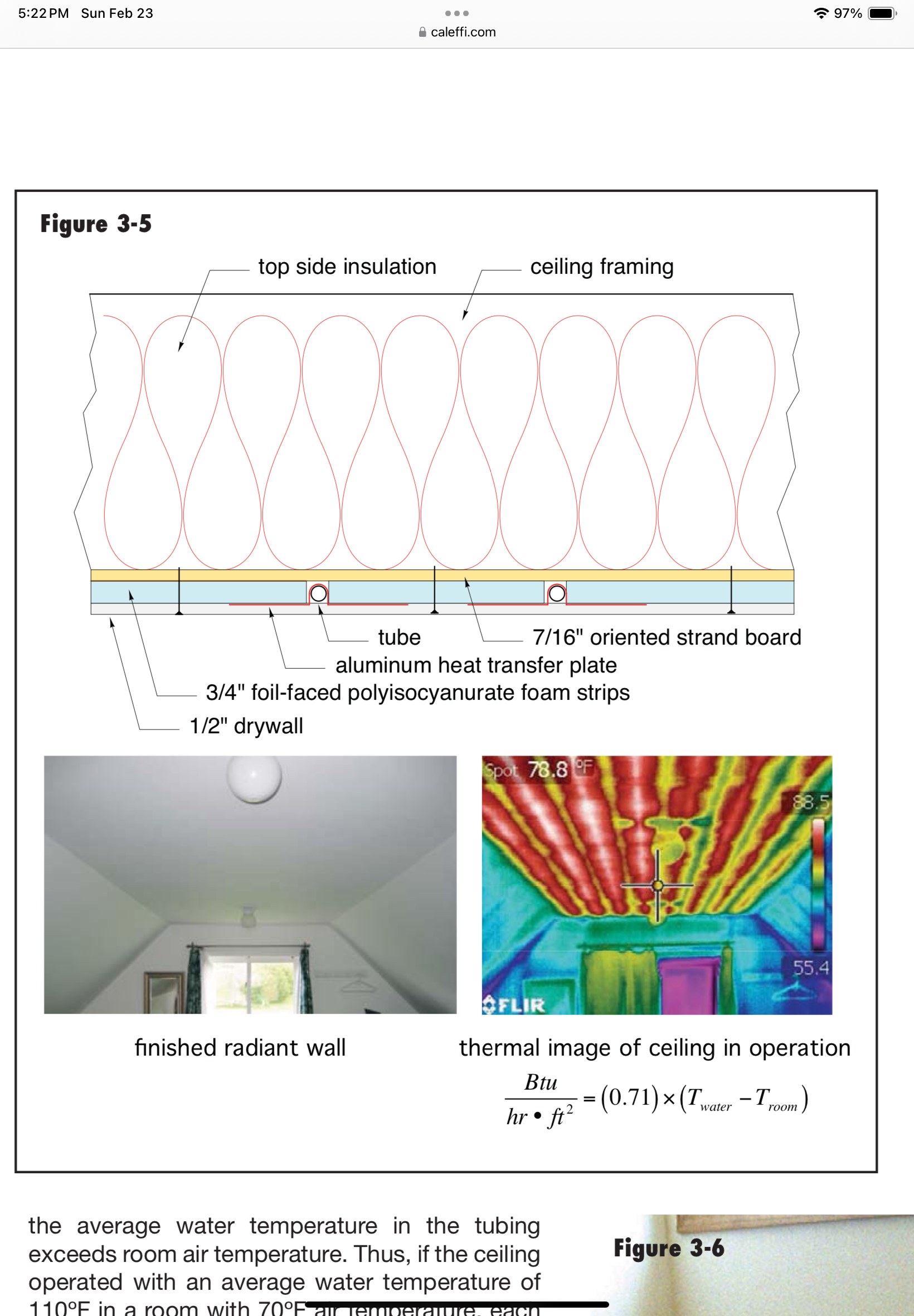

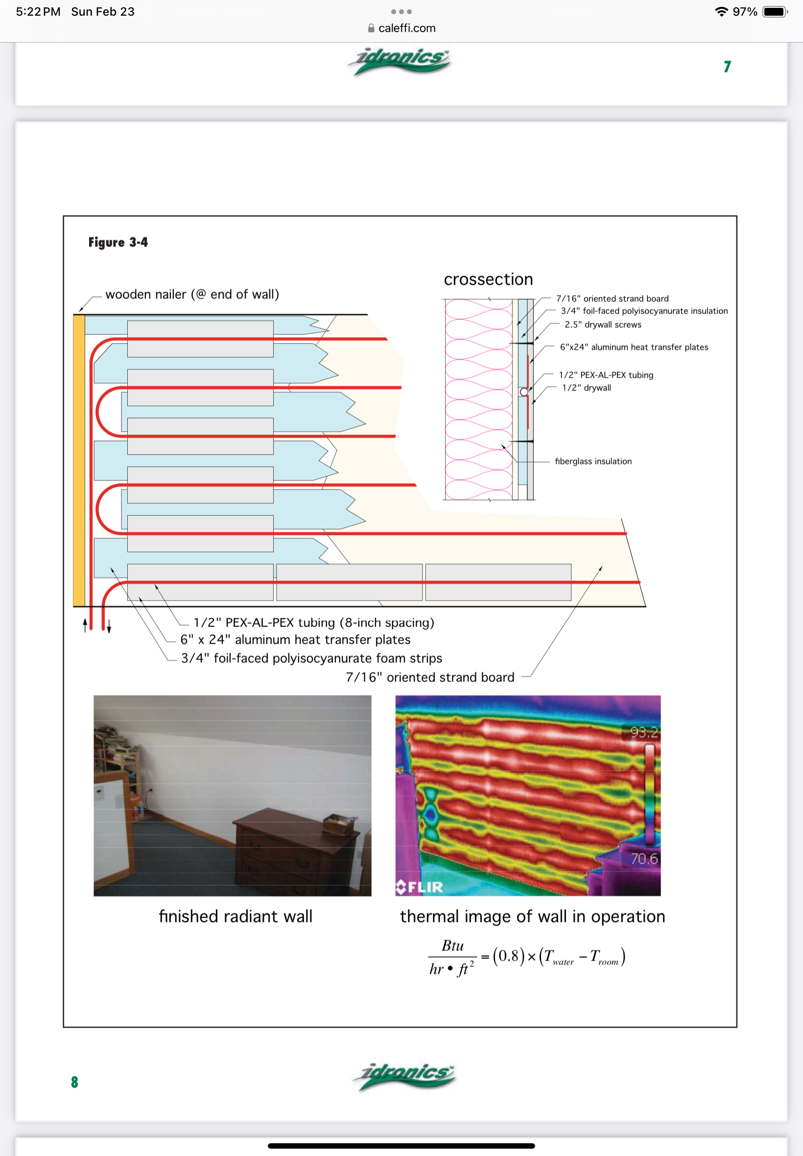

    Radiant ceilings and or walls is a nice clean, quiet, unobtrusive option. Typically run 110 supply or lower.
    I have seen radiant walls with the tube around the bottom 3’ of the wall with a wood wainscot over the tube. No need to worry about picture hangers getting to the tube, with tube down low🫣
    If it is a super insulated low heat load, I would not go with a radiant slab, it will rarely feel warm.

    Radiant ceilings are , IMO , more comfortable than floors in newer , well insulated homes . I design and install many in New Jersey and everyone is happy with them . Can be less expensive to install also .

  • doesn't it act like those baseboard heaters on top of the walls. I used to live in the house that had that. Your head would overheat and your feet were always cold.
    hot_rod Posts: 28,699
    The electric radiant ceilings were known to get uncomfortably hot on your head, especially for tall people. Same with IR tube heaters.
    A properly designed hydronic radiant ceiling should not need to run uncomfortably hot. It is all about heat load, and surface area. The more area you have to spread the BTUs the lower the operating temperature.
    With ceilings there is not typically any furniture, walls, appliances, etc in the way to block output, so you get a massive radiant panel. With no bare feet touching the ceiling, you can run higher surface temperature if needed.
    An 88° ceiling surface gets you 36 BTU/ sq ft!
