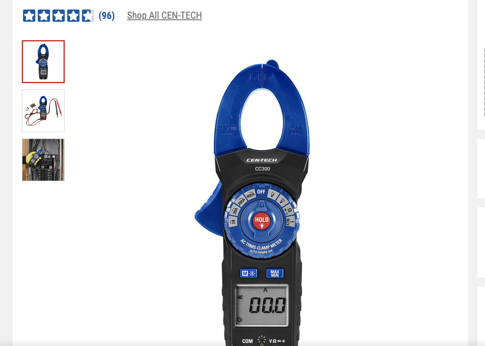

    hot_rod Posts: 28,699
    20 bucks at Harbor Freight and you could measure the current draw yourself.
    120 bucks buys a top quality Fieldpiece or others.
