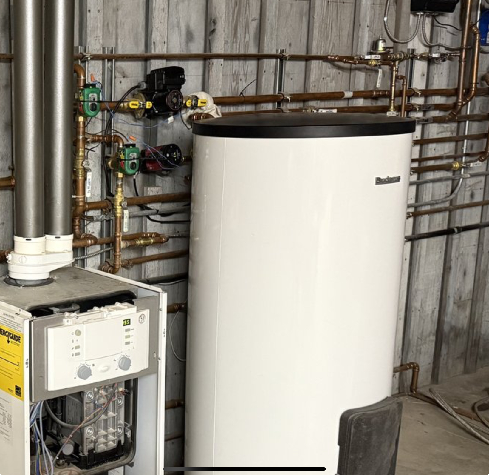

    the second attached picture shows two of the three manifolds servicing the house. I turned all valves for the individual loops off except for one and noticed an increase in that single loop to .4gpm. When I open them all back up they indicate barely anything at all.
    I’ll see what happens over night - perhaps tomorrow I’ll take that TACO valve completely off and dissect it like Hot rod recommended - and see how / if that improves the flow at the manifolds.
    Frustrating…
    The other issue is the boiler is consistently fired up to 155 right now so without flows through the floors the system will keep calling for heat and the boiler will continue burning propane unnecessarily, I think… which is not cheap.

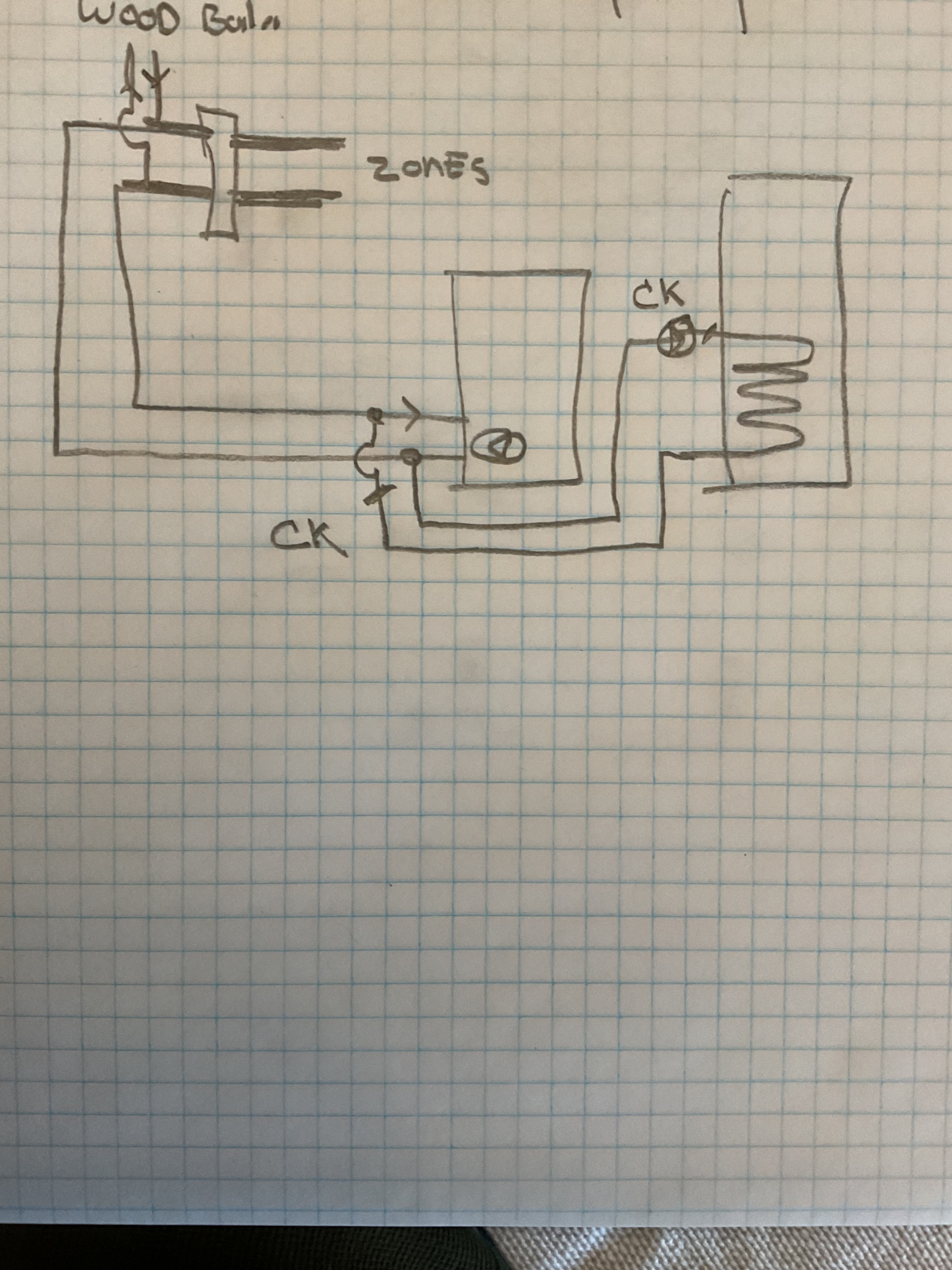

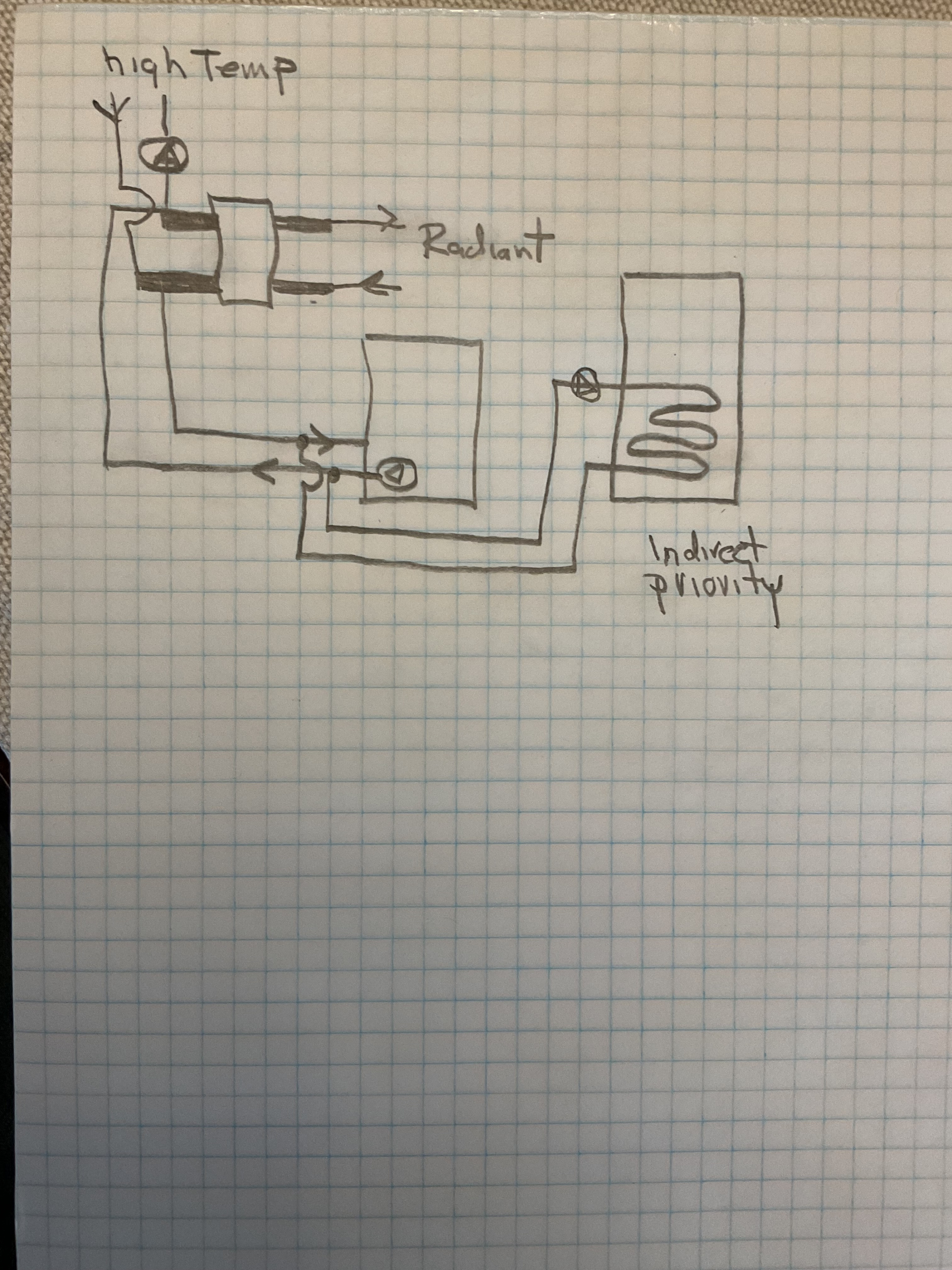

    the boiler piping is a bit confusing. There is a pump in the boiler, a pump above the sep for some reason, and another to the left of the fighter jet? That would be 3 pumps in series?
    The separator has a filter function in it, you could pull the strainer out of the Y strainer to eliminate that flow restriction.
    Someone made a nice RIB really sale 😏
    This piping is an option. Although the boiler and indirect pumps will be in series while the indirect calls. That should recover the tank quickly.
    Unless you get inside the boiler to tie in the indirect circ
  • ”the boiler piping is a bit confusing. There is a pump in the boiler, a pump above the sep for some reason, and another to the left of the fighter jet? That would be 3 pumps in series?”
    Yes three pumps prior to the hyd separator. The top left one in the picture is unused now and will be used later when the wood boiler is installed. The pump in the boiler and the one above the separator is used, and the Low loss header in the boiler is utilized as well.

    the pump in the boiler is all you need to the sep. wood boiler ties into sep, loads come off right side of sep.
    Indirect is a parallel loop to the boiler, doesn’t need to go through the sep. I would check both sides of it. Possibly an air sep on that loop as it doesn’t go through the sep air elimination.
    If you have high temperature loads, then the boiler needs to run that temperature. I’d use ODR to limit running high temperature all the time.
