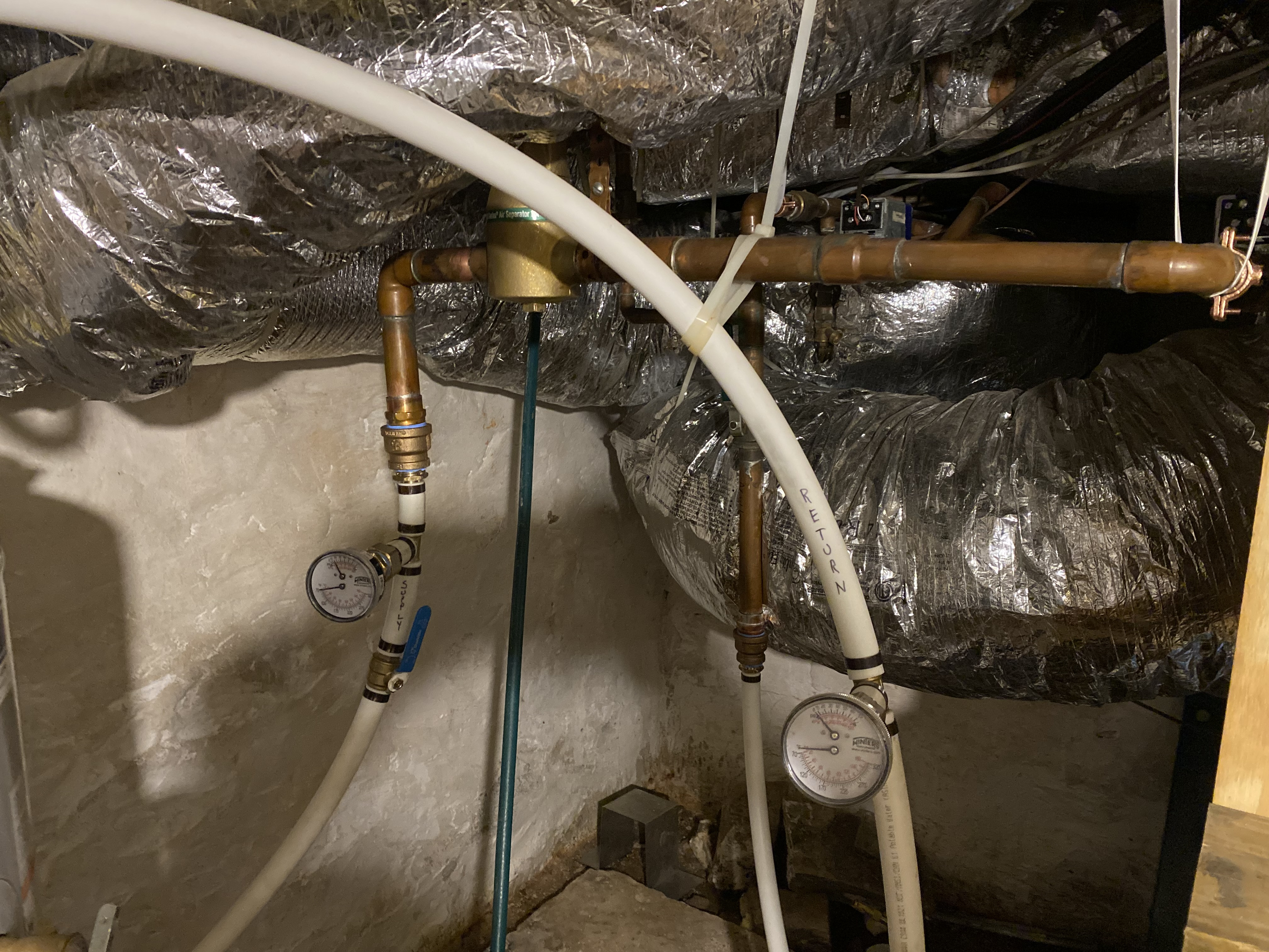

    here’s my update and a few more questions.
    attached are pictures of my setup. I tried to follow the guidance and diagrams shared here, but if there is anything that jumps out as incorrect or poorly done please advise. I know my “tie-in” is a bit redneck😆.
    I am struggling mightily against air intrusion.
    outdoor wood boiler is doing great bringing in 180 degree water to hx. My gauges are reading 170 in and 150 out of the baseboard system.
    i have read a lot of other posts regarding air purging, baseboard gurgling and the like. I don’t think I have a leak in the old baseboard system as I have cut off baseboard fill for hours and never saw a drop in pressure. AND I wriggled my way under this 150yr old house following all the supply and return pipes I could see and never saw a drop of moisture.
    For now I have the upstairs zone valve and manual valves on supply and return closed focusing on the downstairs zone. I have purged the downstairs several times. But the air eventually comes back to the point where my Alpha 15-58 tells me there is -.02gpm flow…
    what are my options? So far I’ve done everything myself with y’all’s advice. Should I call a true hydronic specialist that can purge cart this?
    IMG_1003.jpeg IMG_1002.jpeg IMG_0999.jpeg https://us.v-cdn.net/5021738/uploads/IOZ2GB3QEYTV/img-0998.jpeg IMG_0997.jpeg

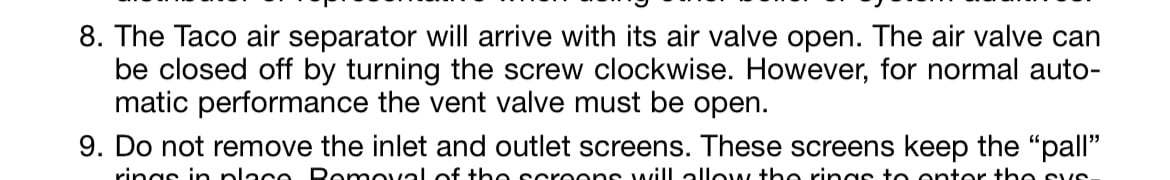

    hot_rod Member Posts: 28,077
    do you ever hear air hissing out if that air separator ? Are you sure it is not closed off?
    The system should purge completely within hours, no more than overnight
  • Wahoo
    Wahoo Member Posts: 9
    Never. I have even run it for an hour or so with air valve closed a few times and there is rarely ever even a pop of air when I open it manually…let alone a hiss.
    now the bleeder on top of the Avey MagnaClean I can consistently get air out of. And I hear it tickling and gurgling through the small DWH Hx right above it.
    One thing to note is that I have a T right before the downstairs zone return “manifold” and it has valves to shut off each side. I know very little about the routing and design of the baseboard pipes themselves; but I am learning more everyday! This last purge I closed one at a time to see if maybe there was air trapped in the “parallel” loops within the downstairs zone. One side was simple to purge but the other never relented in the amount of air being forced through the pipe and out the drain. This was even with the fast fill, pump running at 38w and 170deg water.
    I have the downstairs zone running tonight with just the one return T valve open that I was about to purge. We will see if it makes a difference in the morning.

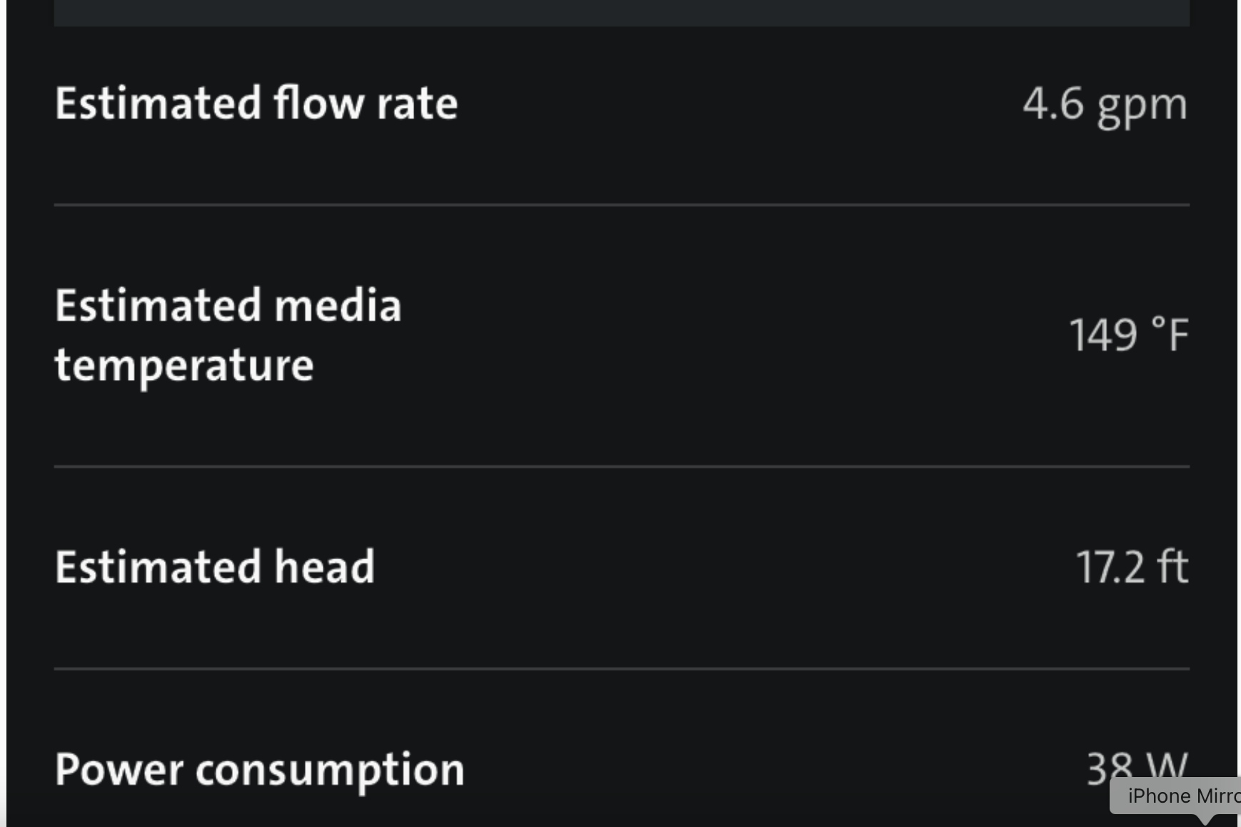

    Here are the stats from the alpha pump:
    Supply temps are at 170 so we are consistently hovering close to a 20 degree delta with both zones wide open for the last 36 hrs.
    Do I have any options? I’m honestly thinking about piping in another zone valve to run a plenum heat exchanger for my forced air. At least I know that got the house warm.
  • DCContrarian
    DCContrarian Member Posts: 1,548
    At 4.6 GPM and 20F delta you get 46,000 BTU/hr. Depending on water temperature baseboard can put out about 500-600 BTU/hr per foot, so that's what you would expect from about 90 feet of baseboard. If that's about what you have, I'd say the system is working as designed, it's just undersized for the house.
    Which would explain why it might have been abandoned.
  • Wahoo
    64’ downstairs and 56’ upstairs. So 120’ total.
    I do know we have insulation problems which I am working to fix. But the baseboards are just lukewarm and I have to think they should be working better. Again, seriously frustrated that 4 months of work and $15k later my wife just asked if we could turn it off and turn back on the heat pump.
    Would adding more emitters in select locations around the house ameliorate the issue? Are hydronic radiators better than slantfin baseboard?
    I’m obviously desperate and defeated at this point.

    Have you clean out the dirt separator ever. It could be a lack of flow issue
  • Wahoo
    @hot_rod flushed the dirtmagPRO twice and this is second cleaning of the MagnaClean magnet I just pulled:
    Here are update stats from Alpha pump after constant running for ~24 hrs. Return temp is a bit lower than actual since I grabbed screenshot after I flushed Dirtmag and added cold makeup water- usually hovers around 150
    warmer day today in Scottsville Va. house got up to 65-66. Flow gpm is faster than usual using autoadapt so maybe you are right HR.
    the pump is reading. 141 and 149. That is a low SWT for fin tube.
    what temperature do you have at the first baseboard?
    The temperature in the circs that he is showing on the GO ap.
    Those calculated gpm numbers are not always accurate. I have seen them off as much as 80%

    I'm only seeing the 141F. Where are you seeing the 149?
    The post on Feb 11
    Different head also, that is why I asked if there are several pumps involved?
  • jesmed1
    jesmed1 Member Posts: 1,499
    edited February 2025
    On Feb 7, he said he was getting 180 supply from the OWB, and 170 supply to the baseboard with 150 at the return, for a delta T of 20.
    On his Feb 11 screenshot, the pump temp is showing 149, which seems consistent with his report of 150 coming out of the baseboard (the pump is on the return).
    On his Feb 13 screenshot with the Dirtmag, the pump temp is showing 141, which he said was not representative because the screenshot was taken after removing/replacing the dirtmag and adding some cold makeup water. He said the return "usually hovers around 150."
    So it seems his original report of 170 supply to the baseboard and 150 at the return is still representative of how the system is running.
    Then the only question is what the "real" flow rate is. @hot_rod why are those gpm estimates so potentially inaccurate?
    I see now, pump is on return. Flow is going through two HX always. Maybe 1” pex piping?
