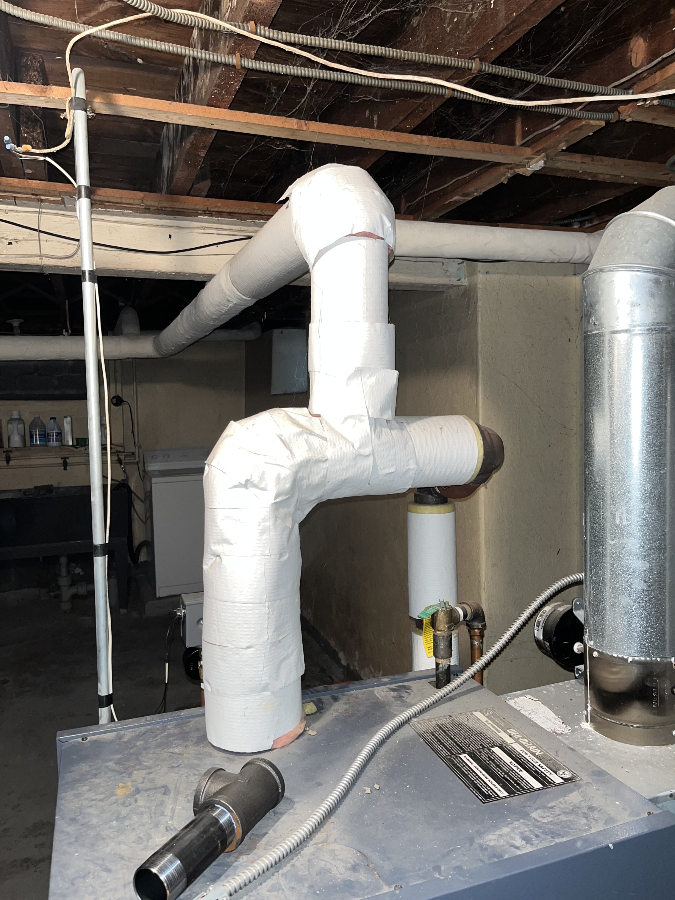

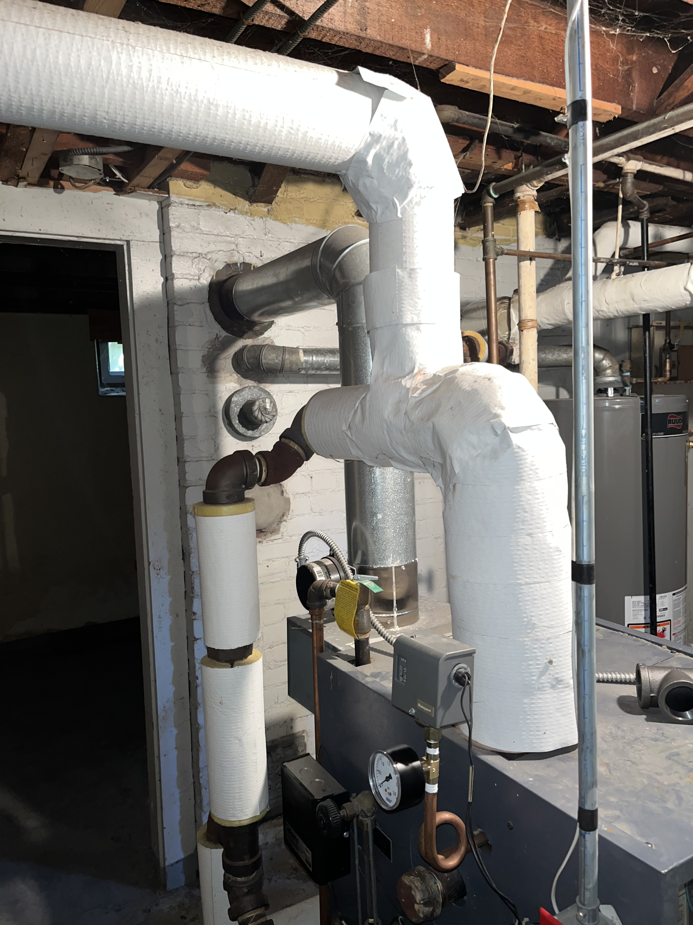

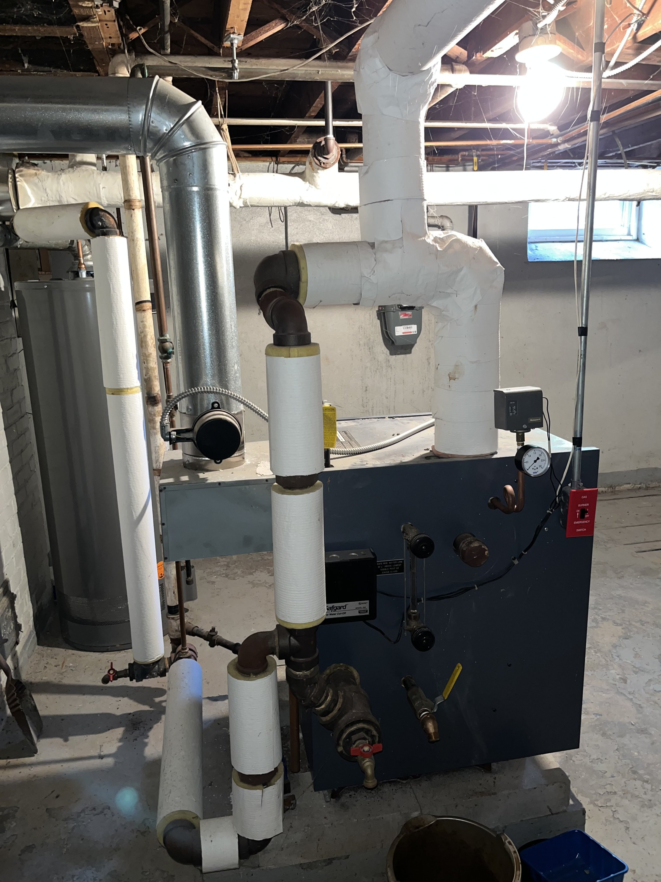

Hey all, we currently have a Utica PEG187 from 1991, that I am finally in the position to replace along with all of its crappy near boiler piping.
Our system has is smallish at 343.5 sf (82,440btu) of radiation. Using a standard 1.333 pickup factor places our system in between the Weil McLain ED-40 & EG-45 boiler models based on AHRI rating (no one installs Peerless around here).
All of the mains, branches, and condensate return lines still have their original asbestos insulation intact. We have added insulation in our attic and storm windows to increase the efficiency of the thermal envelope of the house. Would it be a mistake to "undersize" the boiler by using a EG-40 (resultant pickup factor of 1.24)?

    Do not go larger than an EG-40.
    If it was mine id probably go EG-35.

    Don't worry about the BTU, don't worry about the pickup factor. Just compare your installed radiation to the Net Sq Ft of steam of the boilers you are looking at.
    I wouldn't rule out Peerless or even Utica just because of what the contractors there like to install. There's no installation difference between any of the gas atmospheric steam boilers to speak of.
    For WM, the EG-40 is rated at 321, that's the one I would pick. The 33% pickup factor that I advised you ignore is outrageously oversized so 321 sq ft is plenty large. 388 (EG-45) would be a crime.

    @roc_rktec , if you're going with Weil-McLain, I'd use the EG-45 and downfire it a bit if needed. This would mean the cast-iron would run a bit cooler and last longer.
    The only thing wrong with your present Utica is the installer. There may be some illiteracy issues there- proper piping is spelled out in the manual. I'd repipe it, in such a way that when replacement time comes you won't have to rip everything out.
    That air vent in the first pic looks like it's in the wrong place. Steam from the header will reach it quickly and close it. The proper place for these vents is at the ends of the steam mains and, if this is a 2-pipe or Vapor system, at the ends of the dry (overhead) returns.
    If you're not sure what type your system is, post pics of some radiators that do not have covers. We can tell from this.

    since you commented on someone else's year old post, can you show us your near boiler piping? If your near boiler piping is as bad as the piping from the op and it affects the speed with which the system heats then fixing it could be worth it.
    ethicalpaul Posts: 9,076
    as stated above the savings are going to be very little. This is because for every unit of fuel you burn, about 80ish percent of the heat produced goes into your home envelope.
    this is true for oversized, undersized, correctly sized.
    A correctly sized or undersized boiler will run at lower pressure generally but that doesn’t change the facts above. It’s good to have it sized correctly but it’s not worth pulling a working boiler
    A smaller boiler is less costly. I wouldn’t buy a larger boiler and downfire it. I think the stated benefit of that is highly speculative. But different strokes for different folks
    the boiler piping looks pretty good, changing it isn't going to do anything for you. make sure you have good venting at the end of the mains.
