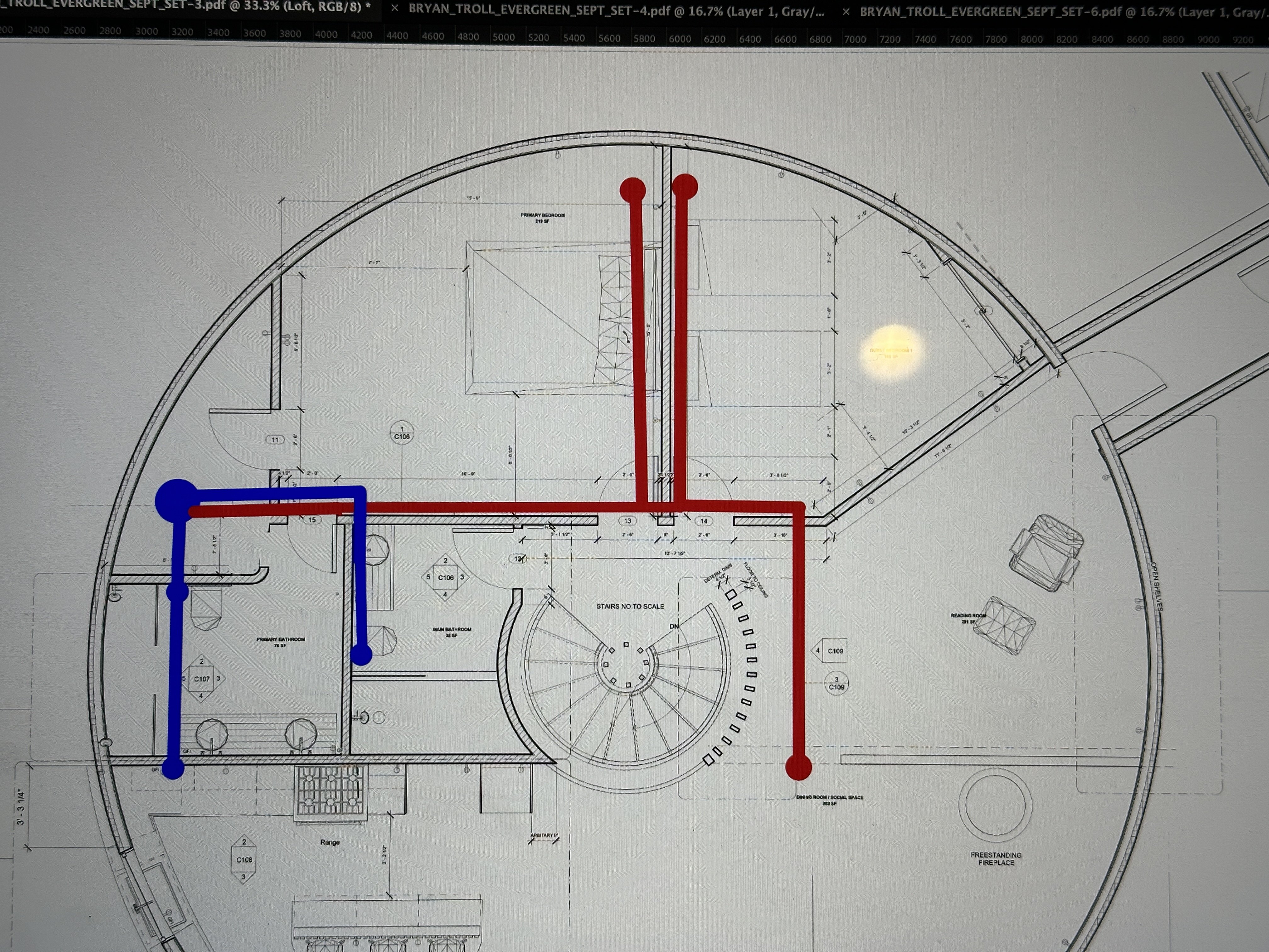

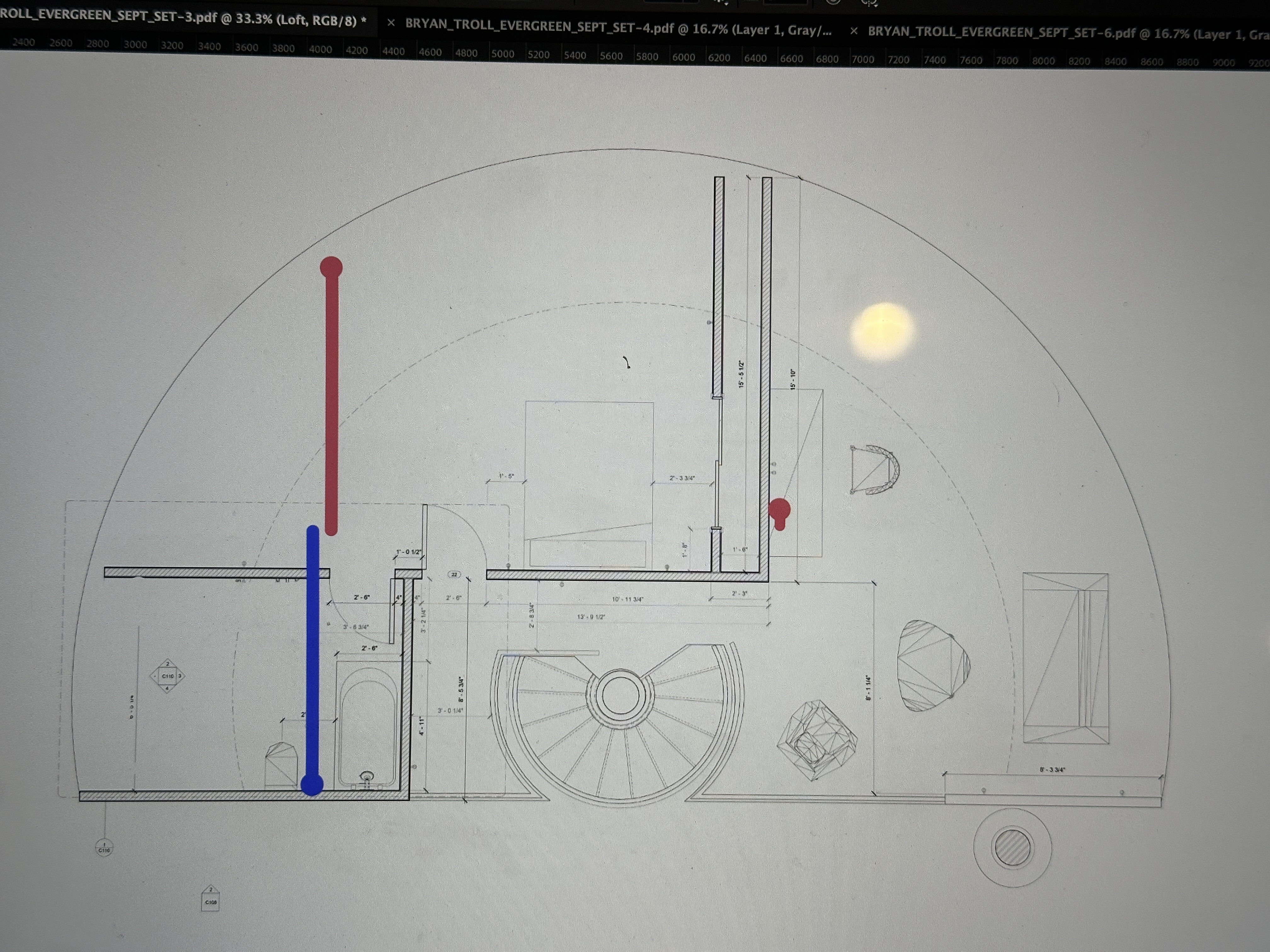

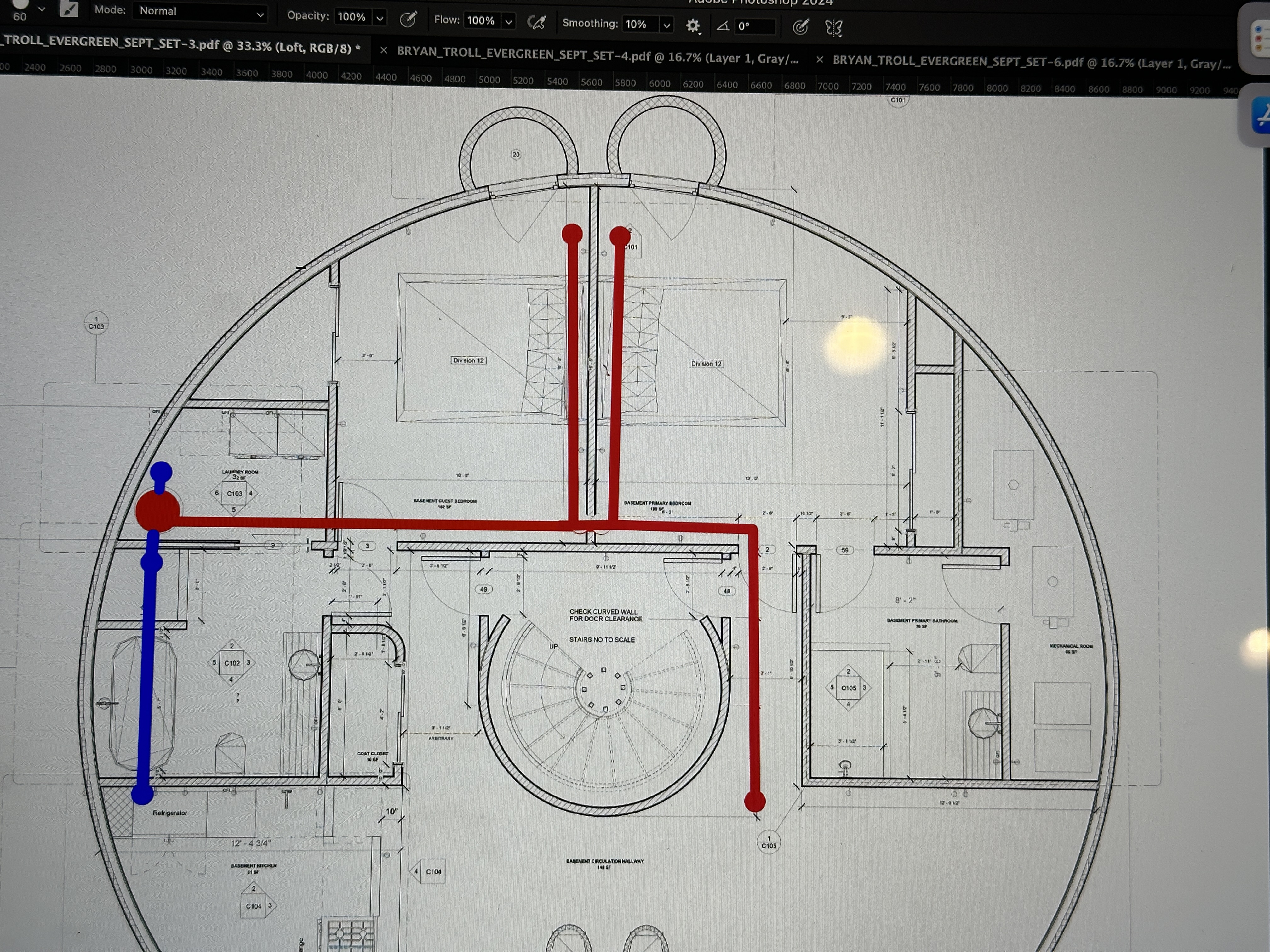

    I have sketched out an idea below for adding a ducted ERV / HRV system below — this has one system in the basement and a separate system for the main floor and loft.
    This would require adding soffits for the right-left run in the basement and main floor but I am hoping I can keep them to a minimal size — 6” or 8”?
    I would then have separate kitchen exhaust and dryer vents.
    Can anyone here provide feedback on this layout, or suggest an alternative?

    Looks like a good start.
    I would not run the fresh air feeds across the bedroom, send the fresh air out up high by the door. You do want some flex or duct silencer between bedrooms though to limit noise transfer, so you might need some extra length for that.
    For the living space, dump it into the hallway, no need to run across the room. As long as there is no doorways in between, you'll get decent air mixing.
    Depending on the size of the ERV, the main trunk can be 6" or 7" with each room feed a 4" takeoff.
    The main floor kitchen stale air pickup is a bit close to the stove. Try to push it as far as you can and maybe install a real filter grill for it.
    Make sure to put some flex or duct silencer between the ERV unit and the main supply and return trunks. These are generally quiet but in a house with no ducts, you want to minimize the sound especially under boost.
    Try to install boost switch in the kitchen area, this is the on that I use the most.

    An ERV is not like a heating system. If you get it wrong, flows are a bit low, might be a bit loud and distributions is not that even but it will still mostly works. Important items is to go for autobalance unit as these are much easier to set up and stay in balance as filters clog.
    For an ADU you can share the ERV but you need fire dampers. I think the simpler option is to install something like:
    https://iaq.na.panasonic.com/erv/whispercomfort-60
    And mount in the hallway. You can get the tandem vent kit for it for a simple install. No need for all the ducting, think of it as a good enough solution.
    For the main unit, stick with the largest size duct your ERV can take. This is usually 6" for 100CFM units and 7" for 200CFM. Some big units come with only 6" ports, these need to be stepped up as 6" duct is way too loud at 200CFM.
    Outdoor ducting to each unit needs to be insulated with a well sealed poly sleeve. The indoor ducting can be bare pipe.
    An insulated pre-filter on the outside fresh air feed to the ERV is a good idea if you have the space. This would save you the cost of the expensive OEM intake filters plus you can oversize it so it lasts much longer (my external filter is good for a year).
    Any filters should be easily accessible, you want the least amount of friction (in terms of effort) when it comes to swapping them.
