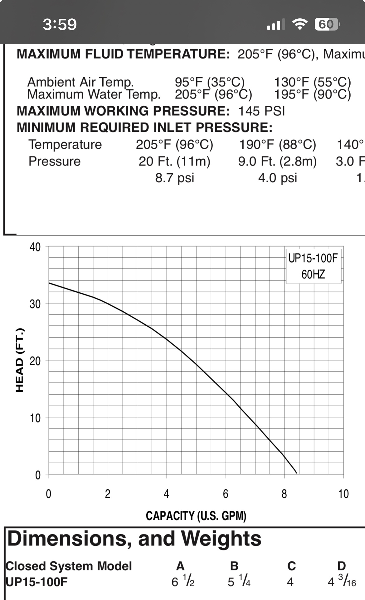

    A Grundfos 15-100 is a great drainback pump,, high head, low flow, it will do 30’ of lift. It is a 1.1 amp, but we have run them for years with that Resol control in the variable speed mode
    5-6 gpm should move all that collector can produce
    If you use an ECM type of pump, you cannot use the variable speed function, just on/ off

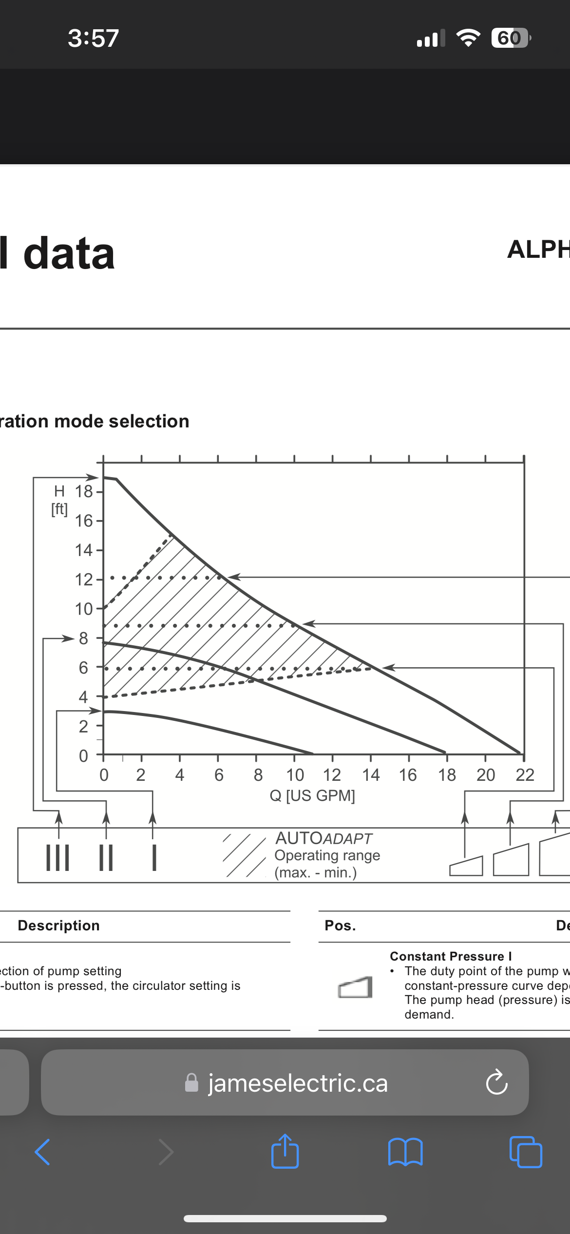

    looks like the 15-100 was discontinued and replaced with a 26-99 , 3 speed pump, is this still able to be modulated by the solar plus? As far as controlling pump speed based on panel and tank temps?

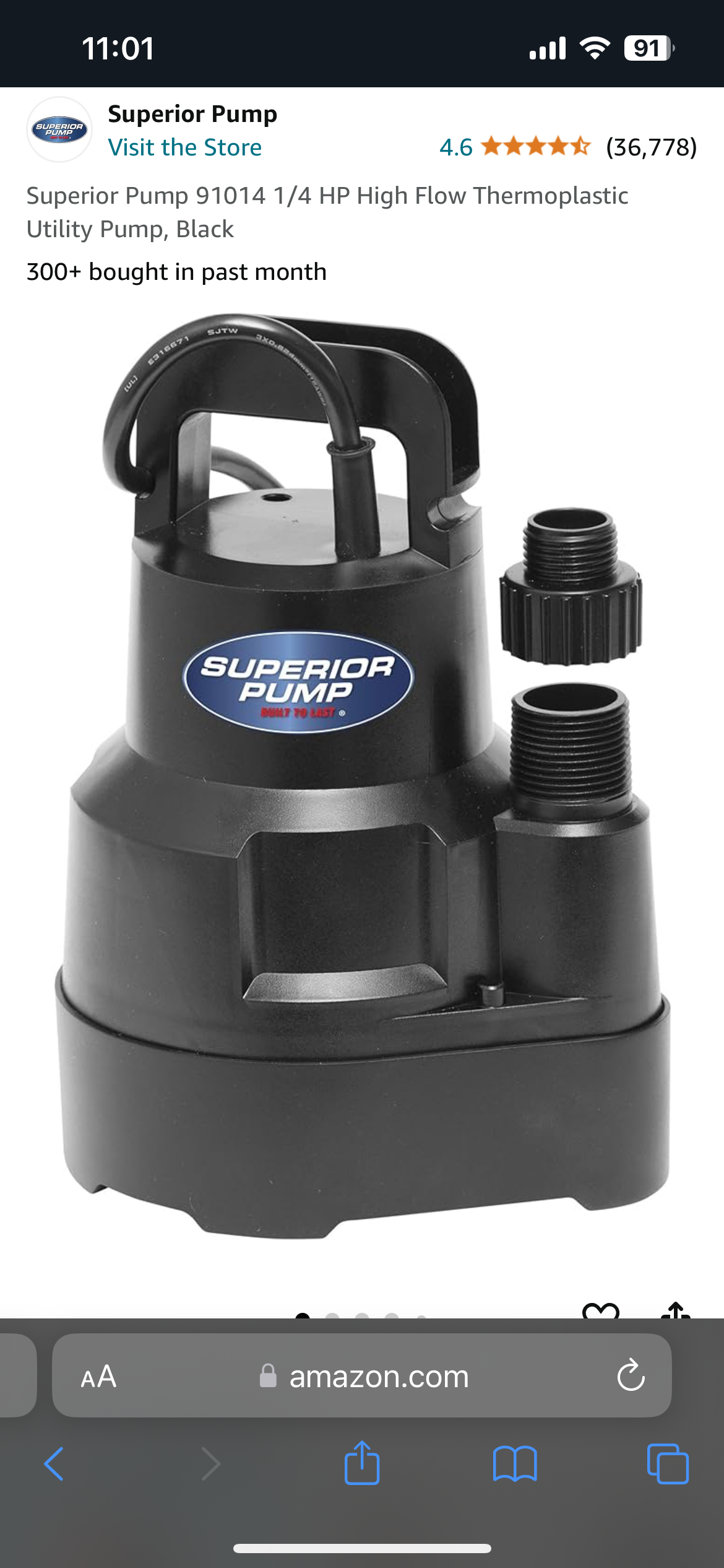

    This 1/4 hp
    will do 25’ of lift, 50 bucks on Amazon

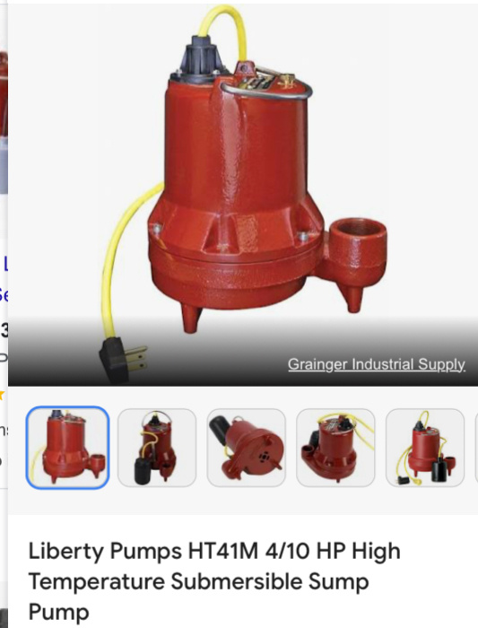

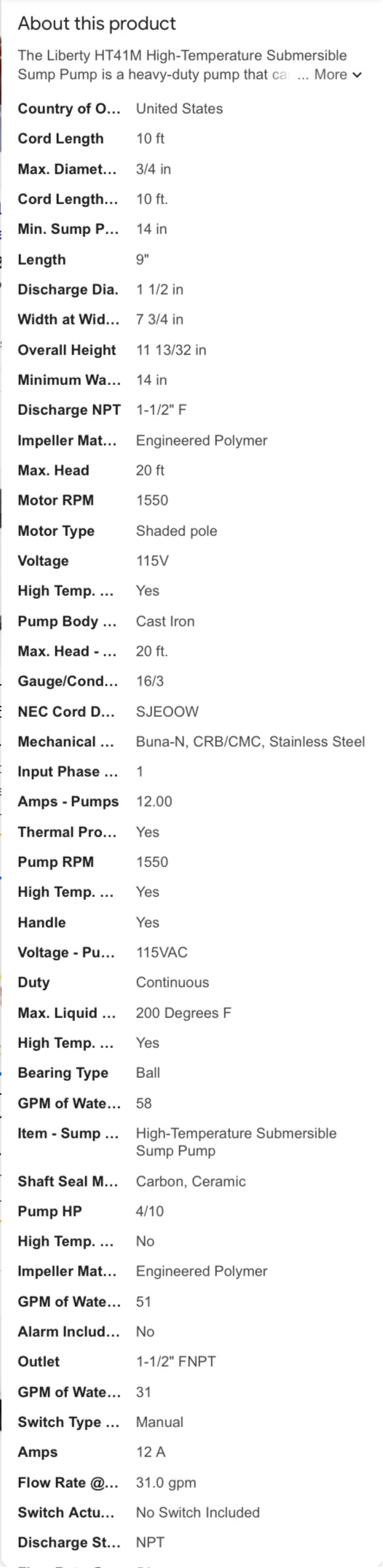

    here is the pump I would try, 4/10 hp, 200f max. fluid temperature. Gpm is high but I think maybe you could run it off a triac on the Caleffi/ Resol controller. We ran a 5 hp shop vac on a triac once. Maybe tech support at Liberty could talk to you about using a speed control. Mention that you want to use a wave chopper type control, a basic triac relay.
    Or throw a balance valve on it and choke the flow down, but you need to do quite a bit of throttling to get down to 8- 10gpm or so. The solar controller, if you can make it work with that Liberty, will run the pump at the optimum speed based on the delta T it sees. Your limit will be the velocity in the 1” copper.
