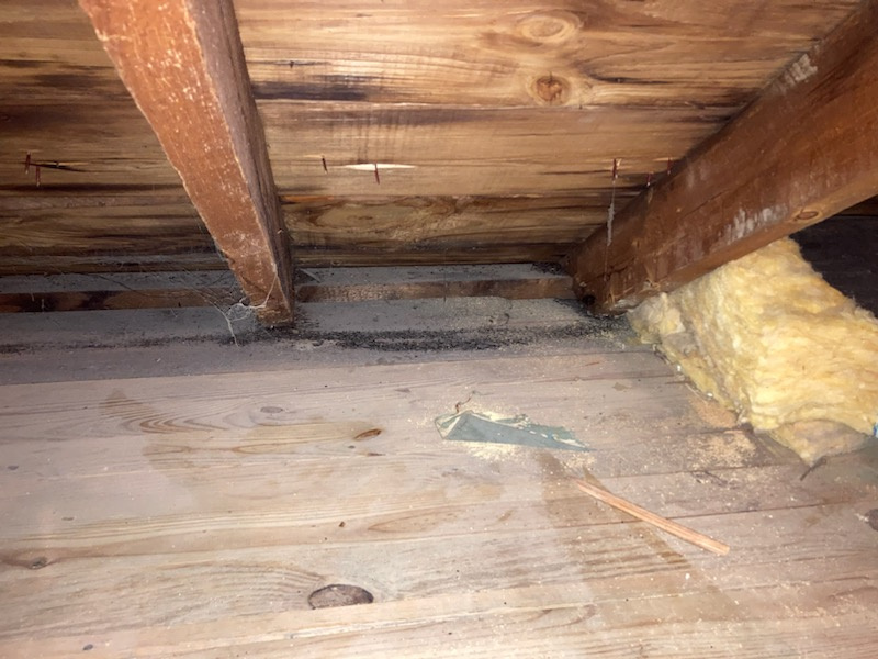

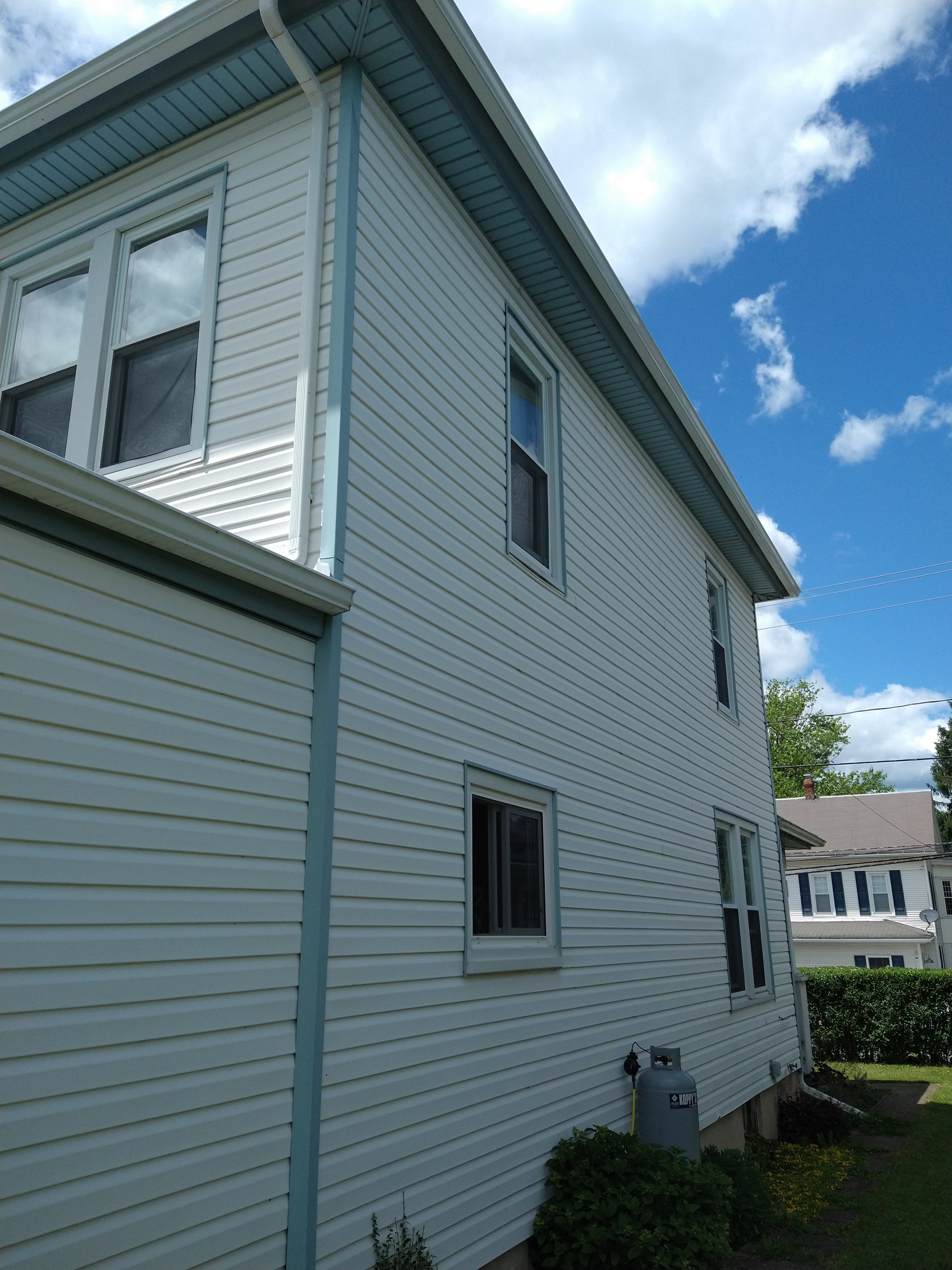

Hello Heating help friends! This summer I'd really like to do some work tightening up the air infiltration in my 1923 (yr built) 2000 sq ft balloon framed house. I consume from 750,000 to 1.1 million BTU/day in the winter months if temps are between 10-30 average. I am in eastern central PA. Last year I did my best with fiberglass to insulate the rim joist in the basement. However I know that the balloon frame lets air travel through the walls up into the attic very easily.
https://us.v-cdn.net/5021738/uploads/4XKBQH47FQ89/img-2218.jpg
I notice the second story floors get chilly and I think it's from all the open areas between wall cavities and floor joist areas. Where is a reasonable place to start to slow the air movement? I have a little bit of blown in cellulose in the attic under the floorboards but I would pretty much consider that not doing a whole lot. The house is sheathed in 1" boards with a tarpaper (what's left of it) and then 1/4 blue foam sheeting with vinyl siding. Some I'm pretty open to the outdoor temps and wind. Windows are 25+ yr old vinyl.
I know some people say just spray foam or fill everything up with some sort of blow in, but I'm really not about that. I want to stop air migration and chimney effect before I would even tackle that. I want a secure lid on my house. So 'dams' seems to be the approach my mind takes, dam the channel to the attic, dam the joist ends to prevent more circulation under the floors.
My 1st floor has all original plaster ceilings, the upstairs has a drop ceiling ( I feel this is my best access area to do something)
Another area I really need to tackle is the stairwell ceiling from the 1st to the 2nd floor, I know there is a lot of heat going straight up from 1st floor since like a typical house the stairwells are all on top of eachother. I was planning to rip off the stairs in the attic and either lay down batts or possibly remove several treads and blow in cellulose. How would I air seal the lath and plaster before doing that? Just run a bead of caulking around the edges and seams and call it good?

    For the walls, by far your best option is dense pack blown in insulation. It will stop both infiltration through the walls and any chimney effect in the walls. If you're not about that, that's your choice — but that's the only effective way to stop air circulation within the walls.
    The attic is another question — and the question there is whether you want the attic to be warm(ish) or cold. That determines where you put your insulation. If you want a cold attic, then the insulation — I suggest fiberglass, but if there is an attic floor blown in between the second floor ceiling and the attic floor works well — goes in the floor. Otherwise, spray foam on the underside of the roof.
    There is a caution: if the insulation isn't really tight to the underside of the roof, be sure the attic space can breathe. Otherwise you'll get condensation up there, and that you do not want.
    I'm not quite sure what you mean by sealing the stairwell. Are there stairs going directly up to the attic? If so, can you simply put a cover over the opening in the attic?

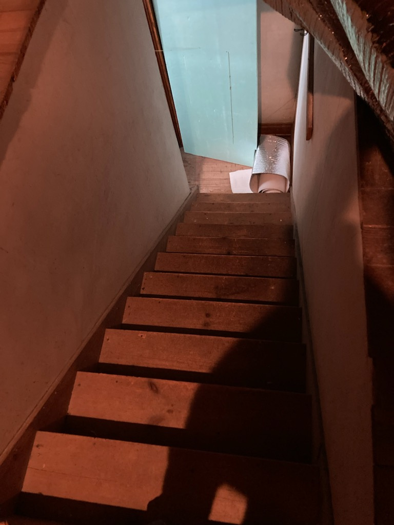

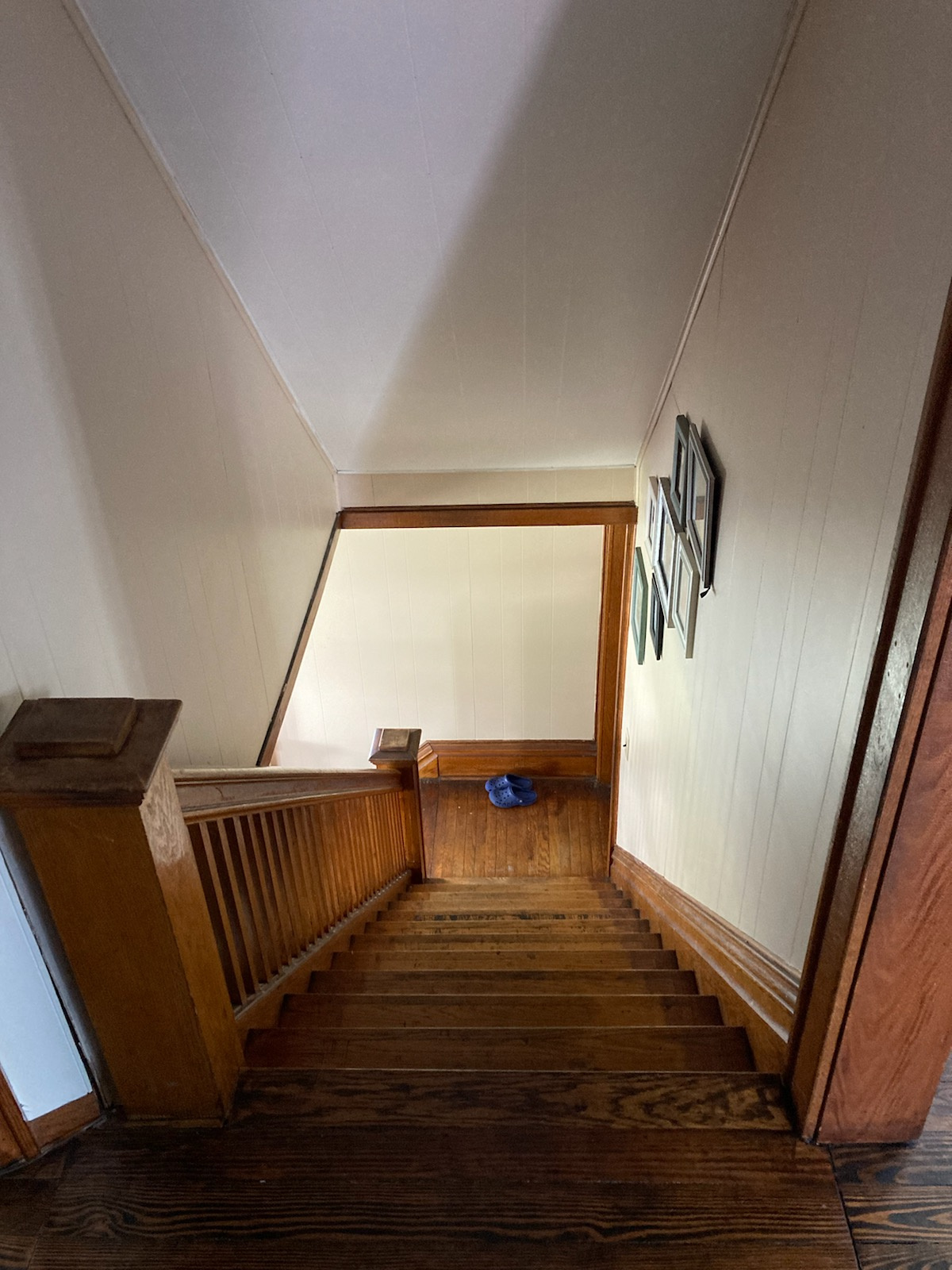

    Sorry I tried to upload these earlier, this is the staircase going to the second floor. When I come up the steps I notice the warm air following me (especially when we use our gas stove in the adjoining room (kitchen) in the summer I notice the heat migrates into this stairwell, imagine the winter? So the 'ceiling' is just panelling on old plaster and lath, I want to insulate this from the upstairs attic stairwell. If I just pull the steps and blow in or lay batts down will that be sufficient? I do have a sort of 'lid' I top the entry into the attic with, but I'm sure that's only doing so much, i thought best off to control it as many places as possible.

    Do I take it there is a pull-down type attic staircase? Those are horrible heat leaks. It will be worth building and fitting a reasonably tight, well sealed cover for that which you can pull down and close before you fold up the stairs.
    Then yes, the biggest bang for the buck is going to be insulating that attic floor as much as you feel is reasonable. But as I said above, if you do make sure that the attic itself can breathe. Be sure not to close up any eave openings (except with screens to keep birds out) in your enthusiasm to insulate, and make sure that there are either gable vents or a ridge vent.
