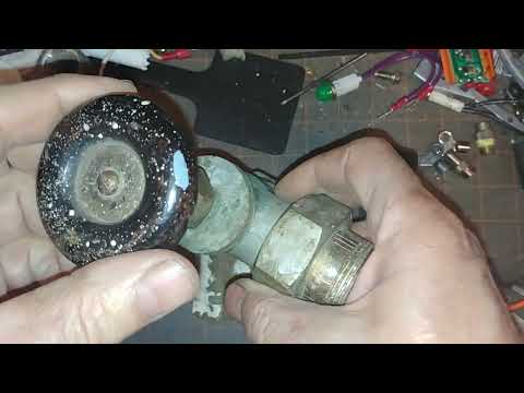

    Folks, what is wrong with this picture (from the OP's video above) ?
    What confidence would I have that the valve is correct ?
    And it was changed twice ?
    Watch
    If you don't want to watch the whole thing, watch 3:00 through 3:50 and 5:38 through 6:04.
    https://youtu.be/xe52k4JQWuk
    A 1" and 1-1/4" Steam valve. And in stock. And other sizes are in stock too.

    The valve is a steam valve. Is bulbous like in the video referenced above and you have to turn it several turns to get it on or off. The technician returned today and confirmed that it's a steam valve. He is still not sure why it won't completely turn off or why it's making so much noise. He's going to install a cycle timer on the boiler to see if that will help. I'm on the first floor of a 6 story building and other tenants along my 'stack' are also complaining of noise so there's definitely something going on.
