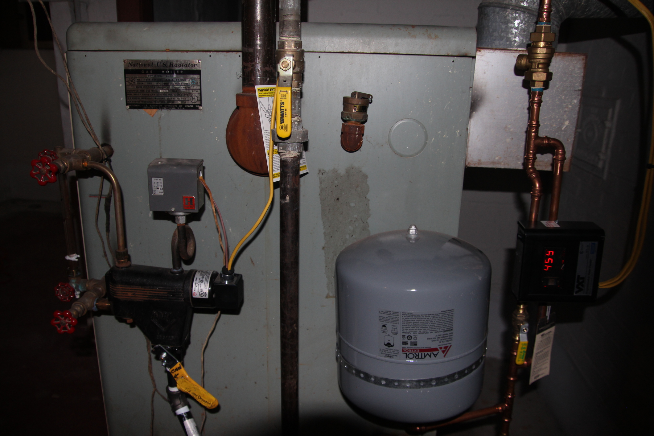

    One should remember that the boiler is the power unit for the heating system as a whole — so you have a steam heating system which happens to be powered by an older boiler. This is not a trivial distinction, as if and when that old boiler does develop intractable problems, and most do sooner or later, it is not a question of a new heating system but only of finding and installing a new boiler to power the system.
    As to maintenance, we can guide you much better if you could take a picture of the entire boiler, so that we can see what controls it has on it. In general, though, steam systems take very little maintenance. You should have someone come yearly to check and adjust the burners on it and make sure you are getting your money's worth from the gas you are burning — that is not a do it yourself project. Otherwise, the main thing is making sure that the boiler has the corredt amount of water in it, and making sure that the control and safety devices are working as they should — and that is mostly do it yourself, but the picture or pictures of those controls will help us guide you.

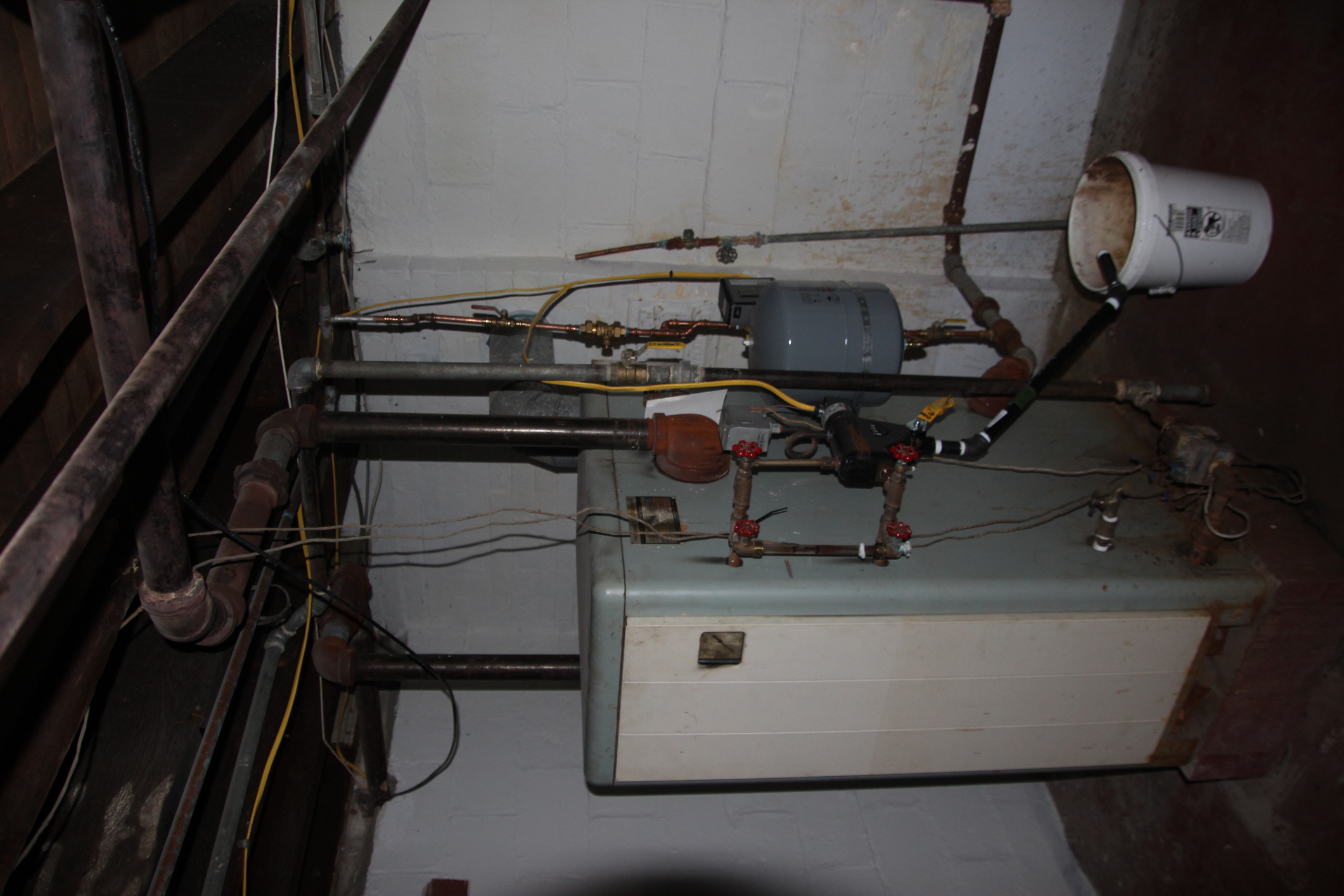

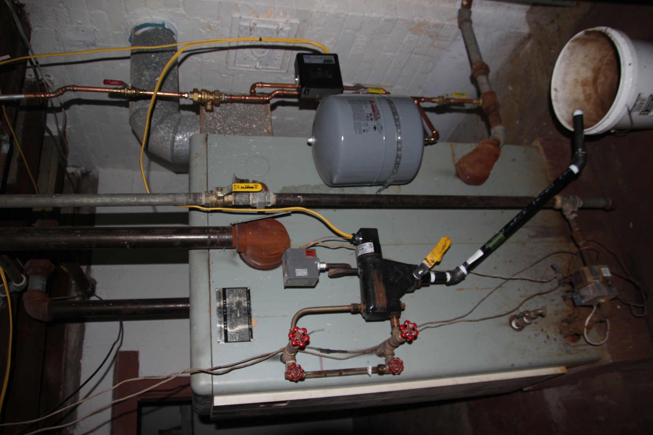

  • Thanks for the feedback. As requested, I've posting photos of the system as it looks today for your collective comments / advice. Th uploaded photo below is a good overview, and the attached photos have more detail:
    Dan Donovan (Ohio)
    Not surprisingly, the near boiler piping is not what one might want — but if it's working quietly, that's not a problem.
    On the front of the boiler there is a black triangular affair connected to the water level sight glass. It has a valve with a yellow handle on it. The traingular affair is your low water cutoff safety, and that valve is the only routine maintenance you have to think about: it should be opened about once a week or so to flush gunk out of that container into the handy bucket. If the is running when you do that, the boiler should turn off. Then refill the water level up to about half way on the sight glass.
    That's it. Steam is pretty simple.
    You should, however pay attention to how much water — if any — you have to add from time to time to maintain the water level, other than that which you addid above. Ideally you wouldn't have to add any. In practice anything up to a couple of quarts a week is probably OK — but anything over that is a leak somewhere, and it should be tracked down and fixed.
    What is that expansion tank for? Can you take a picture of the back? Is there a hot water heating loop off of it as well or is it also making domestic hot water?

    It looks like that boiler has an autofeeder. So in addition to the regular blowdown of the low water cutoff previously mentioned, the reading on the feeder should be monitored between blowdowns to check how much water is being used. (I can't tell if the expansion tank is part of that.)
    At the end of the season, I'd remove the Pressuretrol and replace the pigtail with a brass one—or at least make sure the one on there is completely clear. (And while your are at it, make sure the wheel inside the Pressuretrol is turned down as far as it will go.)
  • TonKa
    TonKa Posts: 111
    You may want to check if the pressure relief valve is actually rated for steam. Also, there does not appear to be an outlet pipe on the PRV.
    Additionally, I do not see a pressure gauge.
    I woudl repalce the 70 year old pressure releif vavle and make sure it is clear back to the boiler.

  • I forgot to respond to the comment about the lack of a pressure gauge. Referring to the boiler photo, the square object in the upper right part of the front panel is a non-working gauge. I had asked the service people to replace it, but they said that they could not find a like replacement. I'd like to find a gauge myself and install it if there is a location on the external piping that will give me the correct boiler pressure. Where would be the easiest location for this?
    Also, I'm confused by the comment "So maybe someone has this hose down a drain and running constantly." Can someone expalin what that is referring to exactly?
    Thanks

    I believe that Presure Relief Valve style does not require and is not made for additional piping. An additional Presure gauge could easily be added above the pigtail and below the pressuretrol (the little gray box).
    Typical good 'Near Boiler piping' is much different than what you have there. You looking at pictures would help you the most.
    That gauge probably works but the system shouldn't build enough pressure to move that gauge within its accurate range. Add a 0-3 or 0-5 psig gauge off a tee above the pigtail and below the presuretrol. Make sure the pigtail is clear.

    Look as some of the pictures in this post below. The old boiler on page 1 has two supply ports like yours. Typically they are conected together with a horizontal header so the steam travles in one direction then comes the two mains connected to the header then the drip into the equalizer to return any condensate back into to the boiler. This provides dry steam to the system. Since your boiler is old and large and the vertical risers to the mains are significantly above the waterline before they get to the mains, wet steam may not be an issue in your case. There are other pictures (good and bad) if you poke around the site.

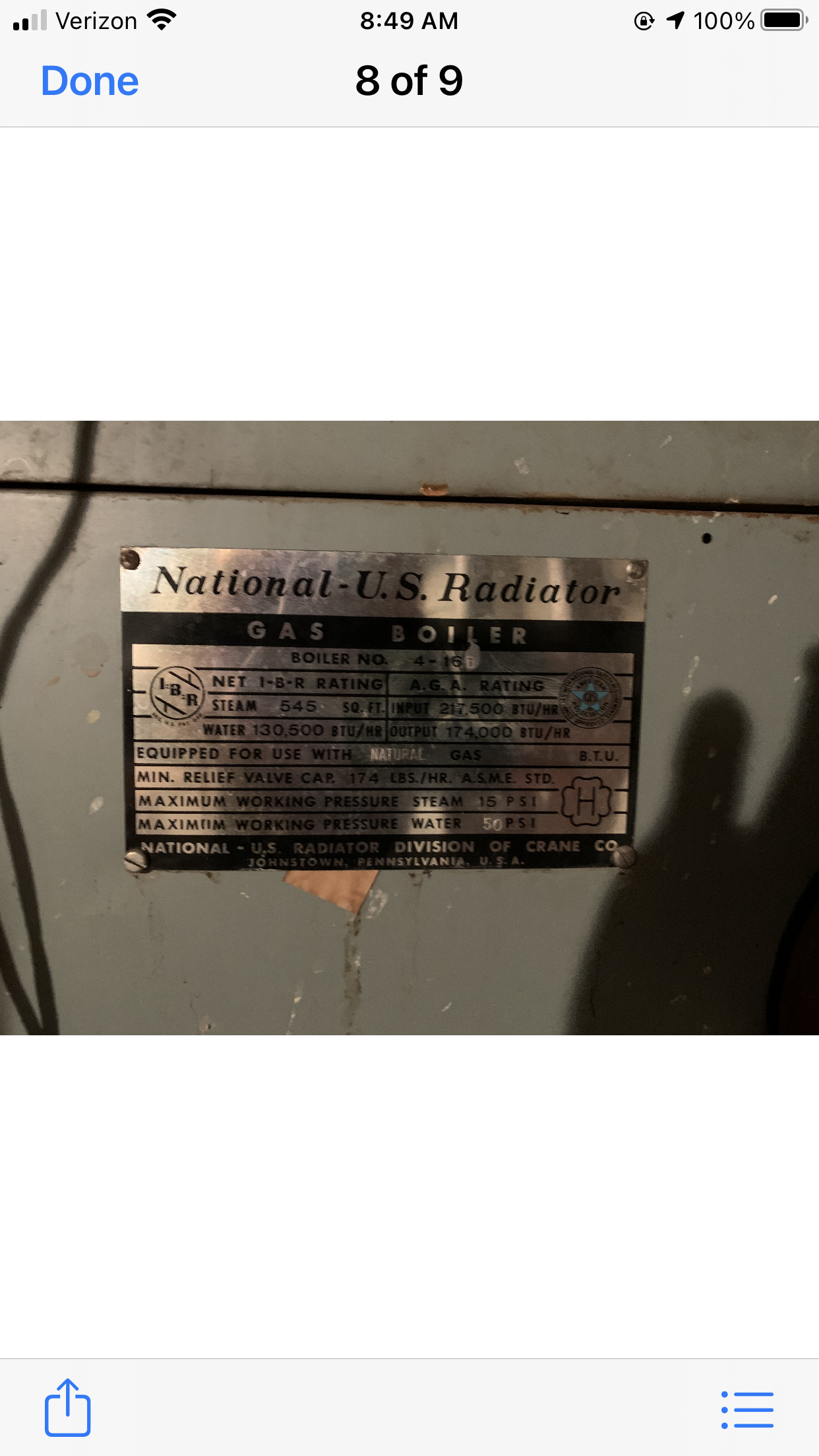

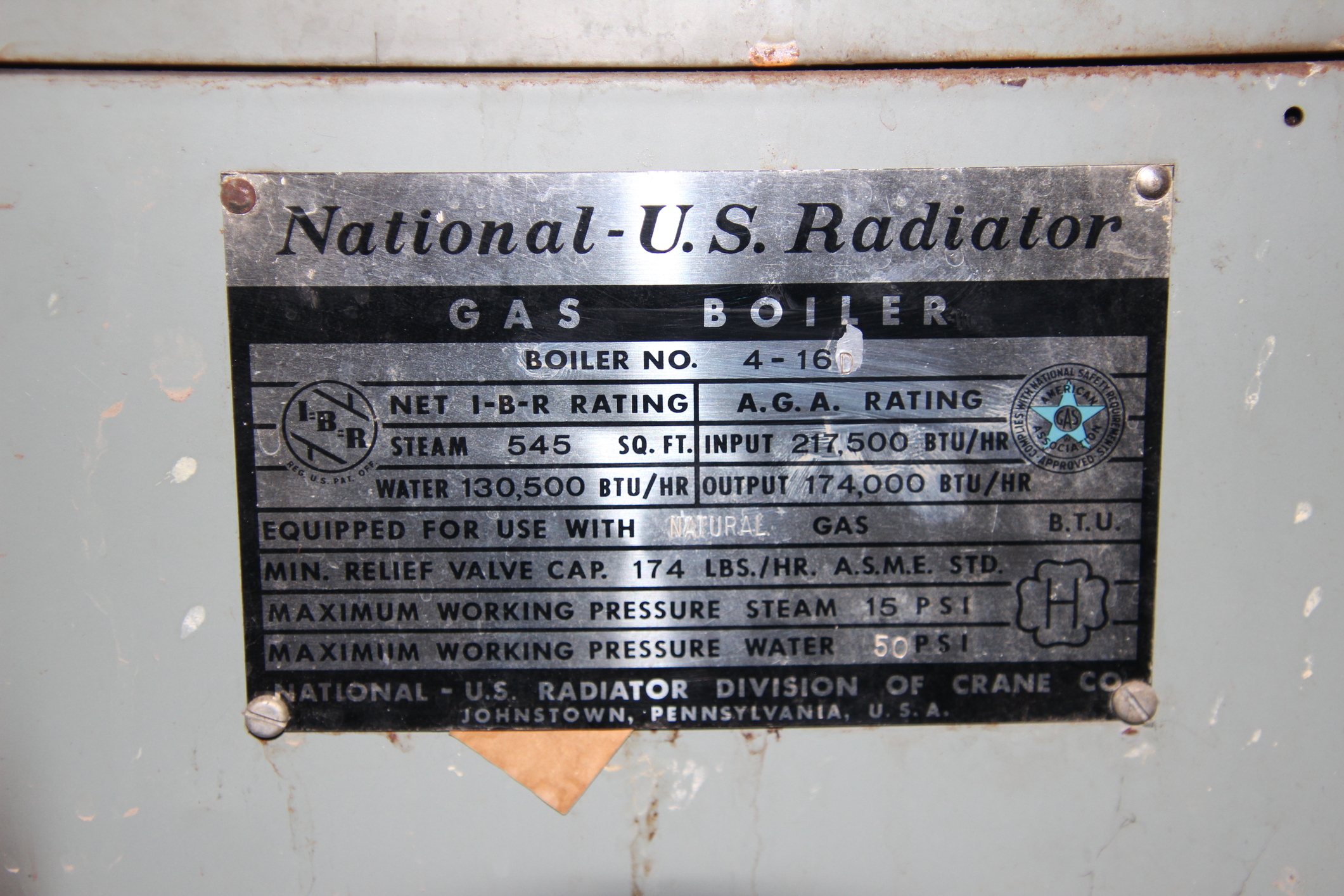

    Get a new 15 PSI relief valve rated for a minimum of 174 lbs per hour, as it says on the boiler nameplate.
