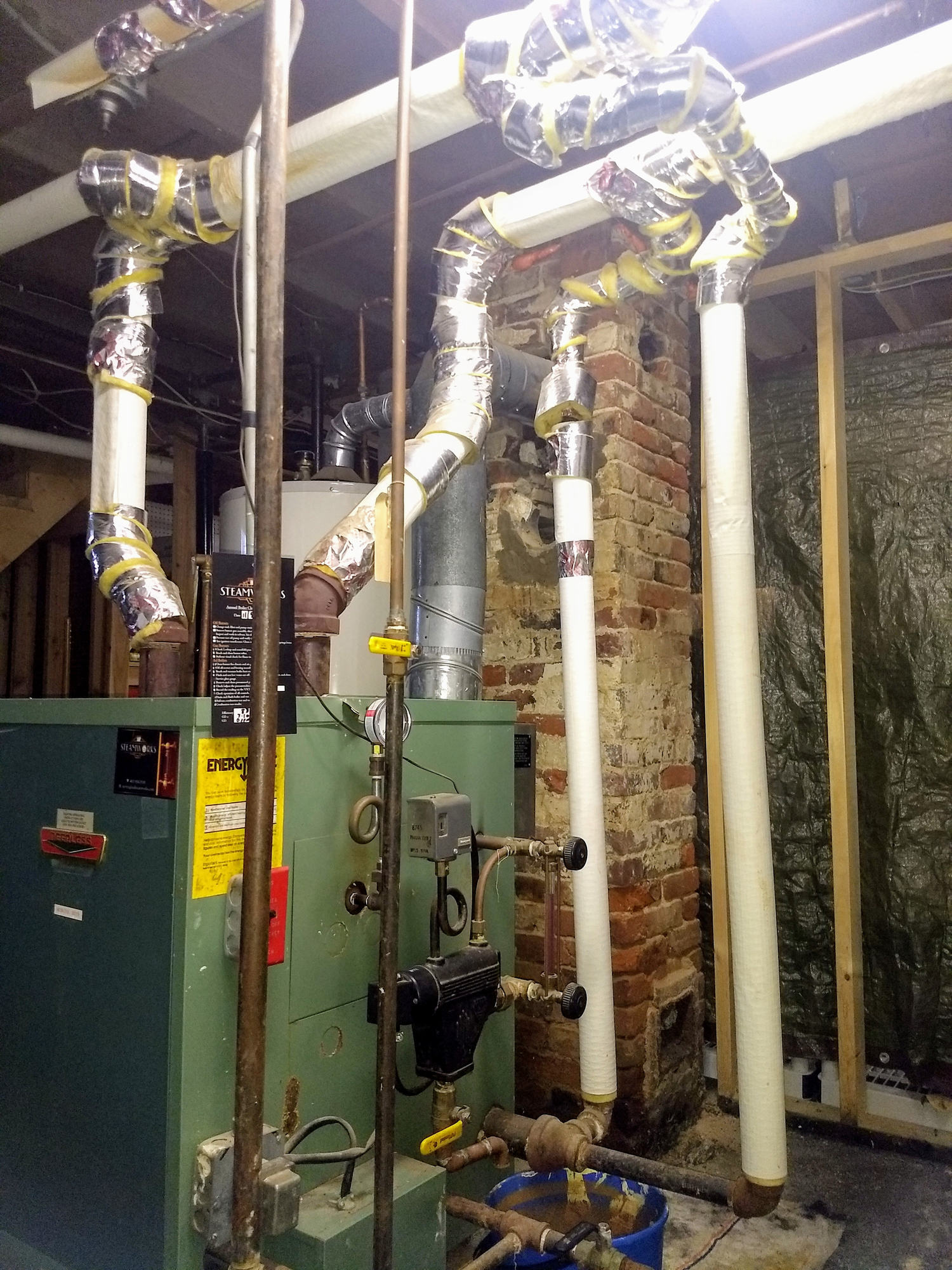

@ethicalpaul got me thinking on his recent discussion and test of installing a valve on his boiler equalizer to essentially remove the equalizer from the equation.
I have a single pipe counterflow system. 220 sq.ft. of EDR and the boiler has ~320 sq.ft. of capacity.
My 41 year old Peerless boiler (modern 63-03 equivelent) does not have a header installed (yikes!) Each riser from the boiler goes to its own 2-1/2" main.
There is no Equalizer either. Each main does have a drip leg that goes to the bottom of the boiler. Hartford loop? Meh. I guess they didn't need that either…the drip legs go right to the bottom of the boiler. Main Venting? Pfffft. Nope.
It has been working just fine for 40+ years! I have recently installed main vents and insulation and that got the heat to the radiators much faster and quieted down the radiator vents.
This summer I plan to re-pipe the near boiler piping per the manufacturers specs. Since the boiler is 40 years old I will re-pipe it so it will easily swap over to the 63-03L when it comes time for replacement.
I've never had water hammer, surging or priming. Regular use of 8-way keeps it squeeky clean. I recently installed a Vaporstat to keep the pressure under 1psi and it has helped reduce fuel consumption.
My conclusion: Steam heat is very forgiving! It seems with less than ideal installations a combination of very dirty boiler water and/or oils combined with high pressures usually are the cause for 75%+ of the problems we see here.
That said….any guesses how my system will act once it is piped and vented properly?

    what we say is the proper way to pipe is what the boiler manufacturer draws? But it is just what is acceptable and will allow a multitude of different kind of systems to work with one configuration? A universal and conformal way of piping makes it easier to diagnose issues in the future? Determine warranties?
    The "proper" way will allow your system to work great as well i'm sure. Are there different ways with the same result? I'm sure as well..
    ethicalpaul Posts: 9,076
    It will work great. It sounds like your current boiler is also working great so it is likely to be indistinguishable.

    And when I repipe this thing with a header, equalizer and hartford loop, vent the heck out of the mains and add 1" insulation… the boiler will probably say…. "thanks, I guess".
    The real reason I intend to do this isn't fuel savings…the fittings to re-pipe will cost 100x of what fuel I will save. It is to get the piping perfect in prep for the inevitable 63-03L which may be a few years or a few more decades…who knows?
    If it makes my boilers life just a little bit easier and extends it life just a bit further I consider it paying it forward.

    @AdmiralYoda I see your system a bit differently. You have two headers and two equalizers. The need for or any benefit of a Hartford loop is debatable since your Wet return is about 2 feet long.
    With typical Parallel Flow near boiler piping the header needs a drip, the Equalizer provides the drip, you have two headers and two drips. The headers just happen to be at the same level (or height) as the supply end of the mains. Since you have a Counter-Flow system your drips drain the headers and the mains.
    Typically the Equalizer also provides a vacuum break for the Hartford loop so the boiler water can not be siphoned out of the boiler with a Wet return breach that may be out of sight. Your Wet return is about 2 feet long.
    109A_5 Posts: 4,759
    In this case the supply end of the main is below the Header. Look no Hartford loop.

    And could one even say that he has two equalizer loops since he has those drips? I mean I get that the equalizer loop should be as short as possible……….
    PS: Now that I'm awake I see that you already said that lol.
    I don't like the way Weil drew that. Anyone that has put pipe together knows you cant have a tee on a sloped main and then have the supply from the boiler above it be level without a swing joint or something
    Captain Whoethicalpaul109A_5

    @Captain Who " If the header was below the main (system header) then wouldn't it defeat the purpose of having parallel flow in it because it would serve as the drip for the main instead of the condensate going into the equalizer? "
    The header is usually below the main in a parallel flow main. The condensate in a parallel flow main drains at the far end of the main not at the supply end.
