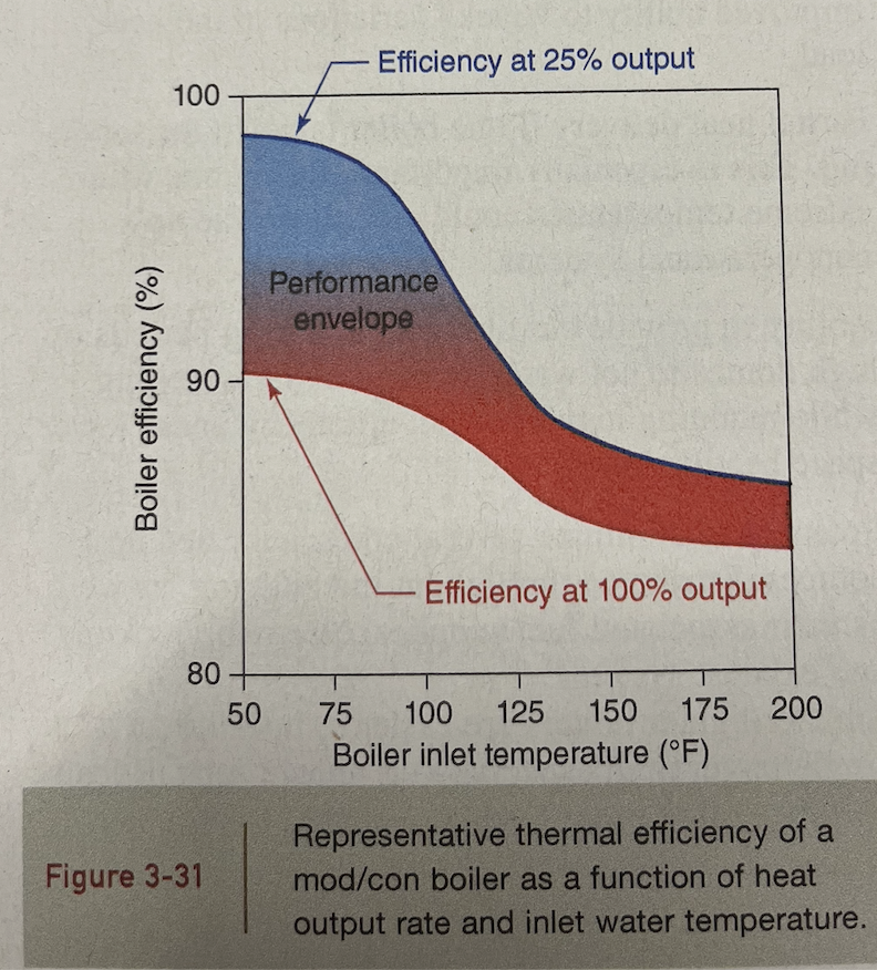

    Numerous studies have shown reducing SWT lowers boiler operating cost, especially in condensing temperatures.
    I believe both modulation and condensing add to boiler efficiency.
    If the boiler is a bit oversized and it is a mod con, the lower the firing rate in condensing mode the more efficient it operates. The concept is you expose the boiler HX surface to low firing and you get addition condensation, more surface area.
    The holy grail is the 120F SWT or lower :)

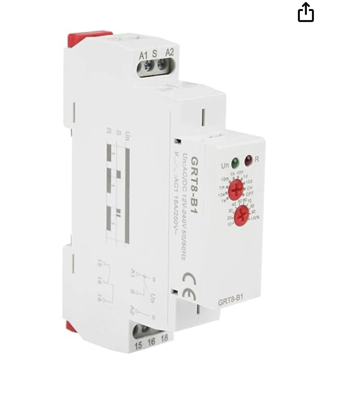

    3. I use a Time Off relay to keep my circulators running for thermal efficiency, longevity and non frozen pipes. But that is another discussion.

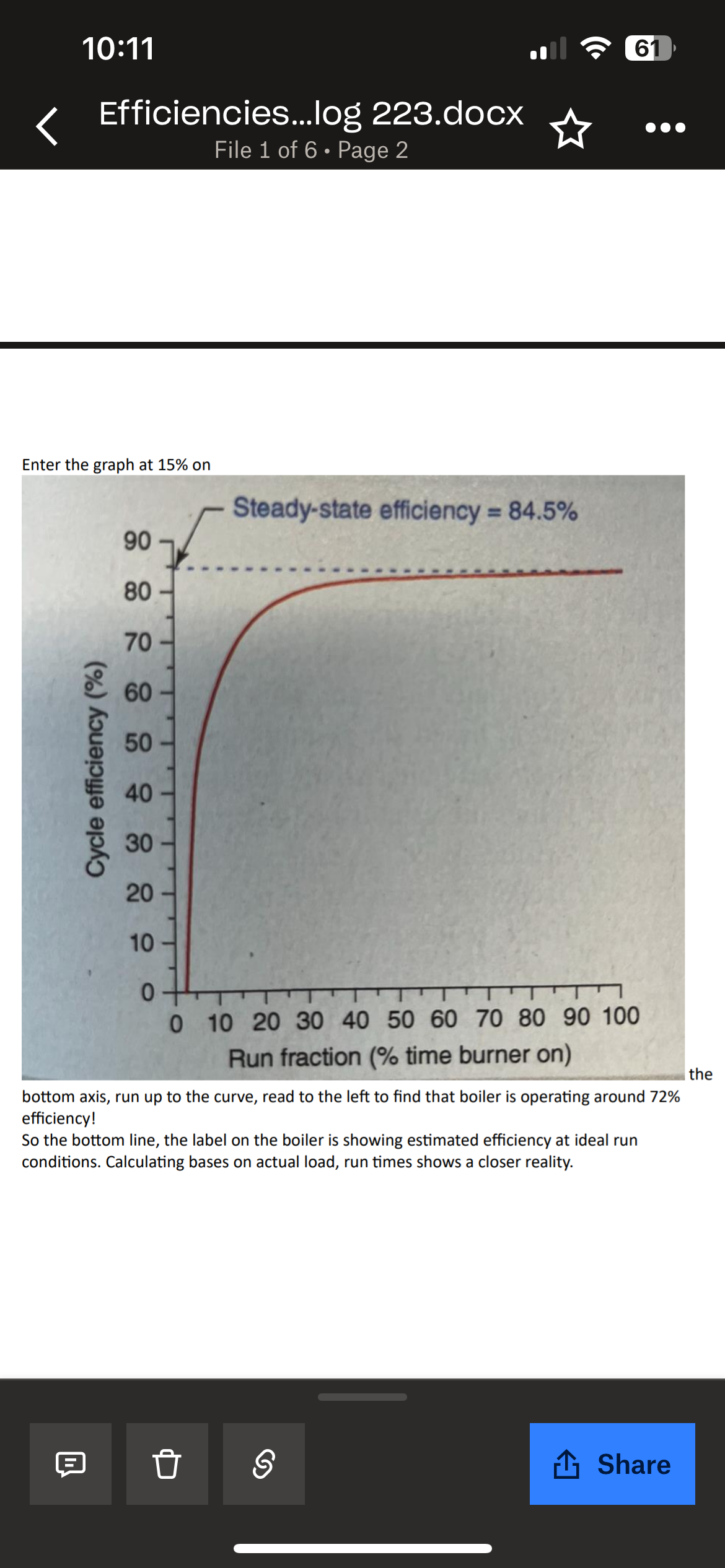

    hot_rod Posts: 28,699
    calculate the run fraction
    for example a 2 minutes run , followed by 10 minute off Gives you an elapsed time of 12 minutes
    2/12=0.167
    Graph developed by Brookhaven Lab
    16% on the bottom axis, up to the curve, read cycle efficiency on left
    Additionally it may be condensing that entire 2 minutes run

    With such a wide range of btu output, it would be hard to miss with a mod con sizing.
    With combis the BTU size is more about the DHW production.
    Running any mod con say a 150K at it's lowest modulation, call it 15,000 BTU/hr can actually increase efficiency as a large surface are is now exposed to a small burner flame, enhancing condensation.
    So no worries running on low fire. Now, I wouldn't purposely over-size the boiler, get as close as you can, step up when in doubt.

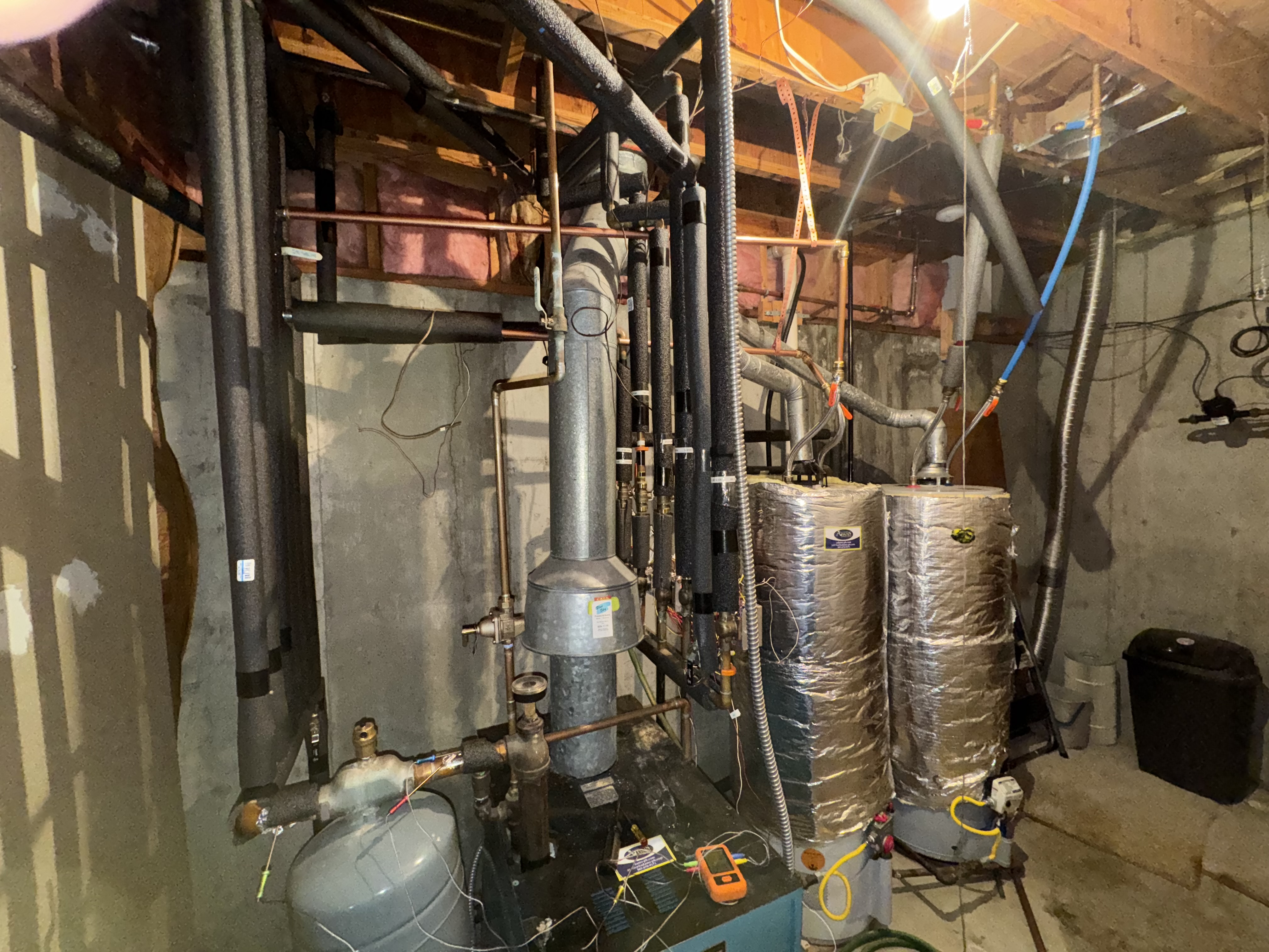

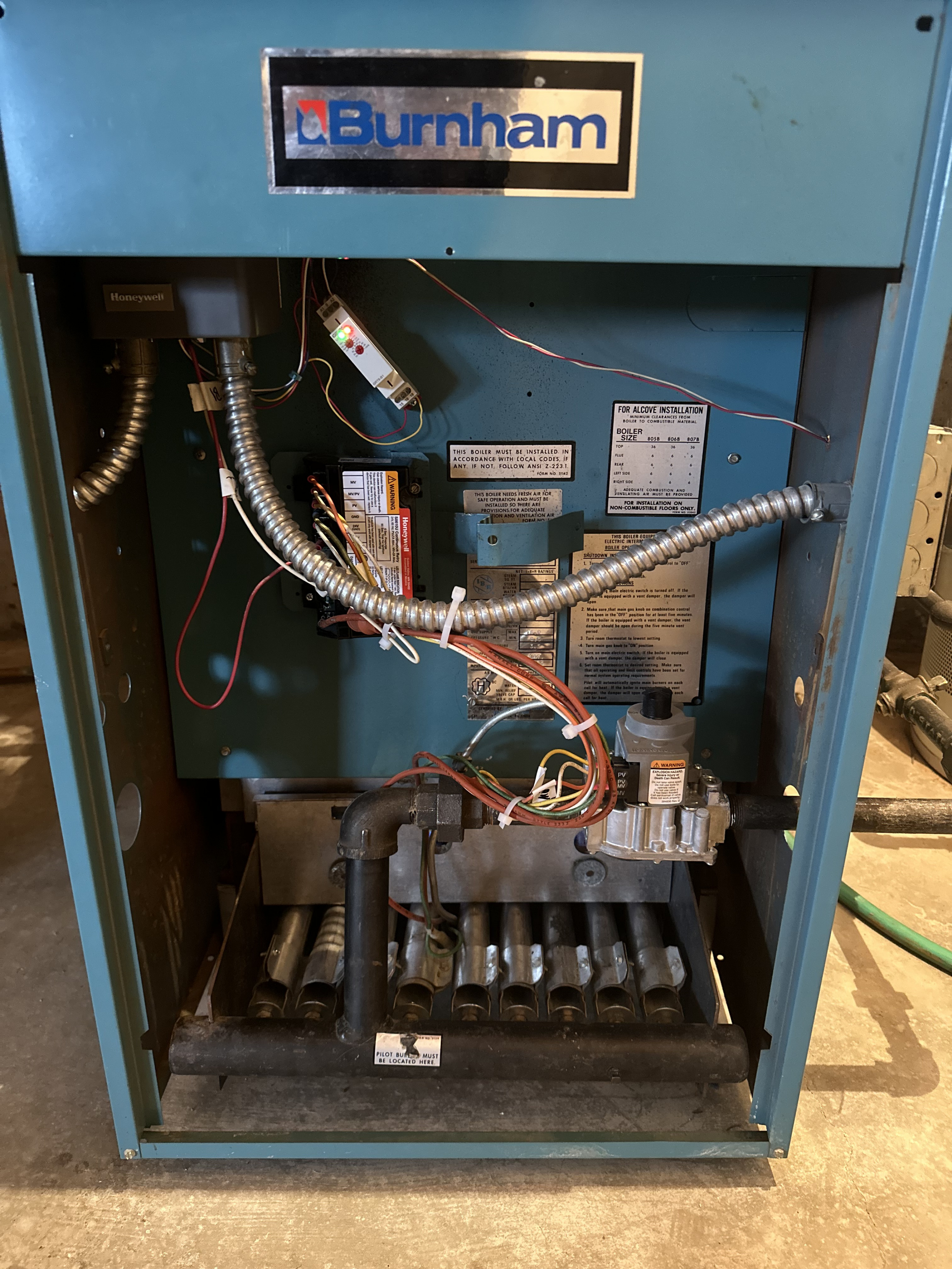

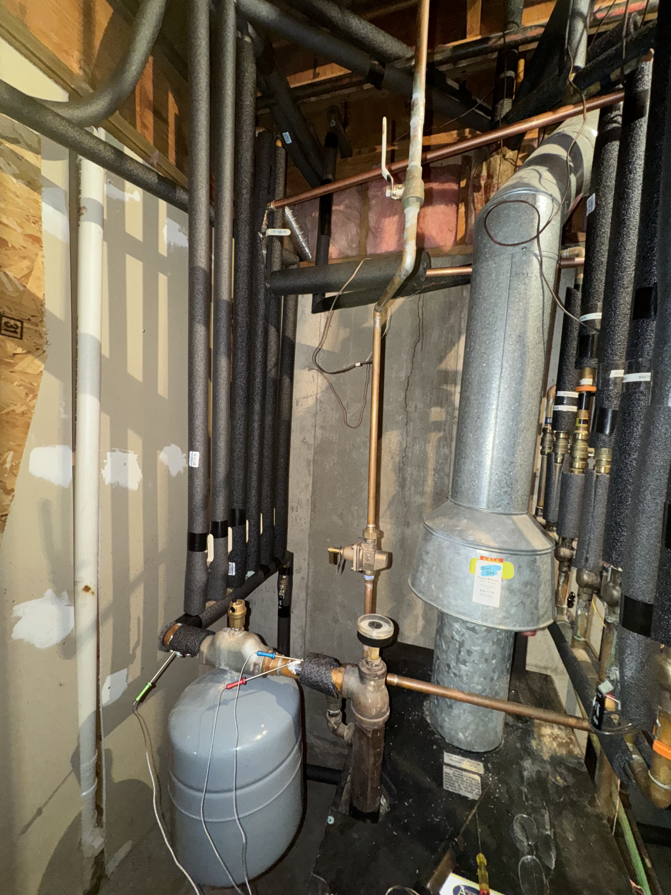

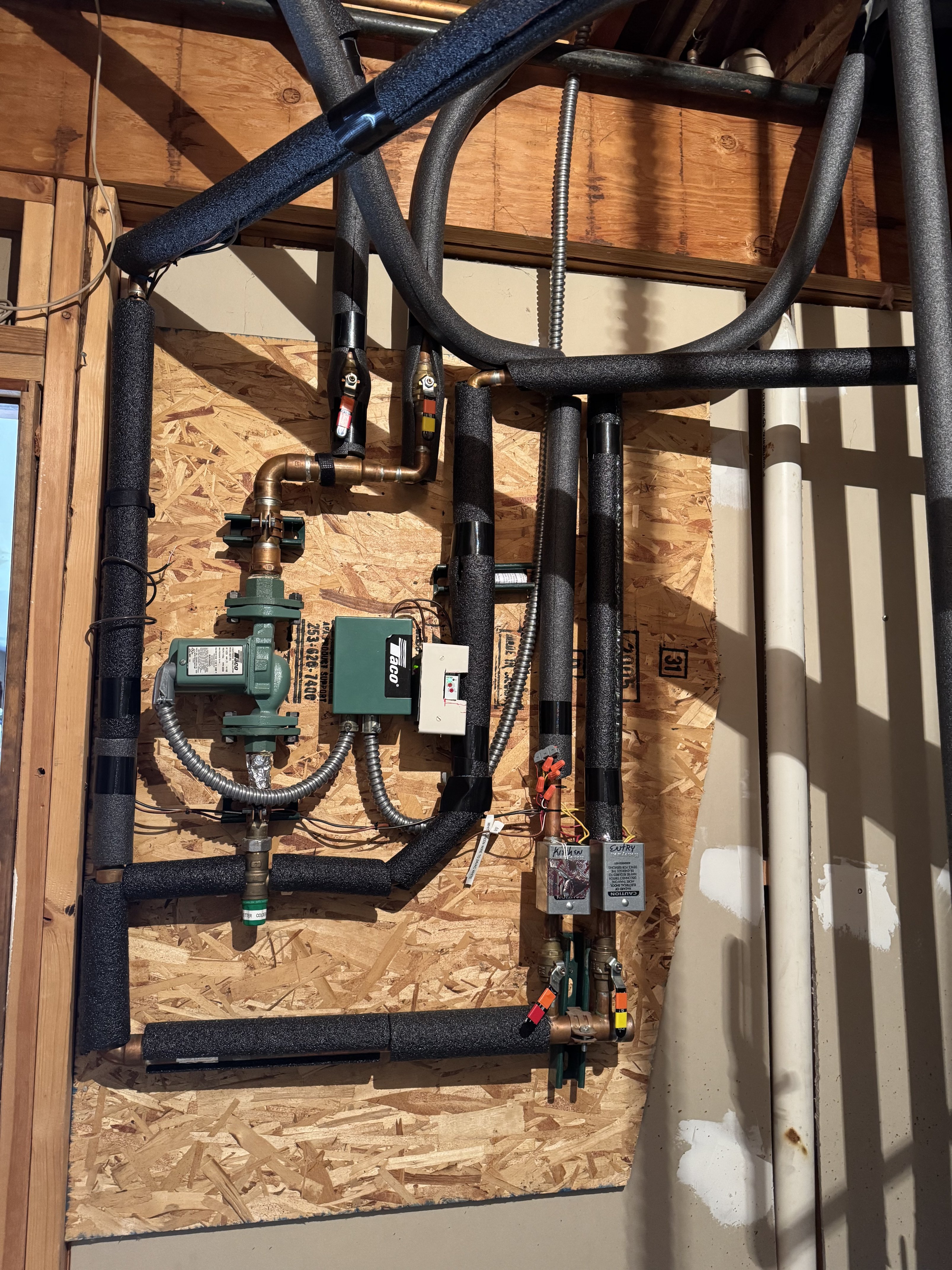

  • @dronic123. Thanks for your comments. My specific situation may not be interesting to anyone else, but here it is. My house and the original cast iron boiler are 45 years old. House is 4700 sf with mostly triple pane windows and some double panes. I did a spreadsheet and came up with 940 sf of windows. 2000 sf roof and 3000 sf of walls. I don't know if I have 2X6 or 2X4 walls. My furnace is a Burnham 805B. 264,000 BTU Input and 178,000 BTU output (65% efficiency). I suspect it is much less than that since it is so old. The original house had 7 zones which I determined was highly inefficient because it reduced the heat dissipation. So I forced all of them open in order to maximize heat dissipation. Anytime I ask for heat in any of the zones, the heated water goes to all the rooms. I also added a power off relay which makes the circulators run for 6 hrs after the furnace turns off. I did this to release all the heat trapped in the huge cast iron boiler into the house instead of going up the chimney. The other benefit is that I have some underground pipe in the basement that froze during a particularly cold spell. Luckily for me, it was not frozen solid, just enough to make me sweat bullets. With the water constantly circulating, there is no way the pipes will ever freeze. I have a TACO 007 circulator, which uses 60 watts, so the electric cost is merely $3/month — a small price for all the benefits I mentioned.
    I have an old HW heater which I don't need. So I added it in series with one of the zones to increase thermal mass to the system. I just completed it today. I have not studied the results yet.
    I keep my house at 61 F to keep my energy cost low. Last month's gas bill was still $400, I would like to eventually be able to get it up to 68 if I can get my old boiler to be more efficient. I have toyed with the idea of blocking half the jets, but Burnham tech support told me not to do so. I am also afraid that with a n 45 year old boiler, I might strip the threads trying to remove them and then I will really be in deep trouble.
    My boiler at its best goes on for 2 minutes before shutting off —— not because of the thermostat, but because the aquastat is telling the boiler the water has reached 180 degrees. My digital thermometer with 4 sensors tells me that the circuit board is working correctly in that the furnace comes back on after the water drops 10 degrees. That tells me that the boiler is grossly over sized given that the emitters cannot dissipate the heat fast enough.
    The controller board is Honeywell L7248. The default setting ibetween the Hi and Lo temp is 15F, but my measurements show 10F. I want to change the setting so that the lower setting is 20 or even 30 degrees to reduce the short cycling. I am not sure Honey will allow that wide a differential. That is the next step in my journey. Anyone who is willing to share how to modify the circuit is greatly appreciated.

    There was also a comment about the boiler efficiency being lower than specified just because it is old. That is simply not true. It may be lower than spec., but not because of age — because of inadequate maintenance.

    Your comment "There was also a comment about the boiler efficiency being lower than specified just because it is old. That is simply not true. It may be lower than spec., but not because of age — because of inadequate maintenance.". I think it gets less efficient because there is calcification and corrosion INSIDE the cast iron water jacket. Since it is a sealed system, it is impossible to remove that. Calcification and crud reduces the heat transfer, so more heat is lost up the chimney instead. I know there is a lot of corrosion because every time I replace a component — pressure regulator, air bleed valve, expansion tank, I see lots of crud. If it forms at those places, it must form inside the tank too.

    @mwong00 The aquastat is the gray metal box marked Honeywell in the upper left on the front of the boiler, with the two metal-clad cables coming out of the bottom. There will be a label on it somewhere with the model #.

    The next question I have is: What is the white control in this picture and where is it connected to on your boiler's wiring

    we haven't asked for pictures yet ? really?
    a couple wide angle shots, floor to ceiling, showing boiler, circs, and buffer tank, all in one, from a couple angles,
    and don't we need a 3rd circ now that a buffer tank is added
    known to beat dead horses
  • jesmed1
    jesmed1 Posts: 1,631
    Look for the 4 jpeg attachments about 10 posts up.
  • neilc
    neilc Posts: 3,213
    ok,kinda dark, and hard to follow, and can't find 2nd circ, don't we still need a 3rd circ?
    assuming the left tank is buffer and right is still domestic?
    if left tank is buffer, and if burner is disabled, consider sealing off top of tank at exhaust vent, or you're chimneying buffer heat up that stack, that burner is disabled, correct?

    agree that @EdTheHeaterMan is very knowledgeable. And a funny guy. 🥸 Also like the delay recommendation; @RayWohlfarth discussed delays in his YouTube channel a couple weeks ago.
    looking at the item Ed circled in his earlier post you appear to have some type of delay device already connected. Can you tell us how it’s connected and the part number?

    @pc7060. The relay I have is a "GEYA Delay Off Single Function Time Relay 1 Output 16A Electronic Power Off Timer Delay Relay(GRT8-B1,AC230V)".
    https://www.amazon.com/dp/B097PNHMKP?ref_=ppx_hzsearch_conn_dt_b_product_details_4&th=1
    The relay allows me to provide power even after the Honeywell aquastat tells the circulators to turn off. The timer can be set from a few seconds to days to "ON".
    Please do not confuse that with a Power On relay. Amazon has one that is labeled as Power Off relay, and it is not. I doubted myself for a long time, and finally, I tested the darn thing on a bench and proved conclusively that Amazon has messed up. The part I show above is the right part.
    The far more useful thing using this relay is that I have solved the problem with frozen pipes when the weather gets super cold. I seldom use my basement in the winter, and so I leave the temp at 50F. Well, on a particularly cold snap that lasted for days, the pipe under the basement floor froze up. The only reason I found out was because I the basement temperature dropped below my setting of 50F. I touched the pipe next to the boiler, at it was cold. That meant that the water has frozen somewhere inside the piping. Terror struck me. the cost of figuring out where the freeze was, and to bust through the concrete to fix it would be super expensive. I used my wood stove at full flame to raise the temperature as high as I could to get heat to the floor. Luckily the pipe was not frozen solid,
