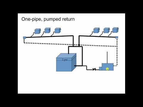

  • Justin20
    Justin20 Member Posts: 28
    edited January 2022
    NHOwner said:
    https://www.youtube.com/watch?v=tpA1epqFMCw
    Here's a link. Which one pipe system do you have?
    Here's a crude drawing of my system. My 'return' (i know there's not really a return as it's one pipe) drop is actually about 2 feet out of view from the above pictures. The red arrow in the drawing illustrates where i'm trying to install a vent.
    The last 2 radiators at the end actually get hot first.. its the guys in the middle that take forever... go figure...
    Regarding an adding a proper antler with a tee, as you can see - there are no unions anywhere in that location to disconnect the pipe to add one, and the main is in like 20'+ sections. I can't really see where i can easily get a tee in there. I'm open to suggestions from you experts.
    Jamie Hall Member Posts: 27,584
    If that drawing you made of your system is more or less accurate -- and looking at the pictures it may be -- that return on which you placed the vent may be partly flooded as soon as the boiler produces an pressure at all, since there doesn't appear to be an equalizer. So it's no wonder it doesn't help much.
    However. Do I see a union just out of the picture to the left where it says "to boiler"? What is on the boiler side of that union, if it is a union? If it is a length of pipe, which I would probably try is to take that length of pipe, shorten it about a foot or so, put in a T and a nipple joining back to the union, and mount my main vents on that T. That won't be a bad place for the main vents in that system, and it involves a minimum of difficult work.
    If that's a union...
    It's too low to be a dry return and too high to be a wet one. A dry return, or any horizontal pipe above the water line, must be considered a steam pipe. Even if it never sees live steam, it's still subject to steam pressure, and it must be at least 28 inches above the water line to allow the condensate to return to the boiler.
    Also, you don't show the header in this diagram, but I'm pretty sure you have one.
    Justin20
  • Justin20
    edited January 2022
    It's too low to be a dry return and too high to be a wet one. A dry return, or any horizontal pipe above the water line, must be considered a steam pipe. Even if it never sees live steam, it's still subject to steam pressure, and it must be at least 28 inches above the water line to allow the condensate to return to the boiler. Also, you don't show the header in this diagram, but I'm pretty sure you have one.
    @Hap_Hazzard Good eye. You can't tell from my photos but unfortunately my "A dimension" is more like 17 inches instead of the recommended 28 (i measured it). There's nothing I can do about that without basically tearing open every wall of my basement along that side of the house.
    @Jamie Hall I'm STRONGLY considering moving the vertical drop of the dry return to the end of the line in addition to adding another main vent. (See drawing)
    I've modified my earlier diagram to be a bit more accurate since i didn't include the equalizer, hartford loop, header, etc.
    - my Hartford loop drawing may be a bit off but you get the idea.. it's there, and in proper position best i can tell
    - as some of you have pointed out ( @EBEBRATT-Ed ) my 2 mains are connected. I have no idea what that's about or why it was done this way.

    @Jamie Hall I've gone through the entire run based on photos during the home renovation and have determined that the return line is not sloped at all towards the boiler, but is instead completely straight with no slope at all. This could be an issue. Ive always had hammer on initial boiler startup when it starts making steam but only for a minute or so and not incredibly bad (I've heard worse) so I've ignored it. I'm guessing this is the cause.
    Honestly i can live with this, but if the lack of slope is driving up bills then i will RAISE the return line - fixing two issues at once... 1) adding the 1"/20' slope and increasing my 17" A-dimension to 28".
    To be clear, if this needs to be done then i will do it, no problem. But my main issue remains the delayed heating of the long main rads, and most importantly DECREASING my monthly heating costs.
    I purchased some varivents that arrived last night and replaced my Maid-o-mists on the problem rads with those. The radiators went from taking 2 hours to 1 hour to get hot. Yes.. i had tried the various M-o-M vent cap sizes with no luck (i went as high as "D")
    I also found that one of my bathroom "radiator" (really just a riser pipe) vents had failed and won't close. It's hissing and letting steam out even after it's hot (see photo):
    At the boiler I very carefully watched/felt the 'dry return' pipe and noticed it doesn't even get hot until maybe an hour after turning the boiler on
    .. around the same time the slow rads begun to heat. The header/main got hot maybe 20-25 min after a cold start... maybe another Big Mouth will help?
    @clammy @neilc @SteamingatMohawk i am also not 100% convinced the connected mains, while certainly not ideal, are the primary cause of my issues. Repiping is definitely in my future, but i think once i am ready to go that route, I'm going to just replace the whole damn thing as well. The $6k+ quotes I'm getting in my area for the job (excluding the cost to repair/replace the walls/ceilings that would need to be torn up) has me looking for stop-gap solutions to at least keep me warm and not paying crazy bills for maybe another 2 winters?
    I could definitely fix that A dimension and return pitch issue myself though. I could also separate the 2 mains with pipe plugs as @SteamingatMohawk suggested.
    Updated drawing
