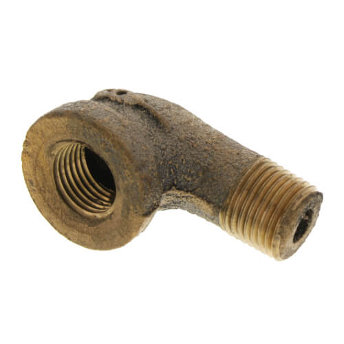

Thank very much Clammy. Would it make sense for me to buy 90 degree elbows for my convectors so I can use adjustable Hoffman 1A's? If so, would I use galvinized elbows?0
Use brass if you can get them.garimh said:Thank very much Clammy. Would it make sense for me to buy 90 degree elbows for my convectors so I can use adjustable Hoffman 1A's? If so, would I use galvinized elbows?
or Stainless Steel0
Thanks. Supply House sells these but that hole on the male end looks quite small. Would that be a problem? I'm assuming it might slow thing down but have read that mains should be vented quickly and radiators slowly so assuming that's fine.
If I was using a 90 style vent like a Hoffmann 1a then yes on a 90 but usually on convectors I use straight style vents .
