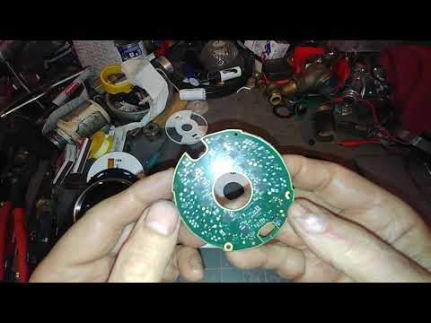

    Here is a teardown of a 2nd gen NEST thermostat.
    Apparently, it also has a microphone, as well as a video camera or two.
    "Don't be evil"
    https://www.youtube.com/watch?v=LP6svLIADIc

  • ratio
    ratio Member Posts: 4,264
    Nest, ecobee, Honeywell's got one, I'm sure there are others.
