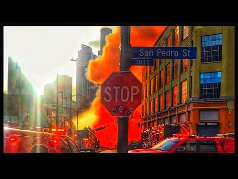

    Another view- watch the firefighters escape THROUGH the fireball:
    https://www.youtube.com/watch?v=Fg36duyIsAs
    The post-mortem on this should be interesting. I'd be willing to bet the city's permitting department didn't know what was actually going on there. Such a building is no place to store that much butane. And they don't say, but I'd bet there was a NG service to that place, which would have increased the available fuel.

    Butane, that would make this a BLEV explosion? Scary stuff.

    Actually, my understanding is that it was a hash oil factory. It may well have been butane, but the manufacture of hash oil in any scale -- which certainly is the case in sunny southern California -- involves large amounts of very volatile, very explosive solvents -- of which butane is one, and ethanol another -- and is an inherently very hazardous process.
    Did the city's permitting department know that that was what it was? Very likely, actually, since it is perfectly legal in Kalifornia, though they may not have realized the hazard. Did the people working there understand the hazard? Very likely not, even if they themselves weren't consumers of the product. Was hash oil the only product manufactured there? Perhaps... though I might mention that it's manufacture and distribution has been linked in the past to the processing of cocaine and production of methamphetamine, both of which processes are even more hazardous.
