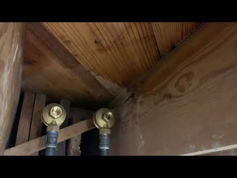

https://youtu.be/ZSTeZo0xMM4
Boilertrol Cut in set to .5psi, diff set to .5psi
It was throwing steam to the floor boards added nipple and elbow to direct it downward.
@Jamie Hall I guess I found my water loss.
What the heck dudes?!

    that pipe isn’t doing much. Take the leaker out of service. I did too. And others

    It’s directing condensate to the floor!

    Was it leaking from day one or did it start leaking after a month?

    They have a good guarantee, so contact the factory, for a replacement. They did have a bad batch, but will stand behind their product.—NBC

    Working great when I installed it in December. My worry is that the other 4 I installed are going to head south as well.

    They had a bad run of parts that are easily replaceable and they will stand behind. It's not a bad design.
    Just keep an eye on the others or talk to the manufacturer and ask them how to proceed. They may want to swap them before they fail.

    Even when mine does seal, it takes a long time, puffing more steam than I want to release each cycle. I love the solidness of it and the design, but in practice it's just not great in my opinion.
    And ironically due to its amazing flow capacity, it will throw a LOT of steam at your ceiling when/if it fails.
    And I believe there has been more than one bad batch.
    But to clarify, I wasn't say throw away your Big Mouths. I was saying take that leaking one out of service. You don't want that steam humidifying your ceiling like that and you don't want to waste all your steam into your basement.
    edit: one thing that comes to mind...maybe my system is too small for it. It might require a certain steam production to close faster, I don't know.
