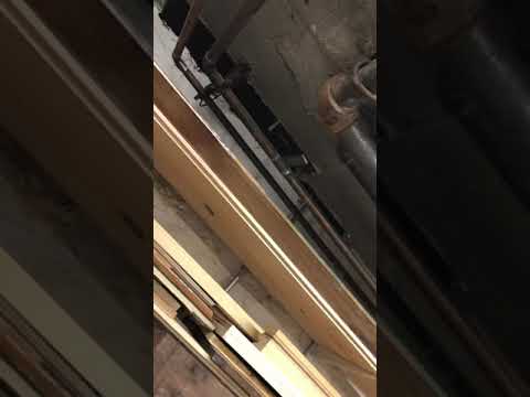

We are moving some pipes and Radiators on a two pipe steam system. Each radiator has a radiator valve on the supply and the return with no trap. The radiators also have vents on them. Some of the supply and return risers pick up more than one radiator. There are teo mains and at the end of each msin there is a loop seal. The homeowner says everything heats fine and is quiet. I’m trying to figure out if I should put traps on the stuff that we are doing or leave it the way it is. At some point before the next heating season we will be replacing the boiler and installing a vaporstat.

    Sounds like a 2-pipe air vent system, but maybe not. As always, pictures help...Do the returns connect above or below the waterline? Ideally in a 2-pipe air vent system, they would/should each drop individually into the wet return. But the loop seals you describe make me think it’s a orifice system that someone knuckleheaded. Again, pics please!

    They do not drop individually into wet returns. Everything goes into dry returns which is why I thought there should be traps. No orifices. Just radiator valves in supply and return.

    Dan C. Member Posts: 248
    edited April 2018
    https://youtu.be/5N6yJ3-FcxQ
    https://youtu.be/UWuZlCK7ILg
    Couldn’t figure out how to post a video. I uploaded these on to YouTube.

    The picture on the right shows an air vent, along with two pipes. Looks like a two-pipe air vent, as read about in TLAoSH, also see here for radiator pics.

    I have worked on plenty of two pipe systems with air vents. Never with dry returns. I’m trying to figure out if I need to do something different with the radiators and pipes we are moving. Either add traps or run them all individually and run a wet return.
