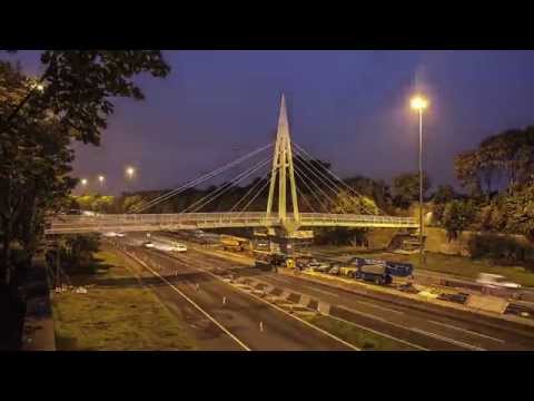

    Gordy said:
    Gordy said:
    http://abcn.ws/2GxcLNg
    Now does it look like any cable stays were up off a tower when the span was set? Unless this design completely changed from the original concept.
    No it does not.
    And, therein lies your problem if you add load to it without those cable stays.
    Such a span is too long to support much of a load without stays, IMHO. It's own weight might be marginal.
    950 tons over six lanes of traffic, bearing on probably 8 square feet each end guesstimate.
    My guesstimate on span is over 100’ with 6 12’ lanes 2 8’ shoulders, and the piers off the edge of the road an unknown distance.
    950 tons on 8 square feet is no issue. It's the 300 tons in the middle creating the bending moment (and causing tension in the concrete on the bottom) that you have to worry about.
