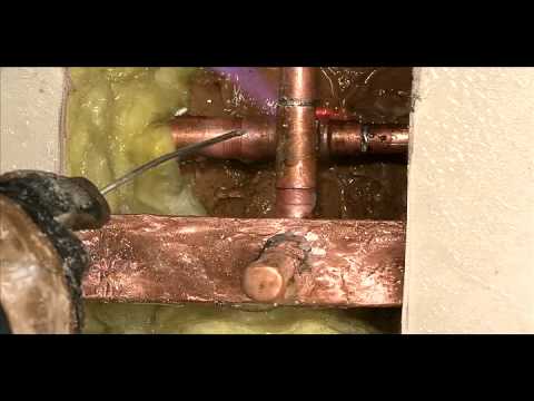

I'm planning on little bit re-piping this weekend to eliminate a couple of awkward bends in my spaceheating loops near the boiler. Of course it will require soldering right up against dry 50yo floor joists and drywall... again.
I've read a few posts regarding the "Cool Gel" spray product, and watched their video's on youtube. It looks like really handy stuff that will make the job easier and much safer. I've used heat blocker pads and water from a spray bottle in the past but "Cool Gel" looks way better than both of them.
Is the "Cool Gel" really that good? Does it work as shown in the videos? They show a guy soldering almost right up against drywall with no protection except for the gel...
https://www.youtube.com/watch?v=3i88bKlY0t0

    I've found those pastes to be a big mess & not really all that much protection, at least when brazing linesets. Plumbing solder may be different, but I seem to dry out the stuff in contact with the pipe & then I don't think it'll work, as it starts to pull away from the surface. Wet rags and a spray bottle of water, or the woven flame shield and a spray bottle, or the ceramic insulation on the aluminum backer if I know I'm going to have flames directly on it.
    HVACNUT Member Posts: 7,407
    Usually having some smoke pipe laying around, I cut what I need and wedge it between the pipe and the combustible. Works every time for me.

    Once the pipe is cut I'll pull a couple of clamps off down the line and pry the ends that I have to solder down and away from the joists a bit, then I'll spray the wood and drywall cavities with the Cool Gel and use the welders blanket too.

    Pried the old pipe hangers off the framing a few feet before where I needed to solder- pulled the pipes off the framing and held them in place with bailing wire, sprayed the area behind the pipes with the Cool Gel and no burning occurred during soldering.
