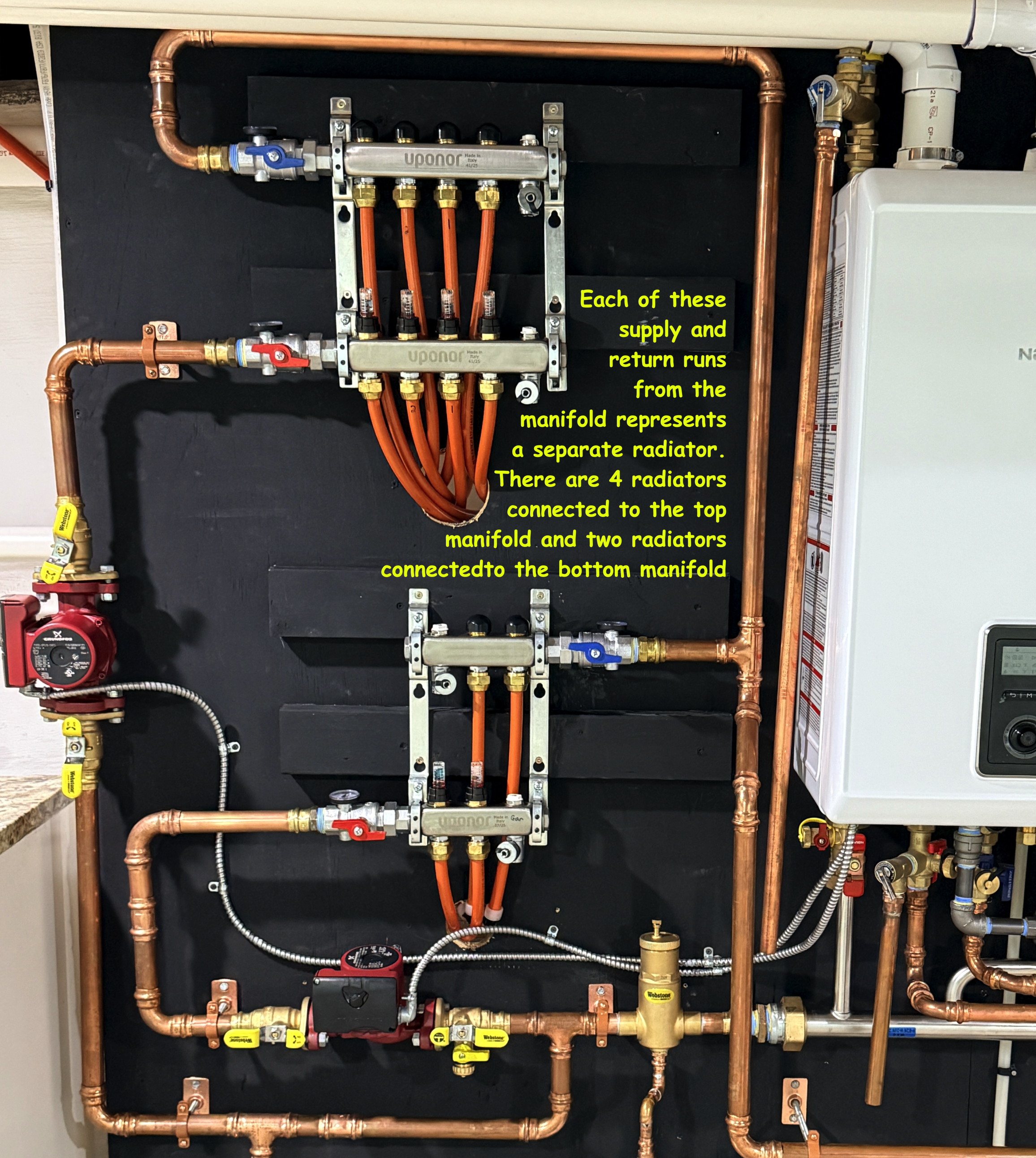

    or a home run system to a manifold:
    instead of monoflo:

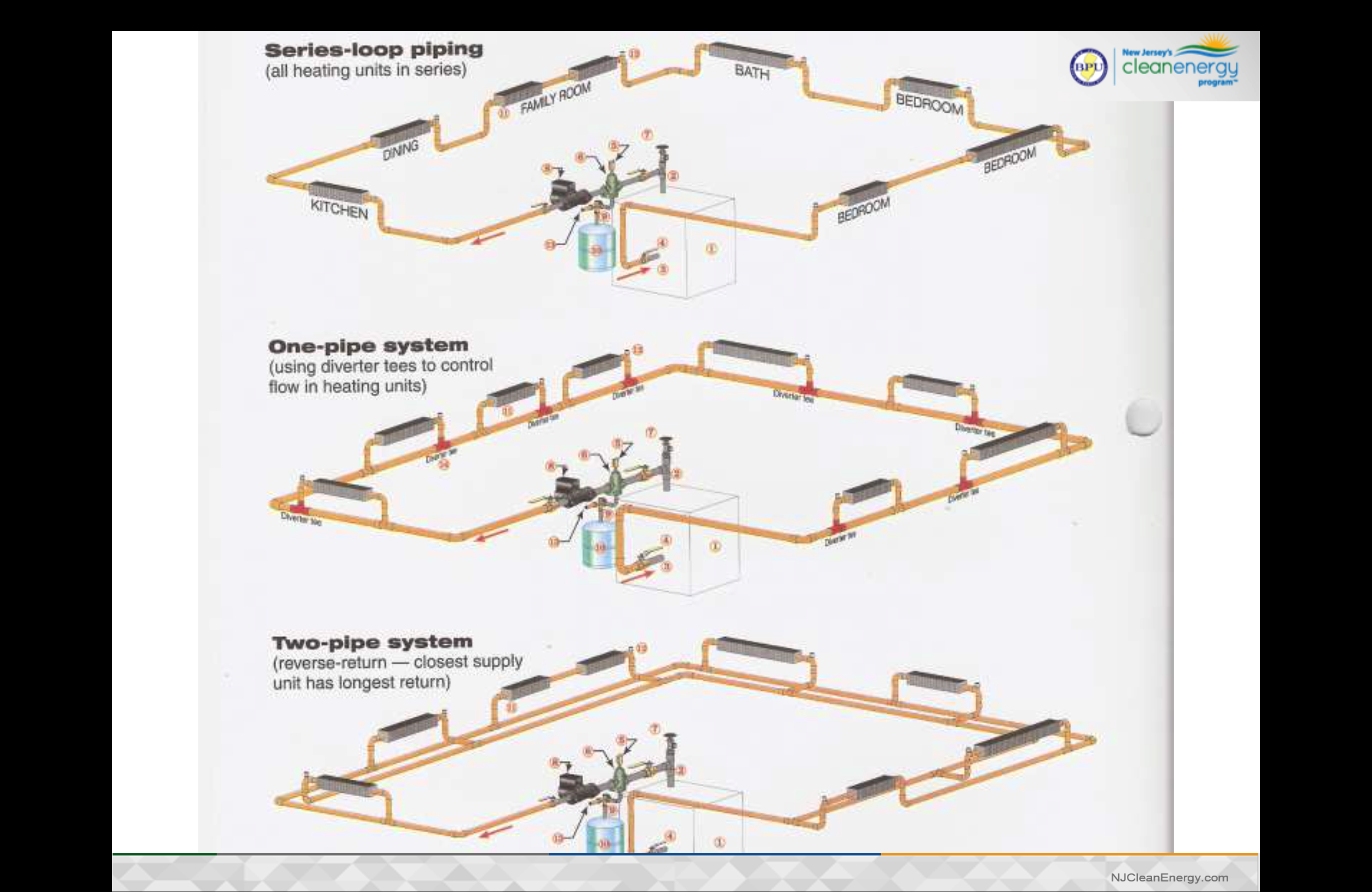

    A two-pipe parallel system eliminates many of the variables that need to be overcome when designing a one-pipe Monoflo® system. There is also a much simpler series-loop design if your radiators are 3/4-inch copper tube with aluminum-fin baseboard radiators.
    The other option is a home-run system, which is somewhat like a parallel system, except the main supply and return piping is very short and the individual branch runs to each radiator are relatively long.
    Sometimes it is easier to understand the differences by looking at a simple visual diagram.
    Top is a series-loop system.
    The middle is the one-pipe Monoflo® design, where one main pipe circles the basement and returns to the boiler. All of the supplies and returns are connected to that one main pipe, with a diverter tee on each return. The diverter tee creates a restriction that directs some of the heated water through the radiator, while most of the flow continues straight through the main.
    The bottom is a two-pipe parallel system, where all of the supplies are connected to one pipe from the boiler supply, and all of the returns are connected to another pipe that goes back to the boiler return.
    The system shown in the illustration is a reverse-return system, but there are many systems with a direct-return design, where the first supply connection off the boiler is also the first return connection back to the boiler.
    This is how many older gravity heating systems, which operated without a circulator, were designed. Once you add a pump to move the water through the system, that type of piping can become unbalanced.
    The home-run system has the supply and return manifolds located in the boiler room near the boiler. All of the individual supply branch piping is connected to the supply manifold, and all of the individual return branch piping is connected to the return manifold.
    Each radiator or heating circuit has its own separate supply and return run back to those manifolds.
