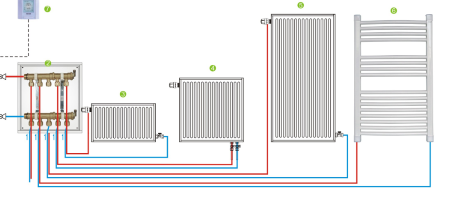

Is there any reason you couldn't pipe the second floor as a separate zone off the boiler with separate supply and return? If you do separate supply and return or home run it will eliminate a lot of variables and a separate zone will allow the first and second floor to be independent since they will never have the same heat loss at the same time. You could put balancing valves in the basement if you don't have room for fittings at the baseboard. You could also feed them with 1/2" oxygen barrier pex fished up through the building.

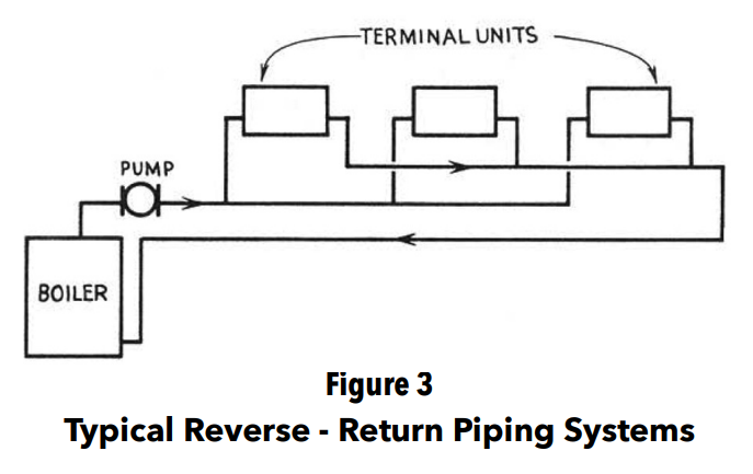

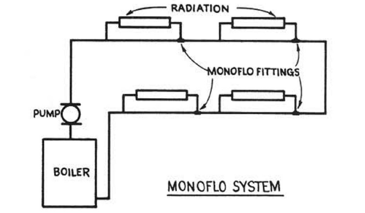

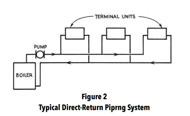

if you are going to pipe a whole new zone, use a layout that is more forgiving of not getting the math exactly right. monoflo saves some pipe but you have to get the math right for it to be even or even for it to all heat at all.
pipe the new zone as direct return:
or reverse return:
or a home run system to a manifold:
instead of monoflo:
