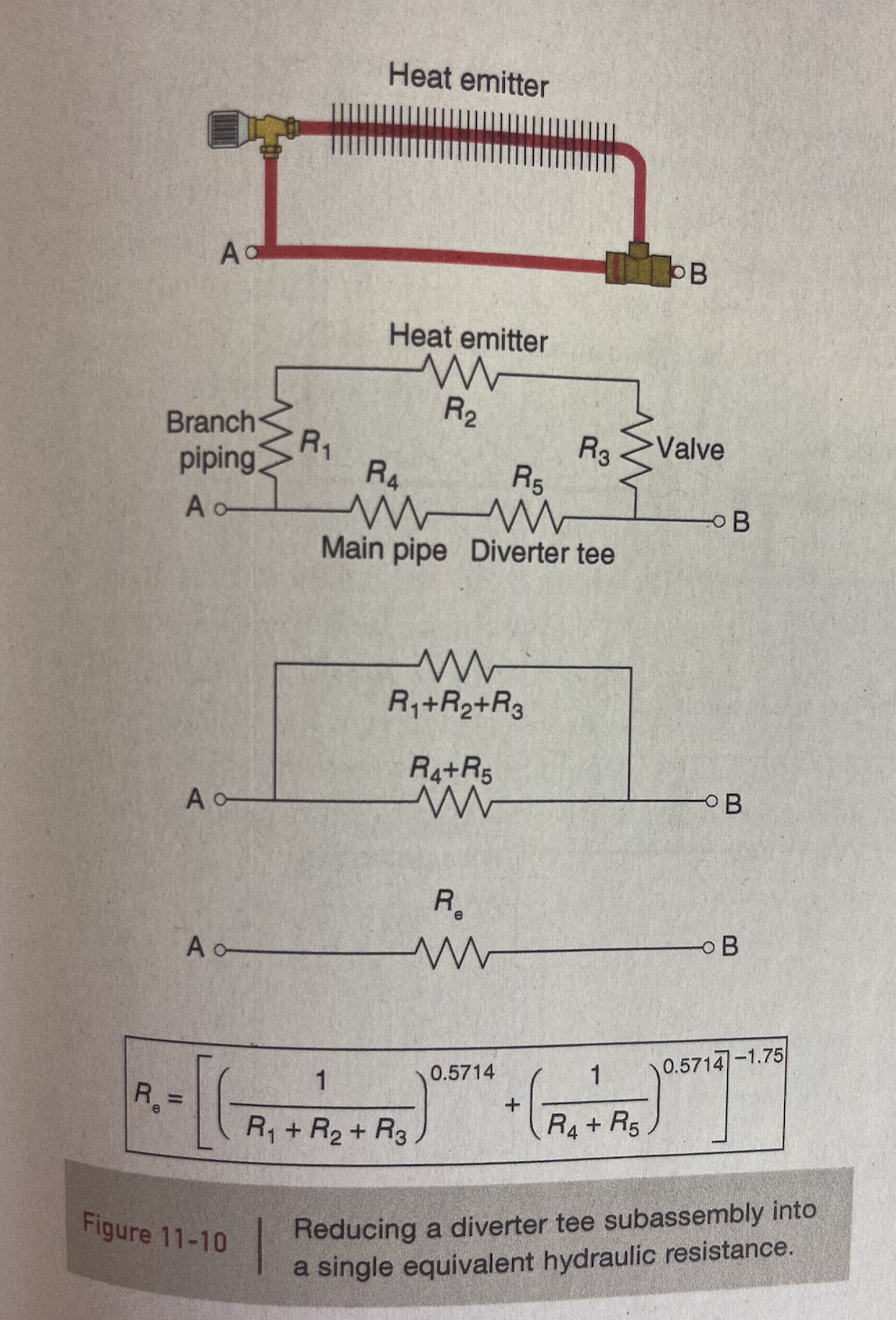

Here is where I need help:
  1. My risers & return drops are approximately 9 feet. Will it suffice to use one venturi tee on the return side of each rooms circuit?
    1. Do I need a cast venturi tee? Some are rough castings everywhere except the pipe sweat surface. (I expected at least the reduced opening would also be machined for predictable performance). Perhaps I'm too particular!
    2. I'm tempted to use 3/4 x 3/4 x1/2 Tee w/ a NIBCO venturi insert. Anyone have experience opinions about this option? If I go this option I'll be scribing the standard tee to indicate the insert & it's direction.
    3. I have pipe chases where the supply and return for adjacent circuits are co-located. I put the return venturi tee 16 inches prior to the pipe chase and the next room's supply tee (3/4 x 3/4 x1/2, no venturi) 16 inches after the pipe chase. -Is this much separation necessary (advisable)? Alternatively, is it better to place the venturi at the pipe chase and the supply some distance downstream? What is the recommended separation distance?
  2. I'm working up circuit distances in pipe equivalents…
    1. These distances will inform decisions about whether more than one venturi is required in a circuit, right?
    2. The circuit distances are from the boiler supply manifold to the boiler's return manifold, correct? (not just the 1/2" branch and the radiator length)
Would really appreciate some experienced guidance. Thanks in advance for weighing in!

    There are quite a few steps. Perhps you Pa did that for the original design?
    Maybe get a copy of this on Amazon and give it a read to avoid a system that doesn't do what you expect.

    if you are going to pipe a whole new zone, use a layout that is more forgiving of not getting the math exactly right. monoflo saves some pipe but you have to get the math right for it to be even or even for it to all heat at all.
    pipe the new zone as direct return:
    or reverse return:
    or a home run system to a manifold:
    instead of monoflo:

    A two-pipe parallel system eliminates many of the variables that need to be overcome when designing a one-pipe Monoflo® system. There is also a much simpler series-loop design if your radiators are 3/4-inch copper tube with aluminum-fin baseboard radiators.
    The other option is a home-run system, which is somewhat like a parallel system, except the main supply and return piping is very short and the individual branch runs to each radiator are relatively long.
    Sometimes it is easier to understand the differences by looking at a simple visual diagram.
    Top is a series-loop system.
    The middle is the one-pipe Monoflo® design, where one main pipe circles the basement and returns to the boiler. All of the supplies and returns are connected to that one main pipe, with a diverter tee on each return. The diverter tee creates a restriction that directs some of the heated water through the radiator, while most of the flow continues straight through the main.
    The bottom is a two-pipe parallel system, where all of the supplies are connected to one pipe from the boiler supply, and all of the returns are connected to another pipe that goes back to the boiler return.
    The system shown in the illustration is a reverse-return system, but there are many systems with a direct-return design, where the first supply connection off the boiler is also the first return connection back to the boiler.
    This is how many older gravity heating systems, which operated without a circulator, were designed. Once you add a pump to move the water through the system, that type of piping can become unbalanced.
    The home-run system has the supply and return manifolds located in the boiler room near the boiler. All of the individual supply branch piping is connected to the supply manifold, and all of the individual return branch piping is connected to the return manifold.
    Each radiator or heating circuit has its own separate supply and return run back to those manifolds.

  • A copy of Siegenthaler's tome expected later this week. Thanks for all the diagrams and accompanying comments. Will revaluate and seriously consider the direct return option, and set aside my penchant for problem solving (often self created, LOL).
