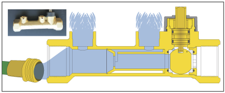

The installers had never installed one of the valves, since I asked for it to be installed. When they took it out of the box, a cylindrical brass piece about 2" long and 1" in diameter fell out from inside the valve. It had an O-Ring and on the flat end and a conical flare on the other. I saw the part sitting on top of the boiler, so I'm almost positive that they installed the valve without the cylindrical insert in place.
My guess is that this piece not optional and that it is it required to provide the pressure differential that drives the flow meter. Does anyone know if this is the case?

    Looks like there should be a venturi in the body of it and you have to pull the ring for it to read anything:

    It takers a bit of force to get this spool out of the body? Matt took on off the shelf to see how it would disassemble.
    Was it separated in an unopened box?
    It definately needs to be in the body to read.

    Thanks for the answer and the picture! The cylindrical part on the right is exactly the part that fell out of the box when it was opened. The box and the valve looked new. It was ordered from a highly rated online supplier, so it did get a bit of "truck time" during delivery.
    I verified with the contractor that it was not installed. During installation, looking at the installation videos they saw nothing about installing the "extra" part. Looking at the installation instructions myself, it seems that it is not ever expected to fall out, since it was not obviously called out as a separate part.
    Could the part getting dinged up by rattling around inside the box during shipping affect the ability to re-seat it or the measurement accuracy?
    Looking at the cutaway view below from https://www.caleffi.com/en-us/blog/how-clean-balancing-valve , presumably the part goes in flat end first? Does the rotational orientation matter at all, i.e. does the slot in the cylinder need to point toward up as shown in the cutaway view?
