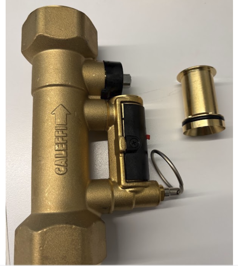

I recently replaced the 60 year old gas boiler on a large 4 loop Monoflo system. The loops are 1" steel pipe in the basement and 1/2" copper risers to the convectors. I had them use 3/4" Taco ZoneSetter valves, since they have higher Cv than the 1" version.
I had the tech install a Caleffi 132 1-1/4" 5-19 GPM flow meter in the supply as a sanity check on the flow through the system with various combinations of zones open.
I have a Taco 0011 pump, so I figured that I would have at least 5 GPM to register flow on the meter. With the shortest zone only, I get no measured flow, and with all 4 zones open I get no measured flow. The system heats fine and the circulator sounds fine, so there is definitely flow.
The installers had never installed one of the valves, since I asked for it to be installed. When they took it out of the box, a cylindrical brass piece about 2" long and 1" in diameter fell out from inside the valve. It had an O-Ring and on the flat end and a conical flare on the other. I saw the part sitting on top of the boiler, so I'm almost positive that they installed the valve without the cylindrical insert in place.
My guess is that this piece not optional and that it is it required to provide the pressure differential that drives the flow meter. Does anyone know if this is the case?
Is there any possibility that a Taco 0011 would not provide a flow above 5 GPM with all 4 zones open?

    Looks like there should be a venturi in the body of it and you have to pull the ring for it to read anything:

    It definately needs to be in the body to read.

    Thanks for the answer and the picture! The cylindrical part on the right is exactly the part that fell out of the box when it was opened. The box and the valve looked new. It was ordered from a highly rated online supplier, so it did get a bit of "truck time" during delivery.
    I verified with the contractor that it was not installed. During installation, looking at the installation videos they saw nothing about installing the "extra" part. Looking at the installation instructions myself, it seems that it is not ever expected to fall out, since it was not obviously called out as a separate part.
    Could the part getting dinged up by rattling around inside the box during shipping affect the ability to re-seat it or the measurement accuracy?

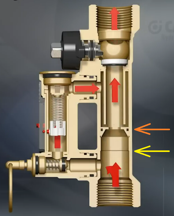

    Looking at the cutaway view below from https://www.caleffi.com/en-us/blog/how-clean-balancing-valve , presumably the part goes in flat end first? Does the rotational orientation matter at all, i.e. does the slot in the cylinder need to point toward up as shown in the cutaway view?

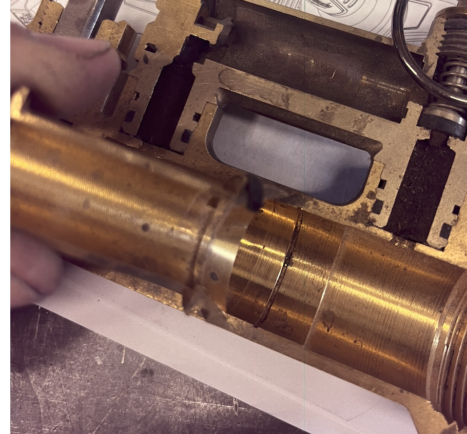

    I looked at a few I have here.

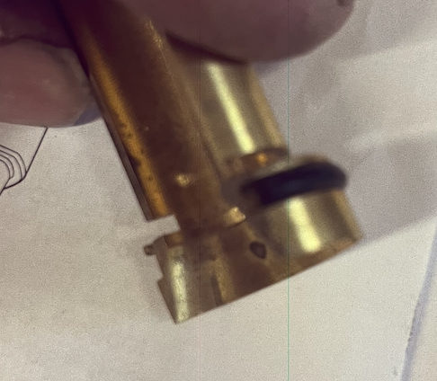

    It looks like a tool puts 4 indent marks into that inner piece that lock it into a groove in the body. It may be hard to see in these pics? Like maybe a 4 sided star punch pushes some brass into the groove?
    You can see that groove in this cut away, with the spool just above it.
    It takes some force to push it out.
    I'll see if I can get the factory tomorrow to understand how it goes and stays in.
    Certainly it is under warranty if you can remove and return it.
    Sorry about the hassle.

    circling where it is staked might help. i can't tell what is a spot of corrosion and that is the indentation where it is staked. a macro lens would help too.
    109A_5 Posts: 4,759
    I suppose the venturi could be crimped once fitted into place, the purpose for the groove near the O Ring. If it is crimped in there is no taking it apart to clean the slots.
    I'm surprised the O Ring would not hold it in place (Orange Arrow). How well would the O Ring seal if the venturi could just fall out ? I'm thinking it was just not properly seated past that slight shoulder on the inlet side (Yellow Arrow).
    crj
    No idea how that piece could fall out — but I can assure you that the flow meter will register zero flow with it out of there, and it has to be installed the way around shown.
