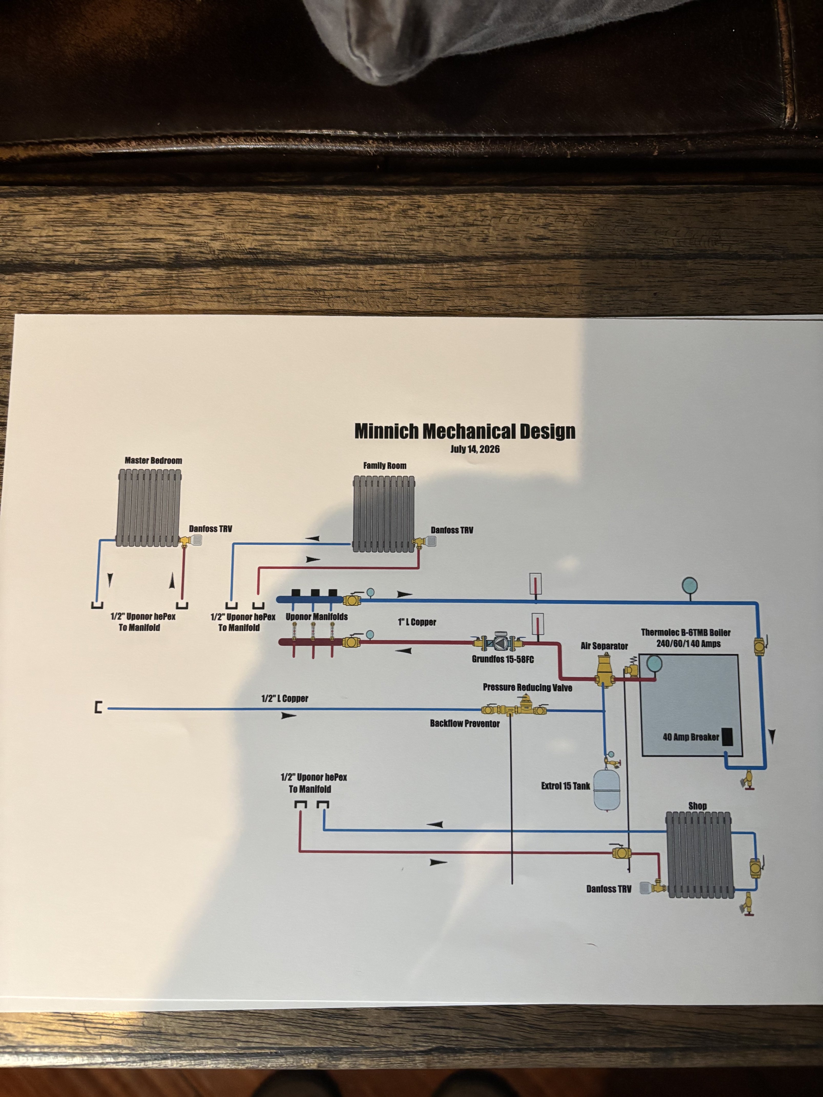

    I still use John's HydroSketch, but I didn't know Uponor's software was back online. I'm fairly sure it was gone for a while? Here is my new, very simple, hydronic heating system. I'm seriously considering getting back in the game. I've forgotten many things. Hydronic design is not one of them.

    in my house in michigan a system similar to that is supplemental heating. only with a mod con because electrical heating in michigan isn't practical.

    I agree. I could get by out here without any heating system at all, but I'm a boiler guy so I gotta have a boiler. Honestly, at this point in my life, I'd prefer a simple Peerless cast iron boiler, but the effort involved with venting it would be too much for me now. I like it cold enough that you could hang meat from the ceiling. My wife, the lovely Barbara Ann, is bundled up at 74*. Thank God we have two floors and separate systems.
