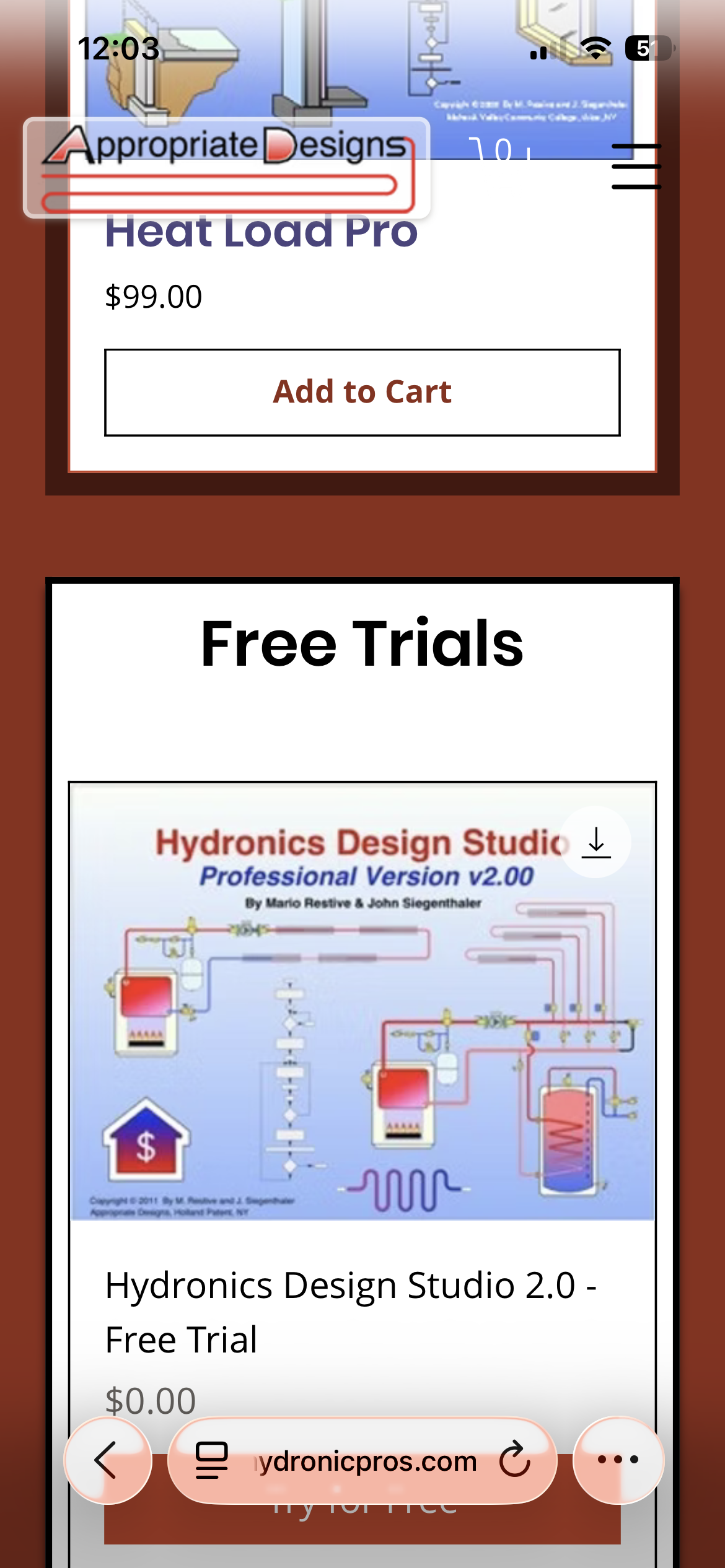

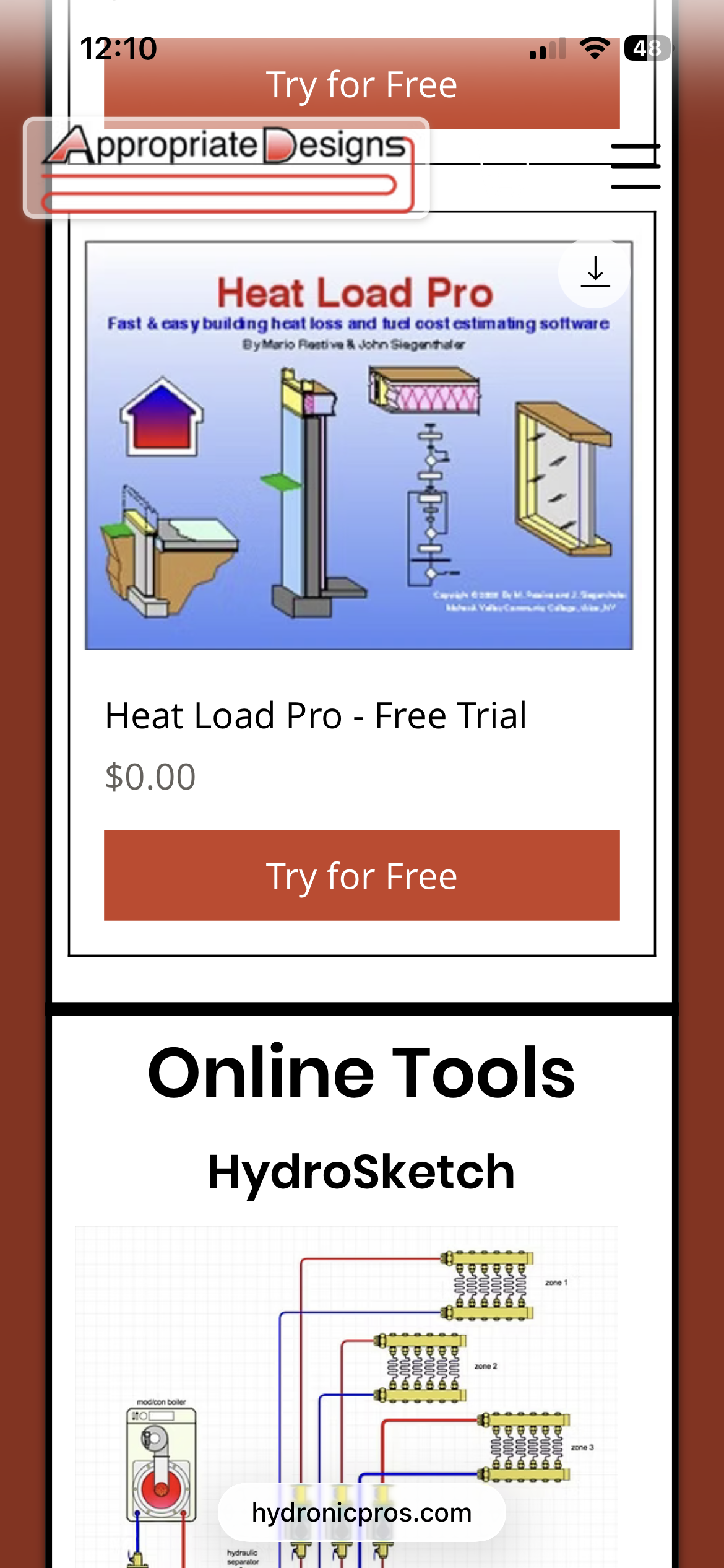

    there is a free demo at hydronicpros.com
    Or 99 bucks for a new version, if you cannot find yours

    I have a beta version of the HDS 3.0, it needs Windows 11 to operate.

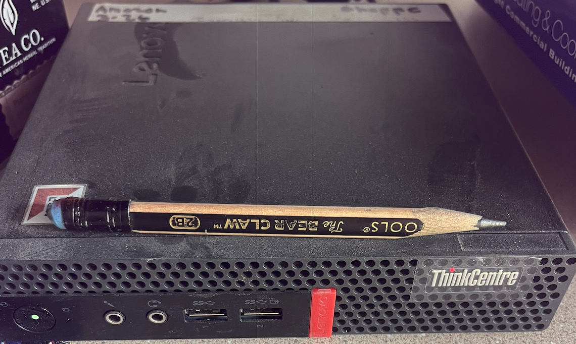

    I bought a PC with Windows 11 loaded,
    online for $274 to run the new HDS version. Amazing how tiny they are!

    I've worked with those tiny PCs. They are basically repackaged laptops- all the components are laptop versions, and are a bit less powerful than desktop components since they're designed to run cool and not use much power. But if you max out the memory (at least 16GB, 32GB is better) and have a good SSD, they're fine.
    Semi-retired
    and their video adapters are a bit dicey. someone thought they were a good thing to use in our installes av systems as the room pc and they have weird issues sometimes using 2 displays.

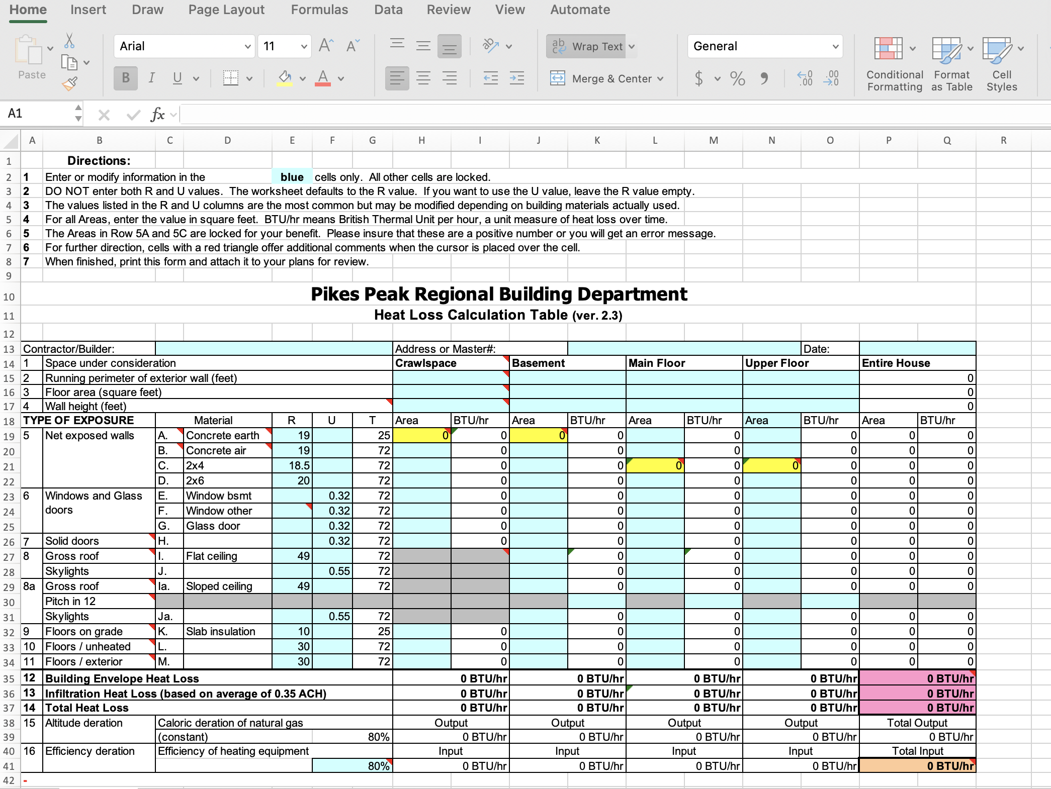

    I think this is basically a Manual J put into an Excel spreadsheet. It shows 2026 revisions? Another free download.
    https://www.google.com/search?q=pikes+peak+heat+load+calc&oq=pikes+peak+heat+load+calc&gs_lcrp=EgZjaHJvbWUyBggAEEUYOTIHCAEQIRigATIHCAIQIRigATIHCAMQIRiPAjIHCAQQIRiPAtIBCDc0MjVqMGo0qAIAsAIB&sourceid=chrome&ie=UTF-8
    Yeah, the more detailed programs like Siggy's allow you to custom build the walls and floors, so a bit more accurate. If that is needed.

    ACCA has full Manual (all the letters) spreadsheets that work really well.
